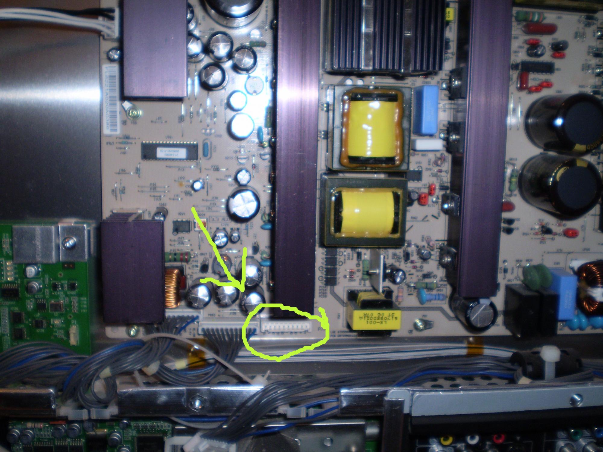

    Update: Just played with it a bit more after posting and discovered something new.
    If I unplug connector labeled P802 from the power supply board the tv will power up without shutting off and the light on the front stays green. Nothing shows up on the screen at all though. So it seems that whatever that cable goes to is what is causing the problem. I've attached a picture of the connector that I'm talking about.
    Does anyone know what this goes to? It looks like I have to figure out how to take the bottom panel off (where the I/O jacks come out) to see what this goes to. (quite an ordeal from what I can tell...)

      That is a picture of your actual board?
      It's riddled with bad caps!!
      Please list the specifiations of those caps.
      Please can you post the specifcations here and take focused pictures of the top of the board and the back.
      One good focused picture of both is preferable.

        Well the caps that look like the top is popped up on them are all 3300uf 10v and every one of them is popped up like that.
        I looked closely and can't find any others that look like that. Not sure if I can take a better picture, that might be the best my camera can do. I'll take the board off and see what I can come up with though.
        I know enough to buy new caps and replace them on the board without damaging anything but that's about it so please bear with me

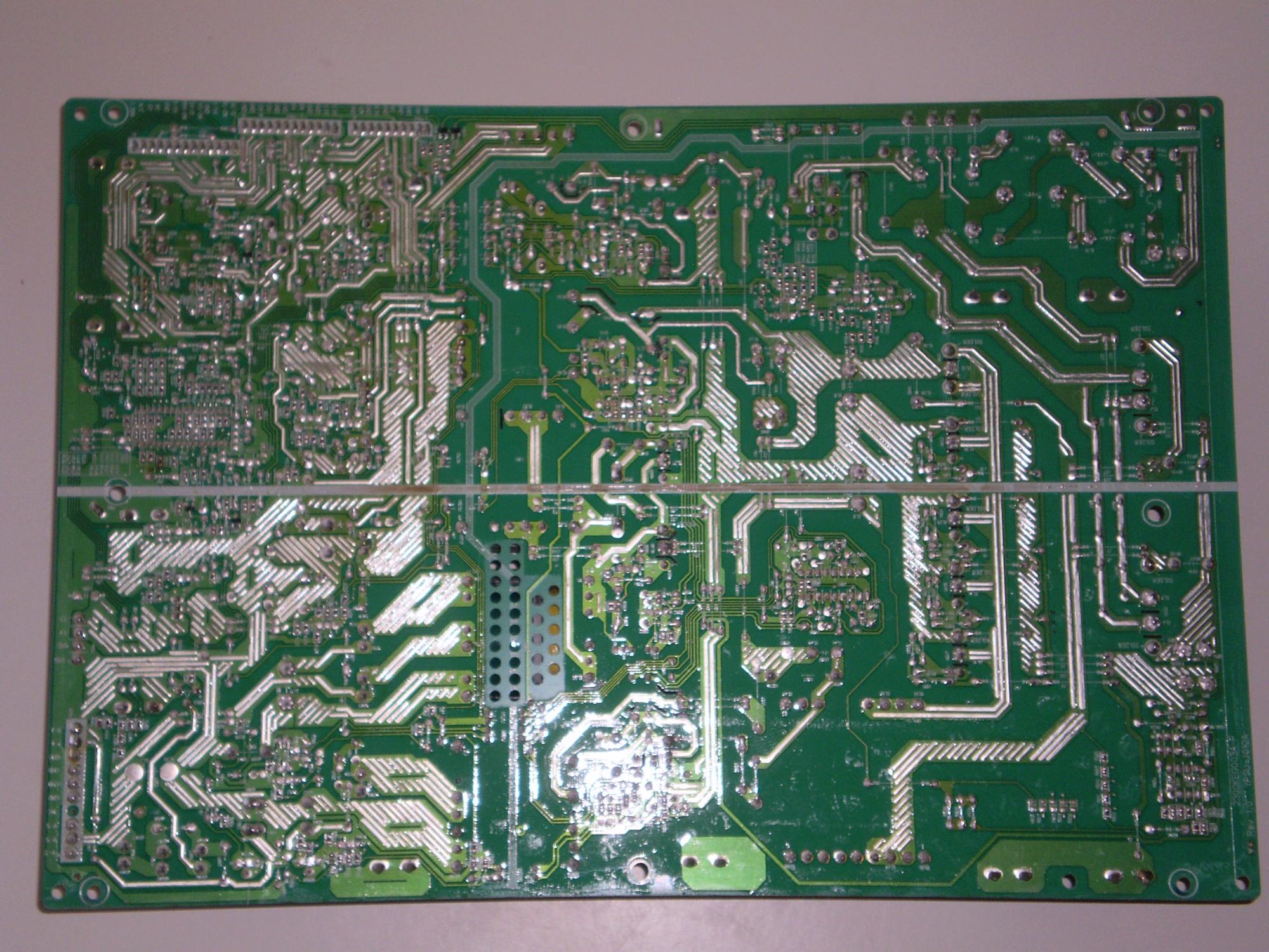

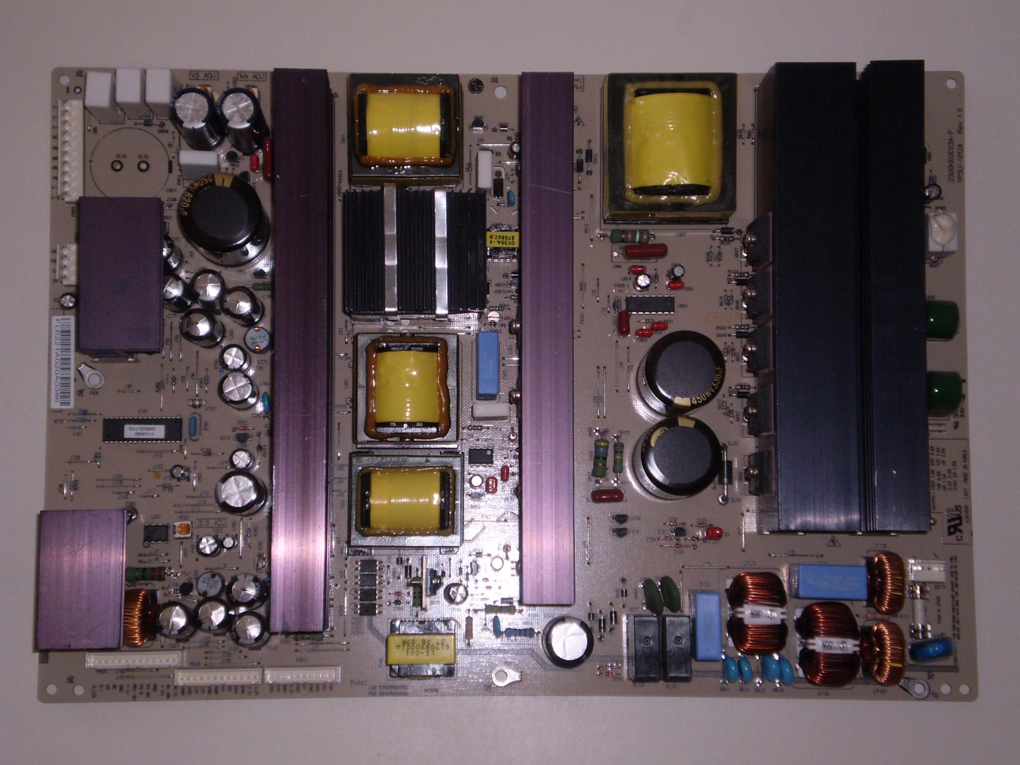

          Alright I managed to take some pictures that were a little better. One of the top and bottom. I see 9 bad capacitors - 4 at the lower left, and 5 at the upper left (including the one hiding under the heat sink). I don't see anything else that looks burnt or popped but I'm no expert.
          I also found out that board that I have was definitely not the replacement, its the one that got hit by the power surge, the guy actually mistakenly replaced the z_sus board thinking it was the broken one...

            If this were my board, I would replace every capacitor, large and small. An equivalent new LG 720p plasma still sells for $700+ CDN so spending $25 USD for caps to replace them all is cheap.

                              Mine still didn't work after replacing the caps and a varistor that looked bad so I ended up just getting this replacement board: http://www.encompassparts.com/products/?ZENEAY32957901
                              It worked! But $10 on parts sure beats $160 for a new board so it's worth a try.
