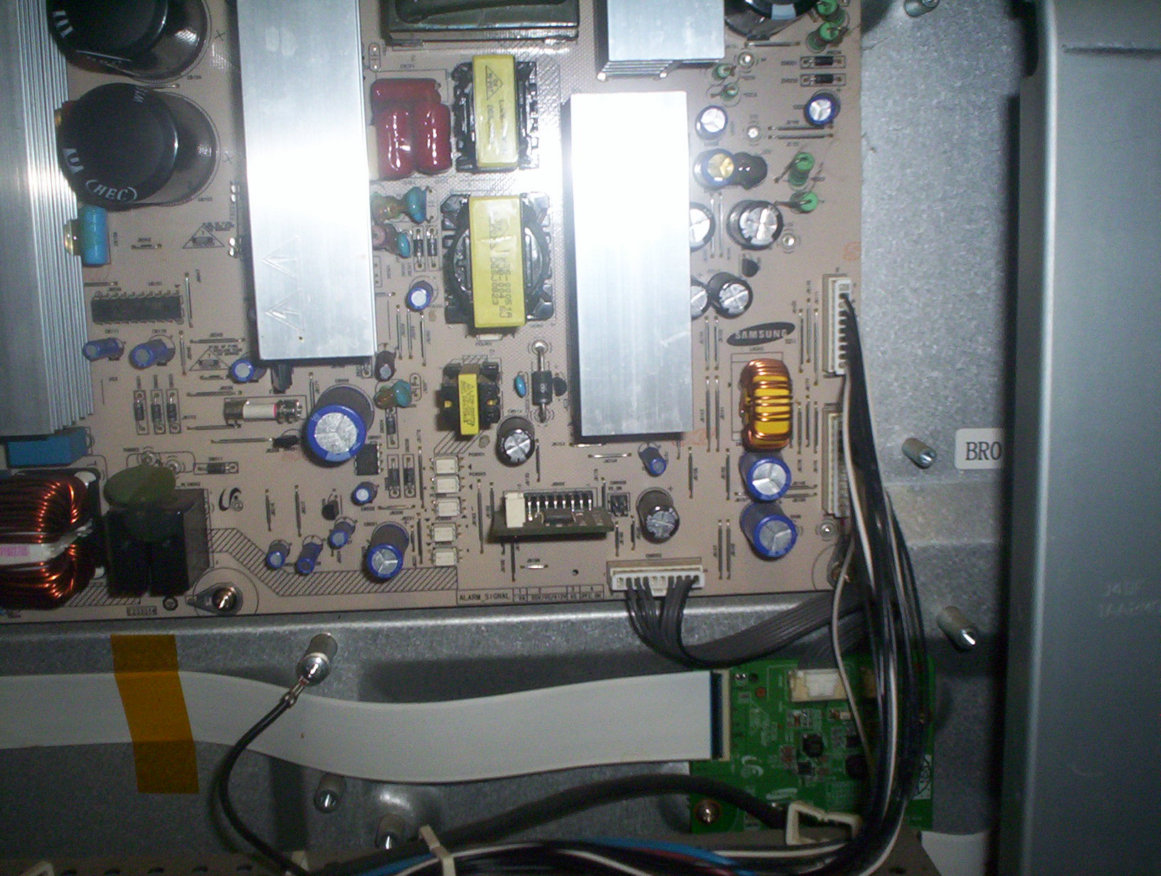

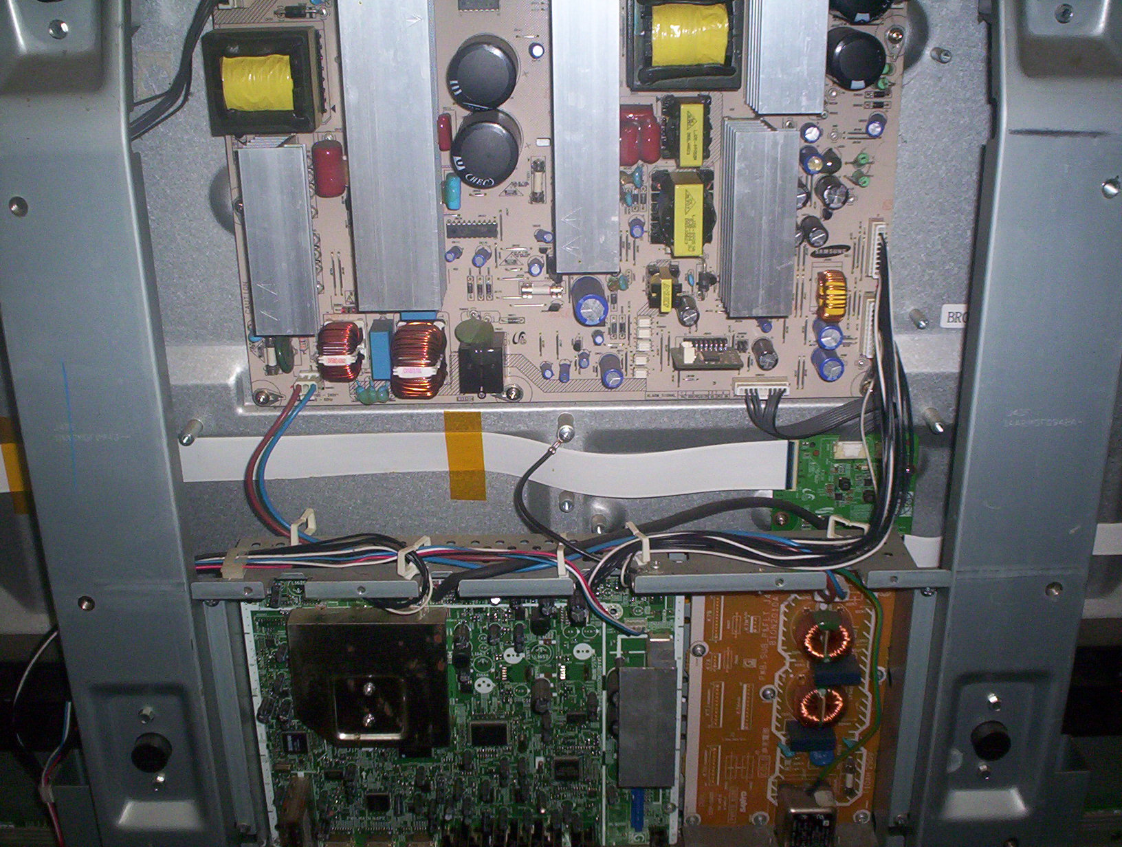

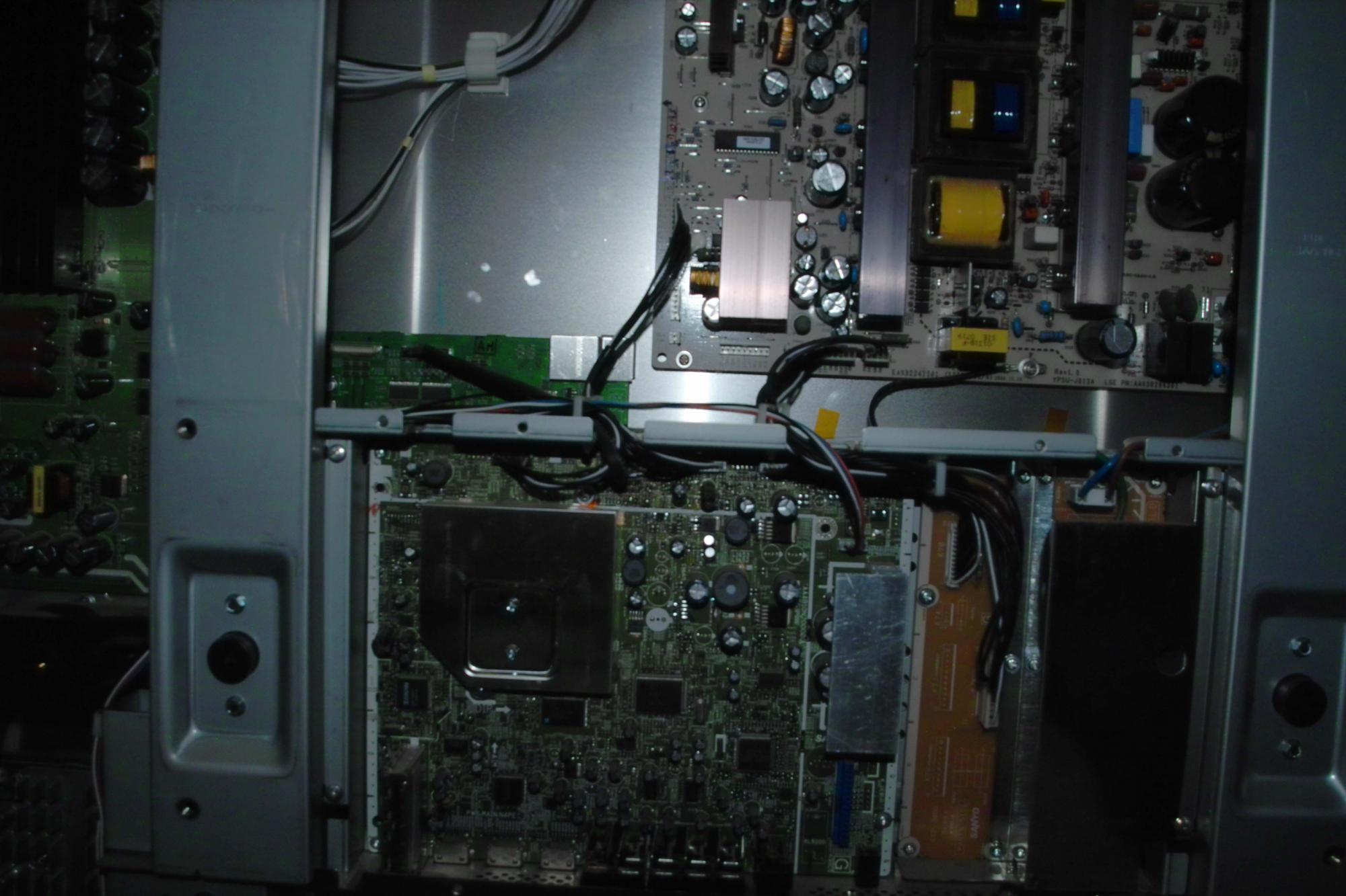

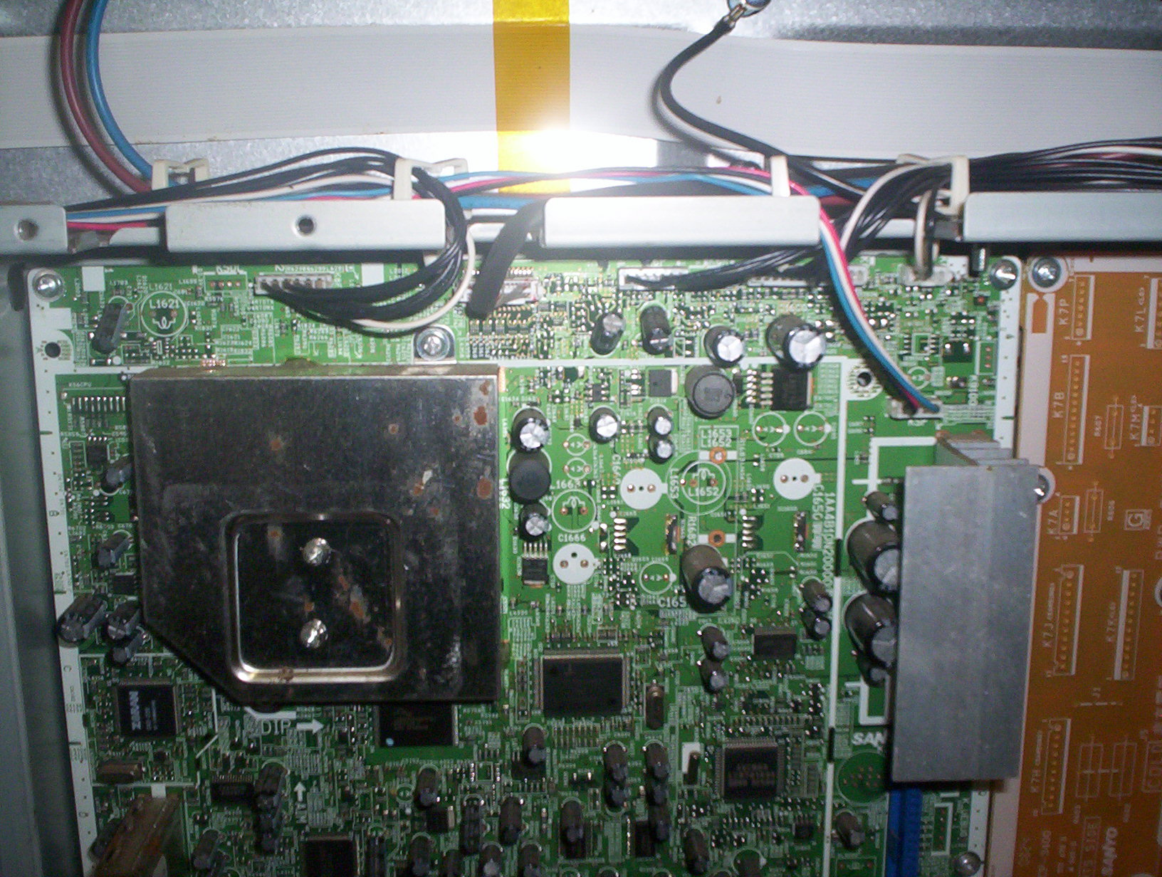

                                  • phatcav
                                    • Jan 2011
                                    • 10
                                    Re: Sanyo DP50747 50" / LG PDP50x4 T000 Panel Tv won't show video
                                    Ok i got some pictures now :-) i had to get new batteries. They pictures arent the best quality so hopefully you can assist with these pics? Any help would be appreciated!
                                    Thanks,

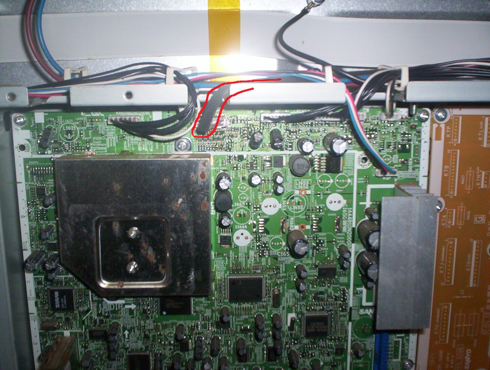

                                    • PlainBill
                                      • Feb 2009
                                      • 7034
                                      Thanks,
                                      Ahh, much better. The cable outlined in red should be the LVDS cable. It goes to the main logic card, mounted behind the chassis holding the main control card.
                                      PlainBill
                                      • phatcav
                                        • Jan 2011
                                        • 10
                                        Am I supposed to short the pins on the cable connector or the board connector? I'm thinking the board connect since PIN1 on the cable is not utilized - PIN1 is the first pin on the lower left hand side of the cable and pin 2 is the pin right above it on the top row and it is pinned. I just want to make sure before i start jumping them. Thanks so much for the help up to this point btw.
                                        Thanks,
                                        phatcav
