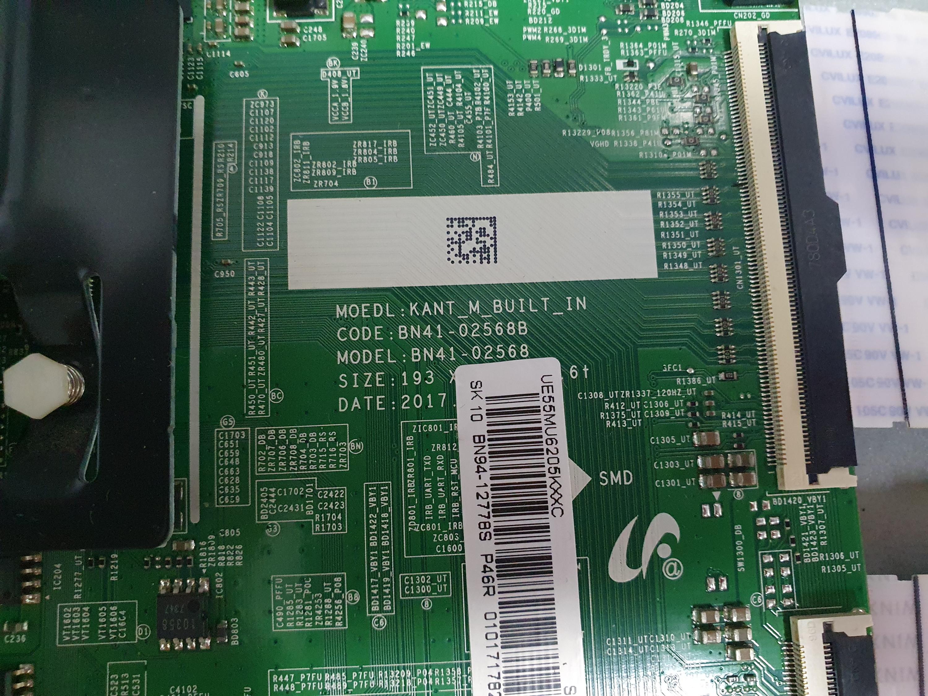

    Samsung ue55mu6202k bn94-12778s Not turning on (dump help ?)

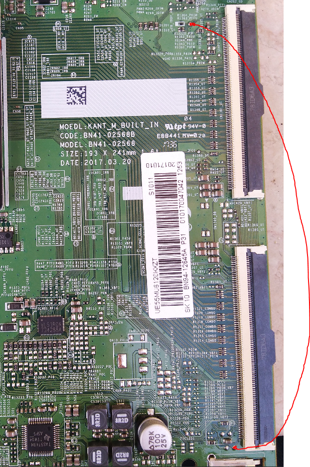

    Good day folks. It's been entirely too long since I've fixed TVs so I'm a bit rusty with all these new models. I have this Samsung set on my bench which doesn't turn on: you plug it in, power LED comes and stays on, but when I try to turn it on, the LED flashes twice in rapid succession, pauses, then flashes twice again and so on. The backlight comes on if I disconnect the main board from the power supply. I tried disconnecting the two large LVDS cables for the panel but nothing changes.
    Based on some info I found on similar models, there may still be hope, as others have reported they were able to fix similar boards by rewriting the SPI chips. I couldn't find the exact model number of this board or TV and it also gets a bit confusing as to what I should attempt to flash: there's 2 SPI chips on there: a 25Q40 and a 25Q80 chip, as well as the NAND, which I cannot work with anyway, so if that's corrupted, then the only solution is replacing the board. I came across another thread where someone was able to "fix" the dump they ripped from the SPI chip(s), thus managing to get the TV up and running again, but they didn't elaborate on how to do it. I read something about setting some registers, but I really don't know if I can do that with my basic CH341 programmer. I CAN read the chips though, so if anyone would like to share how to fix them, or provide a pre-made dump, that would be great. I inferred it's the 25Q40 chip that's most likely to be of interest, as the 25Q80 chip is for storing the panel model. Cheers.

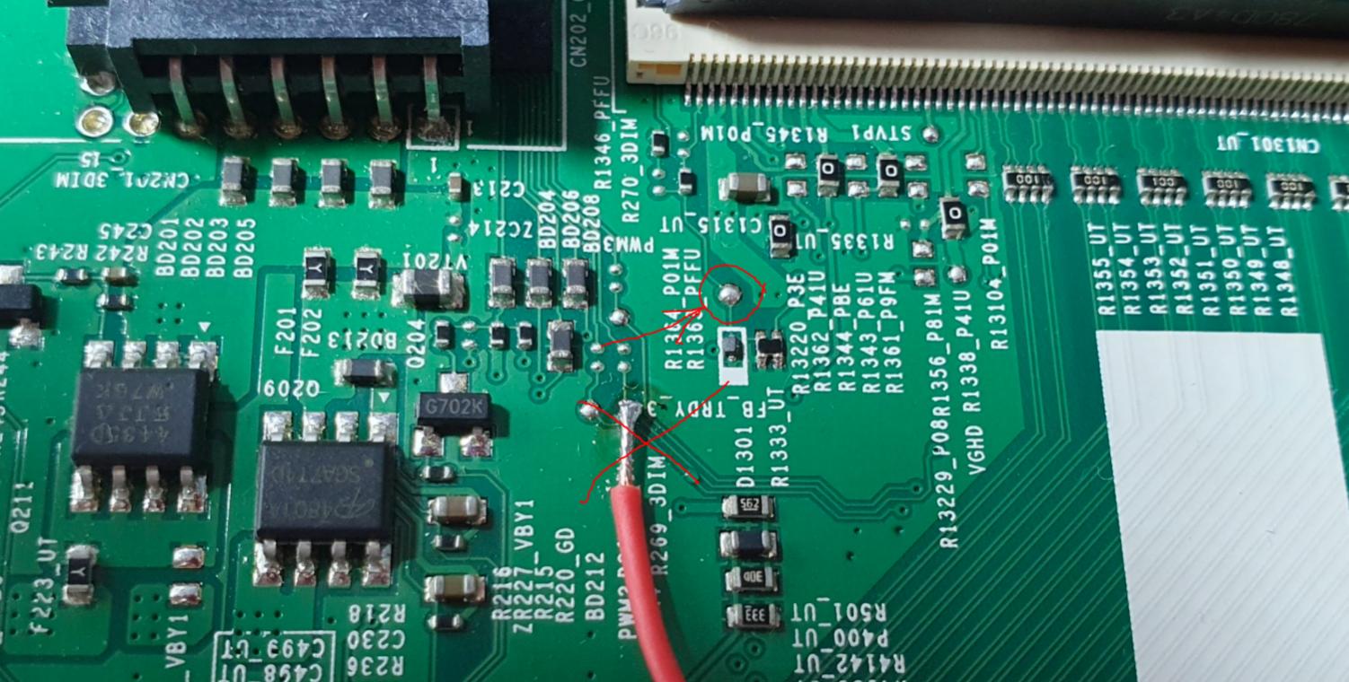

    Re: Samsung ue55mu6202k bn94-12778s Not turning on (dump help ?)
    It's more likely that the issue is not in the firmware (25Q40), but in the panel, first you need to install a jumper between the FB_TRDY_1 and FB_TRDY_3 contacts on the motherboard, then you can check each half of the panel, disconnecting one lvds cable at a time
      Originally posted by lotas
      It’s more likely that the issue is not in the firmware (25Q40), but in the panel, first you need to install a jumper between the FB_TRDY_1 and FB_TRDY_3 contacts on the motherboard, then you can check each half of the panel, disconnecting one lvds cable at a time
      Thanks, it's a start - hence why I said I'm no longer up to date with all these "tricks" Ok, so I just run a wire between them them like that ? That's wild I assumed they'd be adjacent solder pads I'd have to bridge for each side of the panel

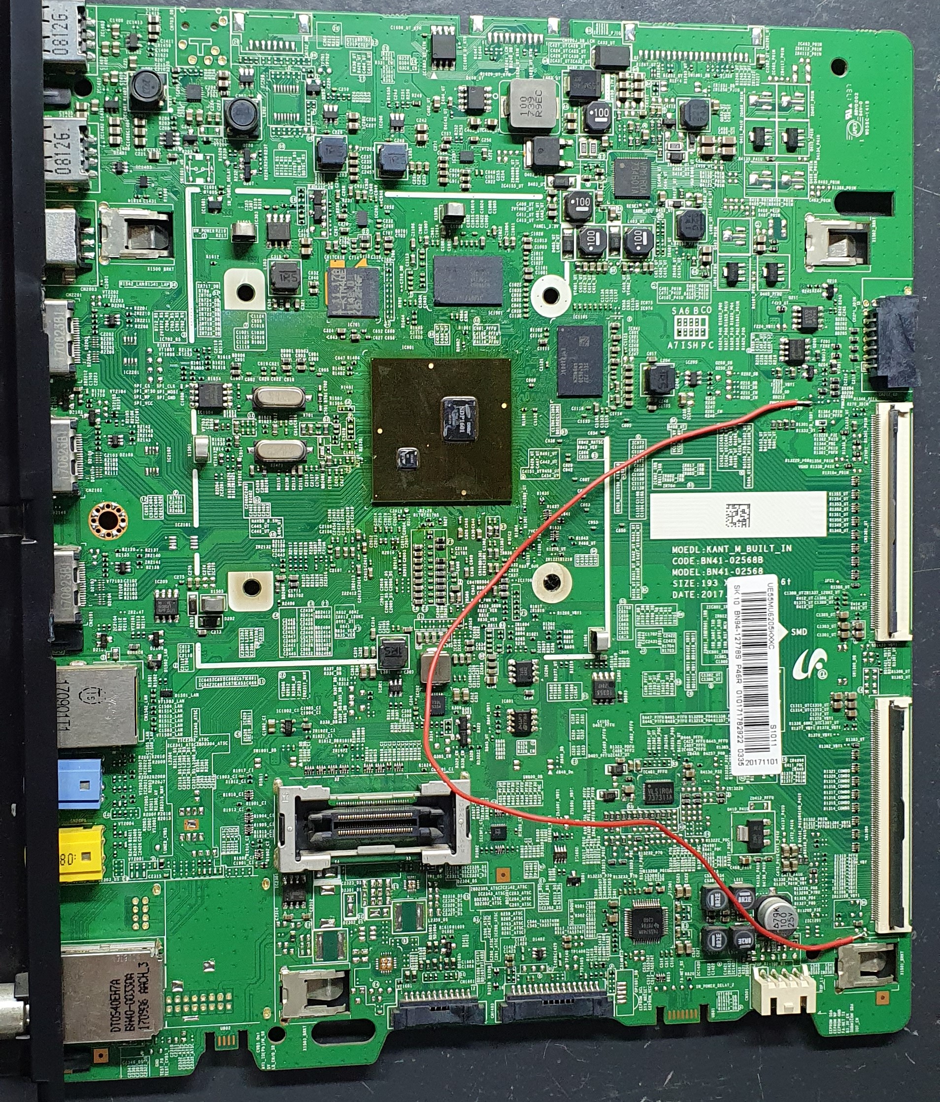

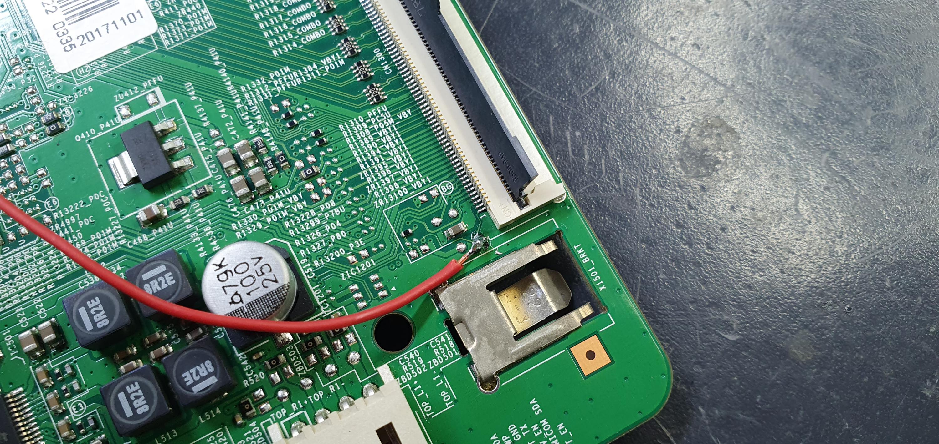

          Ok, I'll provide as much info as I can in one go: connecting those test points together did not change anything (I HOPE I got them right, especially since the bottom one isn't marked, but I inferred from other posts it's pin 1 of the LVDS ribbon). The set still doesn't go past blinking the LED, no matter if one/both/neither of the ribbons are connected.
          Next: I pulled off and read the 25Q40 IC and got THIS. I tried ASProgrammer just to see what it's like, since I haven't used it before. It appears to read the chip alright, so it's happy with my cheap and cheerful CH341. I don't know what to do next though. I read something about setting some registers, but don't know how to do it or if that alone is enough. I clicked through the different options and came across this "SREG" screen which seems familiar (definitely saw it mentioned in another post), but most of the fields are blank, with all blank boxes ticked on the rightmost column, so I can't read what they are. I tried it on an older win 7 machine just to make sure it's not a compatibility issue, but the same thing happens.
            Connected incorrectly!
              Ok, let's try it again...sure how that first pad didn't kill anything (else) Same behavior sadly, even when moving the wire to the pad you indicated.

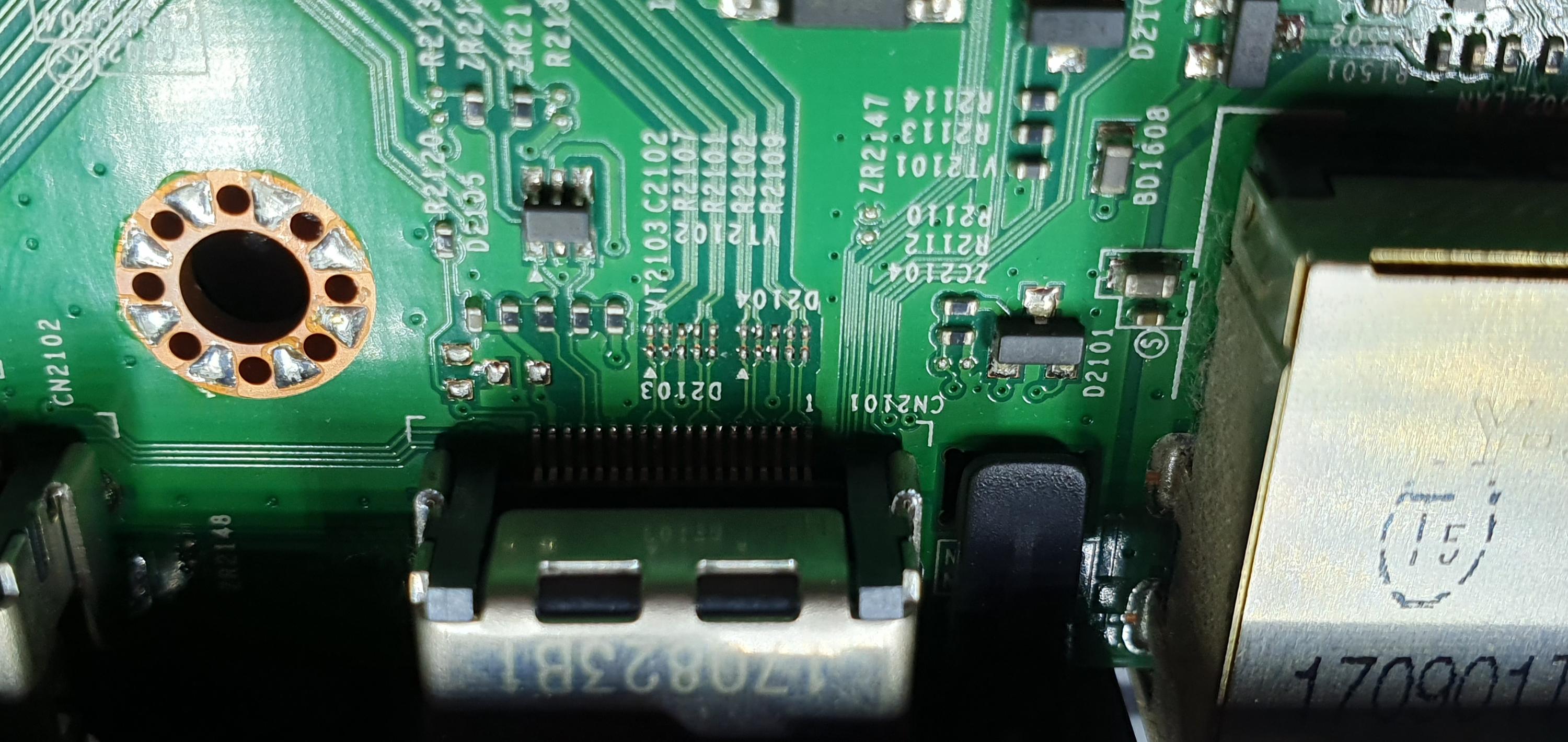

                  Check the signal line resistance for low or short circuits at the USB and HDMI connectors to ground.

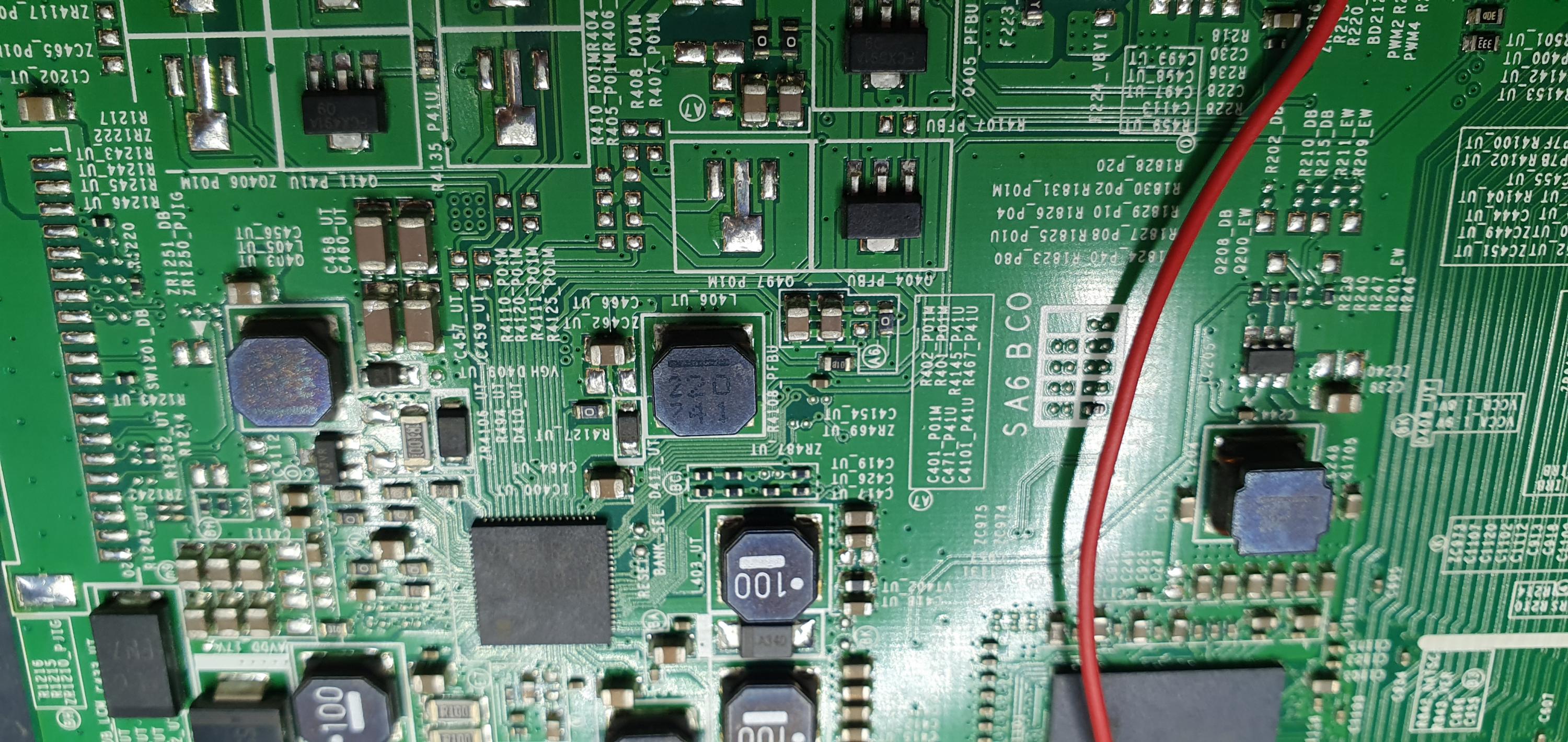

                  I believe you refer to these. They all read in the Mega-ohms range, except for those vias in-between, which are GND. Same goes for the USBs.
                  As I was buzzing around, I noticed this coil L406 reads short to GND (just my meter's leads worth of resistance). I tried voltage injection with around 0.8v which resulted in around 1.2 A of current flowing, but nothing got hot - at least not something that I could feel. It may be an inverted buck converter and the coil is connected to GND on purpose.
                  Picture flipped upside down on its own when I uploaded it for some reason, sorry about that....couldn't fix it.
                    The inductor (inductor) can also be on GND, this is for converting negative voltage in relation to gnd, for VOFF = VGL = VGOFF = VEEG = from -5V to -9V.

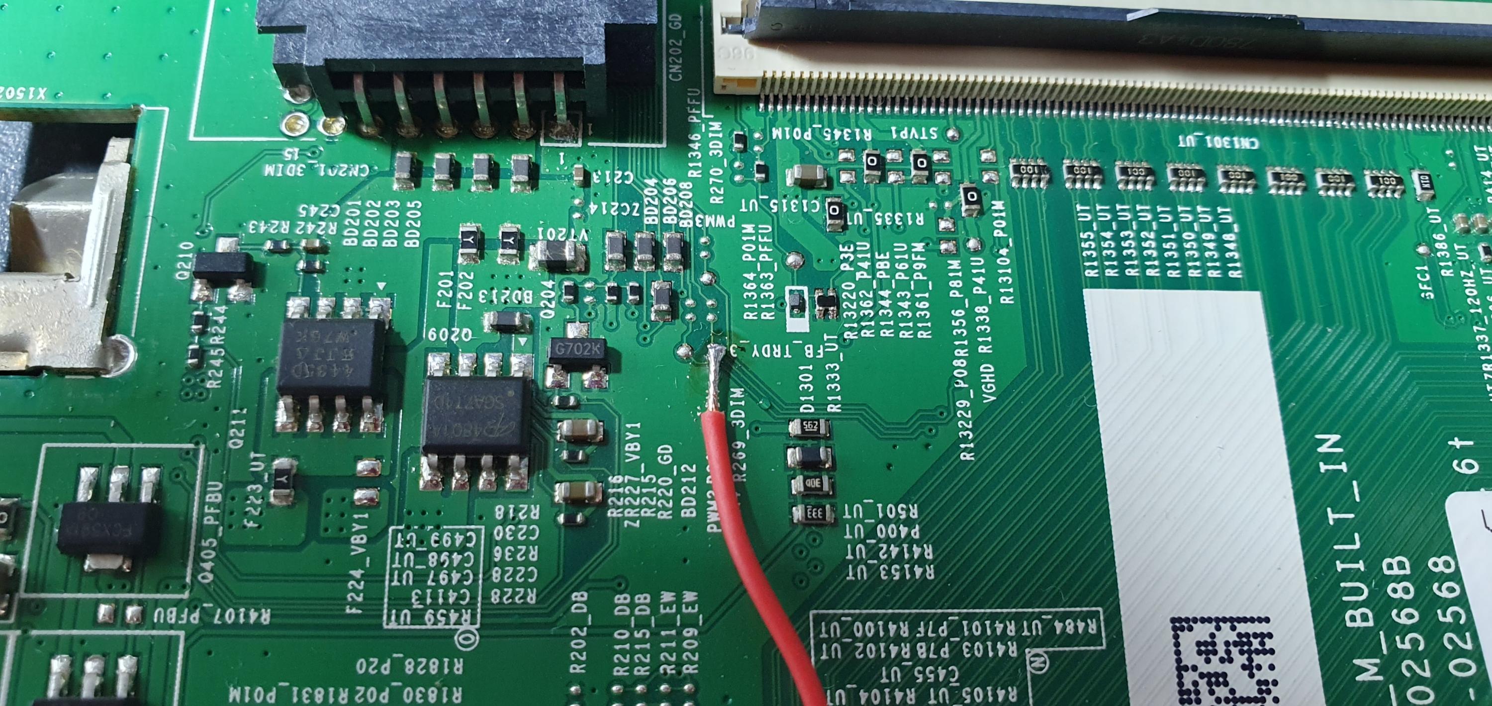

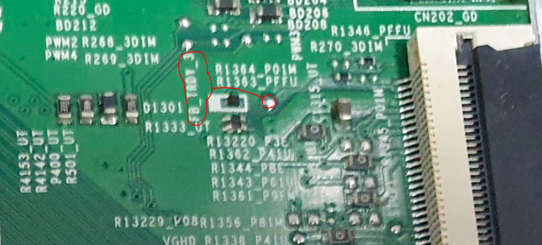

                        I have reasons to believe my dump might be OK after all, which sadly lowers the chances of this board being fixable. I compared my dump to others that had issues with similar TVs and noticed the corrupt dumps have empty bits up to 180, while the "fixed" ones essentially restore these bits. My dump on the other hand looks very much like one of the "fixed" variants, with no FFs in the beginning, so I'm starting to think this is a NAND issue or a CPU issue, which might also explain why it's not starting even with the TRDY pads jumped together.
                        I also wanted to work out how exactly this TRDY loop works and exactly WHY I had to do that in the first place, since I was a bit confused when I saw other videos of similar TVs where they just unplug one of the ribbons and the other half still works like you'd expect, even with the TRDY loop open, allowing you to at least narrow down the issue to one of the buffer boards and work from there with the scotch tape trick. This doesn't happen in my case, with or without the jumper wire. If I buzz out the first and last pins of each connector, sure enough, I get continuity with both ribbons connected and infinite resistance with either unplugged, so it makes sense. I think a pin on the CPU gets pulled high through this loop, like a simple switch.
                          TRDY1 -3 they are connected to each other (this is when there are two lvds loops) and if you disconnect any one of them, then you open the circuit and the controller sees that the panel is completely disconnected and the power stops flowing to the panel; with the jumper, the controller sees that the connections are connected two loops, this trick is for diagnostics.

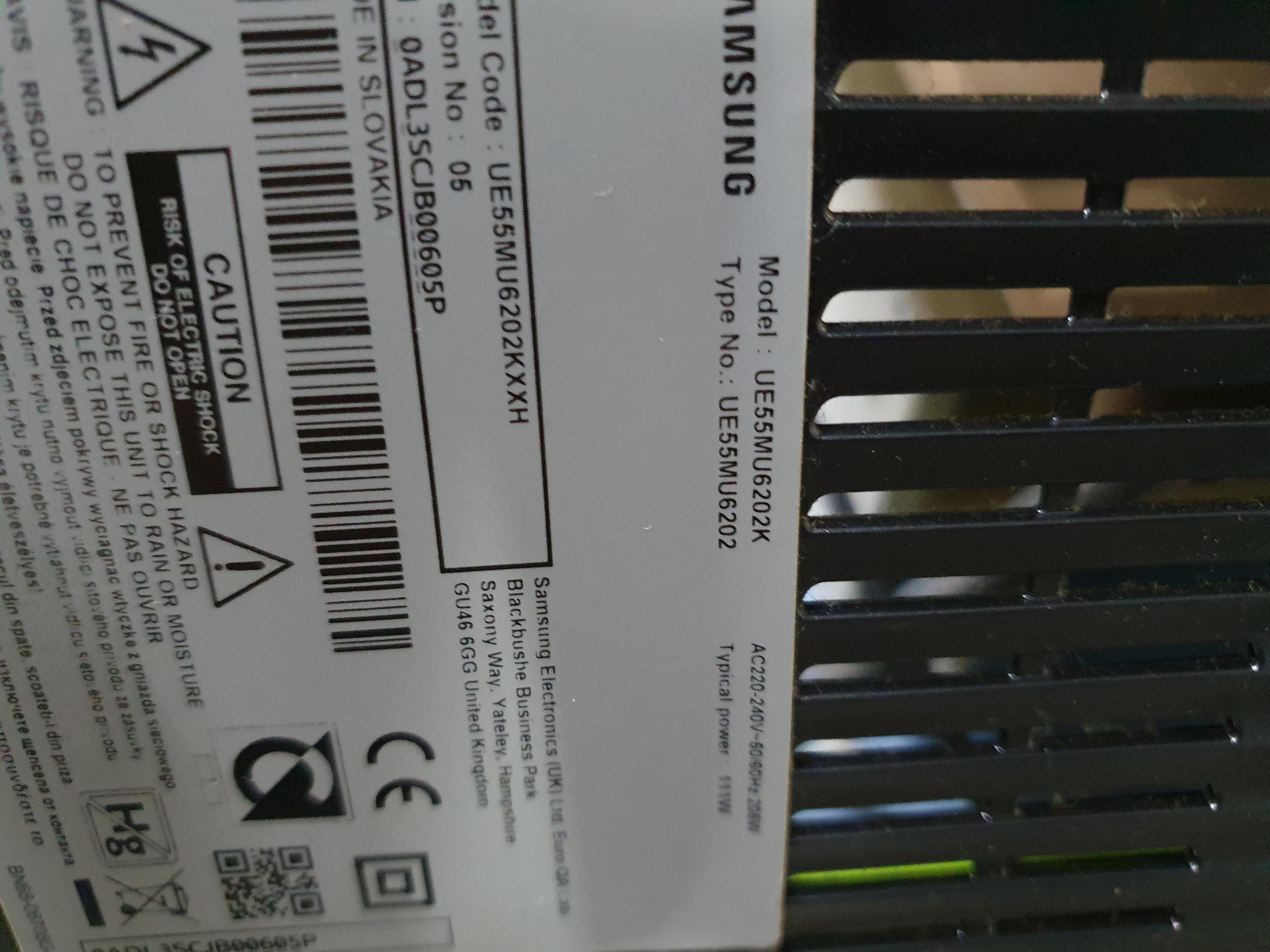

                            What panel do you have (number, model) and post dump spi flash 25Q80, maybe the problem is there too.
                              Here's the dump from 25Q80 and the panel model (I edited the picture by accident and cropped it weird, so I hope you don't need other info outside that).

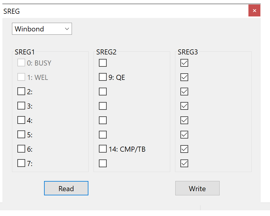

                                        Try another clean dump 25Q40, after recording the dump, set and record the status of the register 0x88, 0x42.
