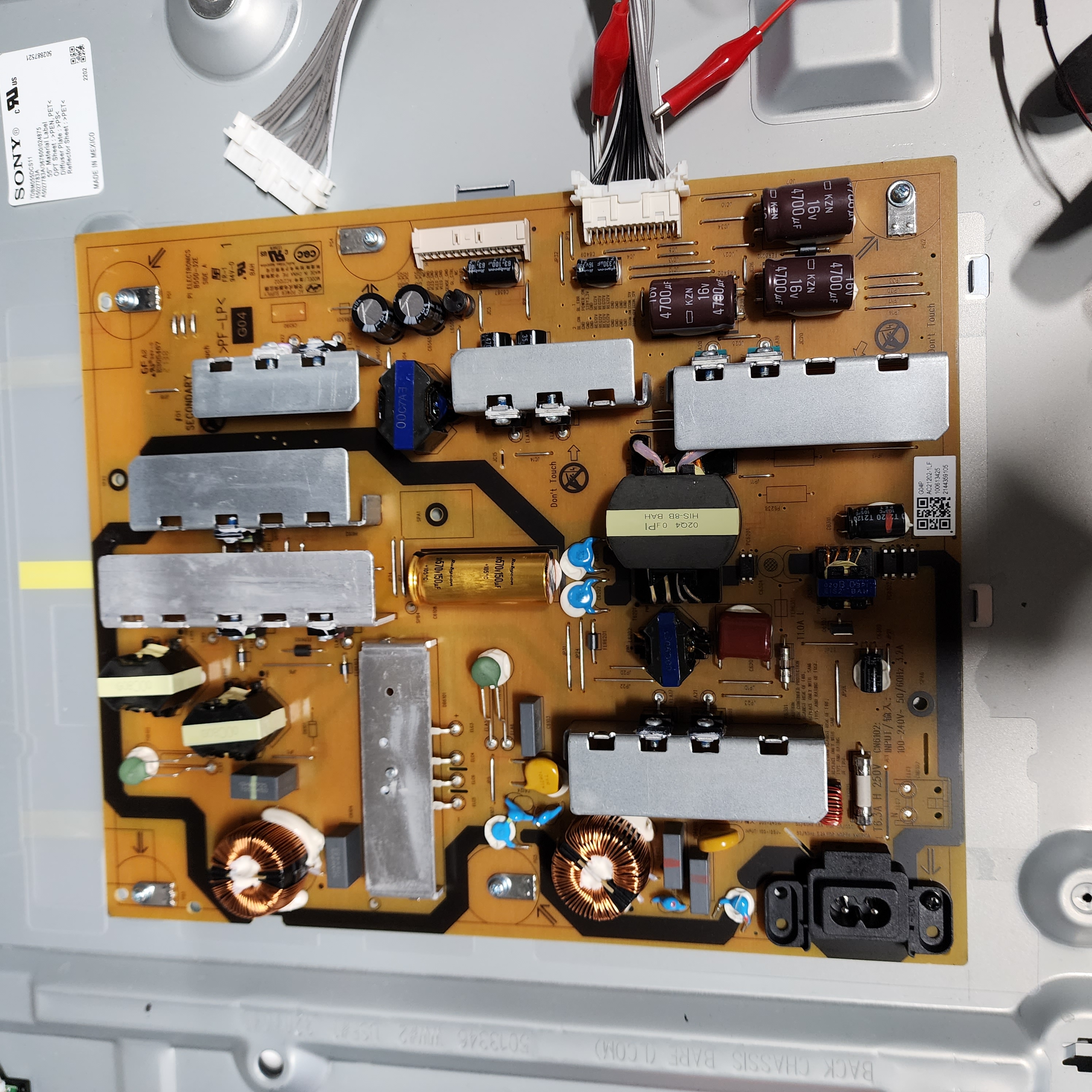

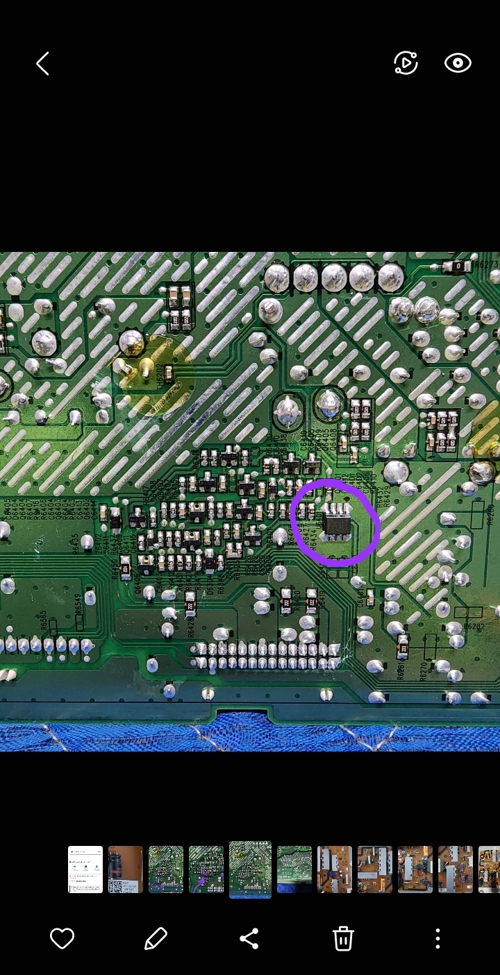

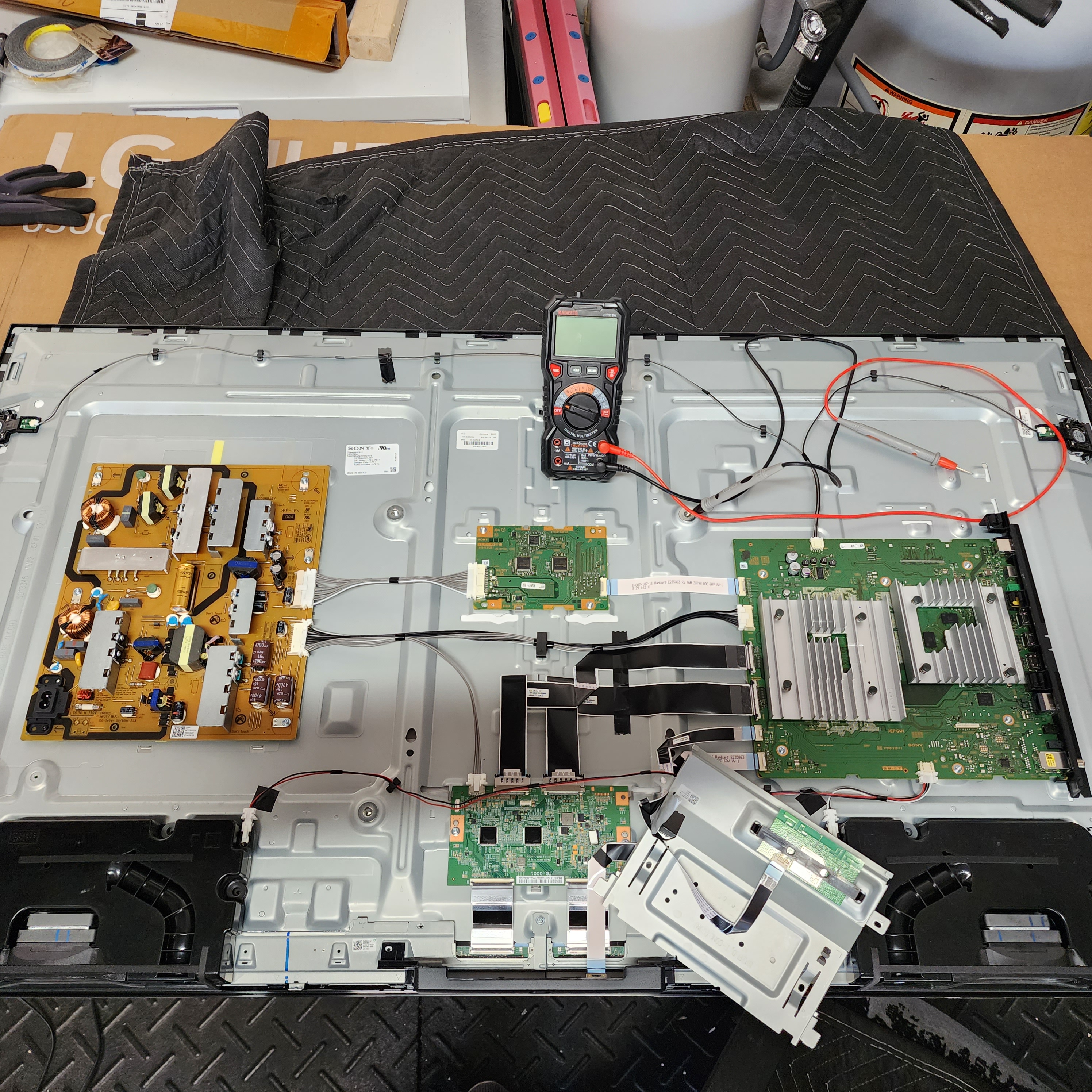

    xr-55x90j was picked up free and there is no standby light at all.
    I have checked the PSU and it feeds 12v to main board and correct voltage to the LED driver.
    I have forced the backlights on and they work through the PSU.
    The main board is supplying .178 to the tcon fuse which shows it as 8a/35v.
    I try to hit power and the numbers don't change nor does any light.
    Is this safe to assume the main board failed here? Anything I should check.
    Also there is a main board for this and 65inch which seems to be cross compatible.. would I need to program it before sticking it in or something? That is, if it's main board issue

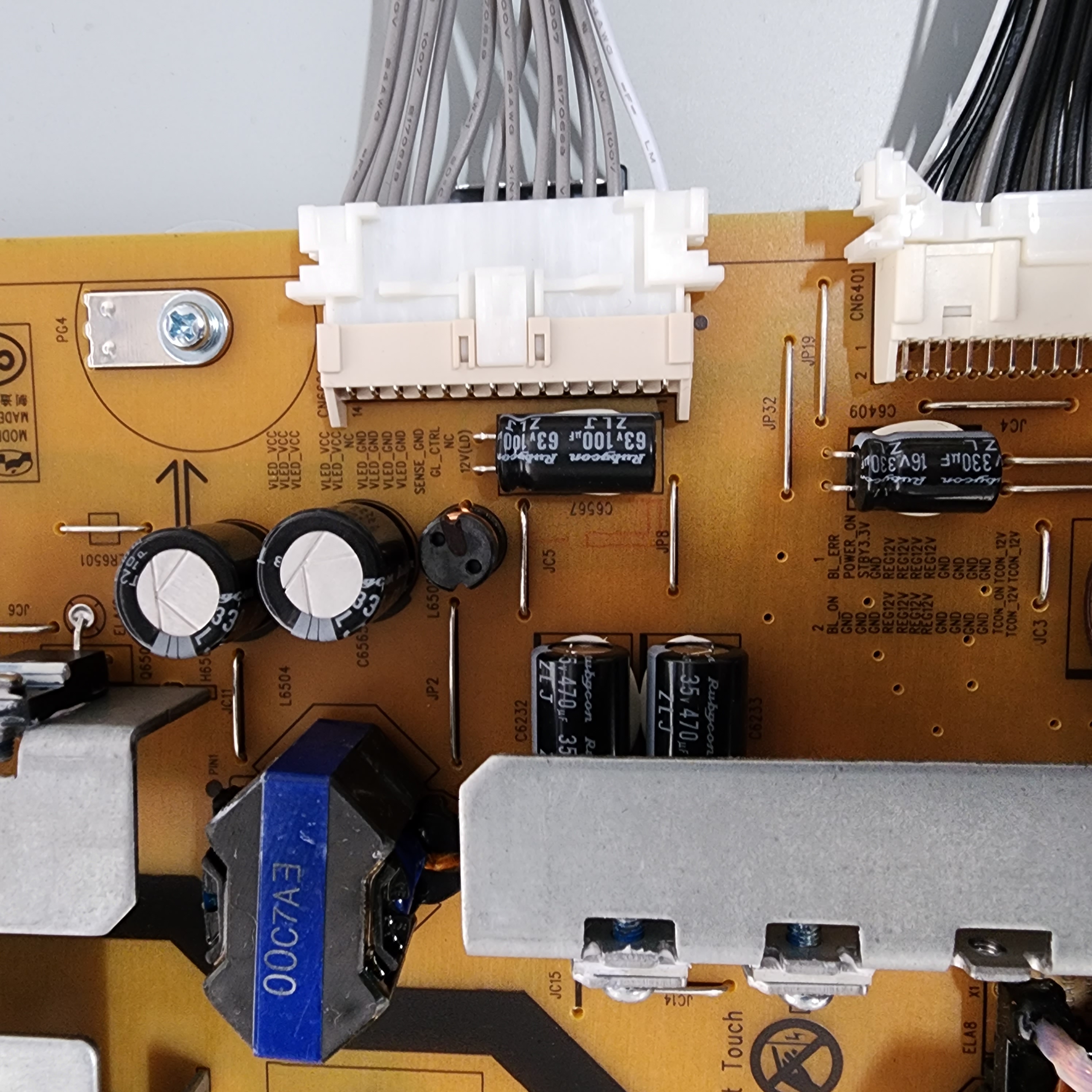

    Re: xr-55x90j power issue

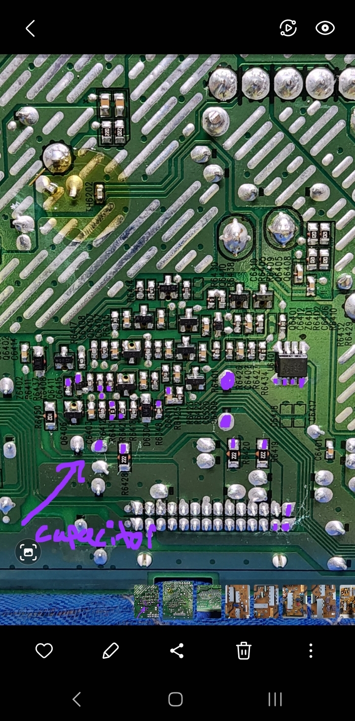

    When jumping tcon on the tcon 12vtcon line goes up to 1.4v. the cap shown in pic is only hitting 1.4v also. I would assume that this is not correct. Any direction for me on this?
    Main board gets 12v but there is no indicator light either and power button does nothing. Any direction? I'm but lost here
      unplug the socket on t-con which feed the 12v. then do it a you did before .. main boards disconnected and run psu as stand alone with out MB and t-con see if the 12v of tcon correct or not

        Sorry forgot to put pic, yes will try diah.
        TCON AND PSU connected (no main board or BL) voltage 1.4v to tcon12v when jumping
        PSU standalone, no tcon connected. TCON 12v line is 2.06volts when jumping

          so your t-con 12v on psu need to work on

            BTW,,, you need STB connect to PW.on when you do t-con 12V_on

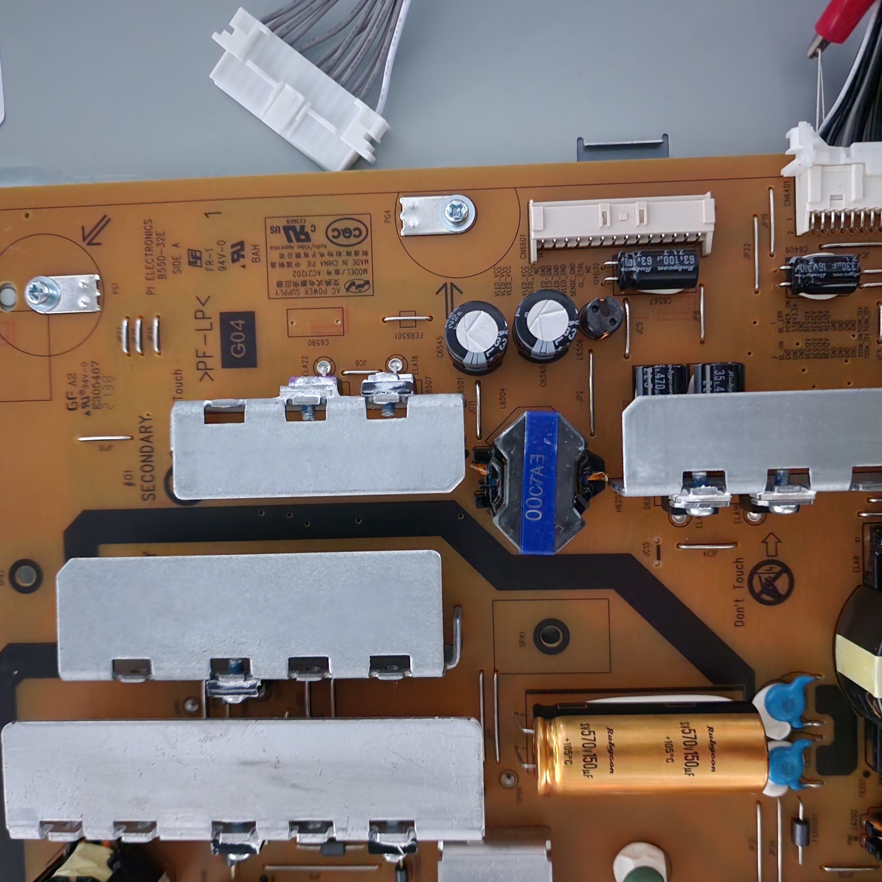

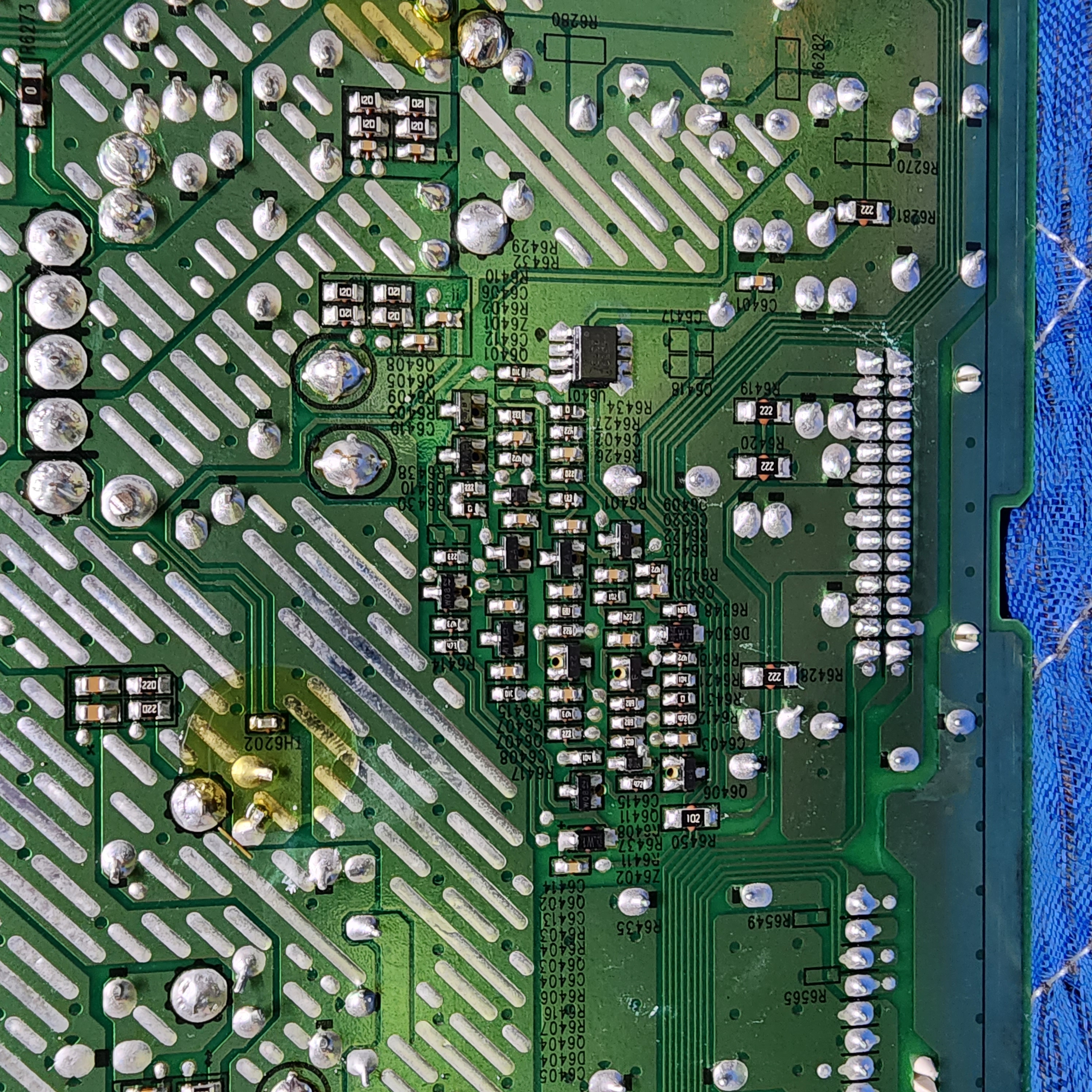

                  This is what I get so far. Purple is where all the beeps go on the line. Then I lose it, I don't really know how to trace a line well, anyone know of a informative thing?
                  There's only one cap along the line that I see which is the one from post 4 first picture.
                  This is where I'm at
                  Edit, I just pulled that cap off to test and it's 325uf which is pretty spot on.
                    you have low currents on this line as you wrote 2.06V. its much like you have R changed value and this common issue at PW_ON or T-CON12_ON.. also the other common issue optocoupler.

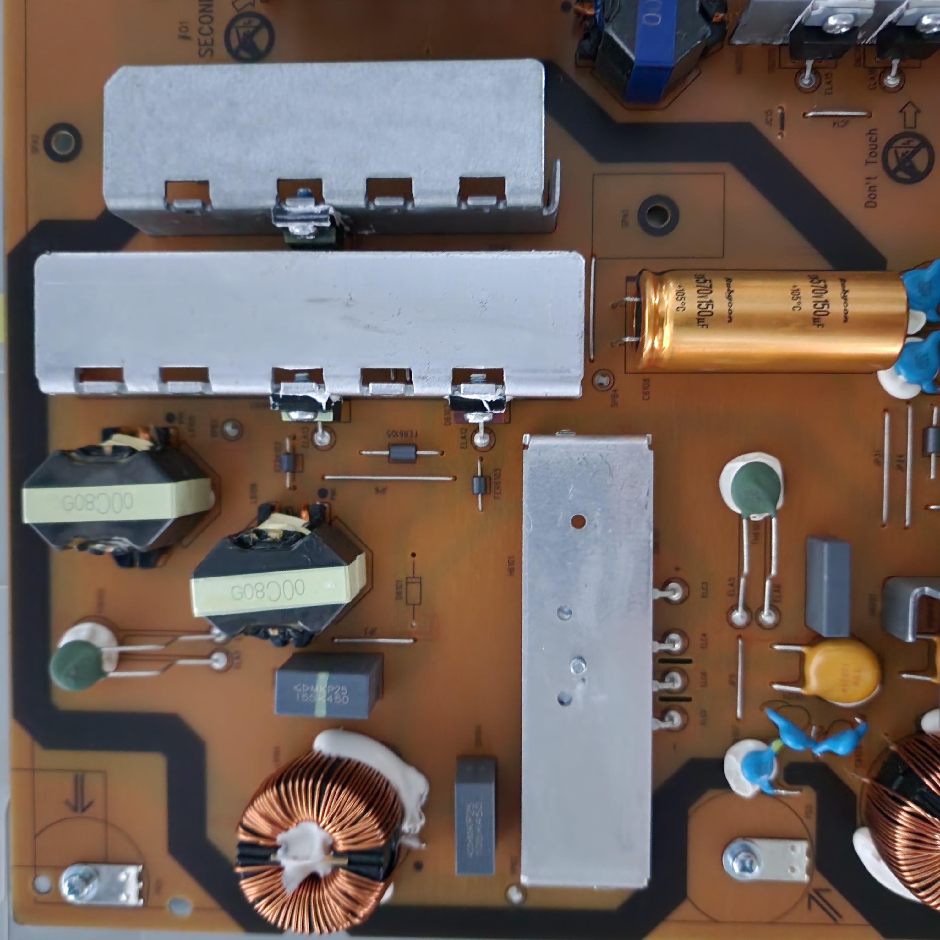

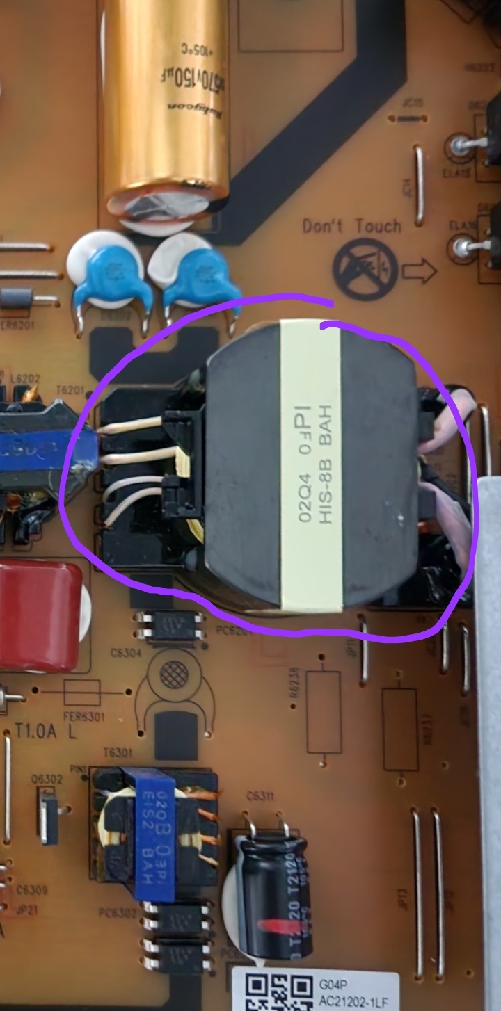

                      Is this the optocoupler you are talking about? Is there a way to test it? Gonna research it
                      • nomoresonys
                        • Jan 2013
                        • 12241
                        • U.S.

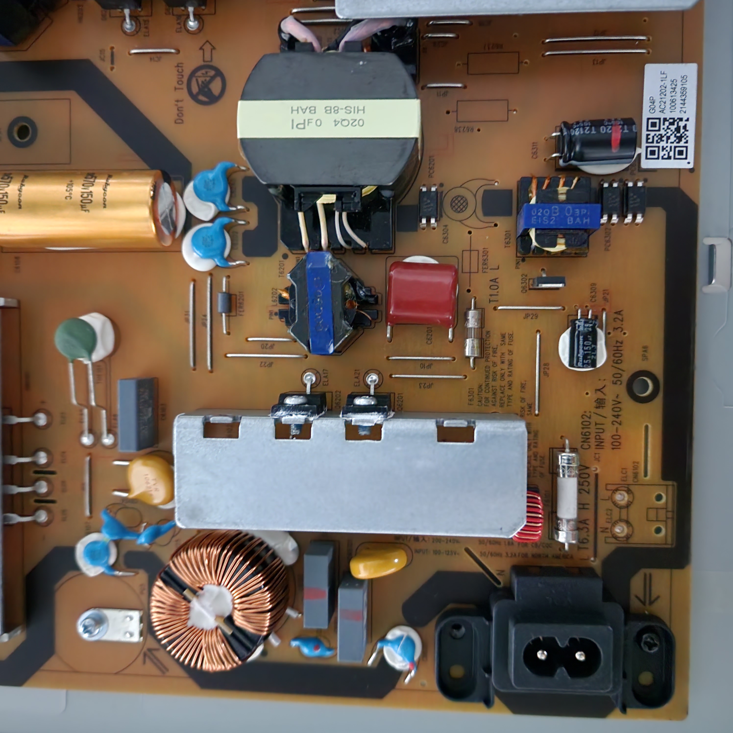

                        Opto is PC6201.
                          Long time no see Sony, know of how I can test it? It's this in the picture right?
                          • Diah
                            • Feb 2013
                            • 6427
                            lol..... this is transformer.. the opto the ic with 4 pin close to it down

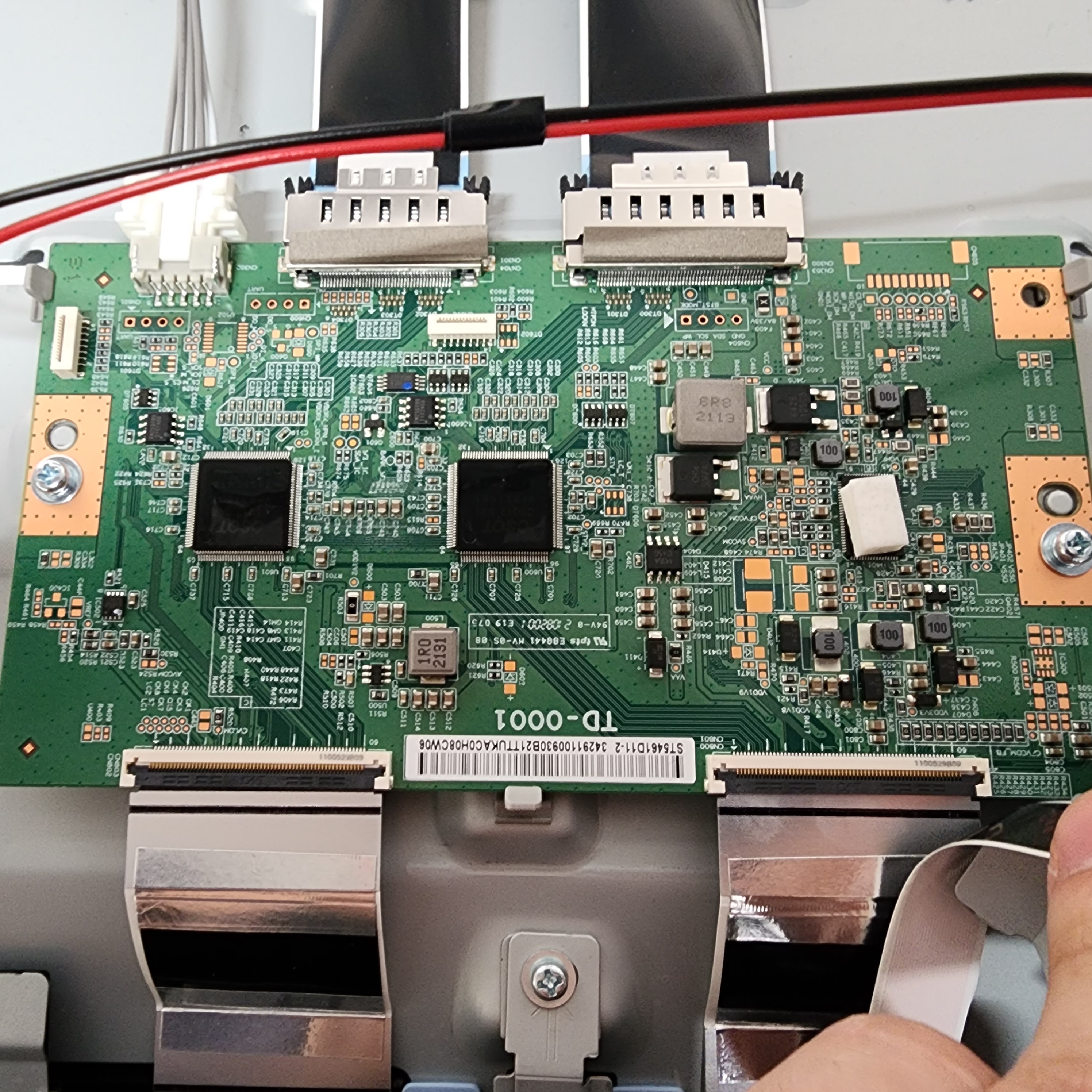

                            • Diah
                              • Feb 2013
                              • 6427
                              from the mistake above, i suggest you to test the t-con and panel as stand alone if they are fine then buy PSU
                              you test before BL on and power On which you have 12V to MB ---- use this 12V to test T-con... MB should be disconnected from PSU and T-CON also, t-con 12V socket need to be disconnected too from PSU
                              note t-con need to have the - too... because u will disconnect the sockt

                                    1- the socket between T-COB and PSu disconnected
                                    2- MB disconnected to PSU and LVDS to T-CON too
                                    3- just do PSU stand alone STB to PW-ON and STB to BL-ON as you did before
                                    the 12V the PSU generated to MB use it to T-CON...if u have Fuse put it on it...
                                    just think we are disconnecting the socket of 12V from T-con and PSU... so the GND chassis line will be disconnected.... so we need to do it in case the t-con have no GND
