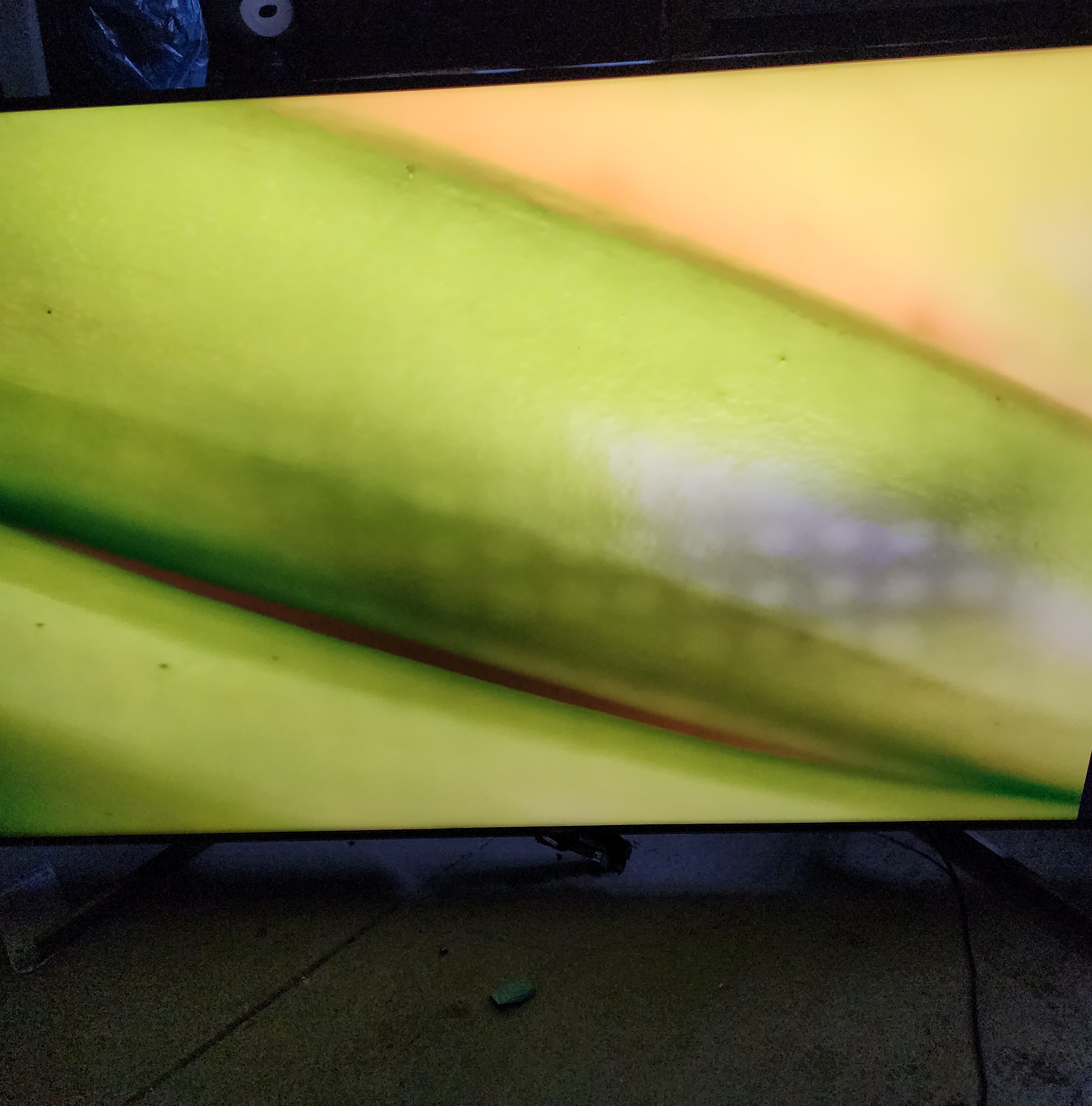

    Hey everyone. Hoping someone has some insight as to what may cause brand new backlights look like this behind the diffuser sheet. I've done about 40 TVs and never seen anything like this. Any help is appreciated as this shows through to the picture during lighter color scenes.

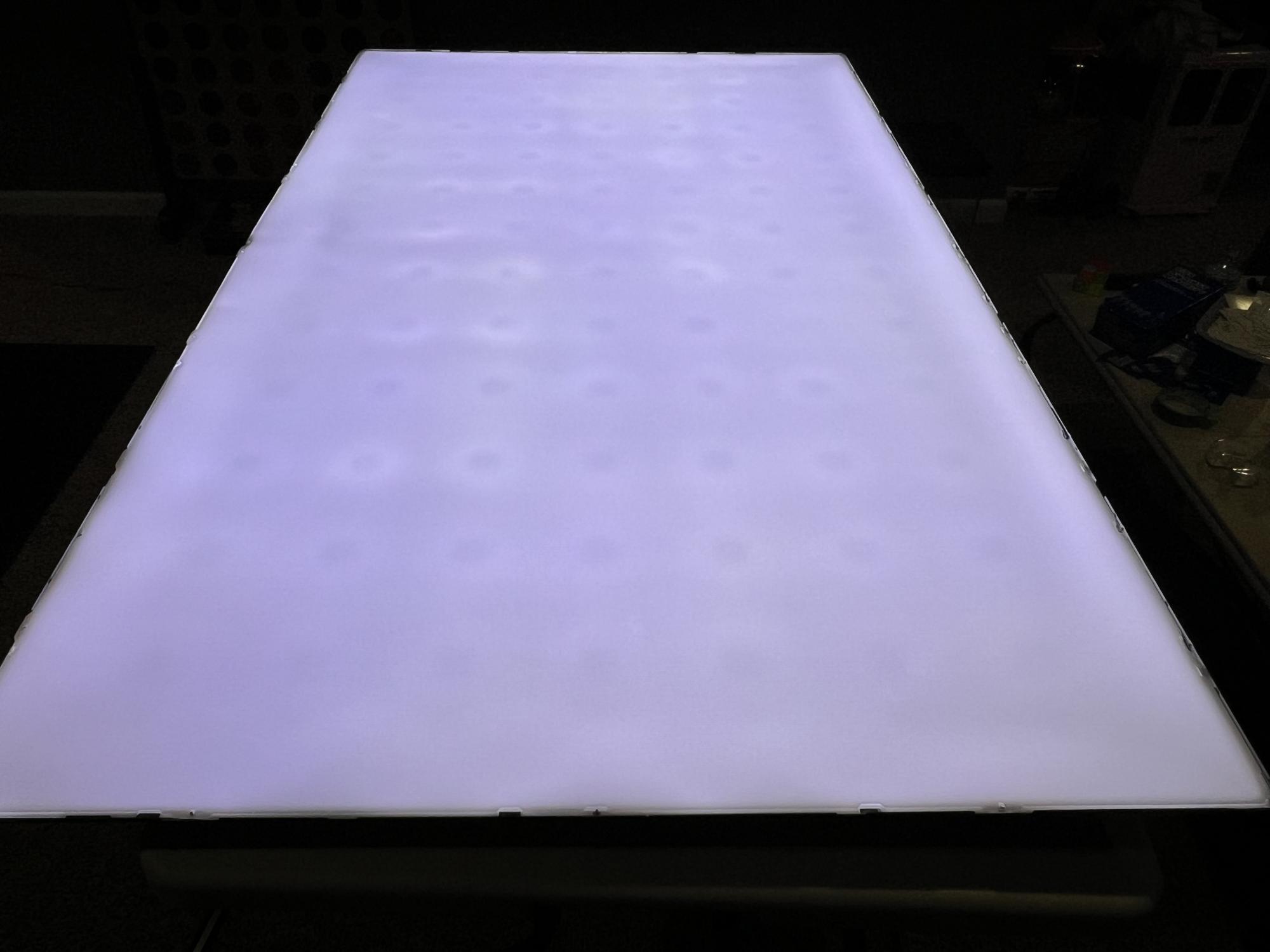

    Re: Hisense 75R63E backlight help
    flip the first solid plate... the smooth surface should be on top
      I flipped it every way possible and still looks the same. I can actually see dark spots through the diffuser lense when the bulbs are off. Seems odd.
        now are different from first photo.... put the reset and see the result
          First photo is with backlights turned on and second one is with them off showing the dark spots where each LED is behind the diffuser. With them on, I get the same halo effect no matter how the diffuser is installed.
            you did replaced LED BL many time as you wrote... the first Solid Plate had 2 surface.... one with small bubble and other smooth... smooth always on the top facing the rest sheets and LCD... no need to do try... if there are black sport on it, exam them if they are burn or dirty. this is strange.. also be sure the legs stand pieces are straight so this plate will sitting straight. as well the first reflector white paper should be mounted tight to the chassis.

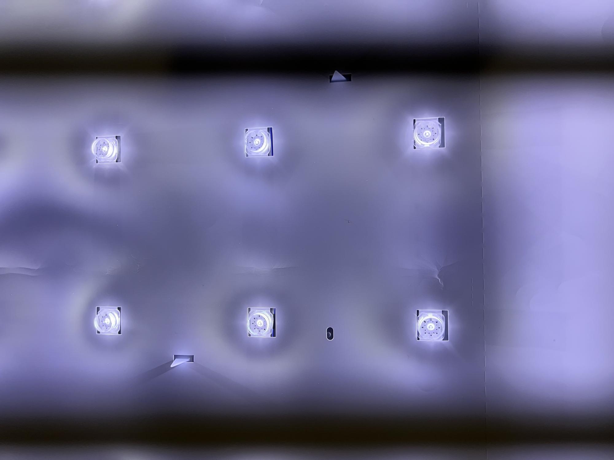

              BTW the white reflector paper... did have black circle round the LED places... could be this what you are see.
                  Think I could have received bad LEDs? Seems to me that the light is coming out around the plastic caps and not out the top toward the diffuser. Could be wrong but that's what I see. This is a picture with the diffuser sheets removed but white paper in place.
                    the original LED lens was Concave as the replacement or they were Convex !!!
                      Both are concave.
                        Both are concave.
                        feed the TV with signal that you will hear sound... then the LED currents will turn High... it may now low currents cause no LCD in place and no video signal.. better put the solid plate as described in order and try.

                          I had the TV back together and watched a football game on it. You can clearly see the LEDs on all light colored scenes. Darker colors look great. Messed with backlight and brightness which really didn't change anything.
