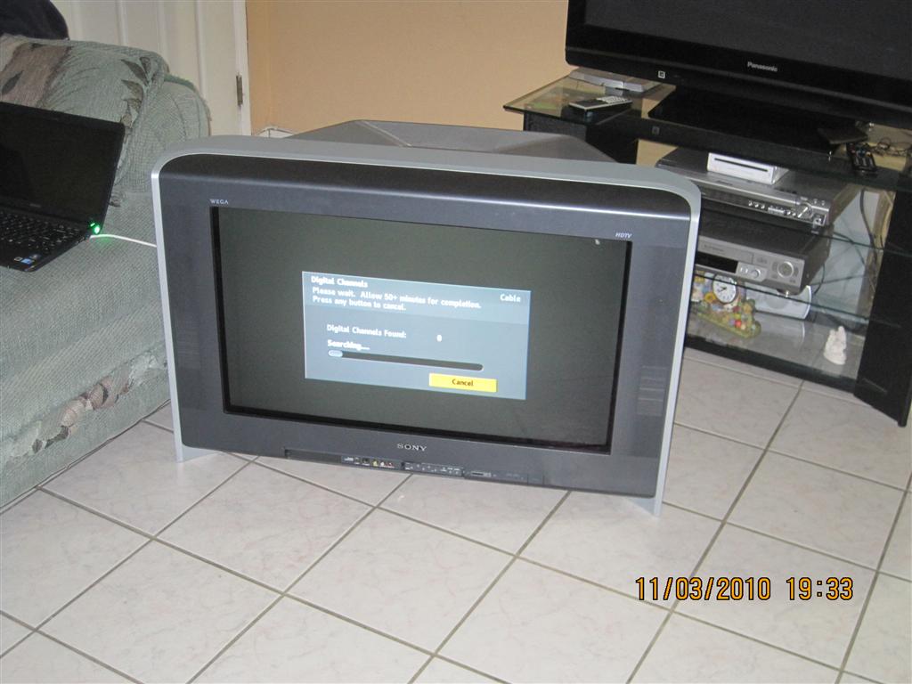

    You guys know I love a good Trinitron, right? Well I just hit the mother load. Check it out:
    A Sony Trinitron 34XBR960, free off Craigslist. This bitch is HEAVY! I had to get my friend to drive me out to pick it up in his truck because there was no way this bad girl was fitting in my Civic. The reason she was free is that she only turns out about half the time. The other half, she just sits there and spits out 7 blinks on the power LED.
    This is a well-documented problem, and it is fixed by replacing two IC's in the power supply. All I need to do is replace them, maybe heatsink them to make sure this doesn't happen again, and button her back up.
    The 960 is supposed to be the best HD Trinitron Sony ever made. She has a bangin' 1080i picture, I used to really want one when they still sold at Circuit City a few years ago, when I was ~14 years old. Now I have it for free!
    Funny story, the only reason I started looking for a big ol' CRT on Craigslist was because the girl that I am seeing right now is looking at getting her own place, and she mentioned to me that she needs a TV. "So that you can come over and we can watch movies together". I asked her if an old CRT was ok and she said she didn't mind. I'm sure I don't need to explain to you guys why this prompted me to start looking for a TV for her on the double. Then I found this lovely Trinitron for free. I think I'm keeping this one for myself - now I have to find another one for Claire!

      Alright guys, I do need a quick bit of help with this. As I said, the 7-blinks problem that this XBR960 has are well documented. The fix is to replace the following on the D board:
      (2) MCZ3001DB IC's
      (2) 1 Ohm 1/2W Fusible resistor
      (2) 1200uf 250v Filter Caps
      I am more than willing to replace those for this sweet-ass TV. My only concern is that Sony stuff tends to blow generic replacements. Can anybody tell me where I can get genuine Shindengen MCZ3001DB IC's? There are a few suppliers that carry them online as well as eBay. But seeing as how this is a Sony, I want to make sure I am buying genuine replacements - not some Chinese replica.

          Anyways, as far as the 7 blinks - I think you should change the filter caps and the 1/2W fusible resistor first. If problem persists, then change the ICs. If not, you got yourself a really nice TV. Did I mention it's very nice?

              Sorry ratdude, forgot to mention - this is a TV. A very nice TV with a plethora of inputs, HDMI, and dual tuners. I really hit the jackpot on this one!
              It finished autoprogramming and I watched some of the QAM HD channels. They look A W E S O M E. I hate to say it but - this thing looks better than our Panasonic plasma, which I always thought had an excellent picture. Once I replace all those parts I will sit down and tweak with the service menu a bit to fix the slight overscan. That's really all she needs. The geometry is excellent and convergence looks fine.
              Momaka, maybe you are right. I'm sure that if those IC's were kaput, she wouldn't power on at all. I might still replace them, just to be done with it. I will decide once I crack her open and order the parts.

                  got the last batch of mcz3001 from acme sales.never seen a fake anything from them.i buy a ton of stk's and dlp lamps from them.same with suburban.
                  and those sets were the last of the good crt sets.those ic's and solder joints are about the only issue till you wear out the crt.
