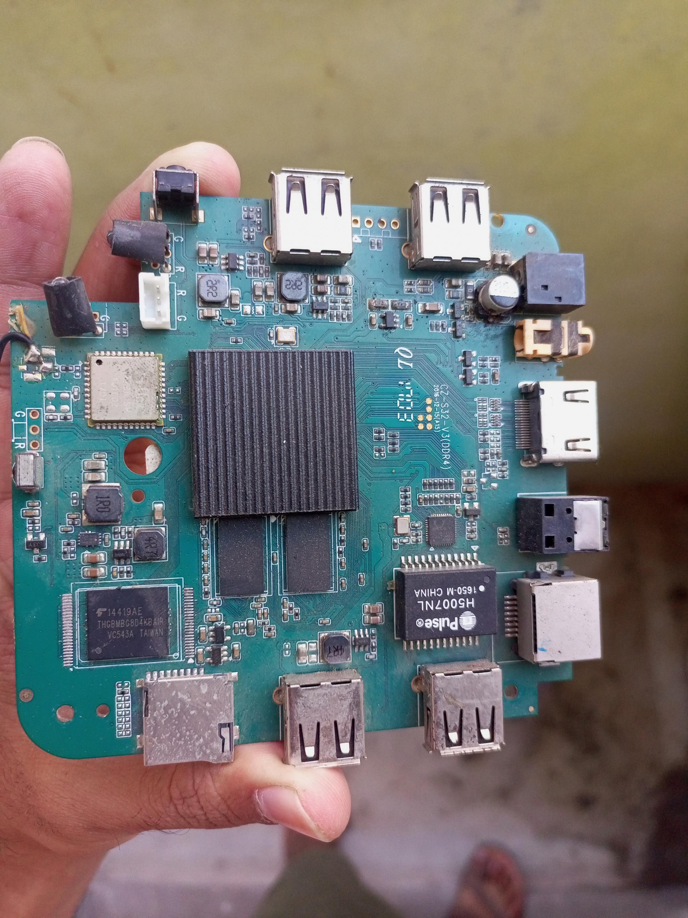

    H96 Pro Plus android TV box only shows blue light
    H96 Pro Plus only shows blue light when connected to charger (tried a few even dc supply 5v), no powered-on and no display. However DC Supply showed 100mA or 110mA usage. any suggestion or clue from fellows will be appreciated.,.regards
    H96 Pro Plus
    CZ-S32-V3 (DDR4)
    2016-12-15(A15)

    Re: H96 Pro Plus only shows blue light
    The 2 amp power supply it comes with is under powered, try a 5 volt 4 amp power supply, also they run hot, so any way to cool them will help, some put holes in the bottom of case and sit them on a small fan, laptop fan would work, need to be careful if putting holes, don't want to puncture anything inside. I would probably try to improve the cheaply done heatsink and or use a fan and maybe take it out of the case and put ventilation holes all over the case, like I did with the cover of my firesticks.
      I see from your picture that you have it out of the case, do you see anything that looks like a reset button?

        Re: H96 Pro Plus android TV box only shows blue light
        To be clear, I would take it out of the case, then put ventilation holes in the case so nothing gets a hole that isn't suppose to.
            Check the resistance to ground of the coils. They are the squareish devices with R2R and 1R0 etc marked on them.
            Is there anything on the underside of the PCB ?
              its firmware.... since the chipset Amlogic.... put it in download mode and flash it.. if it wont go to download mode,,,, on the Nand short pin 6-7 then plug in DC
                Thx
                Coils resistance seems ok
                DC supply was used which was of 3 ampere.
                even tried to flash but stuck on 2%

                  you have open circuit / cut rail of ram /cpu
                    thanks for guidance but sir how can i confirm/test it, as i have no schematic for it.
                      no schematic to Chinese TVs box at all.. the heat sink which cover the CPU not enough to protect the chip from heating.. so it happen an BGA issue under the chip.. and this known issue over Amlogic chips. which as my Box K1 Pro. from first Day i installed Fan 5V to avoid BGA issue.
                        So do you think a reflow will get it going again?
                          75% depend on reflow
