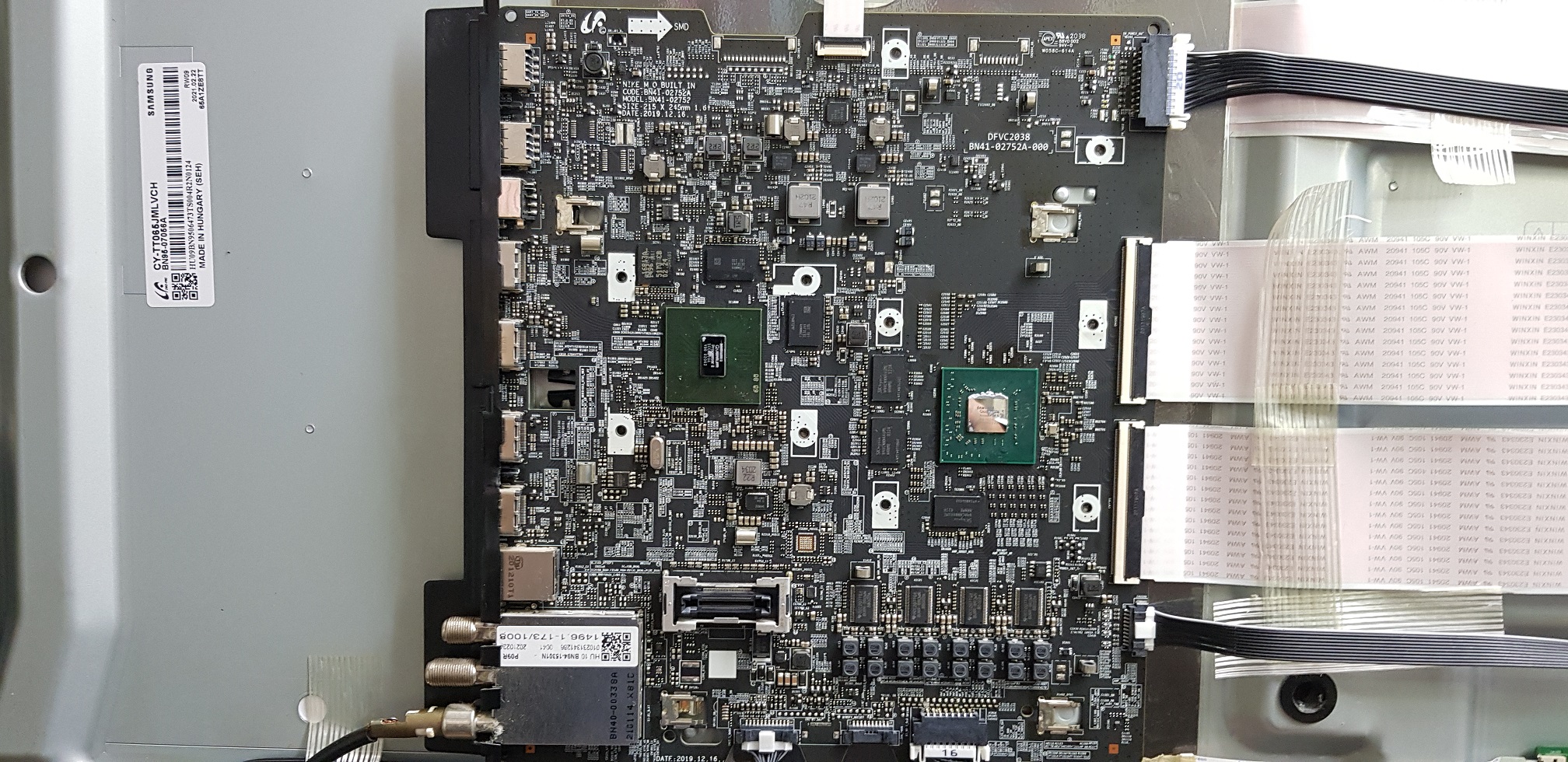

    Defect: Off, voltages on the power supply ok.
    When you press the power button, the TV makes a clicking sound (activates the relay),
    the Power LED continues to remain off.
    The 13 volt voltage on the power supply is ok.
    By disconnecting the cable from the main board to the power supply, the TV backlight turns on.
    I suspect the flaw is the main board, any suggestions are valuable.
    I couldn't find any wiring diagrams online.
    BN44-01068A LED DRIVER BOARD
    BN95-06565A T-CON
    BN41-02752A MAIN AV BOARD BN41-02752A (BN94-15931K) - SAMSUNG
    BN44-01073A Power board
    BN40-00338A BN94-15301NJ TUNER-DTV AIR CABLE
    CY-TT065JMLVCH
    BN95-07056A Samsung LCD/LED-panel

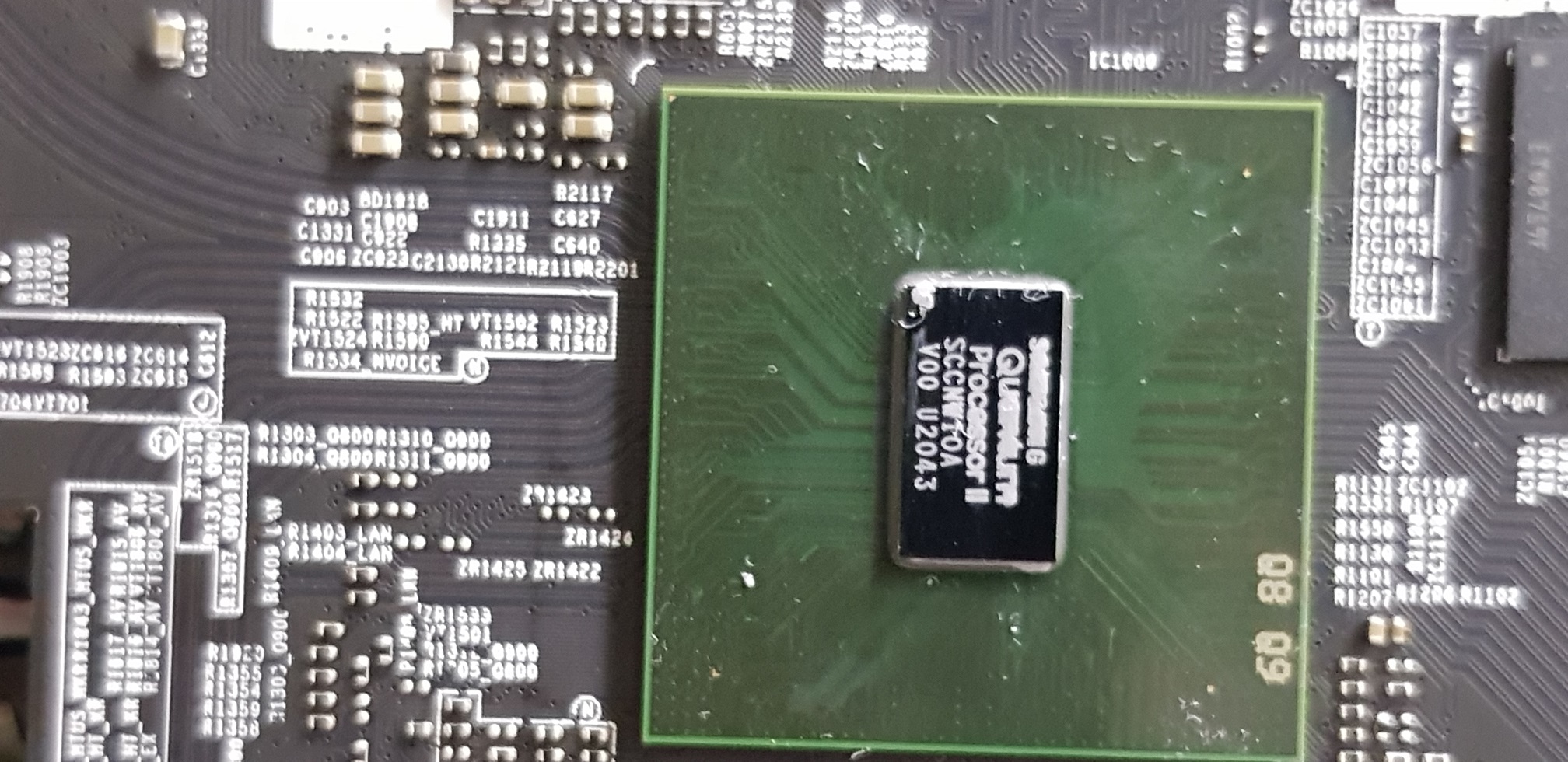

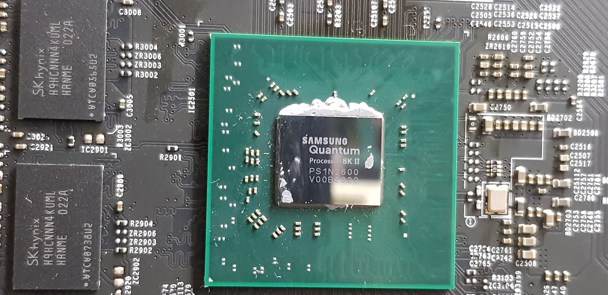

    8K SAMI... kinda of joke ... take out the black heat sink complete and post photos for yours boards up down side photo as well close to SPI and if you able to make dump of it.

      After more detailed checks, the power LED turns on, stays on for about 5 seconds, then turns off and on again. The relay turns on and off, like the power LED, in an infinite loop,
      in all this the backlight remains off.
