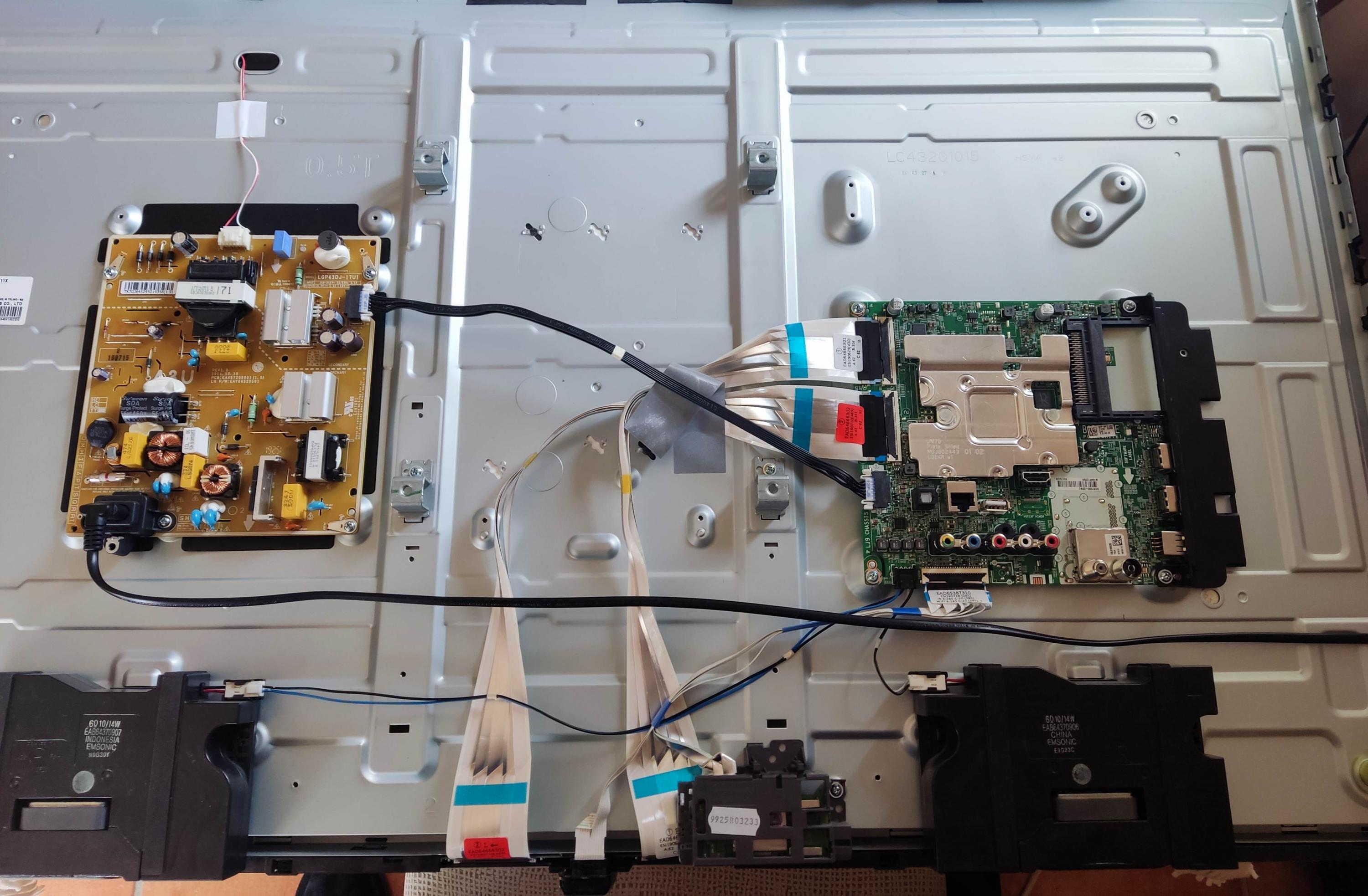

    Hi there! Today I got this TV set . It has stdby_led, responds to remote and internally powers on, backlight powers up and all seems to be OK internally but there's no video signal at all ( I don't mean a "No signal" banner, I mean a black screen)

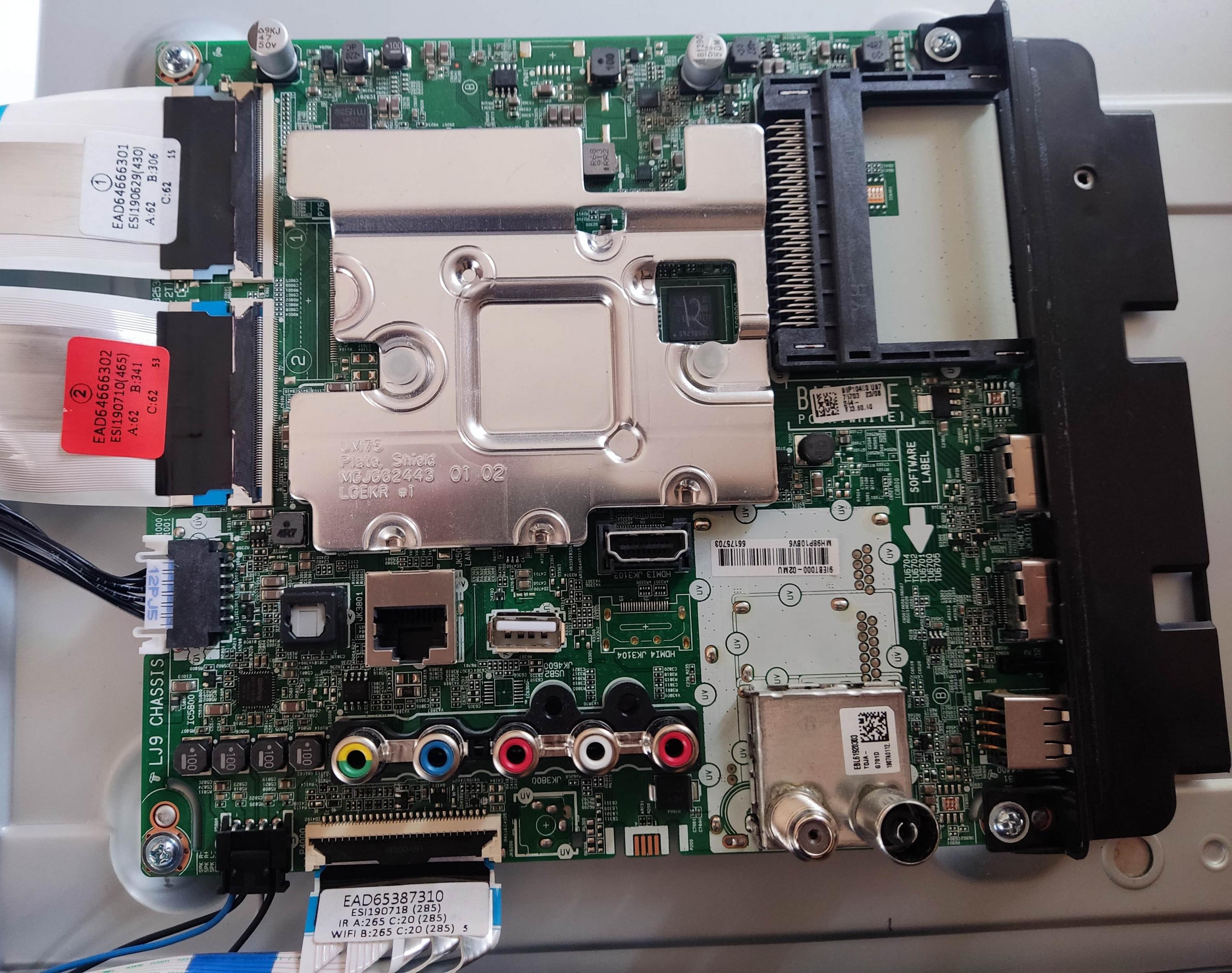

    I opened it and visually found nothing clearly burnt. LVDS cables from main to LCD bars were ok, tried to reseat them but nothing changed

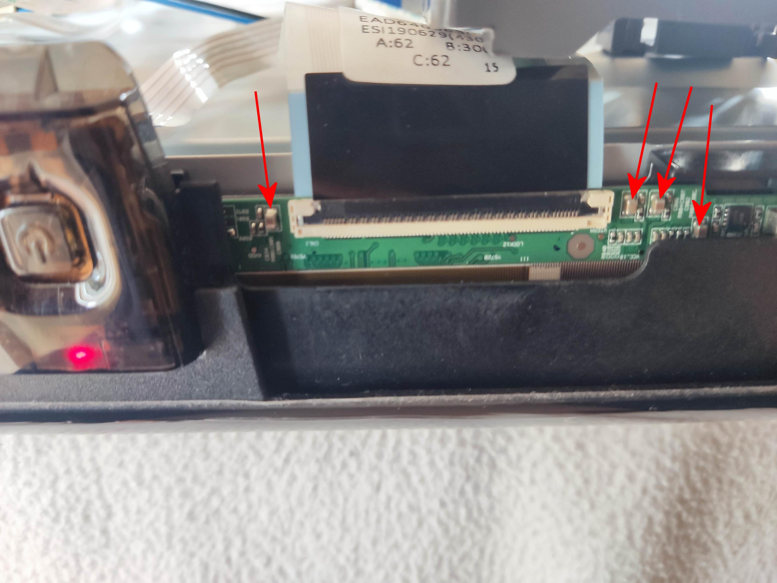

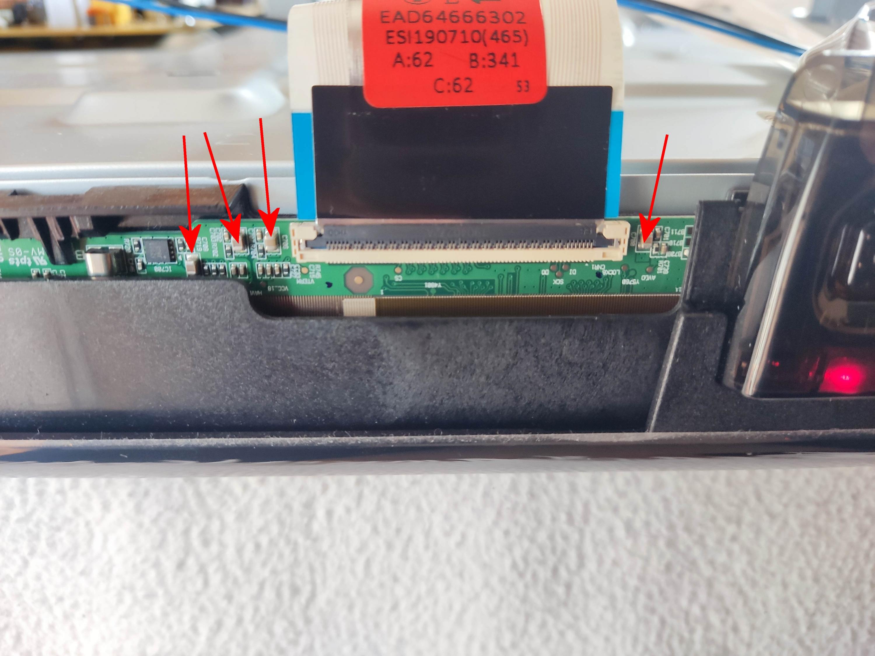

    But I measured voltage on LCD bars (split t-con boards) and going to all capacitors near the lvds cable showed 0.0v. On both sides T-con's. (check attached pictures)
    Is it common that all voltage regulators on both (independent) t-con boards have gone bad at the same time? Should I trace this back to the main board? Any hint on what to try next?

        Can try checking some mainboard voltages, example there, not english but gives the jist: https://www.youtube.com/watch?v=Ab6gMedtAwY
          Re: LG 43UM7100PLB has power, BL and works but with no video
          More there, if you get strange readings maybe recheck with the ribbon cables from mainboard to panel unhooked on mainboard side: https://www.youtube.com/watch?v=Aes6WiG2044

            Ok so I used the normal procedure to determine the source of the issue.
            I removed the right hand LVDS cable and the LH t-con board still had no voltages
            I removed the LH LVDS cable and the RH had correct voltages in their main capacitors (17v, 8,7v, 1.8v). So there was an issue in the LH tcon board
            I checked all SMD capacitor I was able to find in that board but I wasn't able to find one that was shorted.
            Then following directions in one weird video I found, I used scotch tape to cover 13 traces starting from trace 4, couting from the right side of the LVDS cable. I reseated this LVDS cable into the TCON and the LCD is working perfectly (both half sides, with no difference in luminosity, etc)
            I understand this is very strange and there has to be a reason for those signals Im not isolating, but the fact is that this TV is now working thanks to 1 centimeter of scotch tape....
