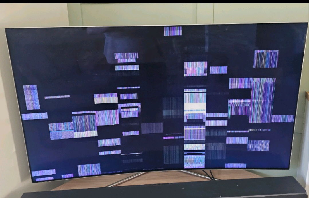

    Quick question please, not much info or pics to go on unfortunately as its not my TV, and I dont have it infront of me, but was wondering if anyone has come across this before, and what the problem possibly could be?
    Samsung QE55Q7CAM
    Owner states after the tv has been on standby for a long period of time, when switched on, it displays scrambled/blocked image as pictured.
    If one connect cable is disconnected and reconnected or power turned off at the main socket it will work fine with no problems until its been left on standby again for a long time.
    Any suggestions greatly appreciated. TIA

    maybe bad OCB cable..

      I was thinking it may be OCB related

        From what i've seen (few) Samsung ocb cables are a modern s*it made for short lifetime, if one touch it for disconnect reconnect maybe it restores connection until it "relaxes"..

          Just wondering if this is ocb fault or panel failure

            I got the TV in the end to investigate any further, so unfortunately I couldnt say what it actually was

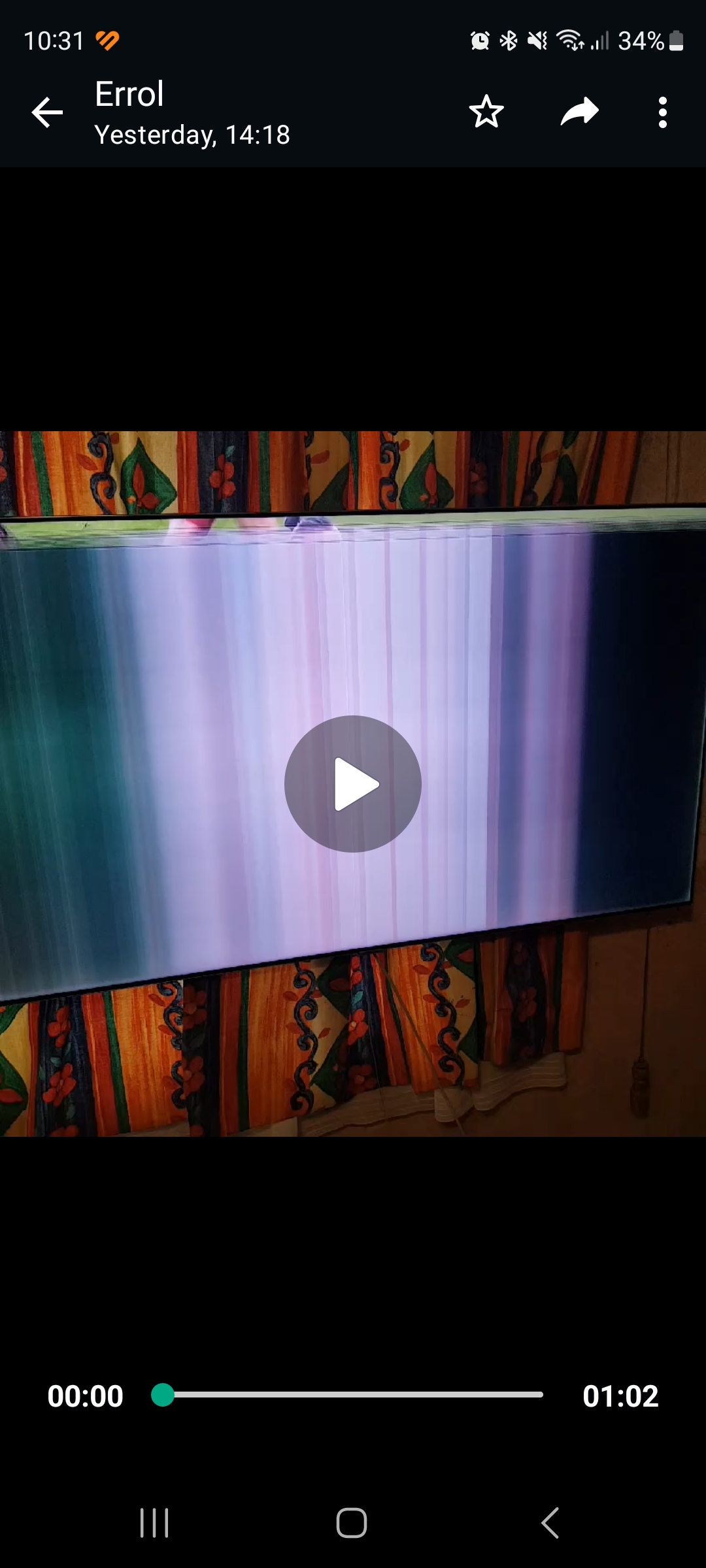

              It's a confusing one to work out the fault https://youtube.com/watch?v=Qk2BWvg7...N0Mn0_KCbR2dft

                the same issue in yours youtube... it was hisense 4k panel with out t-con... solved the problem with panel .bin file friends from hisense Chinese eng. sent it to me
                so u may try firmware

                  Any ideas where I can get the bin file diah
