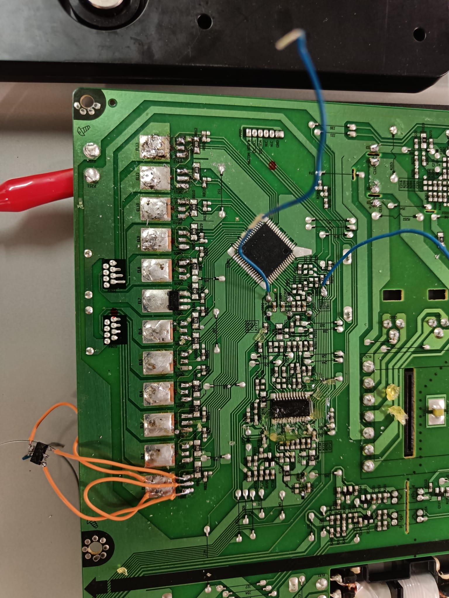

            So i demount the complete tv/panel... And the strange thing is that only 3 of 12 led "areas" go on when i make the stand alone test of the power supply. But the other led areas are good because i told the molsfet and give them ground with a bridge... And they work !! But the mosfets are not switching the gnd when i make the test... Only 3 of them... But voltage on gate it is!!!

              This are the mosfet area on the pwrboard with the led driver, i told all the mosfets, only remains is in place, an one 1 connected with bridges... Thisone in place works... The other not...

                    Hi, i had tested the backlights... They are good!!! But when i plug in the board, (pwron and drvon with 1k resistor on 3,5v) then the board will give me the 12v and 24v. Also the 80v for backlight i get, but only for 3 seconds, the the 80v go out. And only 3 of the mosfets switched the backlights on (3 of 12) all the other mosfet do not switch!! There must be a problem with the led driver ic!

                      Maybe test all the mosfets for shorts, make sure none of the 3 pins shows continuity to the other 2 pins of the mosfet.
