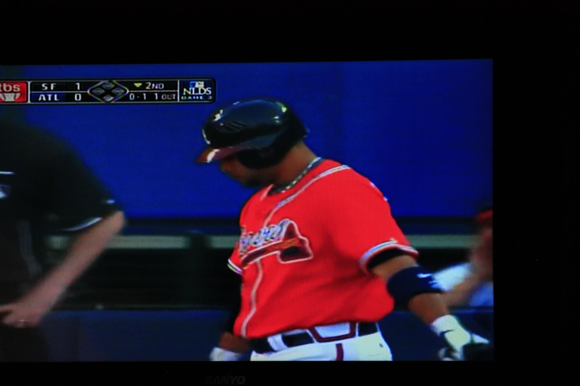

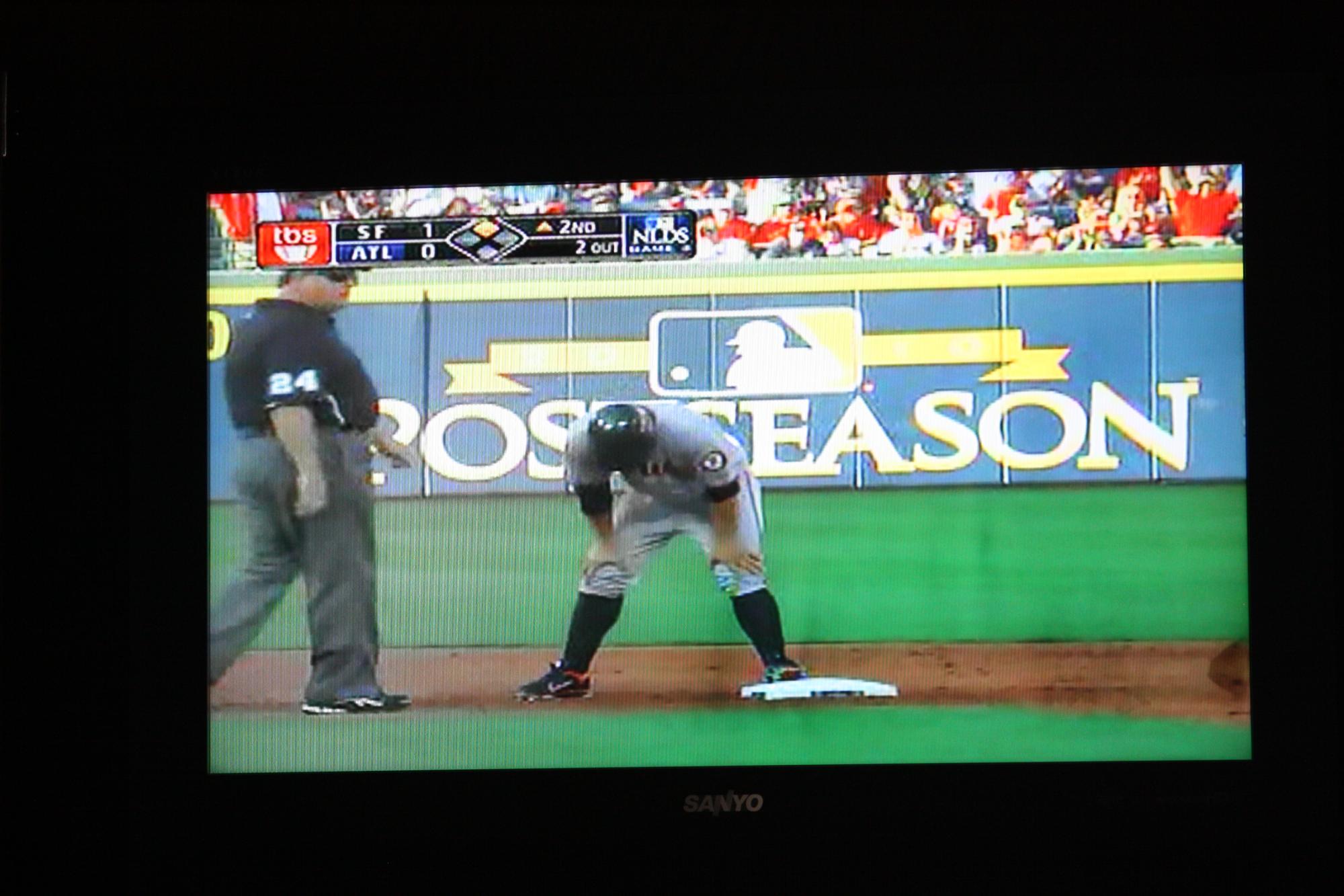

    The 32" TV set has a great picture, most of the time. Ocassionaly there is distortion along the bottom right hand portion of the screen. There are two places I can see it. The first is just above the "SANYO" name on the case. Three dark narrow trianlge shapes appear from the bottom of the screen, spaced 1" apart about 1/3 of the way up the screen. A second bit of distortion, also triangle about 3/4" on each side. It appears at the right lower corner.
    Both are most noteable during football/baseball games (bad news) when green grass is on the bottom of the pix. Don't watchgolf. When other colors are presented there isn't any distortion. At least I didn't note any.
    I will attempt to add pix, but this is the first try and I'm nogt real computer literate.
    Thanks for any and all ideas!
    OkanoganEd (Retired)
    PS Three pics will follow.

    Here are the pics.

      you mean the darker lump over in the right near the bottom? i cant see it anywhere else?

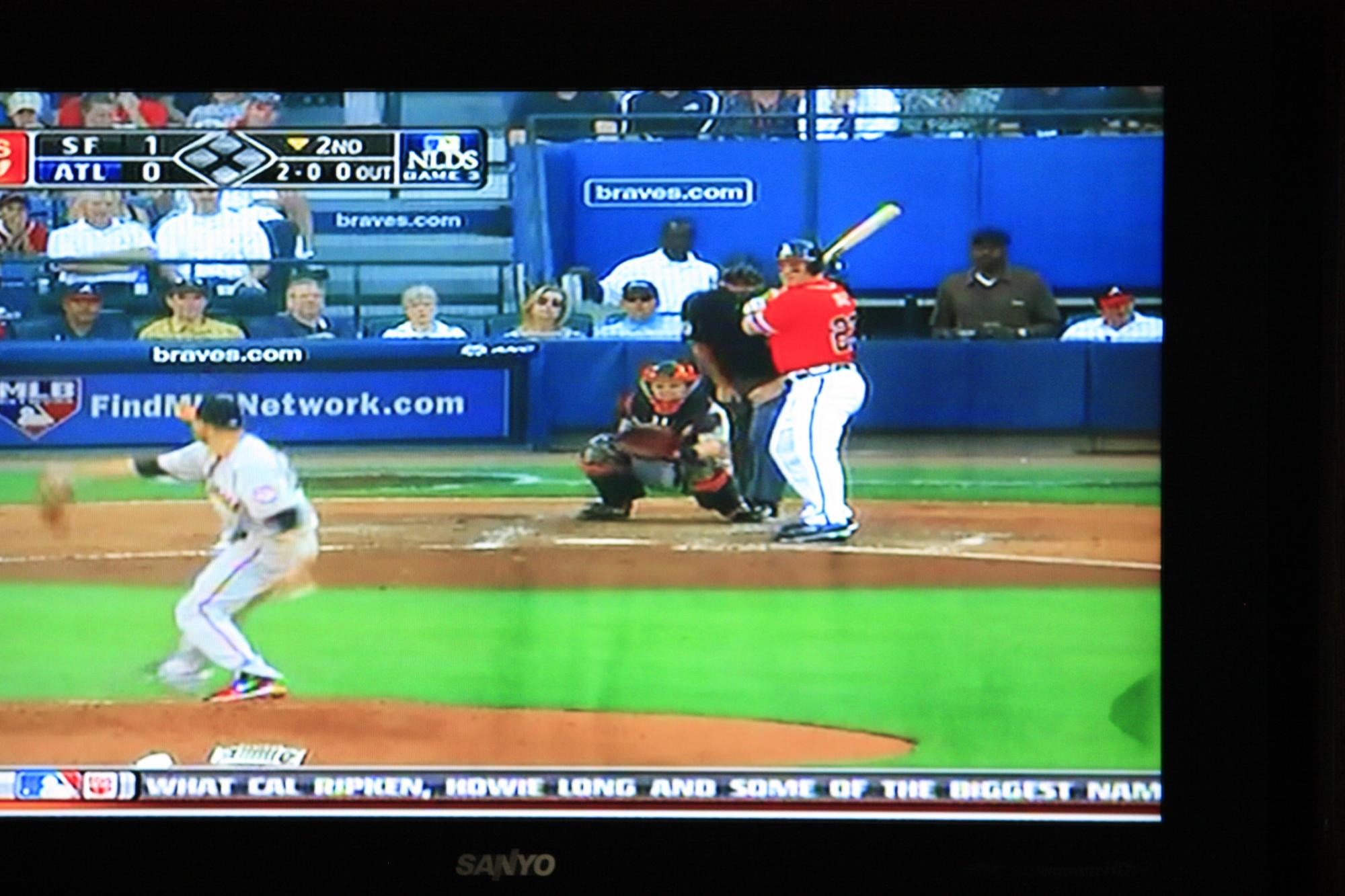

        Yes, the triangle shape in the lower right corner on the first and second pix is ;one of the distortions. Can be seen when greens and browns present.
        The other is in the center of the 2nd pic is are several faint dark lines, three during the last ball game.
        The right pic is an example of the screen when brighter colors like reds, whites and yellows are present. This screen looks normal to me.
        Thanks for the response, any ideas??
        Ed

          The triangular mark is present in all pictures, it's just a little less obvious in the last picture. I'd say 'bruise marks', caused by pressure on the screen.

            Is a "pressure bruise" typical for LCDs? DO you know if bruises develope over time? I don't recall seeing it when we received the set 4 years ago. It hasn't been moved around for over two years.
            Any thoughts about the verticle distortion in the middle of the scree above the Sanyo logo??

              Bruises are caused by pressure on the screen permanently distorting the plastic. Bumping the screen with an elbow is one way. Dragging a toy down the screen is another way. (Obviously this wasn't done by YOUR children.) For some reason they are very sensitive to the background color. Some are almost invisible against certain colors and glaringly obvious with other colors.
              I'm not aware of any fix, other than by replacing the LCD panel.
