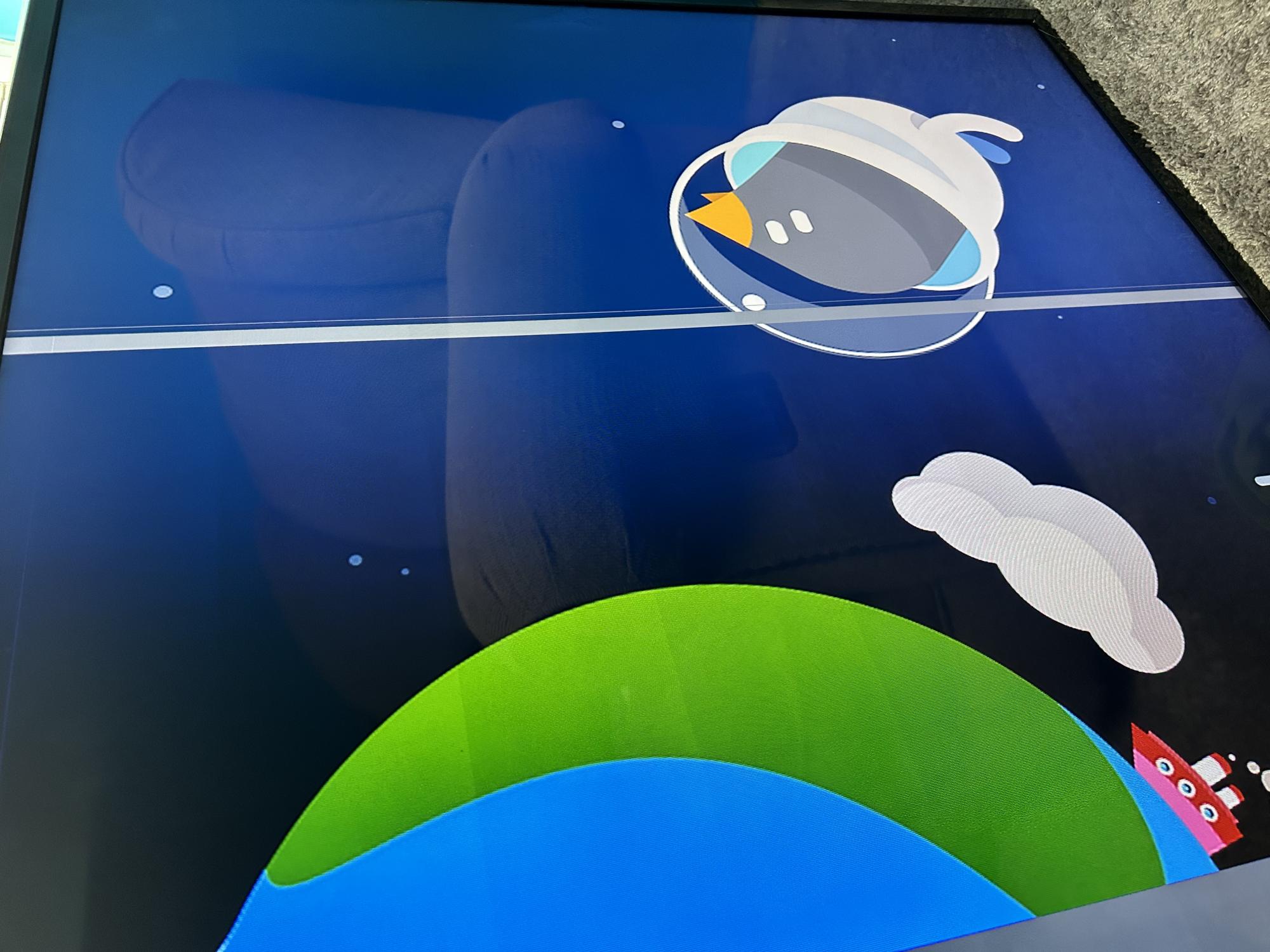

    lg 65uh5500
    Does this line mean the tv has a bad panel ?
    I've tried swapping ribbon cables and pressing on the ribbon cables that are glued to the circuit board with no change
  • Storyteller12
    • Jun 2020
    • 625
    Re: lg 65uh5500
    Yes. Most likely
