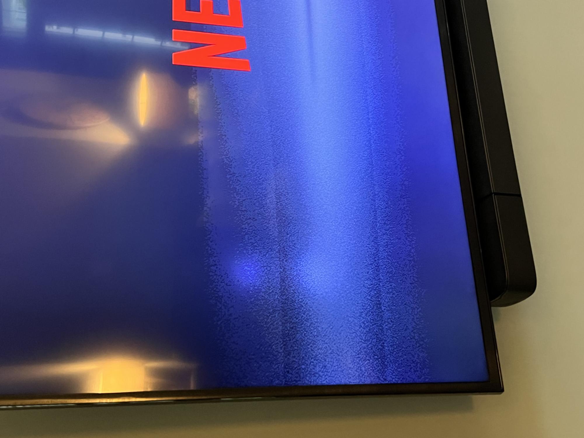

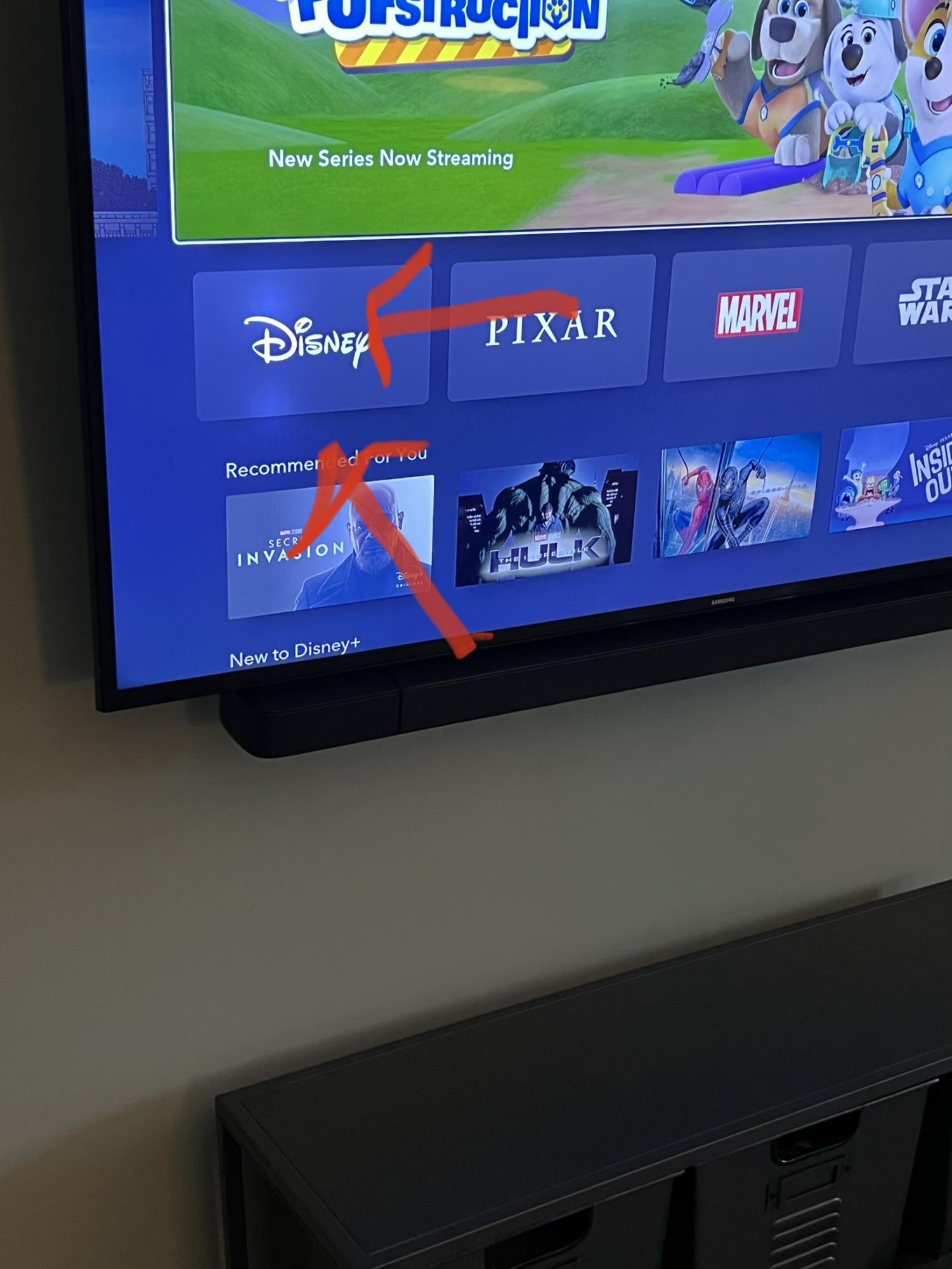

    Samsung Un65ku6300fxza light spots
    I have a Samsung 65in 4k tv with 2 light spots that I am wondering if anyone can help me with the cause of them. One has been visible for a while but I just had a 2nd spot start recently. I am thinking some sort of LED or LED lense/reflector issue. They look to light to be pixel problems but I guess that could be it also. Everyone on here has always been great at helping an amateur like me repair tv's so figured I would start here to see if anyone has an idea of what it might be.
  • Storyteller12
    • Jun 2020
    • 624
    Re: Samsung Un65ku6300fxza light spots
    The led reflectors fell off. Have to open it up and glue them back on. Or order new light strips

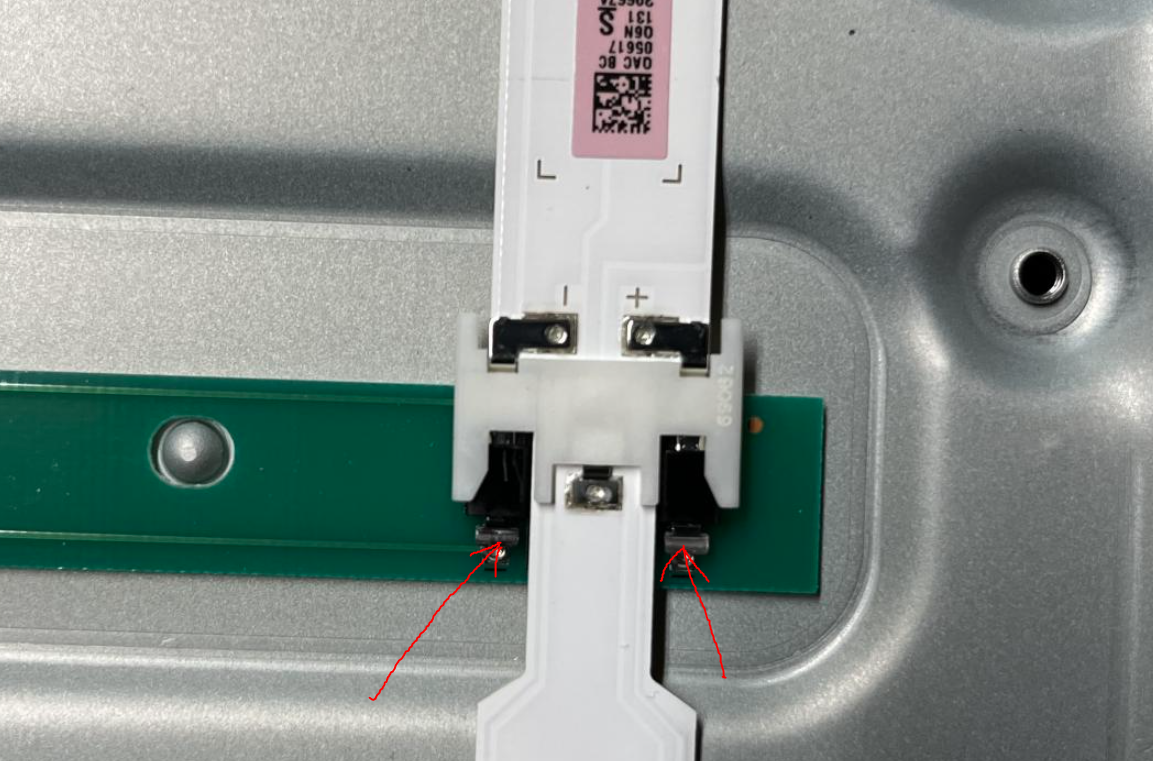

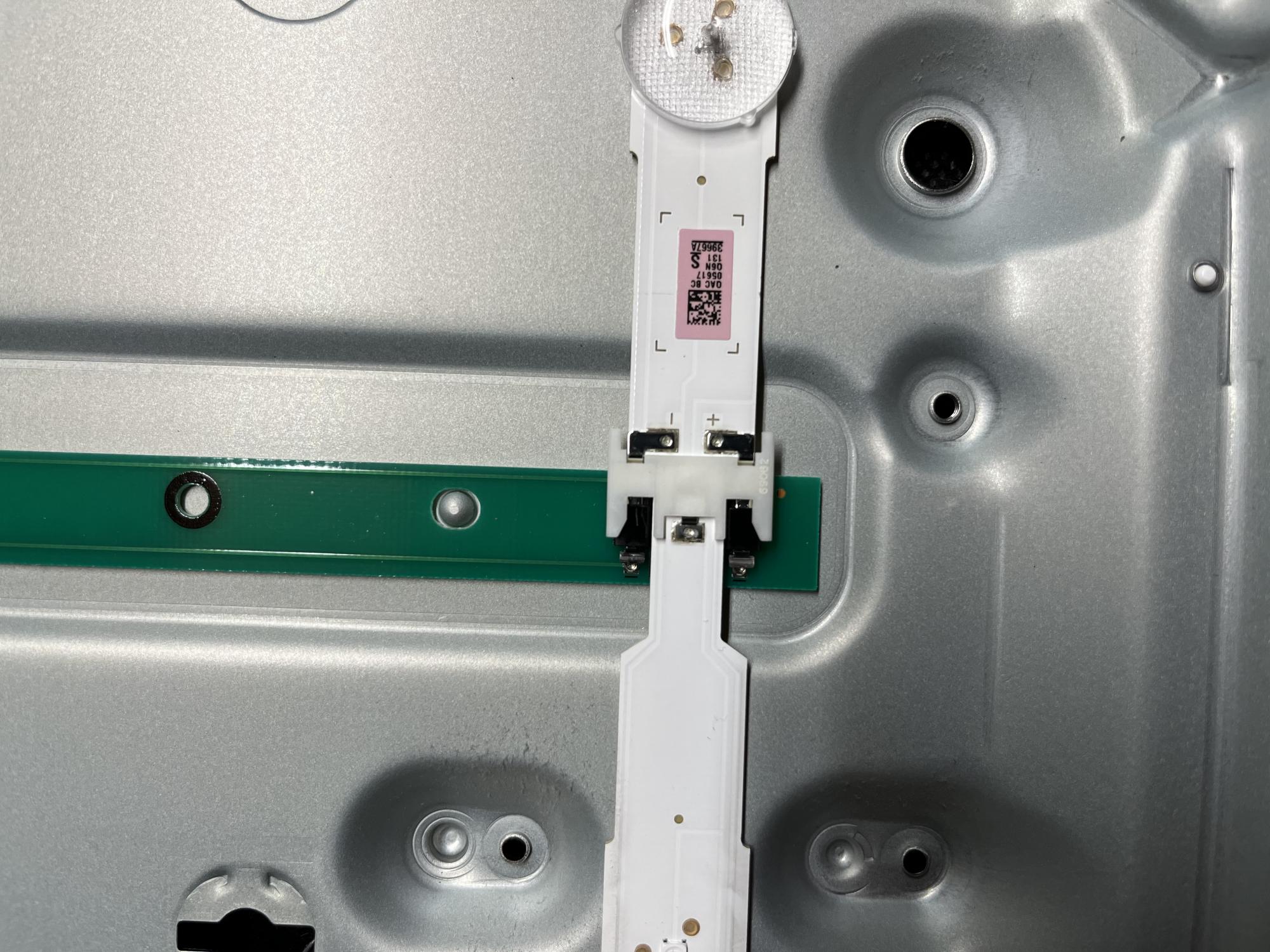

      So the LED reflectors is the issue. I am finally getting around to fixing this TV. Does anyone know how to get these LED connectors off? Having a heck of a time and don't want to break it.
      • lotas
        • Jan 2016
        • 4599
        • Russia
        Press simultaneously on these latches and carefully pull out the bar.
        • dhoff024
          • Mar 2013
          • 96
          Thank you for the help! Got them off and TV is back to functioning like it should.
