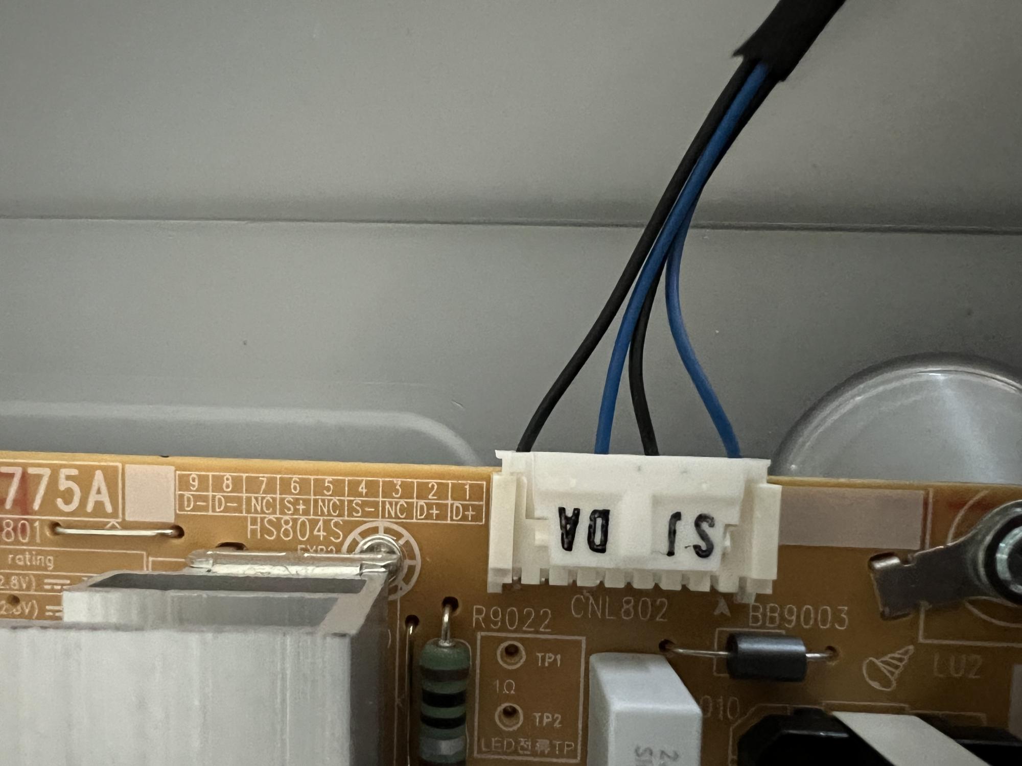

    I then measured at the LED connector CNL802:
    D+ to D - = 419 VDC
    All the other connections on the LED plug to ground show 0 VDC on the connector.

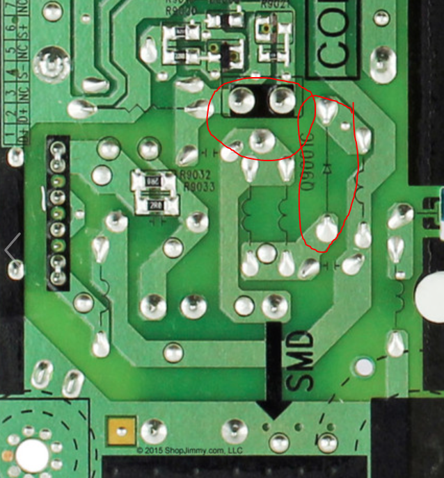

    When I check voltage to the LEDs with out connector connected it is showing 419VDC+ volts first pin (D+, picture attached) to ground and 0VDC to the rest of the connections to ground. The same happens when I plug in the LED connector and also when I unplug it.
    Any help would be greatly appreciated.

    Re: Samsung TV UN60J6200AF No Display + No LED
    You need to measure the voltage at +D relative to -D, not GND. You should have under load (with connected LEDs) 325V.
      Thanks for your reply.
      I have 419V between D- and D+, when the LEDs are connected.

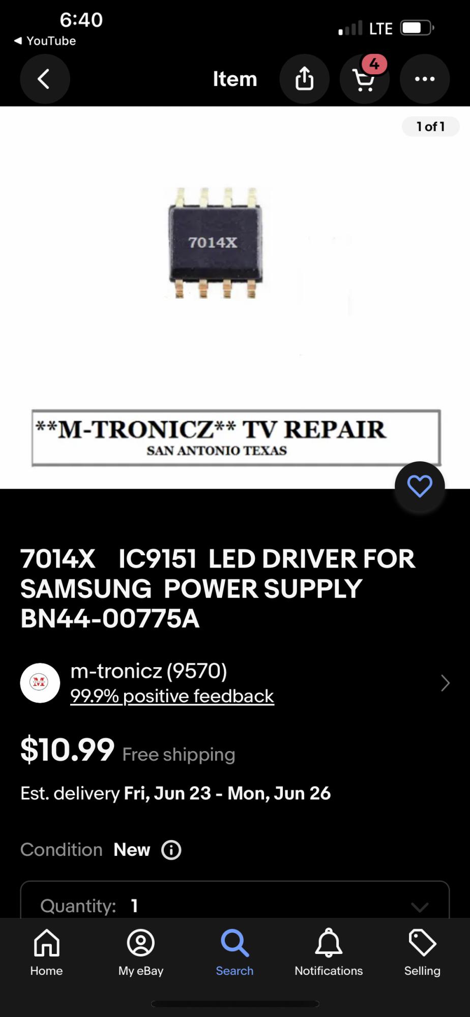

      The voltage is high, is there anyway to check if the IC driver is the problem?
        I found the IC on eBay, but I can't find any data sheet on it

          Check the transistor and diode for a short circuit.
            There is no datasheet for this chip (Samsung engineers like to keep their information secret,
            however, there is information that the MAP3511 is an approximate analogue of this microcircuit.
              Thank you for your suggestion.
              I had already checked the transistor and diode, neither is shorted both seem good.
                Thank you for the help.
                I'll try to check for any obvious anomalies on my IC.
