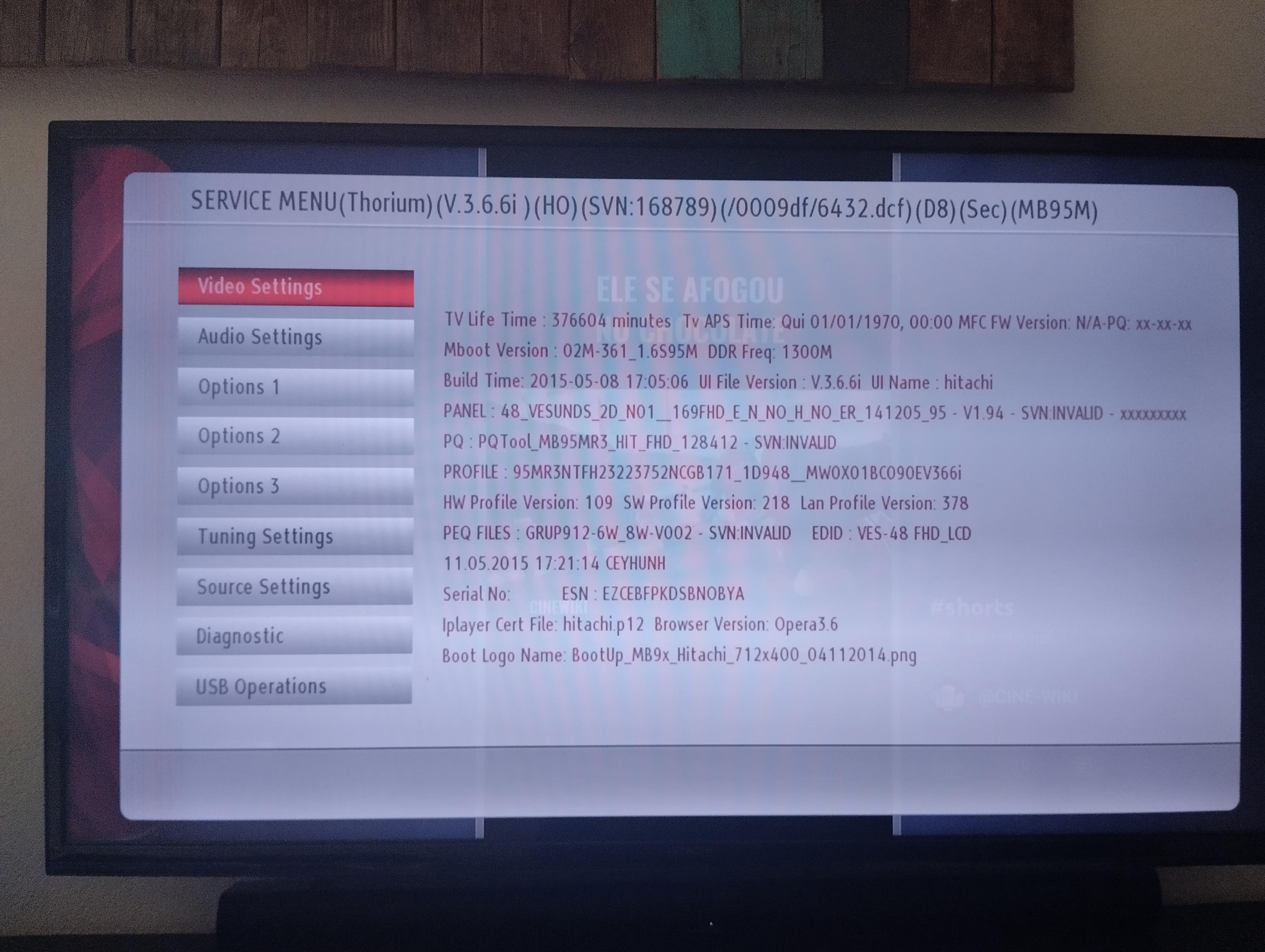

    Hi does someone knows how can i upgrade my firmware on this tv.
    I lost the ability to use netflix and youtube,it
    Needs to be updated but it says there are no updates...
    Thanks edgar

    What motherboard does it have? Type MENU 4725 and put the picture here.

        Re: Hitachi 48hbt62u update firmware
        On the remote control, press the MENU key followed by the sequence 4725. A service menu appears on the screen. Take a picture and post it here.
          Here it is
            17mb95 motherboards are very old. Any software update does not bring significant improvements. Neither Netflix nor YouTube will work. In addition, a small software error can permanently compromise the motherboard. I do not recommend you to update.
              Ok many thanks, i also think that there is no need to risk damage the tv,its working good exept for the unability to use netflix.
              I can live with that.
              Many thanks man !

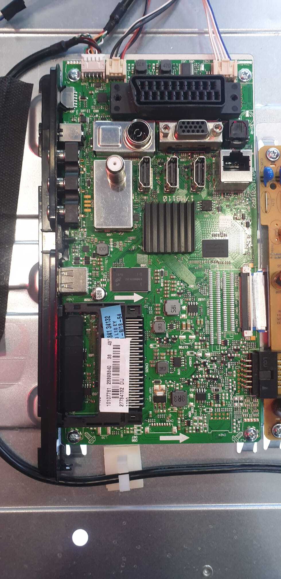

                buongiorno a tutti qualcuno mi puo' aiutare a farmi avere il firmware della flash di questo tv?? grazie mille hitachi 43HB6W621
                  1. What's wrong with the TV?
                  2. For programmer or stick ?
                  3. Cod panel (ves430xxxx-xx-xx) ?

                    programmatore il tv mostra dei canali in conflitto e poi si riavvia

                      mi serve il file del firmware
                        For the stick. Try at your own risk.
                        https://files.fm/u/kpye3f2ge6
