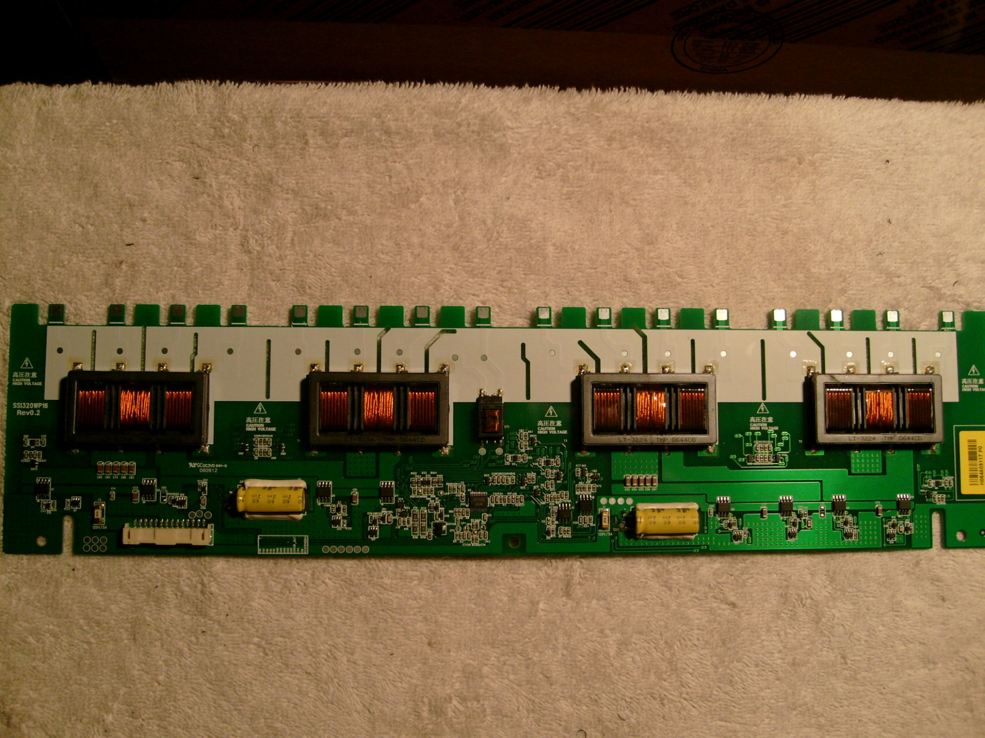

              Re: Samsung LN-S3251D Black Screen
              Okay.... here are the pics.
              If you need more detail, I will have to redo them as left/right since the board is fairly long.
              The first five pins (ribbon conn.) from the left are showing 24V from the PS.
              Starting with the first pair of pins on the far left, the secondary side of the inverter transformers are showing 1.5 ohms on all 8 pair without variance.
                No they aren't. They might be reading 1.5K ohms, but there is no way the secondaries could be reading 1.5 ohms. Recheck them to the full accuracy of your DMM.
                What is the part number of the 20 pin IC in the center of the board?
                PlainBill
                  Oops.....
                  Make that 1.5k ohms on the secondary outputs.
                  The 20-pin IC is a BD9882.

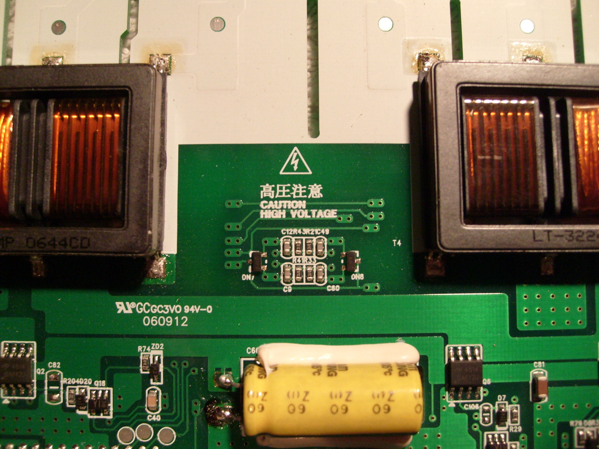

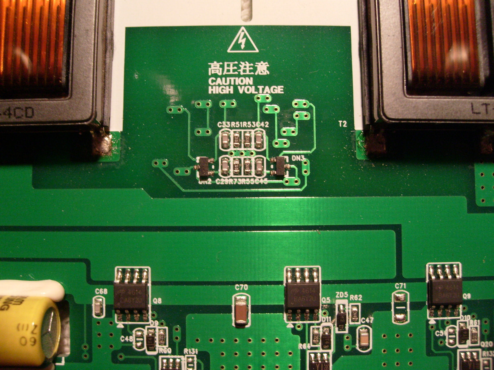

                                    How about these....
                                    Good grief, how much AC voltage do those puppies output?
                                    My Fluke will handle up to 750.
                                      How about these....
                                      Those pictures will do. What is the value of the resistors?
                                      I looked over the schematic, and there is a LOT going on in that circuit. It's going to take a little research. No, that's not true - it's going to take a LOT of research!
                                      In the meantime, I've got a full day of watching football games scheduled for tomorrow. Enjoy my day off.
                                      PlainBill
                                        The resistor values vary from 9.75k to 10k ohms.
                                        Agreed, this board is busy.
                                        It never ceases to amaze me how one can take something that should be simple and complicate it beyond reason.
                                        In the meantime, I will further study the schematic as well as take a few voltage readings to see if I can isolate the problem.
                                        Enjoy the games.
