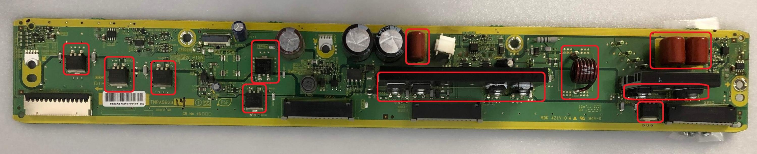

                        Re: Panasonic TC-P50U50 Powers Off - 8 blinks
                        The replacement you did was not necessary since that is for when the DG302 blows up and burn the resistor + their gate driver and the RF diode next to it.
                        There may be fake DG302 in the market as for every common IGBT used in plasmas (most famous fake parts are toshiba, fairchild and renesas).
                        I circled on the SS board image points of interest, all the important diodes and transistors, plus TPVe testpoint (voltage generated by SS board), it must match the service manual specified voltage, and those capacitors + the big inductor can develop bad soldering joints as aging occours.

                          I have replacement 5.6 ohm SMD resistors (R041 and R051), but then I just noticed the ones I bought are physically too small! I could probably be creative in using a blob of solder to jumper it together. A little tough getting the right size because I got these off Aliexpress and seemingly none of the sellers list out the dimensions!
                          In the meantime, I powered on the TV with SS33 disconnected and TPVe tested 170V as per the service manual. Those other transistors I tested in-situ and they don't seem to have any abnormal shorts. I also attempted to do the typical gate/drain/source test using the diode function but it doesn't seem to work on ANY of them. I'm guessing it may be the way it's mounted to the board and/or being interfered with other components? Not sure if I'm doing something wrong but it's fishy that I was not able to test ANY of them properly. I've done the transistor test a dozen times before and I also made sure to look at the pinout from the appropriate datasheets.

                            Just replaced the 5.6 ohm resistors. No luck, still the same problem. Pretty darn close to just giving up on this SS board now.
