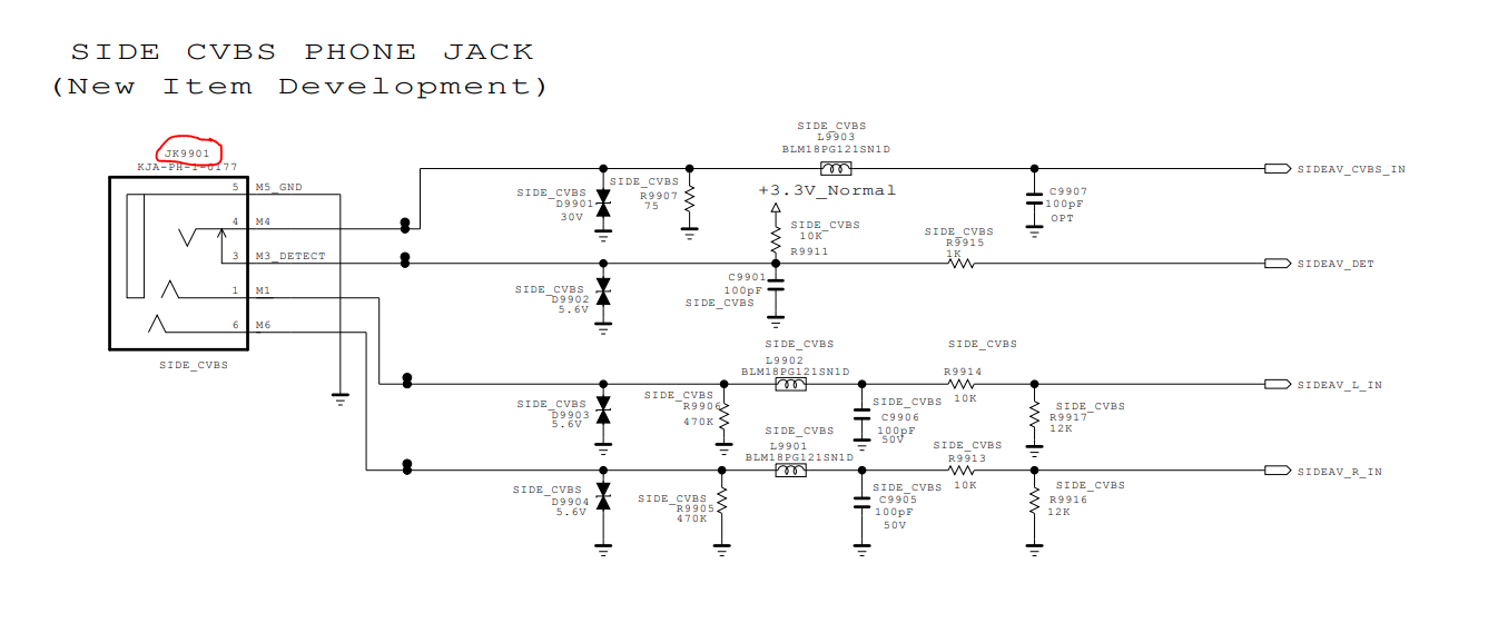

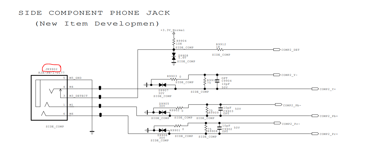

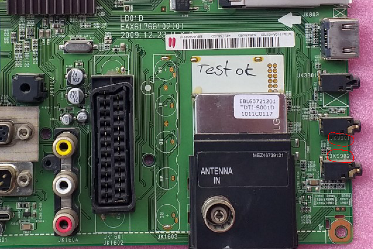

                      Re: Pinout of LG 4 pole 3.5 mm component video cables?
                      Have you tried using the sleeve as ground and the tip as green (as provided in your 1st post link)?, This should give a B&W picture if it works, then you can connect the blue and red
                      The jack I provided in #9 was from the 42le530n (LD01D chassis) service manual

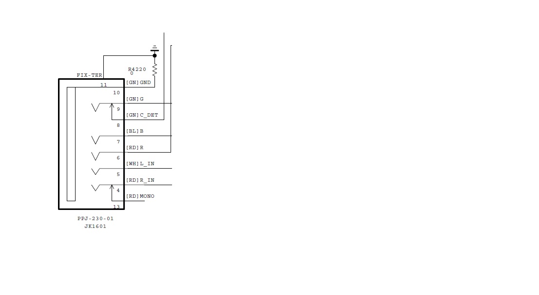

                      • lotas
                        • Jan 2016
                        • 4881
                        • Russia
                        Pinout
                          No but I did now, and yes, that was correct. I didn't think of just trying green, thanks! Otherwise, the prospect of manually holding RCAs tips to sleeves and keeping track of it all wasn't very appealing
                          Originally posted by lotas
                          Pinout
                          Thank you very much for taking the trouble! More than I could've asked for.
                          Now I won't have to second-guess whether the manual is in fact correct (it is NOT — the jack labels are correct), whether the two jacks are are 3, 4 or 5(?) poles, and which is Pb and which is Pr.
                          For the next person:
                          Both jacks are 4 pole. Component plug (as T,R,R,S) is: Y, Pb, Pr, GND. Audio in is shared with composite in which is V, L, R, GND, meaning that you're required to get another 4 pole adapter just to connect stereo audio. Awkward design.
