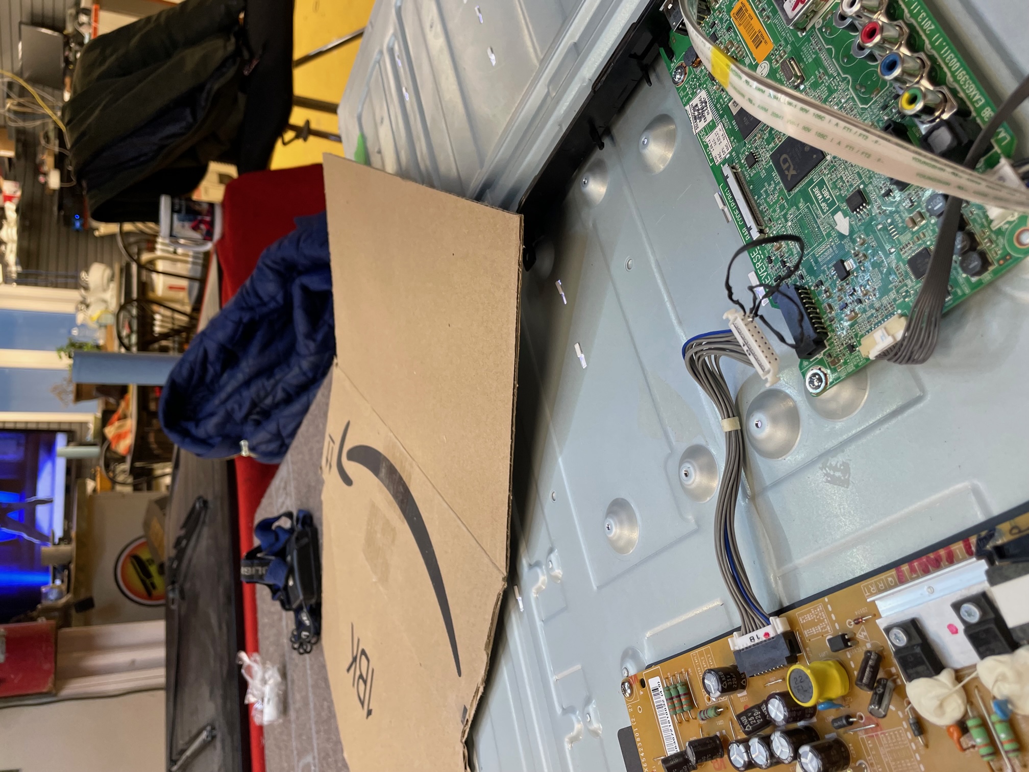

    I have this unit lg 55lf6000 with 2 issues.The first was faulty lamps ...problem 1 solved.Problem 2 is as goon as unit plugged in get the sold red light on front and pressing power does nothing.I shorted vcc 3.5 vdc and pwr and drv-on to ground on power supply and lamps fire up so thats good.On the module eax65391003 i see the optical lamp is on i trace the voltages as far as i could to no avail.Anyone has and success with this issue?

    sounds like a mainboard issue.

      Yes definitely a main board looks like main chip has failure due to bad bga soldering.

        Hit it with a hairdryer for a few minutes, then see if it comes on for a bit.

          Will do thanks

            No luck applied heat to no avail ,have to order board.

              No bad soldering in this case!! Use immagination.. bad lamps means overvoltage , then also overvoltage to the main board! check the standby software memory first.. is there a spi flash? rewrite it..
