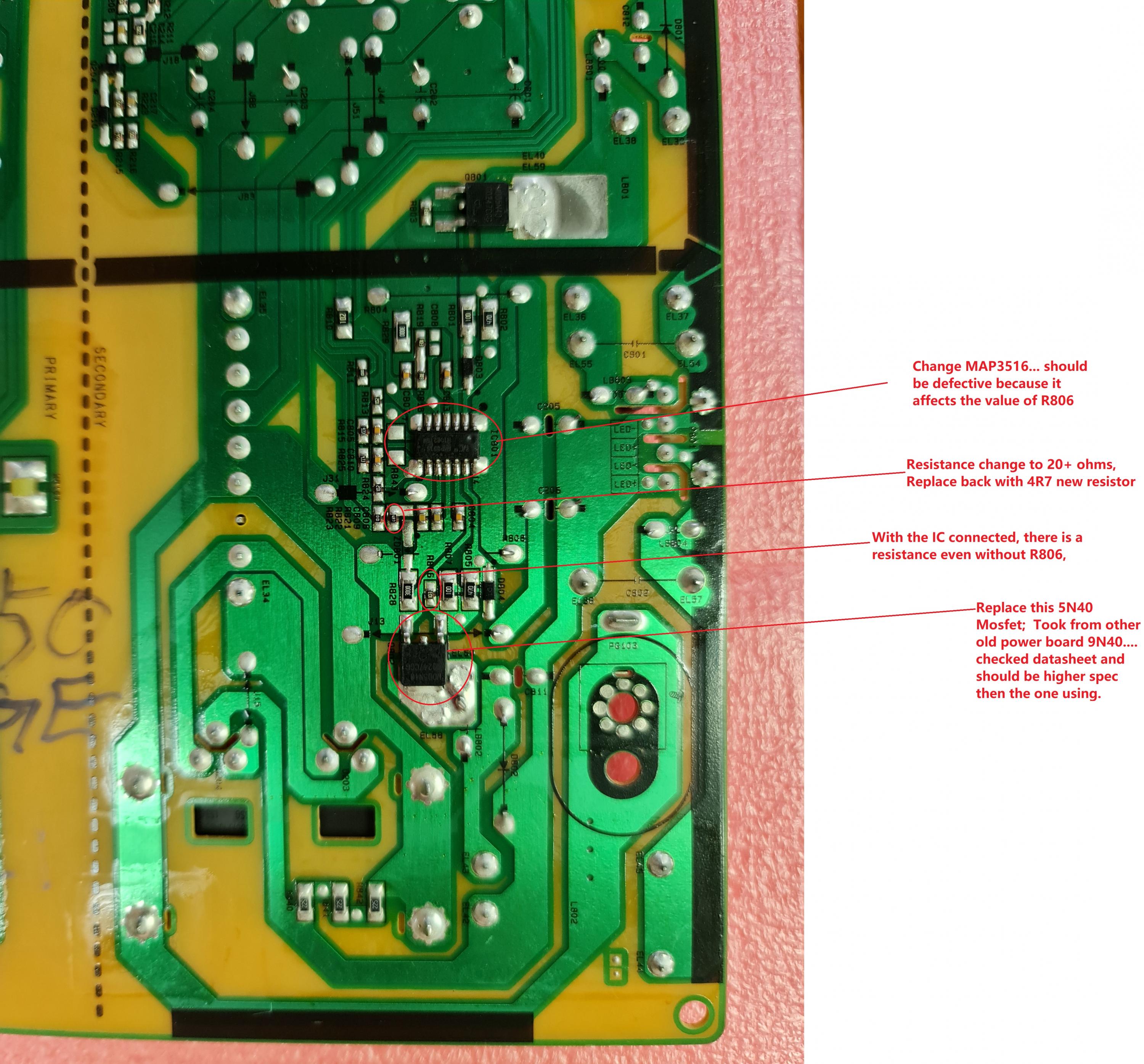

          Re: LG55UH615T pulsating Redstanby LED
          Originally posted by lotas
          Throw the wires on the cable, and you will find out where the problem is in the power supply or in the LED bar.
          I'll try Dav.P method to check the MOSFET and IC (I did purchase this IC 801 from Ebay but yet to arrive)
          Nothing can get worse, any suggestion to nail the problem are welcome....Only last resort yo get another PS board.
              IC 801 = MAP3516
              I try searching for Datasheet... not available.
              I can only assume this is a 2CH LED Backlight controller chip.
                when you buy new ic801 buy n.2 because i think is bad also in your original board
                  Thanks Davi.p
                  You have nailed the problem.
                  Ironically, I repaired the original board instead of the one I purchased. I use the purchased (faulty board) and did some comparison.
                  So the problem of my original board is as follows:
                  1. IC 801 faulty ...... internal circuit issue and it also affects the reading of R806 (10K)
                  2. R822 4R7 value increased
                  3. While trying to unsolder the MOSFET Q802 5N40, one of the lead drop off , so I cant say if this MOSFET is good or bad....Anyway I don't have this part but replace it with 9N40 which is better spec then the one used.
                  Replace IC, 2 resistor , 1 MOSFET .... Power Up standalone and no smoke before connecting back to the TV..
                  All back to normal!!!!
                  Anyway I didn't bother to repair the CN board.... probably is the same problem as you mentioned.... IC801
                  Closing this thread.... For those who have same problem, can use this as a troubleshooting reference.
                  Thanks All who have chipped in for this troubleshooting.

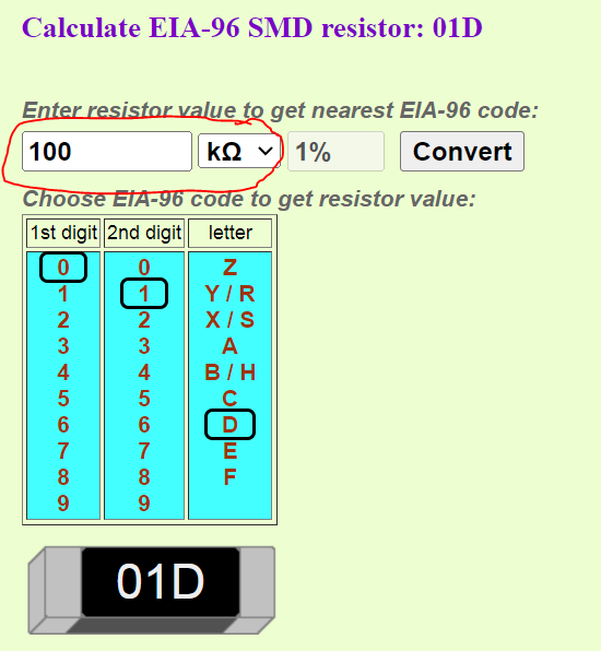

                      Hello
                      Plese do you confirme that the resistor next to the 4r7 the 010 is 1 ohm resistor I get 100k value. ????
                      • lotas
                        • Jan 2016
                        • 4503
                        • Russia
                        #31
                        Originally posted by estrumpf
                        Hello
                        01D - 100 kOm
