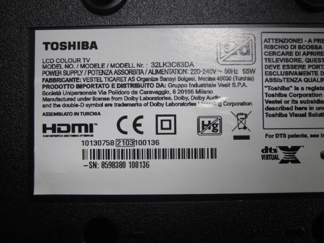

    Toshiba 32lk3c63da

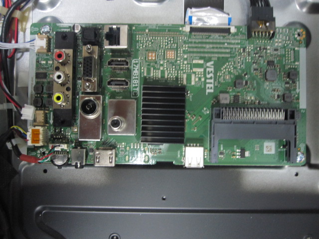

    Brand and model: TOSHIBA
    Serial number: 8598380 100136
    Chassis: 17MB181TC
    Main Board: 17MB181TC
    Panel / Matrix: VES315UNGH-L3-N41
    T-Con: Built-in on the panel
    Power supply: 17IPS62
    After logo it reboots.I need a recovery file.Can anyone help.
    Since I did not find a suitable file, I installed 17 MB 171, everything worked, but when starting there is a HITACHI logo.
    The question for this board is how to disable the logo. I was unable to download the profi files in the standard way. Can anyone help with the procedure.

    It is possible if you can save the TV profile on the stick. Create a folder called downloadprofile.mb171 on the stick. With the mention that I don't know what software you installed (correctly it should have been mb181). Turn on the TV and type MENU 4725. Go to USB Options and then type OK. Exit the menu and remove the stick. The TV profile will be saved on the stick. Post here to edit. The hwprofile and swprofile files are interesting.

      As I already wrote, it does not work this way. YES, I specify: 17mb181 recovery file is needed
      17mb171 I have not installed software. It was taken from Hitachi. The panel responds, the picture is good, but at startup there is a Hitachi logo. I want to disable the logo, but the procedure for copying the profile file is different and I do not know it. It does not work in the standard way .This is a chassis android and needs another procedure

              Unfortunately I don't have a recovery file for board 17mb181tc and I don't know how to download profi files for board 17mb171
              This combination does not help. This is an android chassis, not like the others on Vestel

                  I have this file, in order for the TV to be updated, it must work. It doesn't work with menu 1505, and you can't enter the service menu on board 17mb181tc, because it can't load android and the remote doesn't work. I haven't tried just renaming the file, but tomorrow I will try. For board 17mb171 I don't know how to download profile files. And board 17mb171 is android

                      I'm aware of the risk of damaging the board, that's why I'm looking for a way to download the 17mb171 pro files and disable hitachi logo. With a 17mb181ts board I can afford to do experiments.

                        Hello, can anyone tell me how to download the pro files on this chassis

                              Thanks, but the TV can't load android and accordingly it doesn't work. And upgrade_no_tvcertificate.pkg, I need this for a toshiba TV. Or how to copy the profile files from chassis 17mb171

                                32LA3B63DG 10128764 28502661 TOSHIBA
                                The same device is just different mainboard 17MB171
                                https://www.file-upload.net/download...10210.zip.html

                                    Many thanks, everything fell into place
