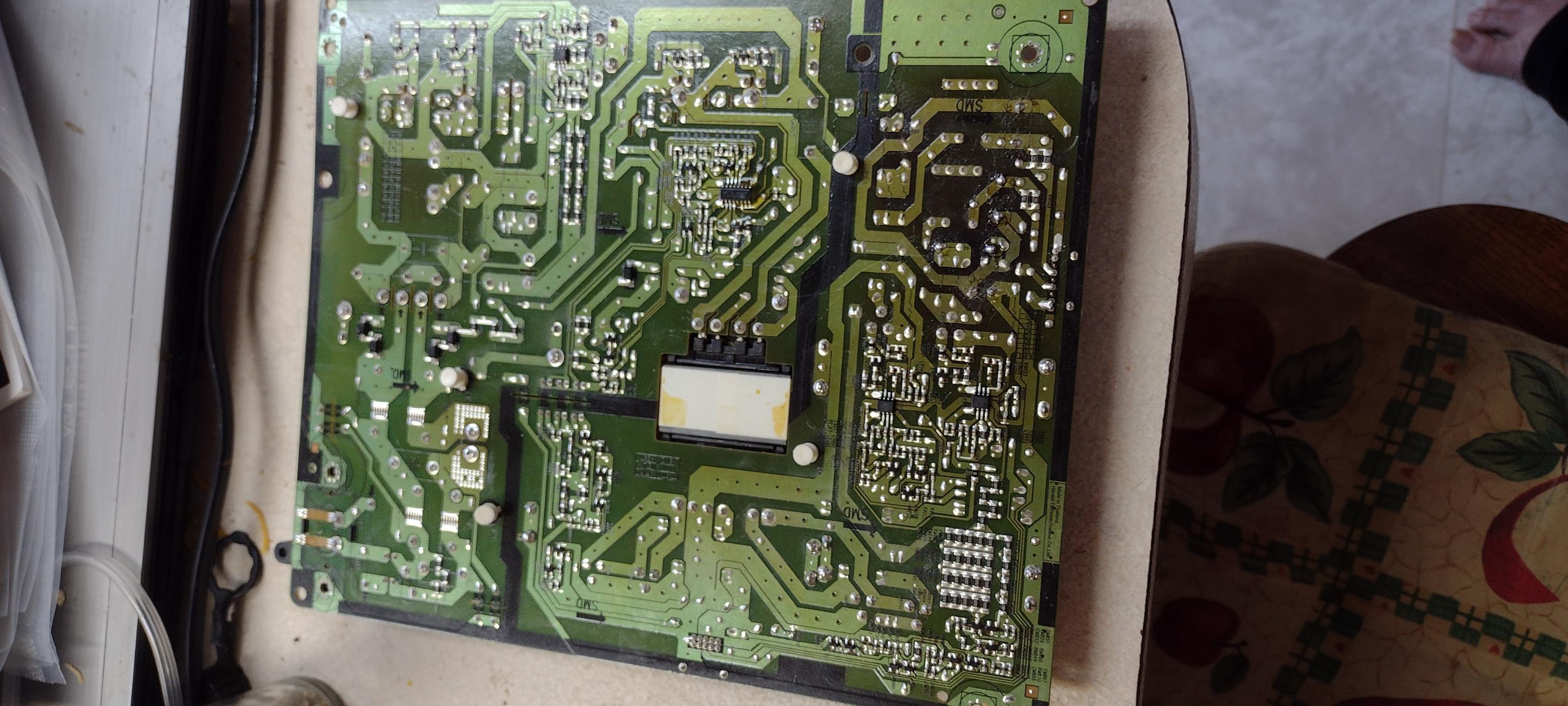

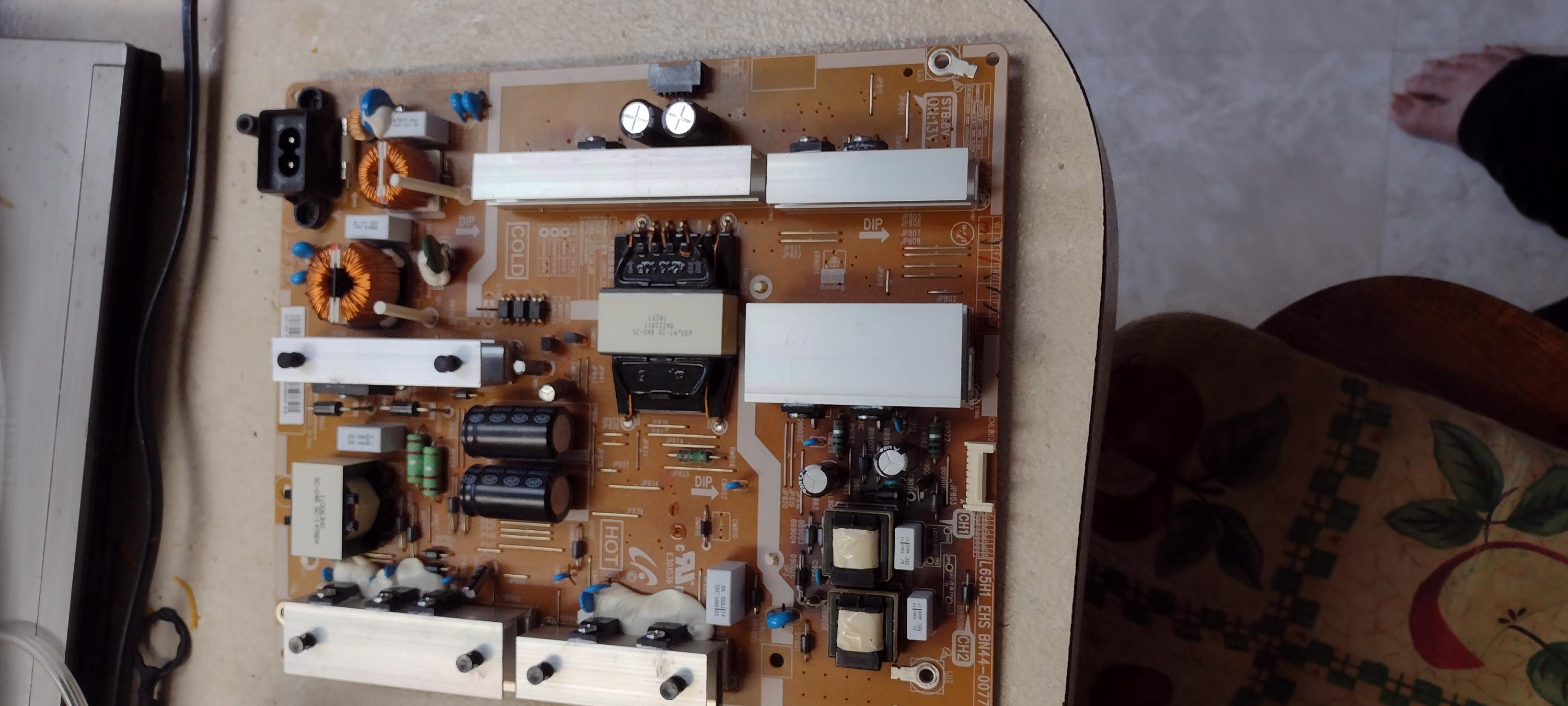

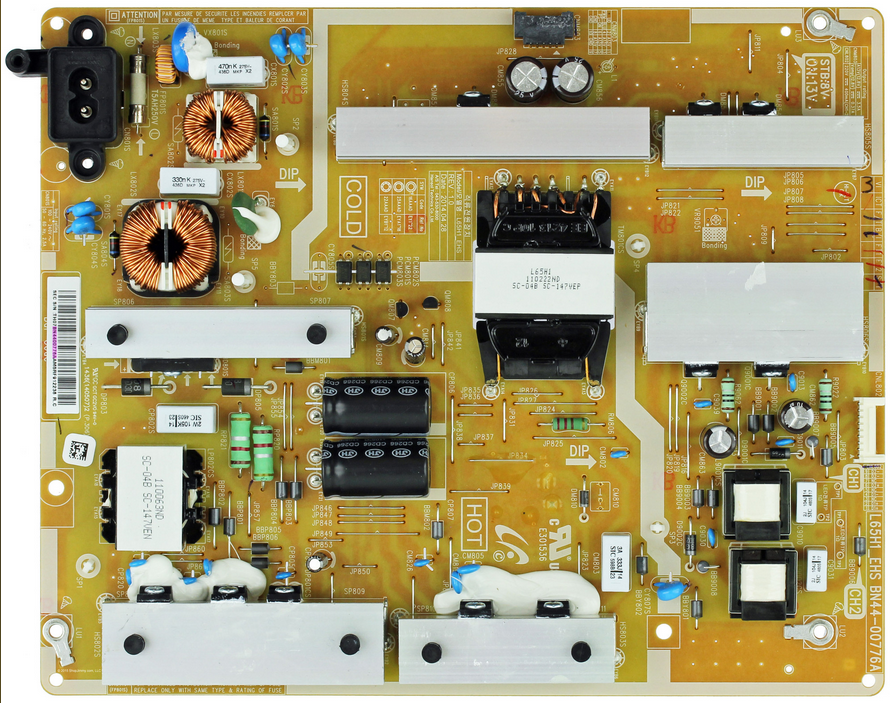

This set has power supply board BN44-00776A. i'am having a hard time finding one that's under a 100. Most voltages are about right with Back Lights unplugged and I have a standby light. If I plug the back lights up the voltages are cut in half and some no voltages and also loose stand by light. Back lights do not light up unless i use a back light tester, i can't really see how many lights are lighting using all four pins i can light up LED'S.Do you all think the power board is bad? Thanks for letting me in and for any reply's i get.

Yes it went to 170 v I think I had meter set wrong. There is no voltage on those two grey wires, maybe 1.785 dc reading from the black as ground and grey wires as hot. Nothing plugged in. Are you wanting a picture of the BN44-00776A p/s.Comment

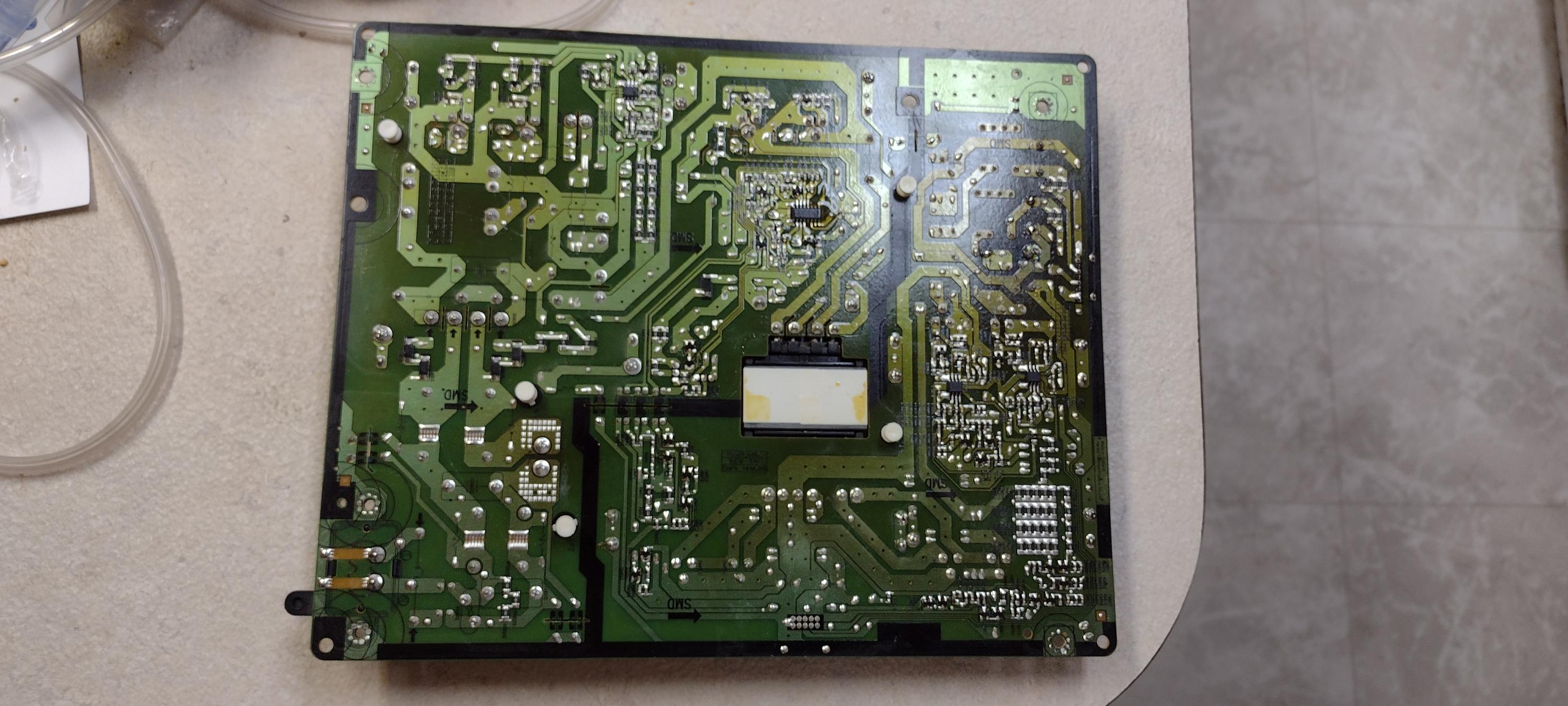

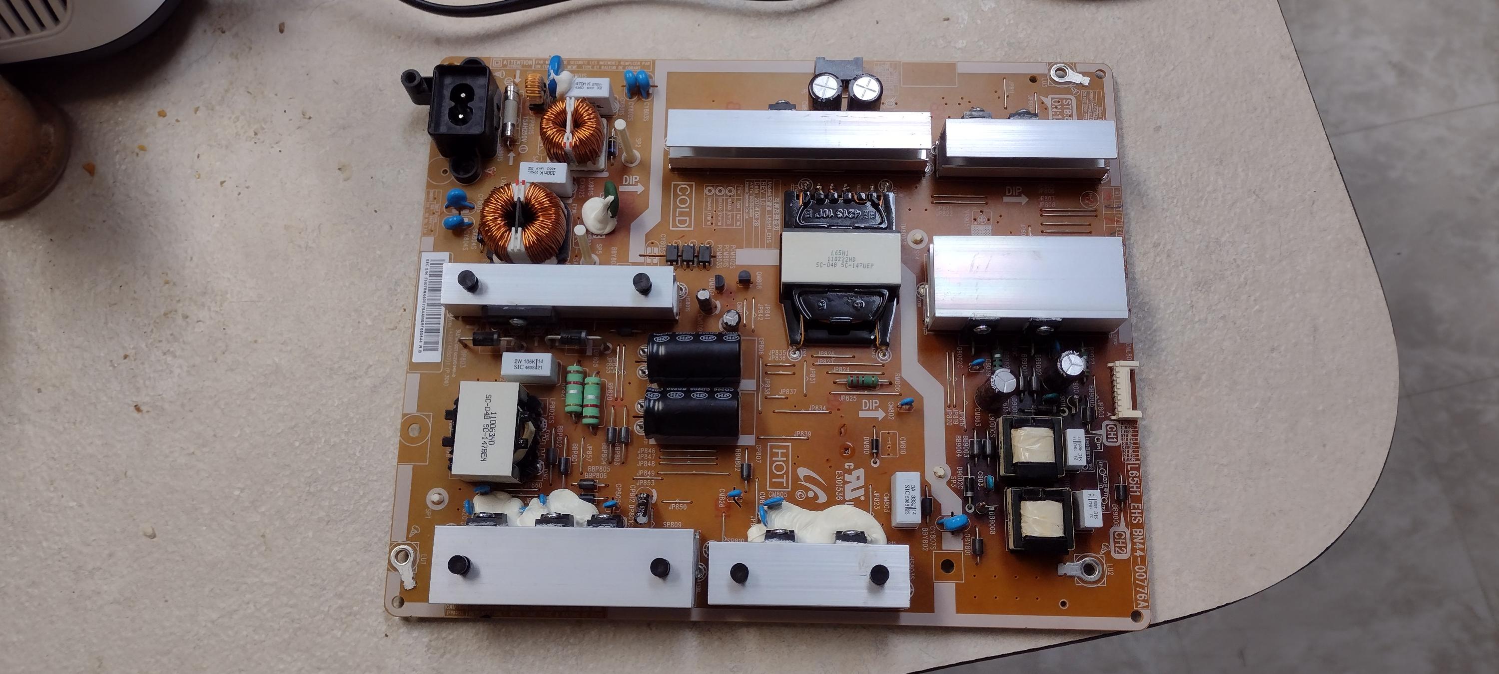

[/ATTACH]After taking the whole power supply out of the set and further testing i do have 325 dv volts on the back light light connector. each grey wire as red and using the black pins both sides have this same voltage. Looks like i may have ordered a board i don't need?? thanksComment

Hi cow boy, post a brightest possible photo of the back, straight, not by side. PSB must be output loaded to test it well, a good board doesn't behave like your with fault at the load, so no way the board can be ok, instead a purchase of a too expensive board after 2 mins of opening the thread is not the smartest move i have seen.. Your board problem is 95% prob. in feedback section, only two parts are affected, one the optocoupler, the other & more critical the shunt reference reg.Comment

What happens to the led strings with the backlights connected and disconnected? Does the DC a voltage ramp up fast at all, or just plain no voltage on the backlights? Do the backlights come on at all (maybe even for a second?) When the TV is on, does the PFC work? If the PFC works you should get instead of 170Vdc something like 390Vdc.Comment
