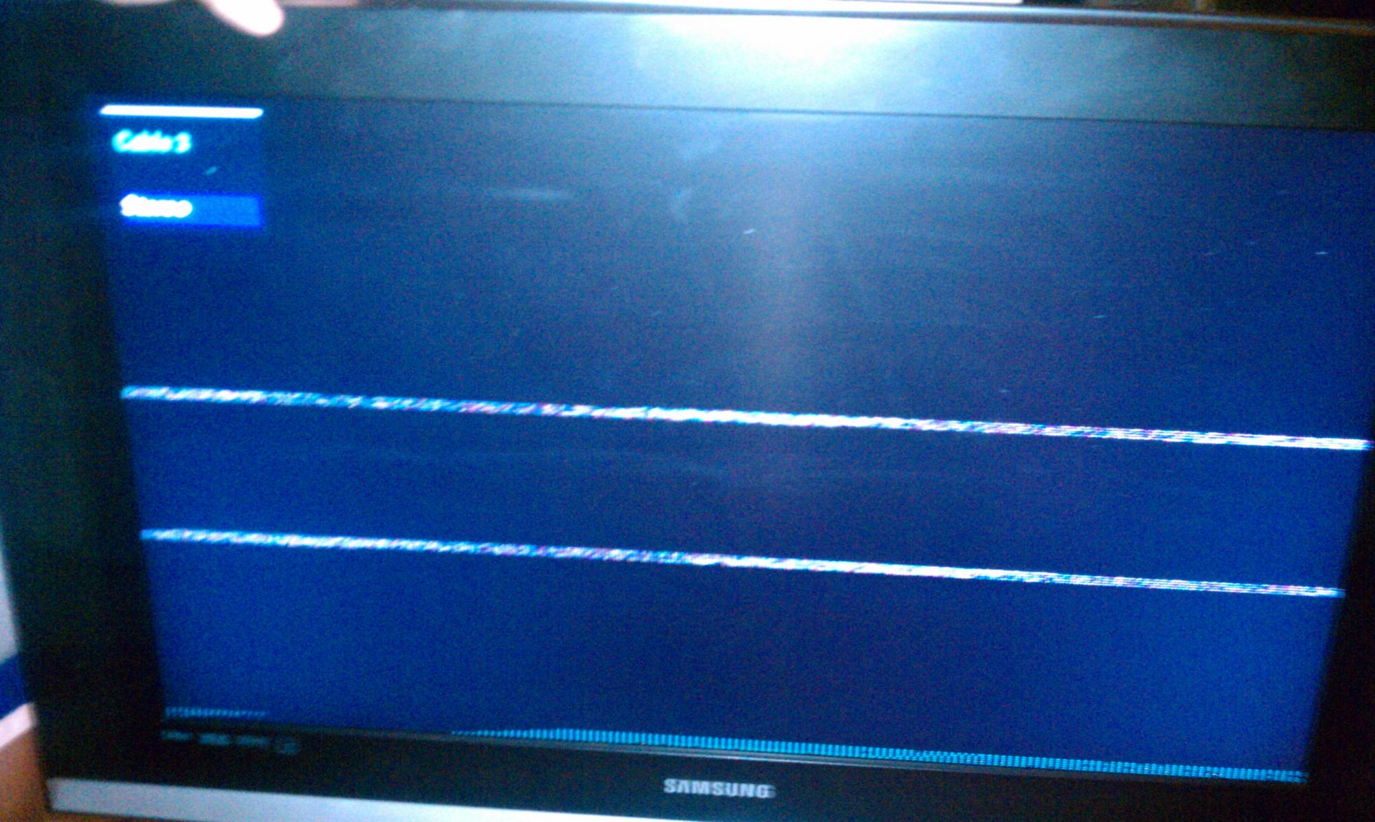

    Hi guys.
    First time poster here.
    I have a Samsung LNS3241D and I have RGB HORZ lines through the screen.
    I have sound.
    The lines also do-not run through the OSD.
    When I goto HDMI input I get the whole screen full of RGB dots.....
    I appreciate any info or suggestions guys....

    You did right diagnosis by putting menu on it. Your LCD is fine.
    Check for bulging capacitors on power supply and replace if found. If not present, replace mainboard.

      sounds like the DSP is failing, or solder is working loose on the BGA itself.
      could be caps too.

        Well caps looked good tonight..
        I won an auction for a board off e-bay for 12.00 bucks...
        http://cgi.ebay.com/ws/eBayISAPI.dll...=STRK:MEWNX:IT
        If this does not fix it then I will prb be looking at a guaranteed good replacement...
        What do you guys think?

                              well it was the mainboard...
                              replaced it with one from e-bay and all is well now!
                              Thanks guys!

                                    I think I spoke to soon. The tv now does some weird things;
                                    If I am watching Football on espn and the game is on it seems to work ok but when it goes to a commercial and there is more black on the screen than white the whole pic vanishes for a sec then comes back when the games starts!??! What the?
                                    If i turn on Pic-In-A-PIC mode the screen never shuts off but then I ahve to deal wiht this big block in the way for the screen.... UGH!
                                    I am guessing I need to find another motherboard?
                                    Thoughts?

                                        weird...
                                        When I use the PC input of this tv it does not do the screen flashing etc. Behaves fine!
