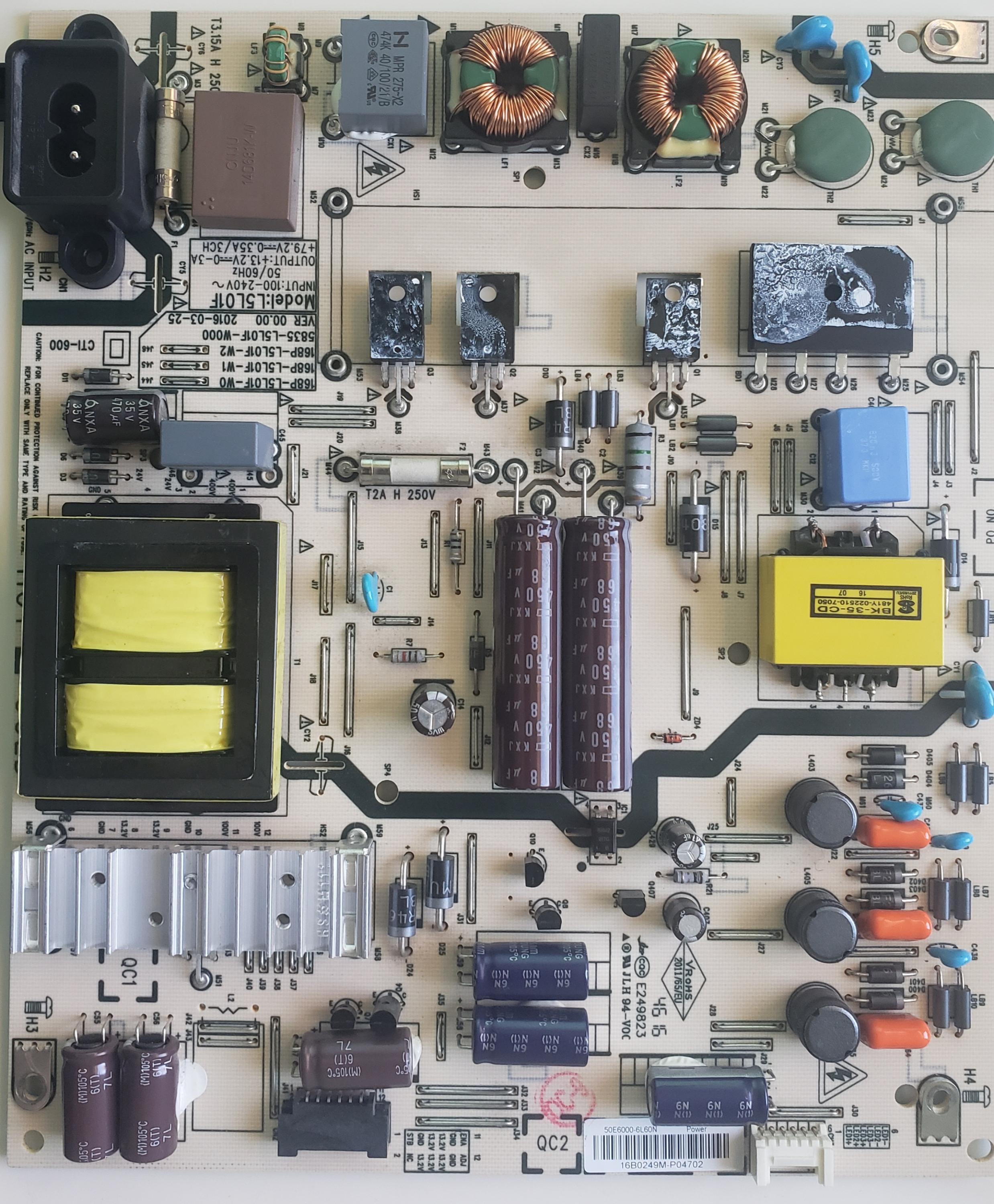

    LG 50UH5530 - Power supply - 168P-L5L01F-W0
    Hi, I've got this tv with no power symptoms. In further checking I found that there are no voltages on secondary side of the PSU board. Also main caps has only 165V DC voltage. Could you please let me know where to start on this one? Is there any issue with Q1 or pfc ic?

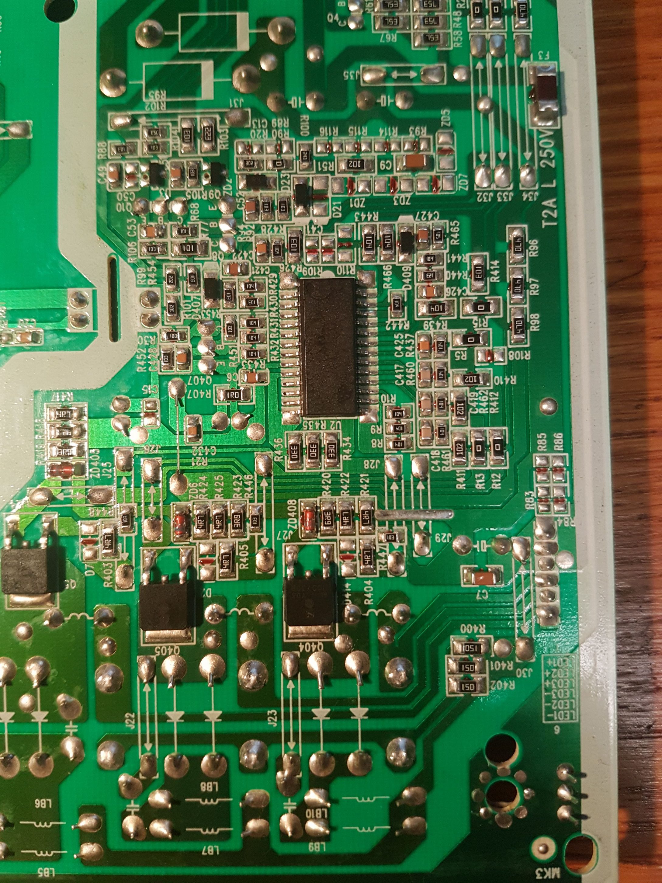

                                • anupkg1985
                                  • Sep 2020
                                  • 180
                                  Re: LG 50UH5530 - Power supply - 168P-L5L01F-W0
                                  Please find the marked cap in attached snap, I'm not getting any voltage on it. It's 50V 47mfd cap.
                                  U2 number - OZ9906GN, probably this is the datasheet - https://www.promelec.ru/product/318597/

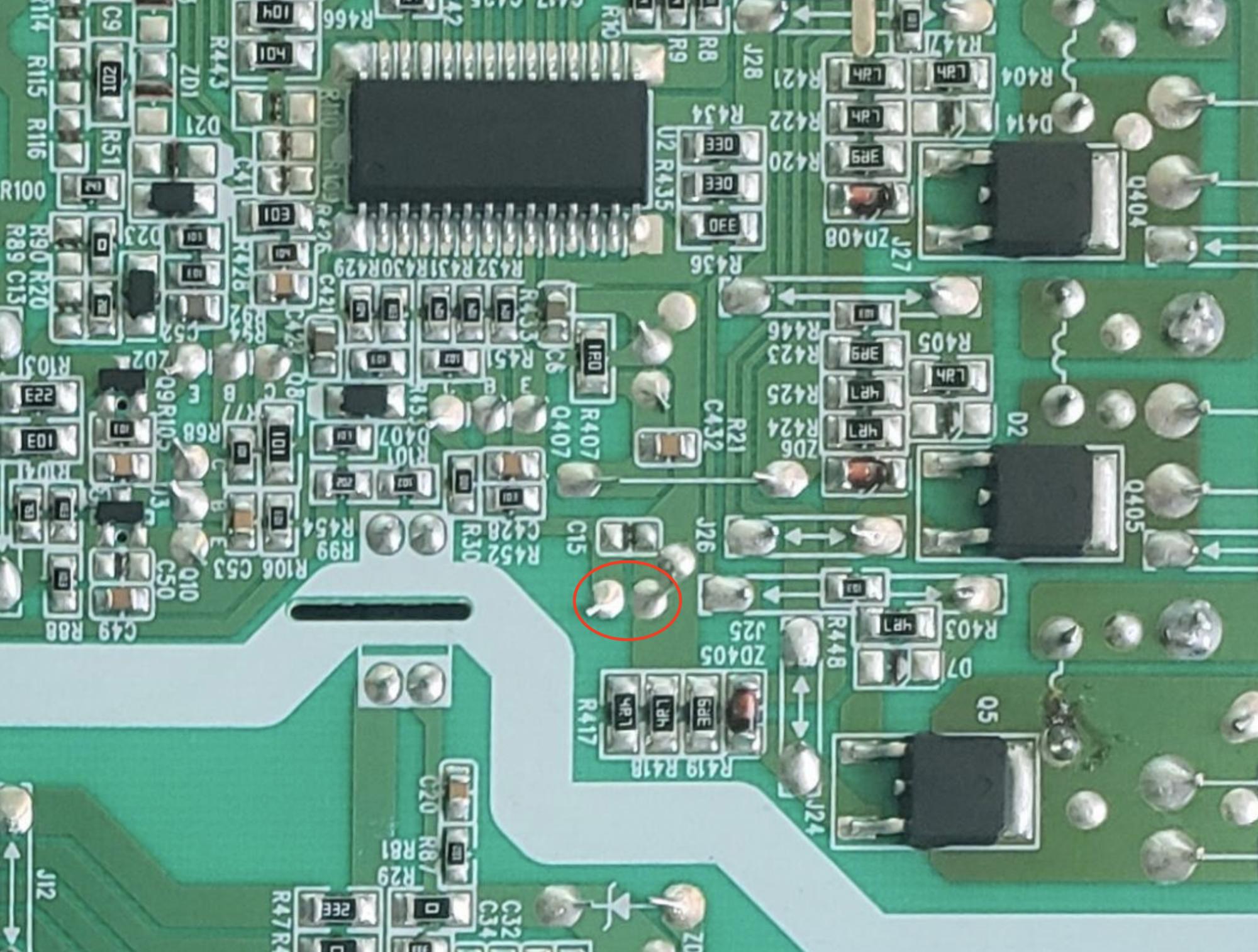

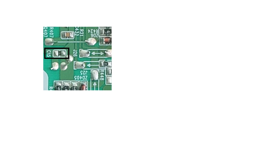

                                    That is NOT C15, C15 is a smd cap that is not populated, those leads are from the electrolytic mounted on the other side marked C429. Where does it connect to that you think it should have voltage on it?
                                      It's connected to Emmiter of Q407, shouldn't it have any voltage present on it?
                                      • R_J
                                        • Jun 2012
                                        • 9588
                                        Q407 emitter is connected to ground.
