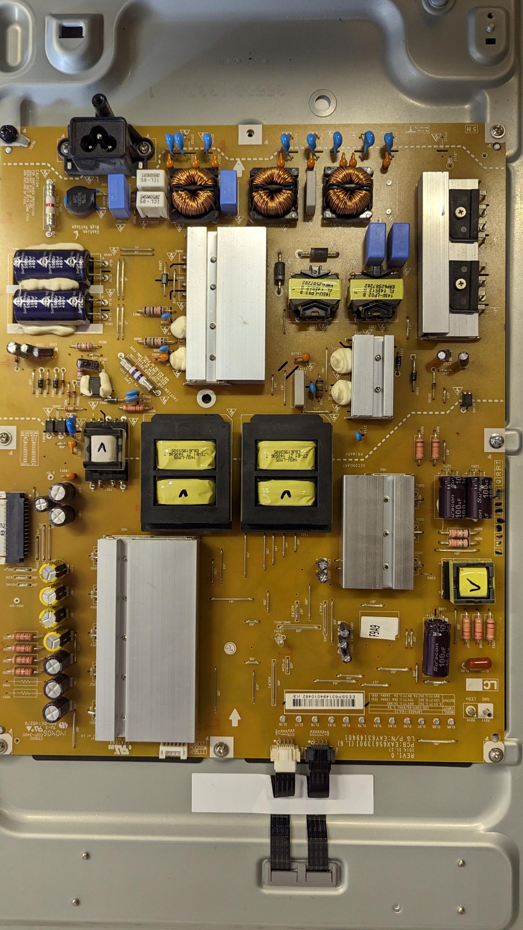

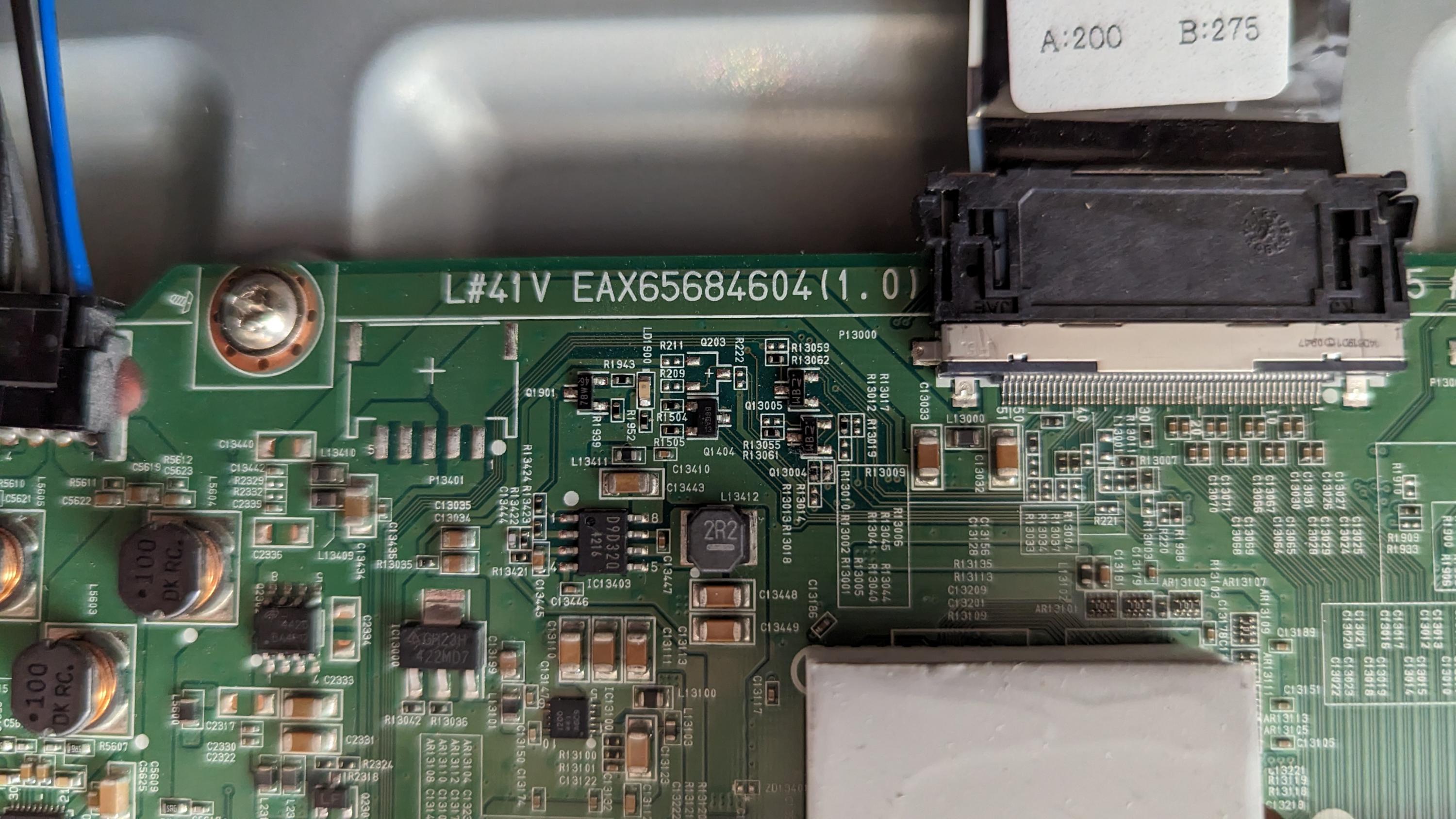

    I have a LG 49UB850V
    Power PCB EAX65613901 (1.6)
    Main Board EAX65684604 (1.0)
    symptoms are:
    Standby light illuminates when power connected but when Power button pressed, Standby goes off but no sound or picture.
    Previous owner said it just went off whilst watching it and wouldnt power on again.
    Check Backlights (side lit) and all good.
    Power board flashes LED LD701 five times in sequence. - searches seem to indicate this is a fault with DRV signal from?
    Voltages all look good from PSU, can see 3.5V, 12V and 24V on C28 (from PB > MB).
    PWR_ON changes from 0 to 3.5V
    PDIM1, PDIM2 and DRV_ON do not change - they stay at 0v.
    it would look like a MB fault.

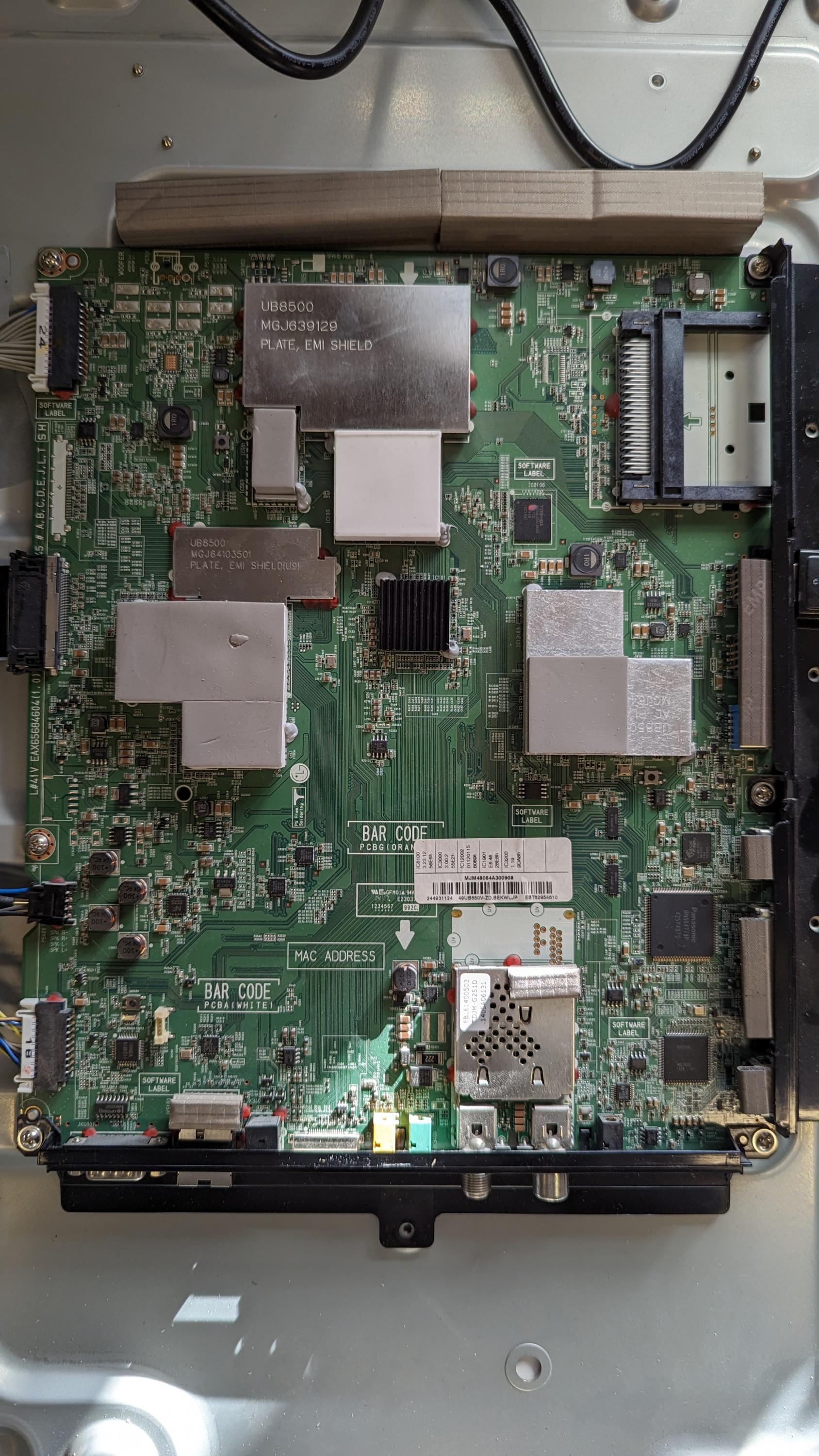

    removed wifi module
    tried holding SW1901 at power on, and after for long period.
    i have tried freeze spray on IC1901 (SPI) - no change
    checked pin 8 on IC1901 has stable 3.5v
    USB port has stable 5v
    no optical port RED light at all at any stage.
    checked for shorts on Caps and Coils.
    what else can i check on MB ?

          Traced the DRV_ON pin, labelled, following a schematic i found on this forum for the 55UB850V, that pin is labelled INV_CTL, connects to R2309, and then to an IC on the bottom left of the board, IC3000 to pin19.
          Looks like IC3000 = R5F100GEAFB in a 48 pin package.
          IC seems ok, has 3.5v but doesnt seem to be activating the DRV_ON signal.

          got the backlights on jumping the DRV_ON,PWR_ON and 3.5v so seems to indicate Powerboard is working ok.

                    R5F100GEAFB is MICOM, a microcontroller from Renesas has firmware inside, it controls the launch of the TV from standby to operating mode and vice versa.

                        OK, so ive got it working.
                        searching through the forums, i saw some other LGs with IC100 reflow fixes... so as ive nothing to loose i thought i would try it.
                        https://www.badcaps.net/forum/showthread.php?t=100402
                        so lifted up the white heatsink and loaded it up with flux paste round the IC edges (only 3 of them as i the heatsink/shield was obstructing one side) - then used hotair tool set at 450C and melted the flux for a minute around the edges.
                        ive only tried it twice and fired up no problem.... will leave till the morning and check it again to ensure its fixed it.
                        thanks all. will update tomorrow.
