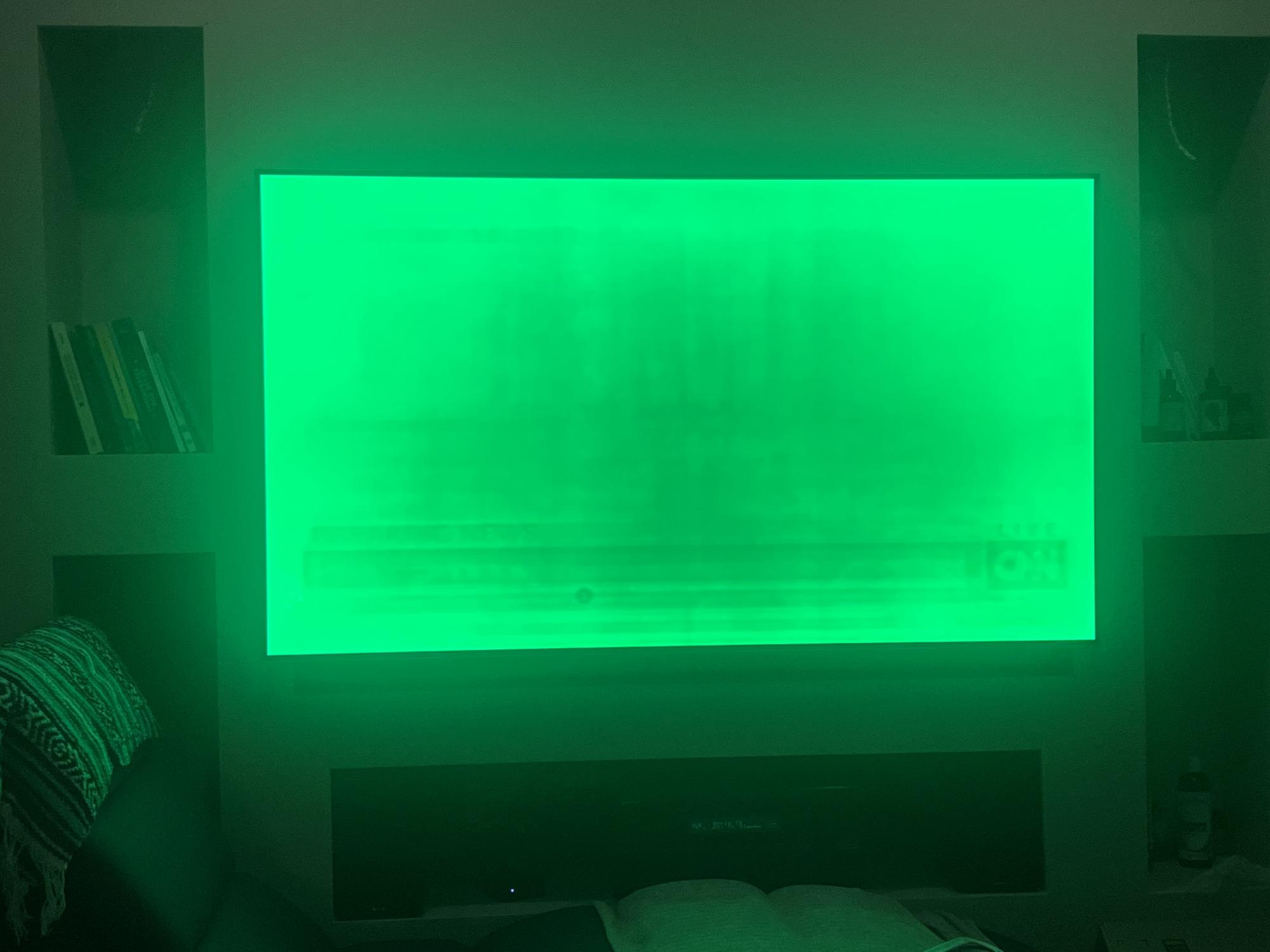

    So i have an LG panel, it's from a OLED65B7 model. Second TV is a lg OLED65BX (new model) with a cracked panel.
    So i took all the guts, and put it on the B7 Panel. It *somehow* works but image is not ok, it seems the reds/yellows/blacks are messed up.
    I have heard (a quick google search shows many reddit users doing sucessful swaps) and i've done it myself, you can use a board from a B7/B8/B9, C7/C8/C9 and they are all cross compatible with each other,
    But there's some new variants out there, like this BX i'm using, or CX, or C1, C2 even more recent. I'm just trying to figure out, am i facing a different hardware that is not compatible, or could it be something that can be adjusted from the service menus (lots of options in there)..

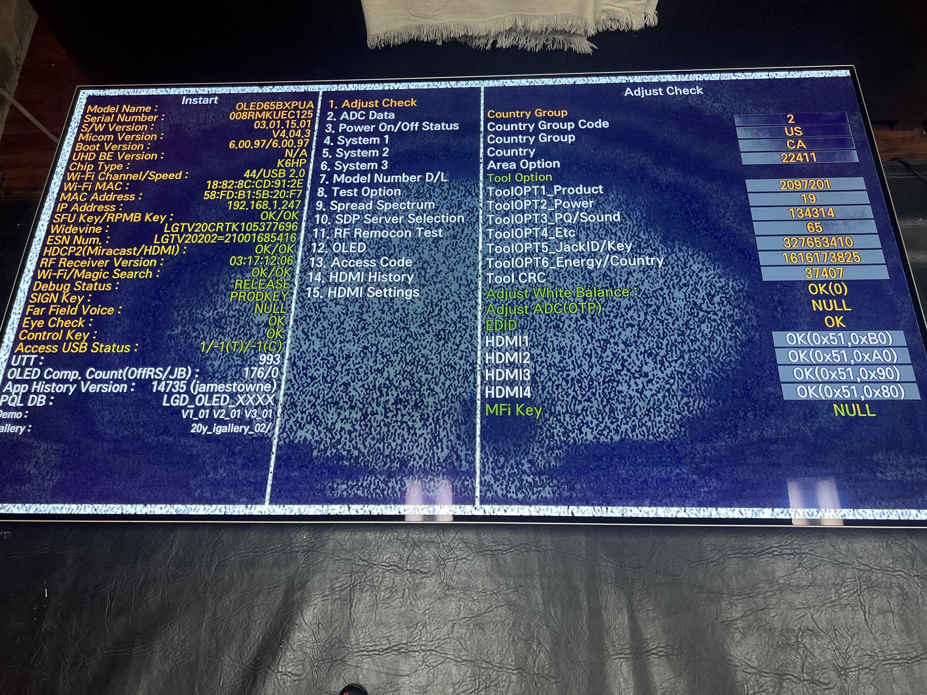

    I attached the screenshot of the service menu, where we can also see the bad colors, more greenish in the middle for the yellows..
    Or would it be a bad panel or bad tcon ?

    the problem are at T-CON firmware... if used BX T-con with BX Main board send first IN_Stop to let the firmware align the panel. or use B7 T-con and do Firmware downgrade to let MB and T-CON firmware align together

                      you can also log in service menu " E-Z AdJ" take look if the B7 Panel listed at BX MB.. if it listed mean the parameter will be adjust automatically.... about self repair LOL... OLED at cold start always do Pixel Refresh.... this action can be due manually too via normal system menu.

                        Hi there, no the B7 panel isnt, in the list in ez-adj.. I will try with a C9 motherboard i think later to see if it does any better..

                            Is there a way to check the panel with some kind of EDID info like with did with pc monitors ?
                            I was wondering exactly in the lines of what Diah said, i went thru the service menu and in the panel type i didn't have BX as the choices so.. It might be why it's incompatible
                            BX is like B10 from what i understand, *should* work as it's in the same series as B7/8/9 but it might be a different beast, might have settings that this panel needs removed up to some point.

                                I was wondering exactly in the lines of what Diah said, i went thru the service menu and in the panel type i didn't have BX as the choices so.. It might be why it's incompatible.
                                Panel Type code you can see it on the panrel chassis lable.. it will not contian any things related to module code as BX oe B7

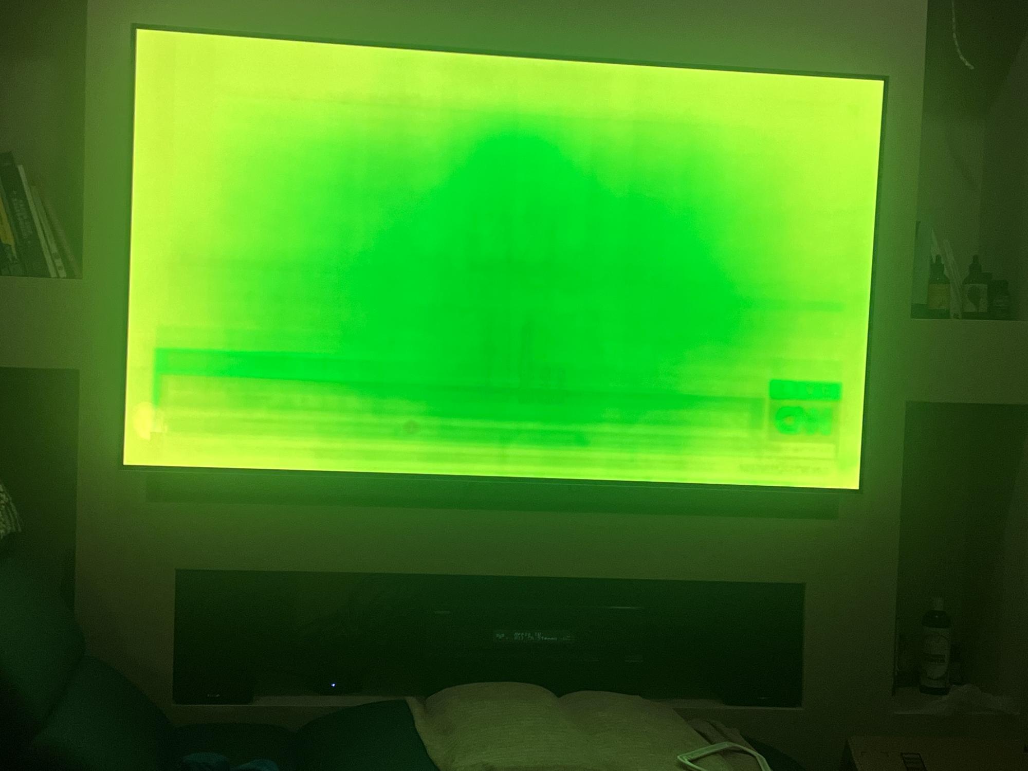

                                    Hi. Anyone with experience can see from these pics if its just horrible burn-in?
                                    I do see the cnn logo, but it looks like its burned on all colors..

                                      Re: LG OLed Main Board Swap Upgrade Compatibility
                                      its typical fault at OLED Panel not only TVs but Mobile too... high contrast burn the second sheet over OLEDs cell. .. if the sheet luckily wise not effected so much refresh Pixel would make it little better or disappeared.
