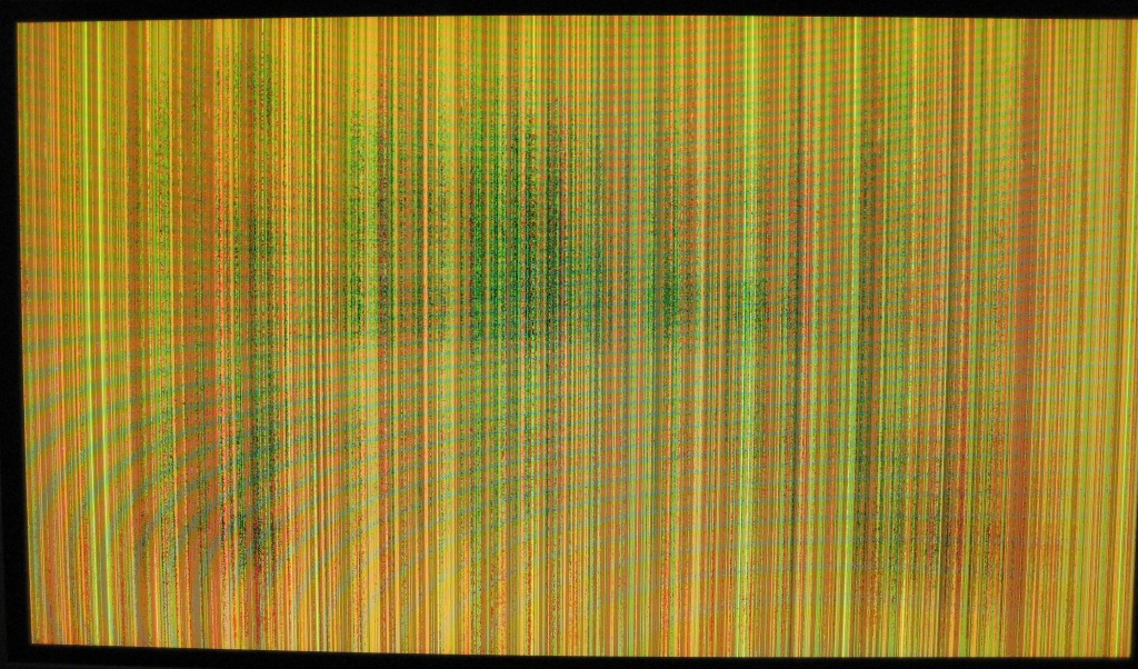

    Hi - see attached photo of LG model DU-42PX12X with vertical pinstripe lines across the full screen changing colors. No video, so no access to menus, so unable to test if sound works.
    Can anyone tell from the attached picture if this is most likely caused by which faulty board:
    * Ysus
    * Zsus
    * Control board
    * LVDS board
    * or some other most likely cause?
    Fuses, caps, driver chips appear good and no signs of distress in the set.
    I infer that that the slab panel is good from the bright full screen consistent picture, the driver chips are good, and the power voltages are probably good. What boards in what order should I replace?
    Thank you for any advice you can offer,
    Michael
    (an electrical engineer, but little test equipment and new to plasma tv so limited to board replacements, but hopeful I can fix this TV

    It's a little early to be replacing parts. The first step would be to measure the outputs of the power supply. Most of them are identified by voltage. There is a label on the back of the panel which identifies the voltage which are specific for the individual panel. Check those too.
    The next step is to do a little learning. Google scribd LG plasma training manual and also scribd DU-42PX12X service manual. These searches should bring up at least three manuals. There should also be a model number for the plasma panel, either on the panel or you can find it in the service manual. Google THAT number and service manual.
    One little hint. If you can find the service manual for the panel, there may be a set of switches on the main control card (it's behind the signal panel) that allows you to put the panel in service mode. This bypasses things like tuner, video processor, etc.

          Hi Bill, here are some results for your consideration and advice if you please:
          The panel label is:
          PDP42X2
          Va: 60 Vs:200
          80 / -200 / 120 /NA / 90
          So, following are the (spec) voltages, the actual measured voltage, and V adjusted in some cases:
          (12) = 11.9
          (3.4) = 3.318 adj to 3.39
          (5.0) = 5.1
          (6.0) = 5.93
          (19) = 18.81
          Va (60) = 60.9
          Vs(200) = 185 at power supply, unable to adjust up to min. spec of 195 using PS potentiometer. Also, why is there a separate Vs pot on the Ysus board?
          Vzbias (90) = 99.6 adj to 90.1
          -Vy (200) = 210 +/- 2 adj to 198 +/-3
          Also, I had the oppor. to swap/try (presumed) good Ysus, Zsus, LVDS (front signal board), and MCC (Control Board between LVDS and the Panel) boards and the same maldischarge symptom persisted throughout, specifically:
          * Well lit display with vertical multicolored pinstripes flickering (see photo attached above)
          * There is proper sound
          * Tuner does change channels using cable tv signal input
          * There does seem to be menus and video behind the flickering pinstripes but not readable or watchable
          * Remote control works to turn on/off, change channels, etc. but menus and video are barely visible through the pinstripes maldischarge
          So, will a +10v higher Vs clear up this display? is the power supply board the problem?
          Thank you in advance for your thoughts,
          Michael

                Re: LG 42" Plasma Colored Vertical Lines and No Video, No Menus
                You diagnosed a bad mainboard. Philips is bit common with sneaky faults especially with mainboards.
                You'll need to change the power supply if you can not raise the Vs as specified by the panel's sticker.
                Once fixed, if you get sparkles, adjust either way very slightly on Vs and Va till sparkles disappears.
                Cheers, Wizard
                    Stop stop!!
                    PS is working properly to get far to that.
                    Cut your losses. Since you have swapped: LVDS cable, logic board, mainboard. The Y-SUS and Z-SUS is not the problem as you can see they worked.
                    Follow the logic do you? If you spot something you missed tell us.
                    Cheers, Wizard

                      Hi Wizard and All,
                      I am approaching wits end! You are right, the PS is OK, confirmed by swapping another (trial avail. at no cost, fortunately). I also swapped another LVDS main logic board with no change in the symptoms. Please note that I have not changed the LVDS CABLE as you may have thought, and I have not suspected the cable itself since it is mainly a mechanical part, and the failure mode was sudden.
                      However, when I unplug the LVDS cable between the main logic board to the control board, the vertical pinstripes go away and I get the mostly dark screen with some random sparkles as you described. Which is why I have mostly suspected the main logic board, but the original and 2 swaps all exhibit the same symptom!
                      All these boards seem to be confirmed good, at least no change in the symptoms: Power Supply, Main Logic board, Control board, Ysus, and Zsus. Since the panel itself primes and exhibits sparkles instead of pinstripes when the LVDS cable is opened (between the main logic and the control boards) I infer that the entire PS/panel/Y/Z high voltage and Control boards are all functioning properly?!
                      I am still in this a bit further for E&E (education and ego) so not quite ready to surender. So, what ELSE could be problem? I did find this info attached from Hitachi, which looks very similar to my display, except my "band" of digital noise is vertical instead of horizontal, and my band moves around and changes width when I toggle the menus, etc. The band seems to be where the text would normally display. The Hitachi info suggests a driver chip is bad -- could this corrupt the entire display with digital noise and noisy bands 4-6 inches wide? What else could be the problem?
                      In my set, the Y driver chips (on the left side of the panel facing the rear) all appear normal. I cannot access the X chips along the bottom of the panel since they are under heat sinks and some framing. Any ideas to narrow down this problem? Maybe LVDS cable? Or a driver chip -- Y or X?
                      Thank you in advance,
                      Michael

                        one thing you have NOT replaced or tried to swap out. thats the Y buffers. ive seen Y-buffers do stupid crap like that.
                        however, its more "controllable" faults.
