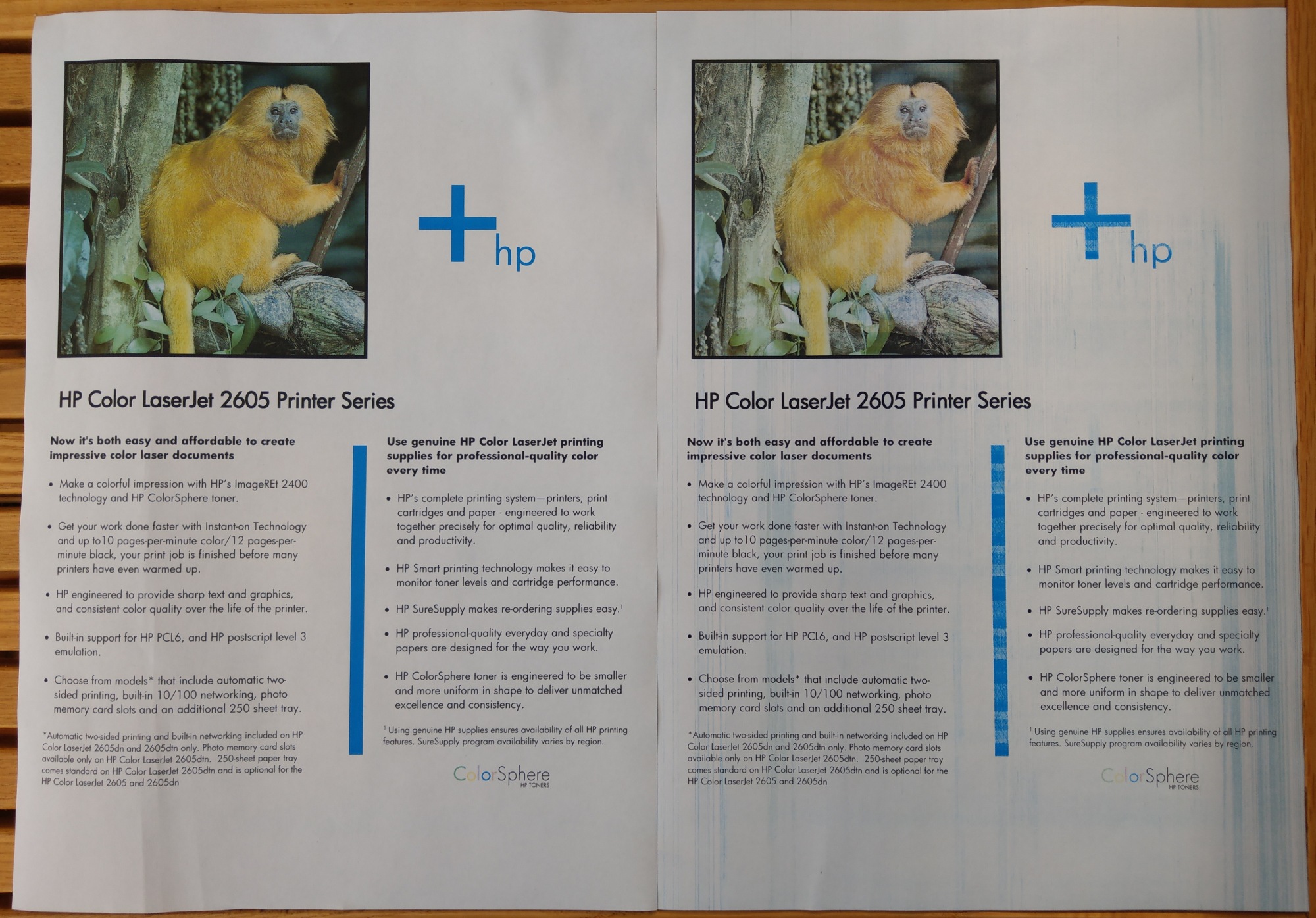

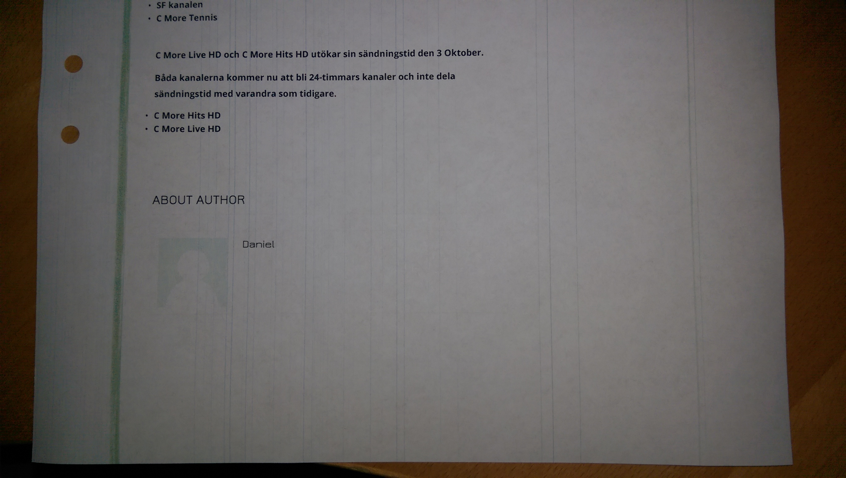

    I bought a HP color LaserJet 2605DN many years ago.
    It developed a problem with the toner though, it made stripes on the paper
    I replaced all toners but this time used aftermarket, they worked for a while but now again got the stripes on the paper.
    Anyone got some ideas, is the toner causing this or something else?

    Dumb as this sounds have you just tried shaking the cartridge?

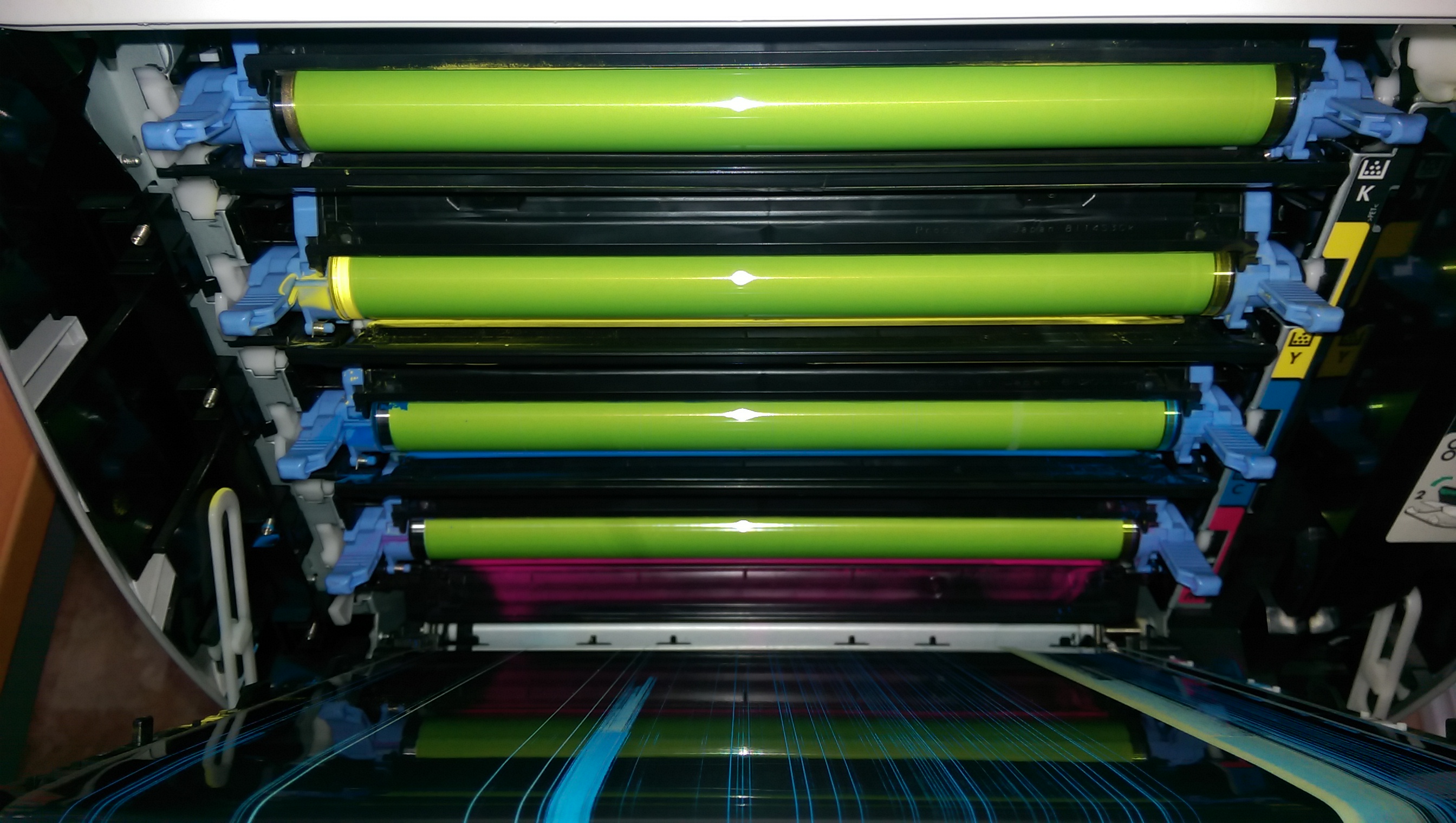

      Not sure if you ever solved this, and or to people that may be experiencing similar print output, but if you look at the toner transfer belt the black wide belt towards the bottom of the image you will see a similar outline. The belt appears from the photo quite badly worn and would need replacement. An expensive undertaking.

          any old laser,
          clean the mirrors, clean the spinning optical drum that scatters the beam, clean the optics.
          dust on these parts causes fading / blurring of the print.
          then clean the drum(s) with a dry tissue and wash any foam rollers under cold water.
          that will help stop banding.
          if your toner(s) are good,
          it will be good as new.

            Sounds more like fuser than toner to me. I used to see image issues caused by problems with the transfer belt. They were printers under contract and the transfer belt was a classed as a consumable.(£120 on £400 printers IIRC).
            With prices for laser printers now being so cheap, if cleaning the printer doesn't cure any problems it's usually cheaper to buy a new printer than buy spares for the old one, unless second hand parts can be sourced at a reasonable price.

                    You generally find toner transfer belts in colour laser printers rather than monochrome, so in the case of your laser-jet and brother, there wont be a transfer belt. In the case of the original poster the transfer belt is very visible in the first image and looks to be severly degraded. I think reading up, most of the likely candidates for problem solving in your case have already been mentioned.

                        Answering my own question here hoping it might help someone else.
                        The issue was the toners: I bought new original HP toners and the problem went away, see attached photos for comparsion!
                        Take note that the aftermarket toners only did a few hundred prints at most!
                        Of course the company that I bought them from has gone bankrupt!
                        I did do some reading before I decided to give it a go:
                        The toners in this printer have the drum built in, and also toner waste bin.
                        So if the waste bin gets full this problem can occur: I made holes with a soldering iron to let out the used toner but there was not much in and it did not help.
                        The other conculsion that others made is that after the 2000 pages they are rated for have been used up the toner is really mechanically worn out.
                        And therefore aftermarket replacements are not a good idea for this printer!
