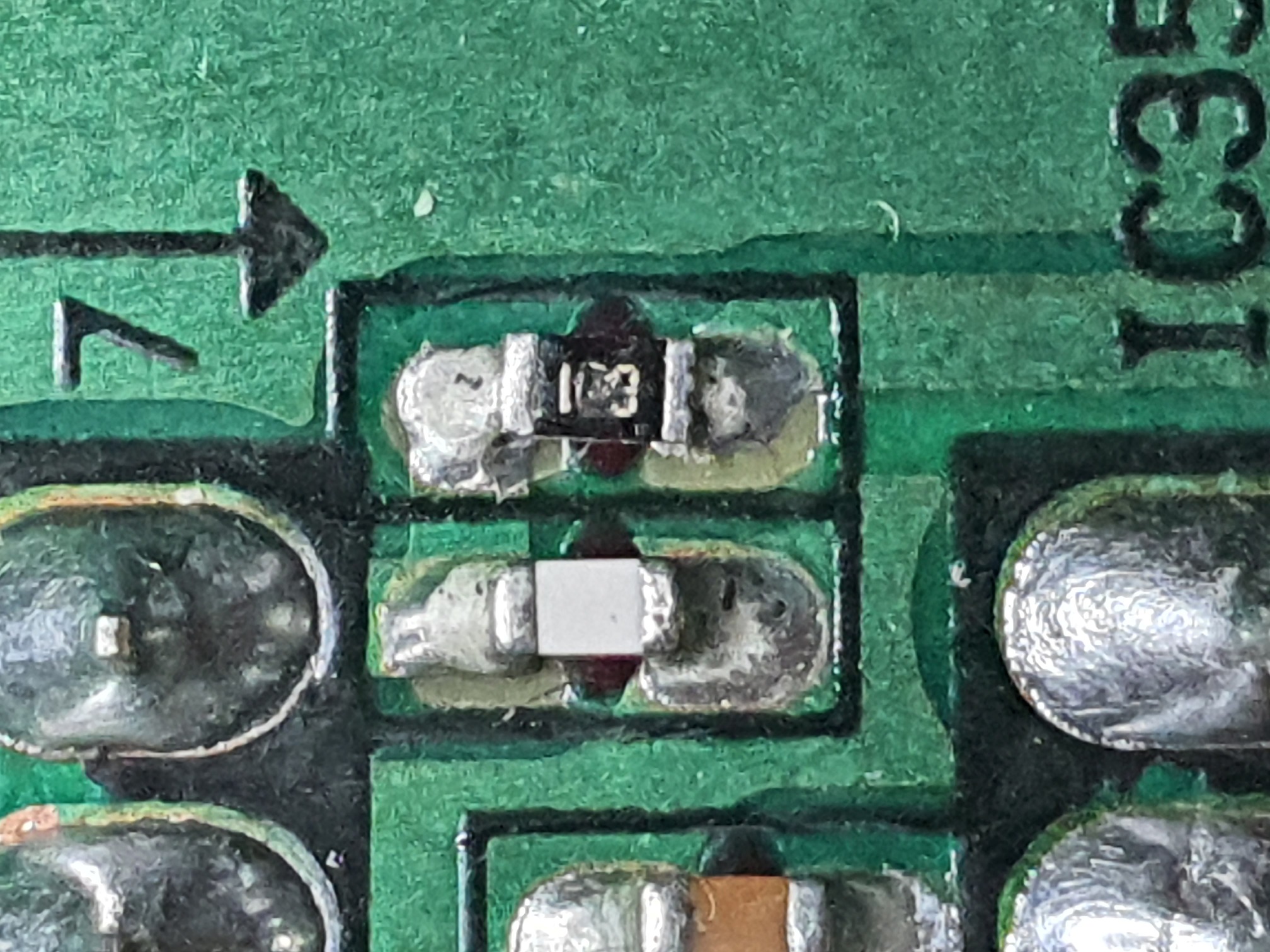

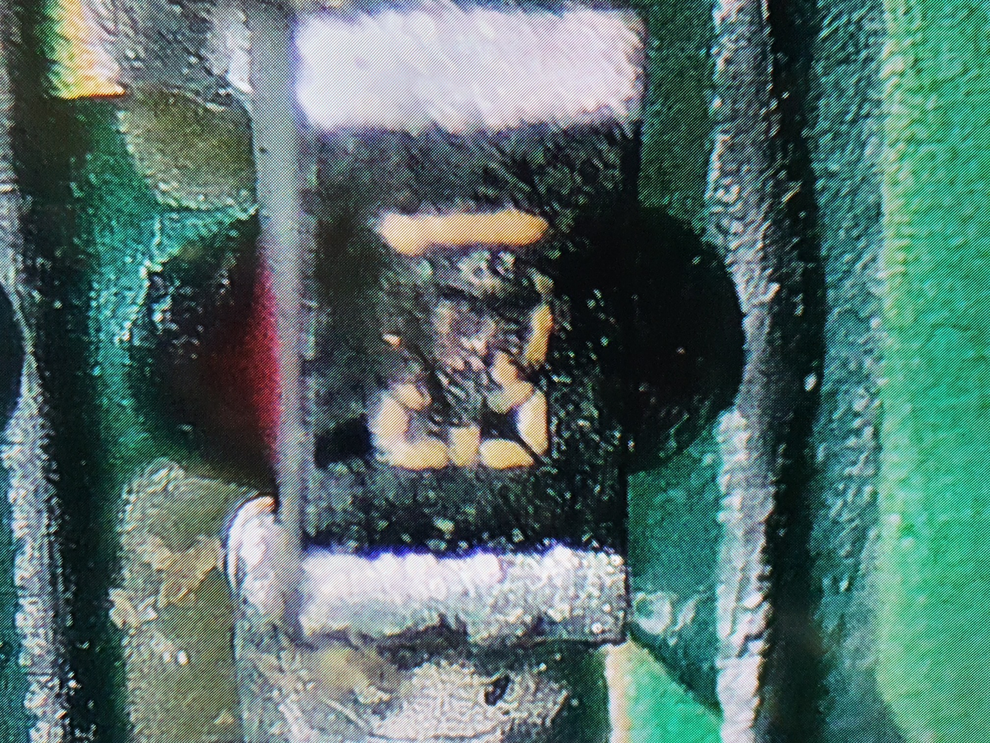

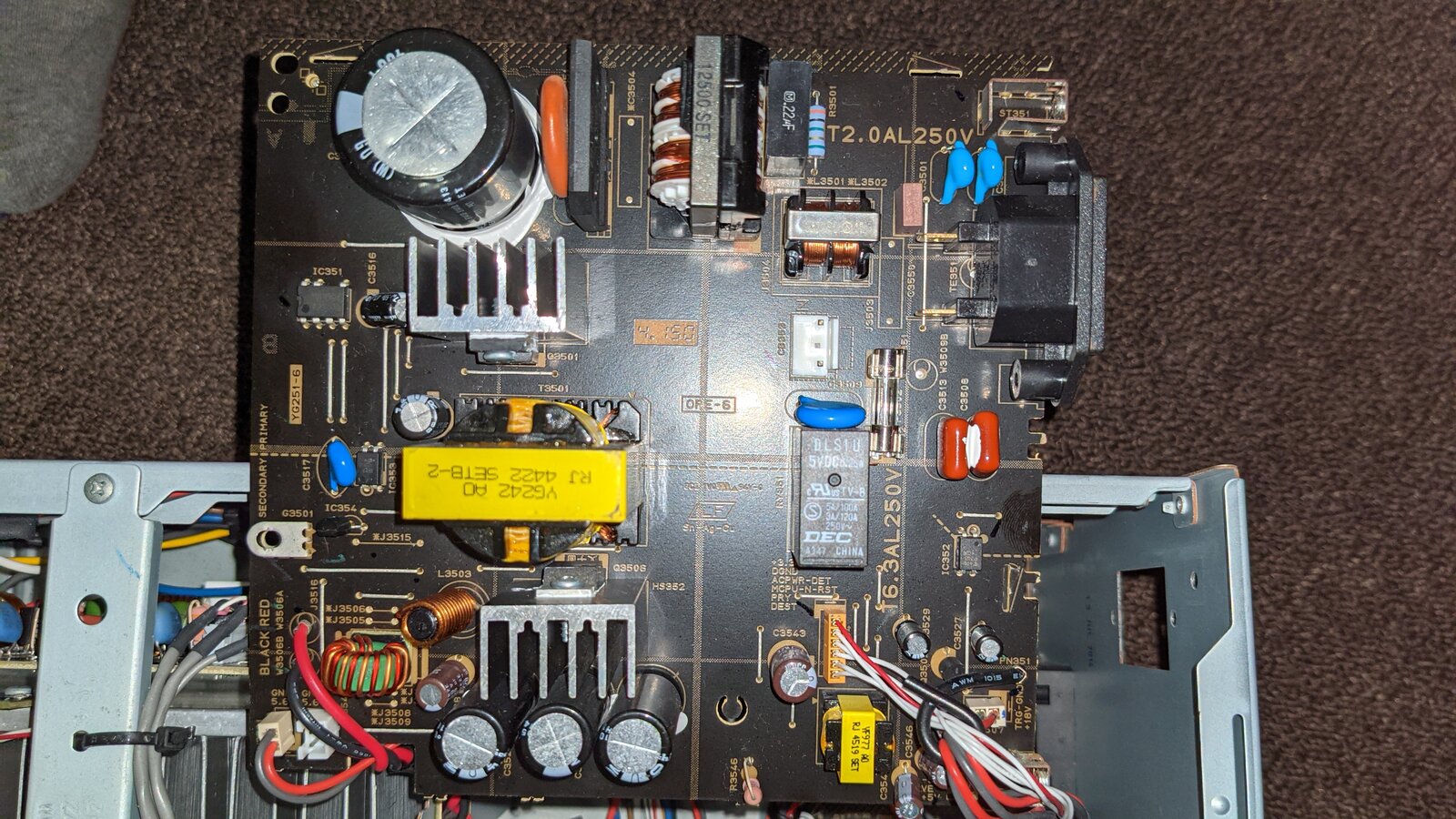

    Been having this unit for sometime now but not a single chance of obtaining the schematic diagram online. The unit came with a shot mosfet, some resistors and a MIP004 IC. Managed to replace the mosfet, mip004 but stuck at 2 resistors thats burned. Can anyone please help me identify these resistors? I only have 2 resistors thats not replaced now, the rest all replaced. This resistor is connecting to leg 7 of MIP004.
    Could it be 801? 800 Ohms? Impossible to be 108 as thats 1 G Ohm :P

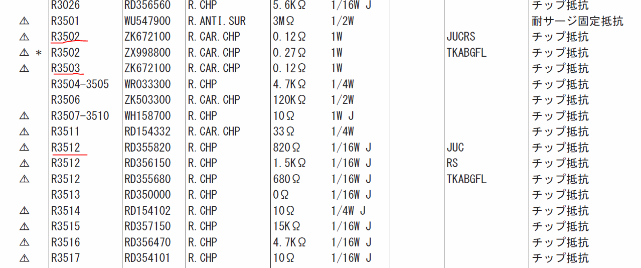

    Re: Yamaha RX-A1080 No power
    Check.
      Originally posted by lotas
      Check.

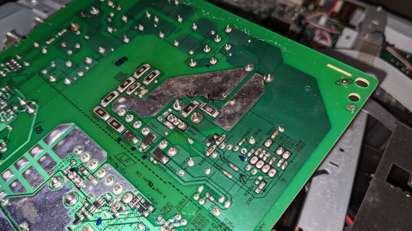

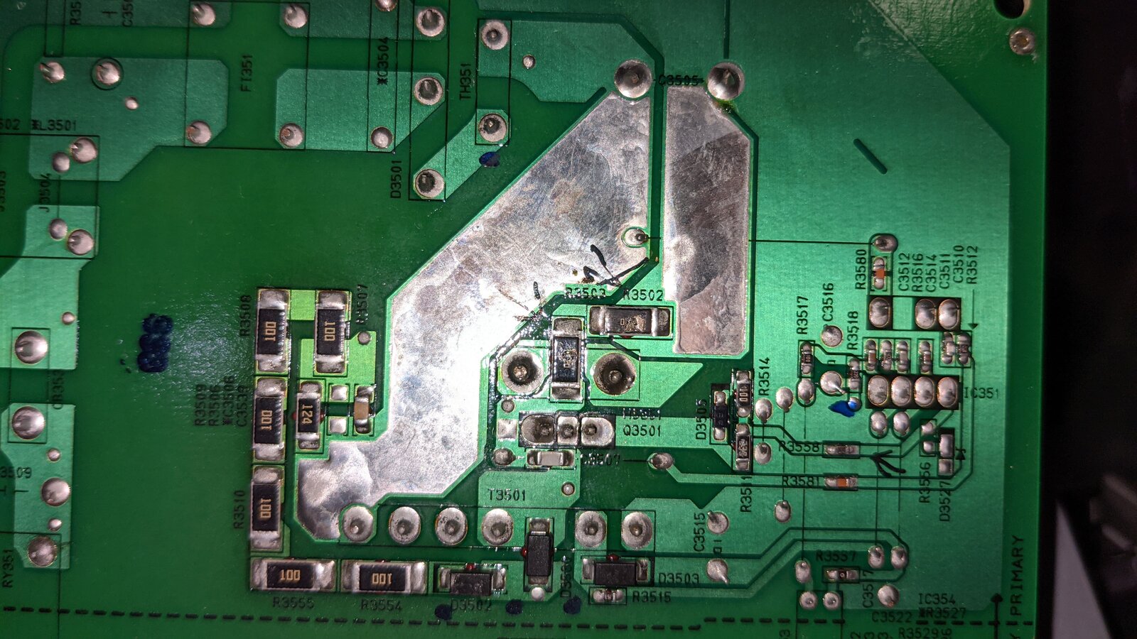

      Thank you so much, youre the man. Can i have R3558, R3511 and R3514 as well?

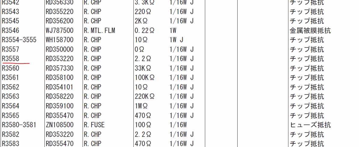

        If you dont mind, can i have the full parts list please? Just in case for future repairs. Truly appreciate your help.
          R3558
