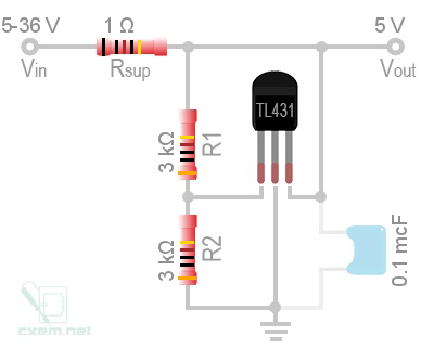

                                      Or would this work on the 5 standby circuit just in case the voltage has gone to hell and remove the regulator that is on the board now one note I am also going to put a switch on the power ON wire so I can control it coming ON

                                        Not sure if the TL431 is able to absorb the surge if 5VSB is considerably overvoltage... but yeah something like this, perhaps with a regular transistor as a shunt current amplifier.
