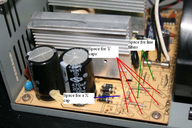

        Things like X caps, Y caps, and bridge rectifiers can be bought pretty easily and cheaply (don't know about the availability where you live,) but line filters are a little harder to find cheaply. My stash of them are all salvaged from psu's.

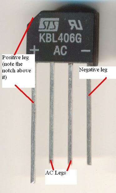

        This is a bridge rectifier:

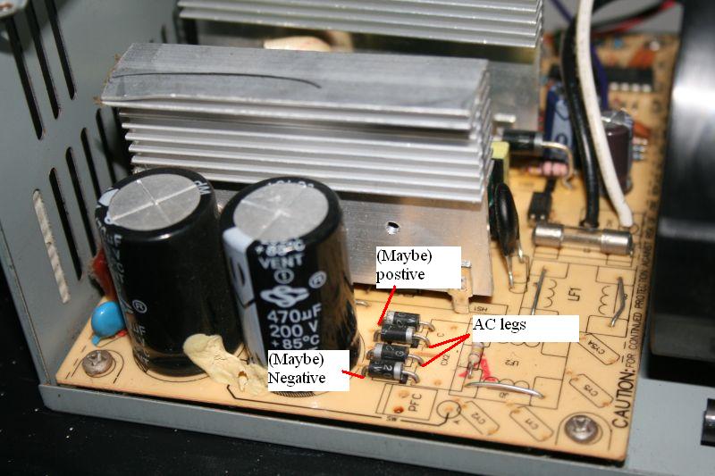

        I labeled which legs are which. To replace the diodes with the bridge rectifier, quite simply remove all 4 diodes. The positive leg of the bridge rectifier goes in any hole that connects to the positive leg of the primary caps, the negative leg goes in any hole that connects to the negative leg of the primary caps, and the AC legs go in the holes that are live and neutral coming from the transient filter.
        That I how I *think* it would connect with your power supply. A underside shot would clear it up.

          okay, just changed the four diodes to one PBU 805 bridge rectifier ( 8A @ 600V ) .
          now the line filter part which i still don't understand at all ..
          does it have specification ? and what recommended part for a 300-400w unit for the line filter part ?

            Several corners have been cut in this power supply, especially having no EMI/RFI filtering.

                EMI = ElectroMagnetic Interference
                RFI = Radio Frequency Interference
                Switching power supplies operate and many KHz, and if they're just hooked directly into the mains, they can feed this many KHz signal back into the 50/60Hz mains. Which can cause other devices (especially AM radios) to not work properly. An EMI/RFI filter filters out this noise, making sure it doesn't escape back to the mains. Also, it keeps interference that other devices may be creating from interfering with the operation of the power supply.
                If I remember correctly (I looked it up once), this is how it works:
                X caps - usually film caps, connected across Hot and Neutral, filter out common mode noise. Must be rated X1/X2
                Y caps - usually ceramic, although sometimes film caps, connected between Hot and Ground (Earth), and Neutral and Ground (Earth), filter out differential mode noise. Must be rated Y1/Y2/Y3
                Filter coils - coils with 2 windings, wound in such a way that they filter out both common and differential mode noise. You must be careful installing them, otherwise you could hook Hot directly to Neutral and blow a fuse or circuit breaker or start a fire.
                The X and Y caps are not polarized, but like I said you have to watch the filter coils. And be sure to remove the lame jumper wire, otherwise they won't do any good Good luck!

                        You should still keep that PSU, though. It's actually not that bad at all. If you know of any TV repair shops around you, ask them if they have any TV/monitor boards that they don't need or want to get rid of. Those will usually have the components (X caps, Y caps, coils, etc.) needed to complete the input filtering of the PSU.
