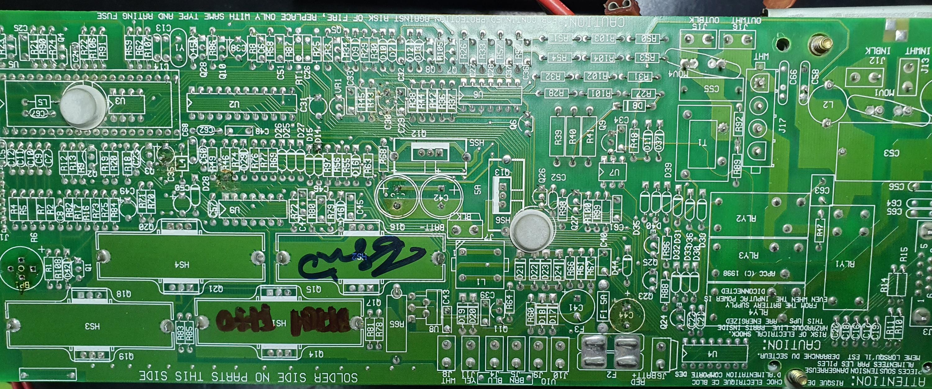

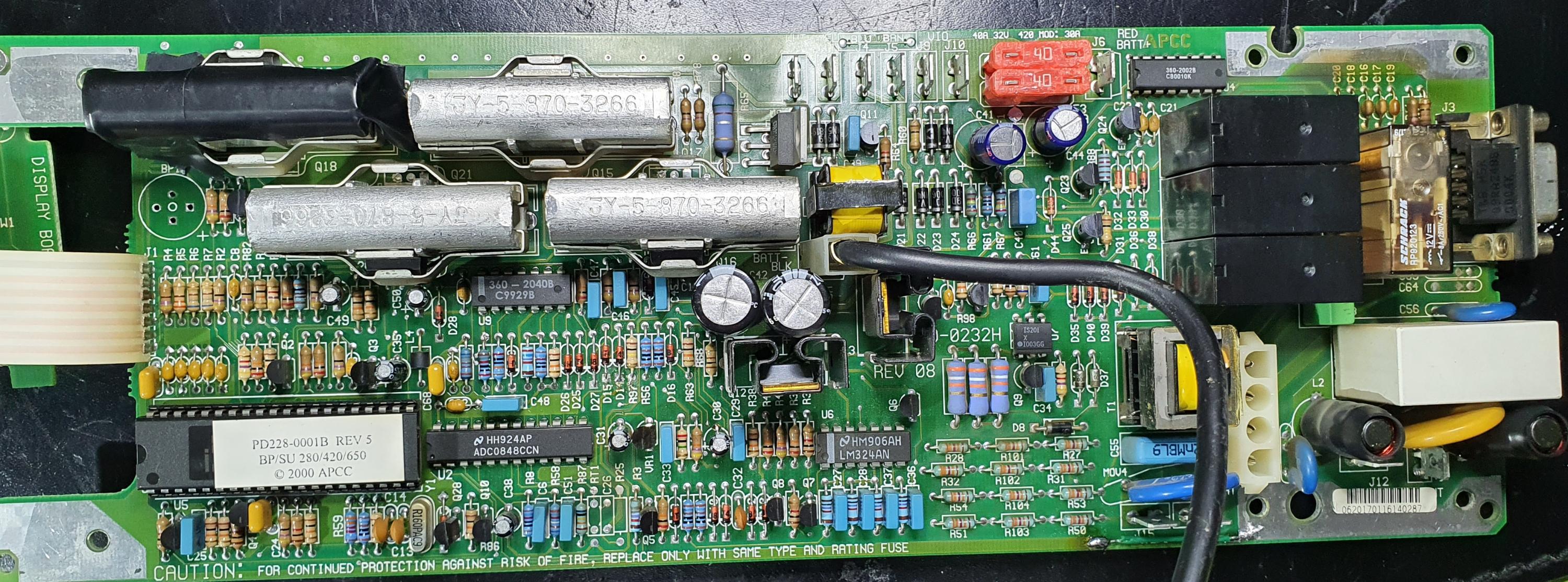

    The board looks clean - no visible damage whatsoever. I also managed to find the schematic for it, so I don't go around blindly replacing all the caps, which I doubt is the cause of failure to begin with.
    I didn't dare plug it into the mains, but it should work on its own off the battery, according to the manual, so I used a fresh one to test. When I hit the button, I get a beep, I hear some relays closing and that's it. After a little while, the relays go off again. You can try doing this all day long with no change. Occasionally, the overload LED will come on and it will also beep continuously, but I've yet to figure out if it happens at random or there's a pattern to this LED coming on. I also don't hear any specific noises that would indicate the inverter part is working: no buzzing or humming from the transformer and no squeals or ringing noise from the board.
    To try and cut the story somewhat short and skip the routine procedures I always go through when diagnosing, like look for shorts or burnt components, I THINK the problem lies somewhere with U9 on page 6, as it appears to be responsible for driving the 8 transistors (4 in my particular unit) that in turn switch the transformer to generate an output. No U9 means no output. Unfortunately this is where I got stuck. There's no info on this part, so I don't know how it operates. I don't have a scope, so I have no way of checking if U9 is doing anything or not. It gets its supply on pin 1 as it should, no problem there. It seems it's driven directly by U1, the MCU, on pins LSB and MSB, though I have no way of checking if this actually happens or not. Then there's that -8v rail below it. If I measure it with respect to GND (the negative battery terminal), I get around -10v on C50 (that's the negative leg before D28). If I put the red probe AFTER D28, I only get around -4v...not sure what this means and what this voltage is for. I'll probably try pulling out C49, though every cap I've tested so far seems to be within spec, since I tried several of them, hoping they're read out of spec, but ended up putting them back on the board, since they checked fine on my capacitance meter.

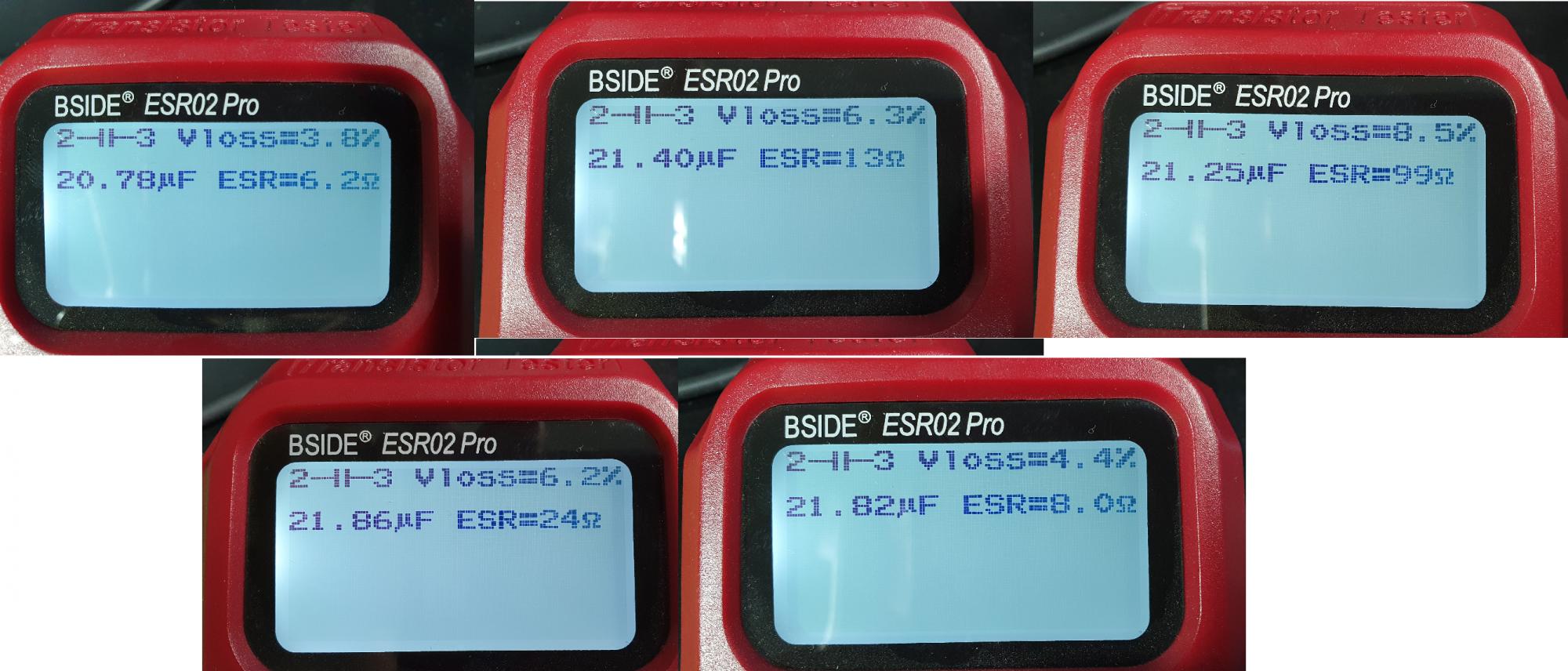

            Ok guys, here's the situation. I busted out my ESR meter today, which isn't anything too professional by any stretch of the imagination (probably cost me around 15$ when I got it), but has been enough to point me in the right direction on several occasions.
            I'd say these results are pretty clear: ALL of the 22uF caps show rather high ESR ratings, despite the capacitance being tolerable. (Hope you can see that picture alright) It's not just because of my Aliexpress meter - I ran the tests several times and even tried measuring some "good" caps and they read around 1.x ohms which is infinitely better. My favourite one has to be that 99ohm one
            Replacing this bunch will probably solve the problem. I don't have them on hand right now, so it will have to wait, but I will keep you posted

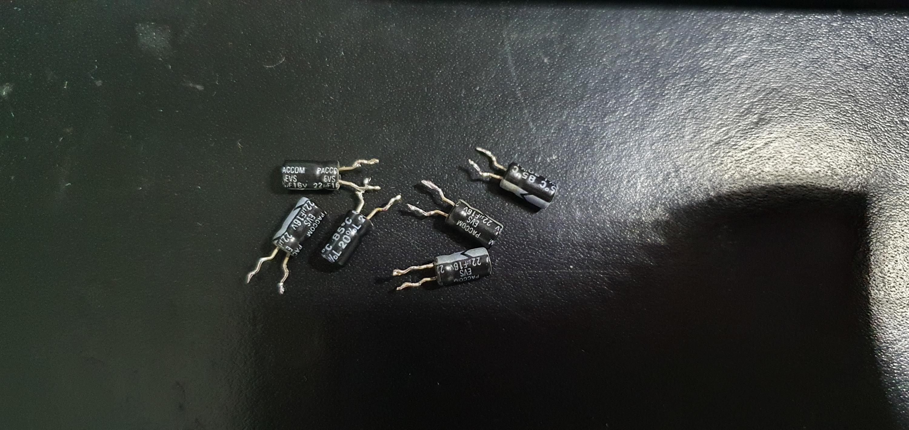

              I think the battery charger is LM2575 with two 330uF 25V output capacitors C41, C44.
              Did you replace these with some small crappy tiny parts? The picture shows something real small compared to the silkscreen.

                Haven't replaced anything yet - that pile in the picture is all the 22uF caps on the board, so yes, I'll be replacing all of them. The 330uF ones read fine, so I left them for now.
