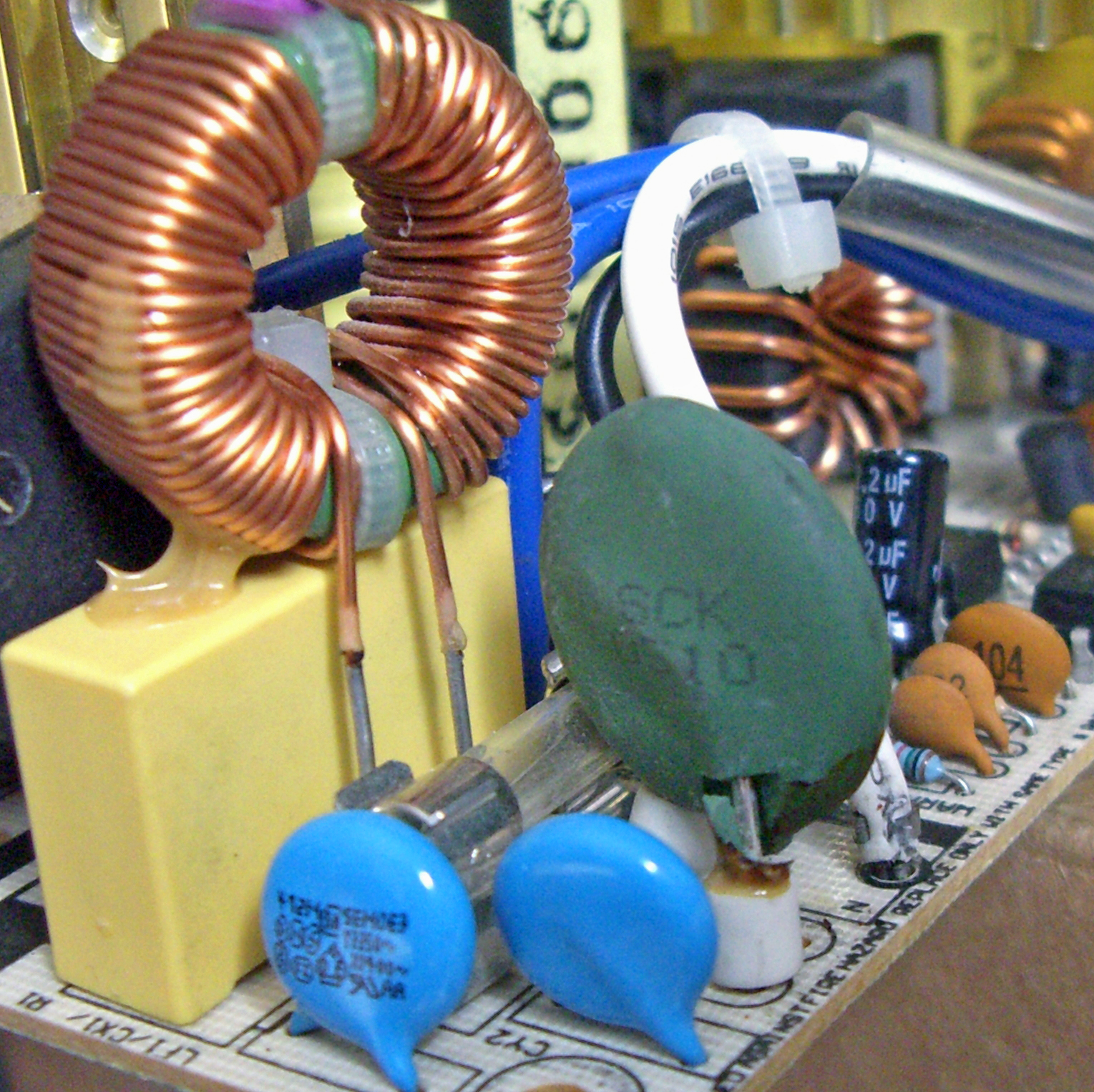

    EG465-VE PSU NTC thermistor
    NTC thermistor (Part #SCK0510) has cracked near one of the leads.
    Will it cause any problems? If so, what part would you recommend? Any advice would be much appreciated.
  • Toasty
    • Jul 2007
    • 4171
    Re: EG465-VE PSU NTC thermistor
    Should not be a problem. Thermal stress likely cracked the ceramic.
    Specs: NTC thermistor SCK-0510
    10 amp max
    20mm diameter
    5Ω at room temperature (25°C)
    Closest value in stock at Digikey is 570-1055-ND
    7Ω / 10A / 20mm
      Thank you very much Toasty.
