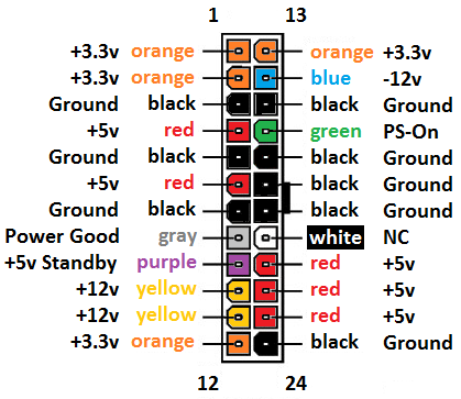

    Re: Dell SFF 760 blinking 3, but PSU
    interesting. I looked at the motherboard online and it looks like a regular 24 pin adapter, but yeah, sometimes the key is different on several pins
    here is a pinout of Dell ATX connectors
      Dell uses 24pin mini connector, not the standard ATX. And even if you find that small PSU, but with standard ATX connector, you will have to use adapter or cut the connector and solder the DELL mini connector.

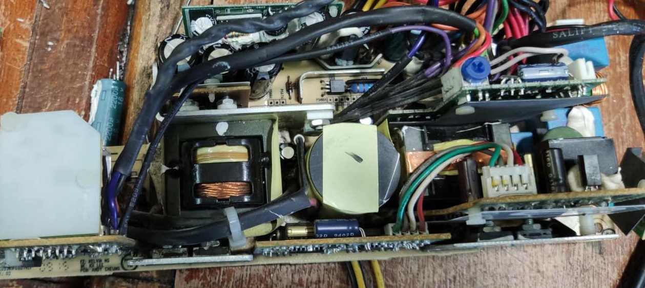

        Recap this, please. Photo attached. This PSU is complete nightmare.
        The engineers, who designed it should burn in hell.
        3 separate boards on soldered pin connectors, 90 degrees from the main board.
        To get to 2 of the caps, you have to unsolder 15 pin row connector.
        All 2200uF LTEC caps blown. One 100uF Ltec between the two transformers also blown.
        Not only this, but half of the PSU is glued using hot silicone glue.
        You have to first cut the glue while trying not to damage something and then unsolder the board, which on the photo is removed.
        It's place is in the middle, you can see the holes for the pin row connector on the main board.
          Nice to hear you got the power supply going!
          BTW, how old is the power supply? Looks relatively new-ish... though Optiplex 760 SFF I guess means at least around 10 years old. That's more or less inline with when these Ltec c[r]aps are expected to fail. IMHO, Ltec are probably the worst in these OEM PSUs. Samxon GF and Taicon tend to hold usually a little longer. Teapo might also... though they are a bit more hit and miss.
          All in all, nothing new here. Both Delta, HiPro (Chicony), and LiteOn use Ltec, so gotta watch out really in any of the OEM PSUs. Otherwise, though, they are pretty solid PSUs. (The newer ones, however, have APFC circuit, and that's another can of worms for down the road when it roasts is primary cap... at which point, the PSU probably won't be worth repairing... or maybe it will, given these are SFF PSUs and replacements aren't exactly cheap - especially if ATX pinout is non-standard.)
