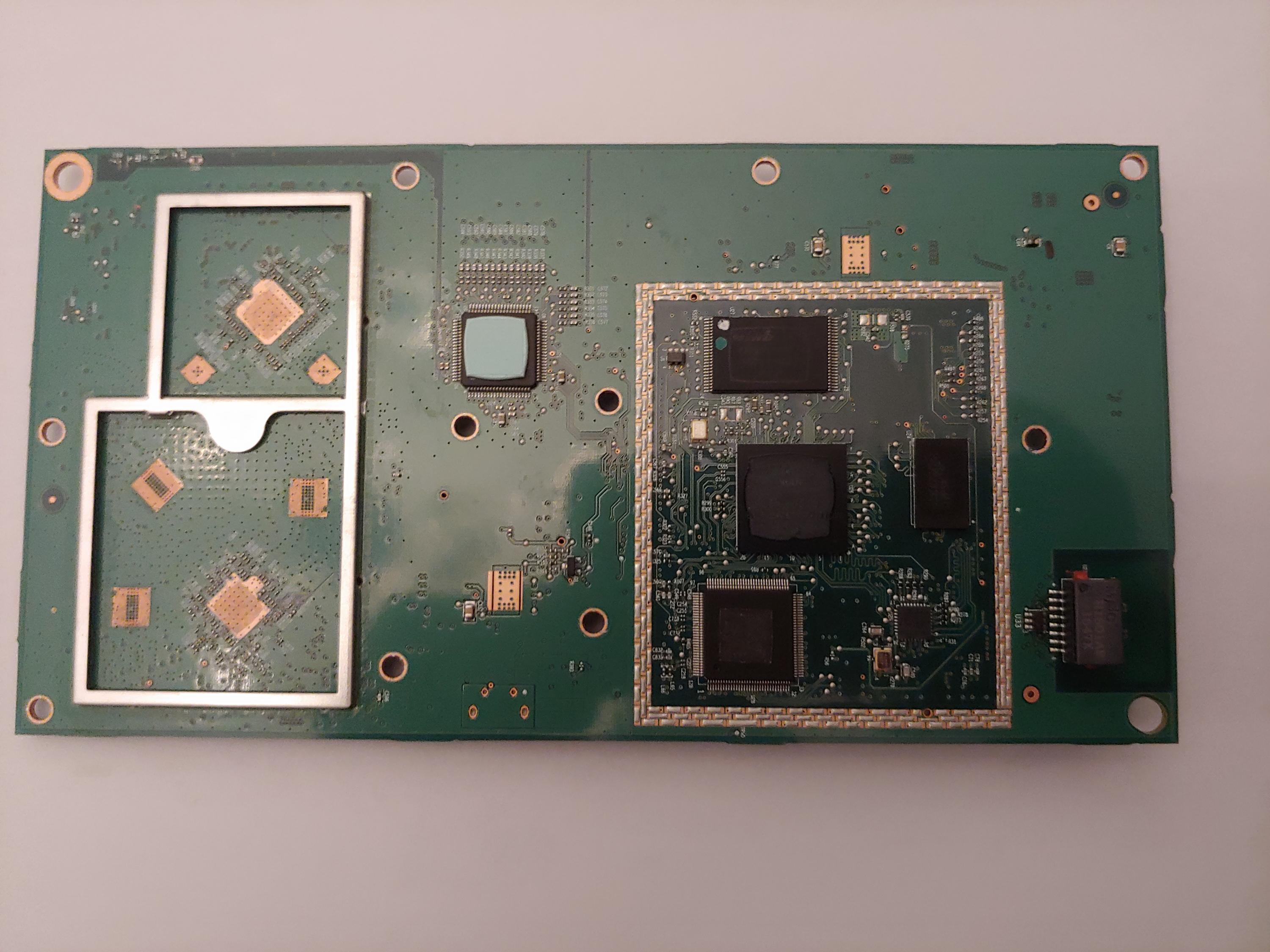

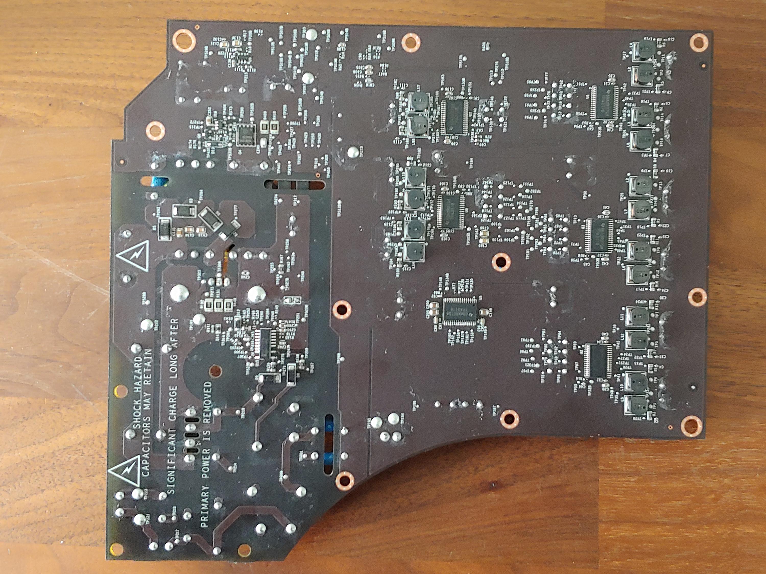

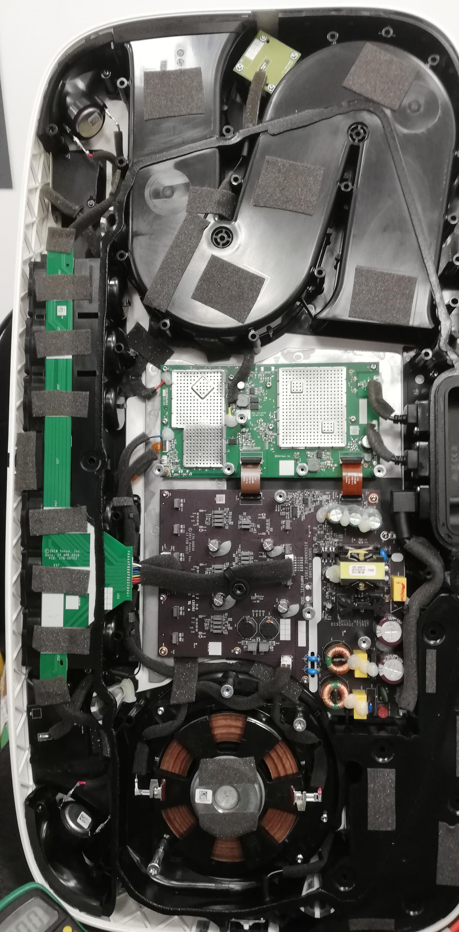

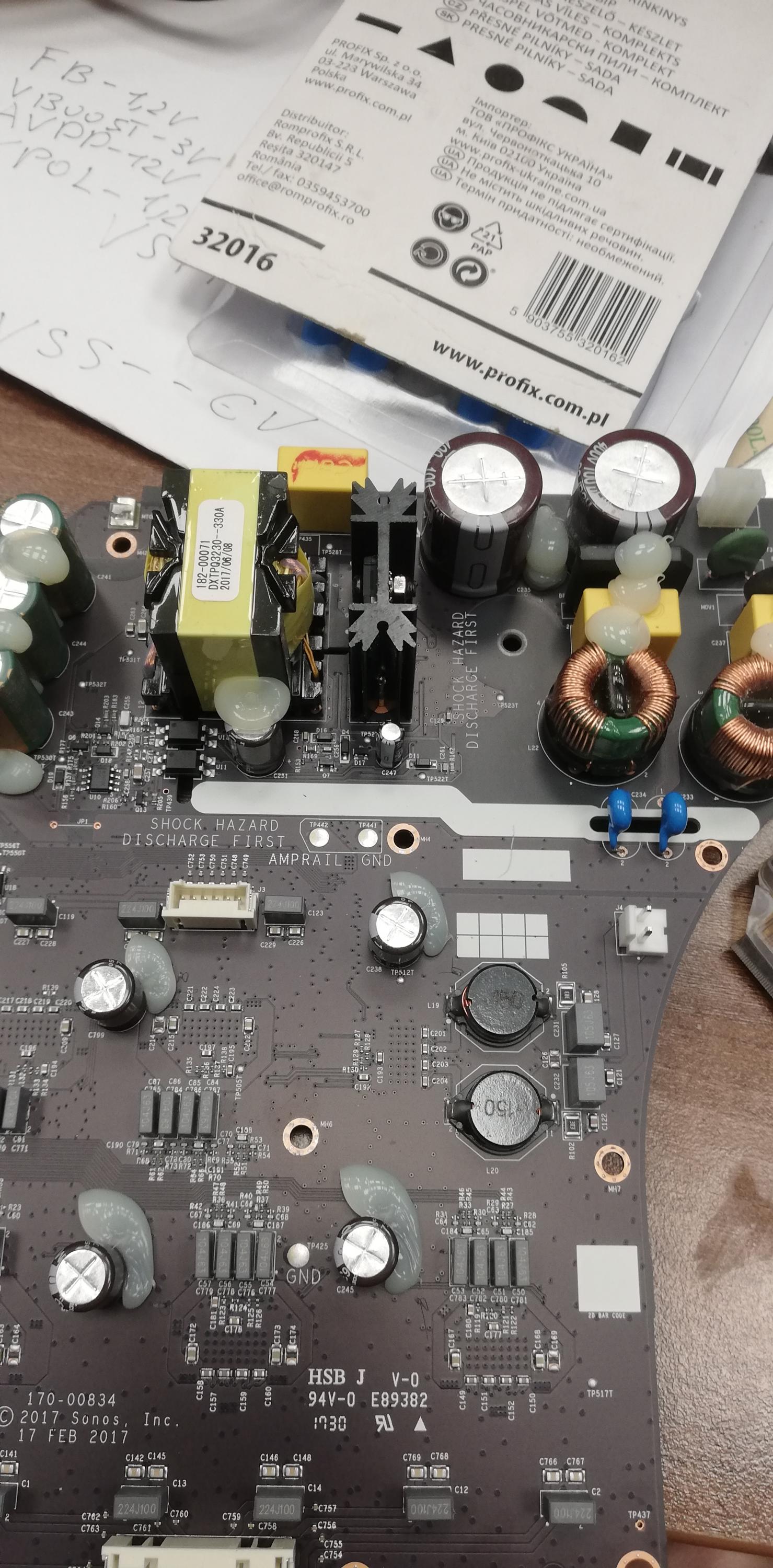

    Good days guys,
    First of all I want to thanks all members of badcaps. This site and its members have help me troubleshoot and repair tv.
    My issue is a Sonos Playbase S11 that completely died on me. Fuse check out ok. No indication of burn on the power supply board. The two big caps are showing 135vdc. I can't seem to find a schematic anywhere.
    I need your help once again.
    Thanks in advance.
    Images are attached

      Canadian AC Voltage is 120VAC, correct? If it is then the Main filter caps should have about 165VDC measured between the + and - legs of the main filter cap.
      What is the P/N of that SMPS IC, U15?, that drives the power MSOFET on the heatsink?

        Hi budm thanks for replying. That's correct canadian AC voltage is 120VAC. U15 P/N is NCP 1937B1G.
        Thanks again for your help.
          Re: Sonos Playbase S11 dead. No led at the front
          So recheck the DCV of the main filter cap again, the cap will be charged up to the peak Voltage of the 120V RMS, 120V x 1.414 = about 169VDC. So may be your meter is not calibrated or error in measurement.

            I double check with another multimeter and am reading 160.3vdc on the main caps.

              That is o.k. probably your mains are 110-115V.

                Is odd because the power led on the Playbase is not on. There is no switch to turn it on. You just connect the Playbase to 120vac outlet and the the front led turns on.

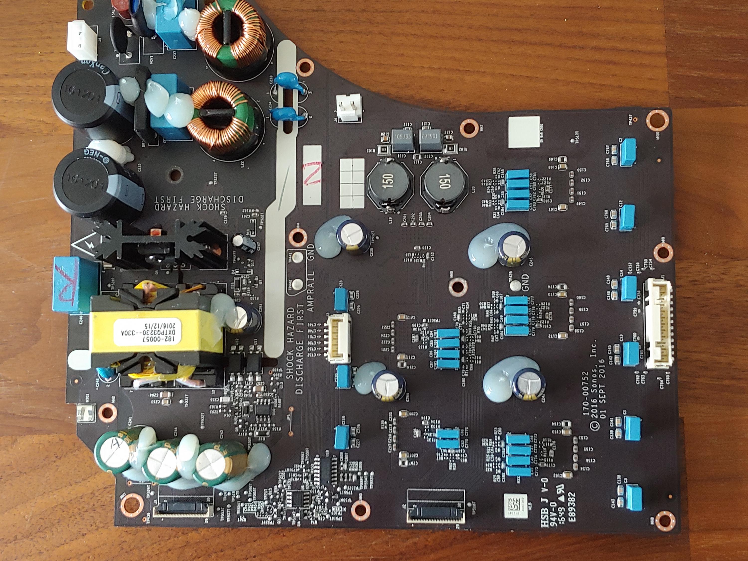

                  Are there any schematic of this power supply board around. Could someone help to troubleshoot the circuit.
                  • waakye
                    • Dec 2018
                    • 340
                    • Electronada

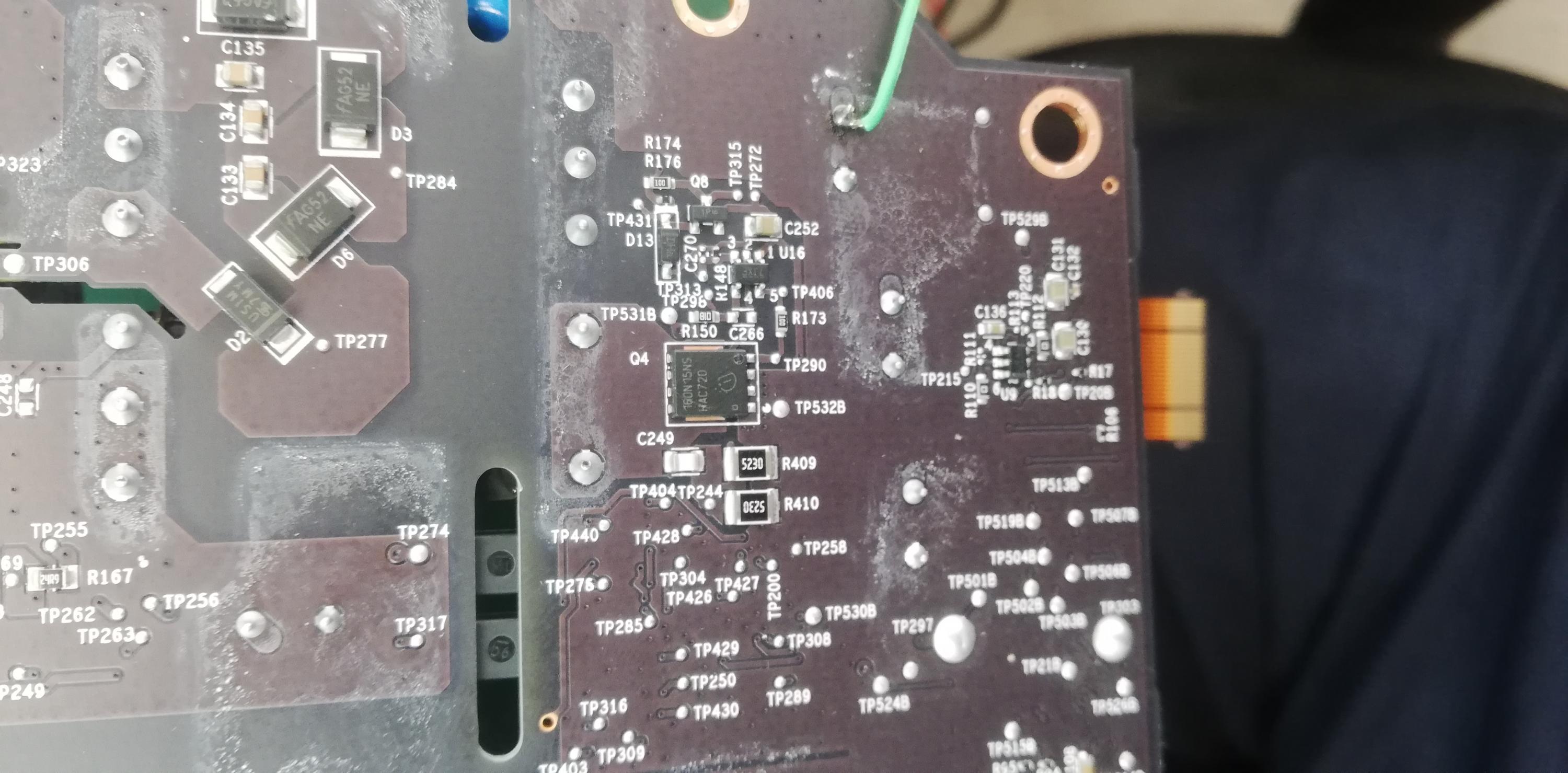

                    A more zoom in pictures below.
                    Thanks again

                            If you measure the DCV between the two legs of any one of the 3 lytics green caps that are glued together, do you get any Voltage when the AC is applied to the board? Be real careful not to touch anything in the hot, so to be safe you may want to plug the AC cord into GFCI outlet.
                            • waakye
                              • Dec 2018
                              • 340
                              • Electronada
                              Thanks budm for replying. Below are my observations:
                              I have AC applied to the power supply circuit and the each one of the 3 lyrics caps are measuring 13.25VDC and it jumps to 14.53VDC and it keeps cycling continuous from 13.25VDC to 14.53VDC.
                              Thanks again
                                1) So the power supply is not dead then, that power supply is an always on power supply, it will run 24/7 as long as it is plugged into the AC outlet.
                                2) What is the DC Voltage rating as printed on the bodies of those 3 caps?
                                3) There are four lytics caps on the cold side, so check and see if they have any DCV on the two legs of each cap, also tell us the Value and Voltage rating of those 4 caps.
                                • waakye
                                  • Dec 2018
                                  • 340
                                  • Electronada
                                  Hi budm. Thanks for the quick reply.
                                  1) If the power supply is not dead then that means the logic board is toast?
                                  2) the voltage rating on the 3 caps are 35V
                                  3) I verified the voltage on the four lytics caps on the cold side and all four reads 13.25VDC then goes to 14.53VDC and keeps cycling between the above values. The DC voltage rating on the caps are 50V.

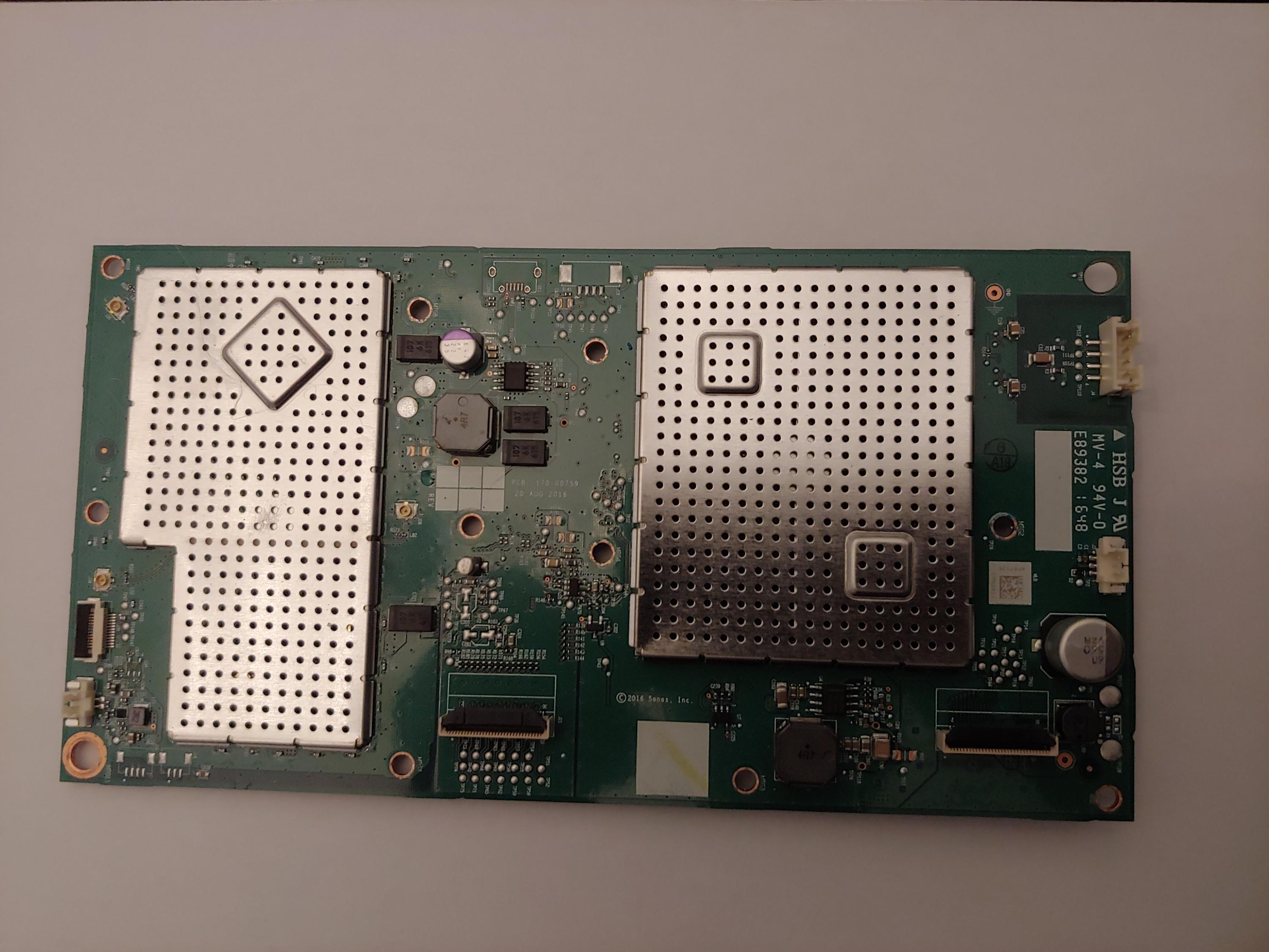

                                    The board you have is the power supply/Amplfier board.
                                    Can we see the main logic board next?
                                    • waakye
                                      • Dec 2018
                                      • 340
                                      • Electronada
                                      Hello budm,
                                      Below are the pictures of the logic board as requested.
                                      Thanks for your help in this.

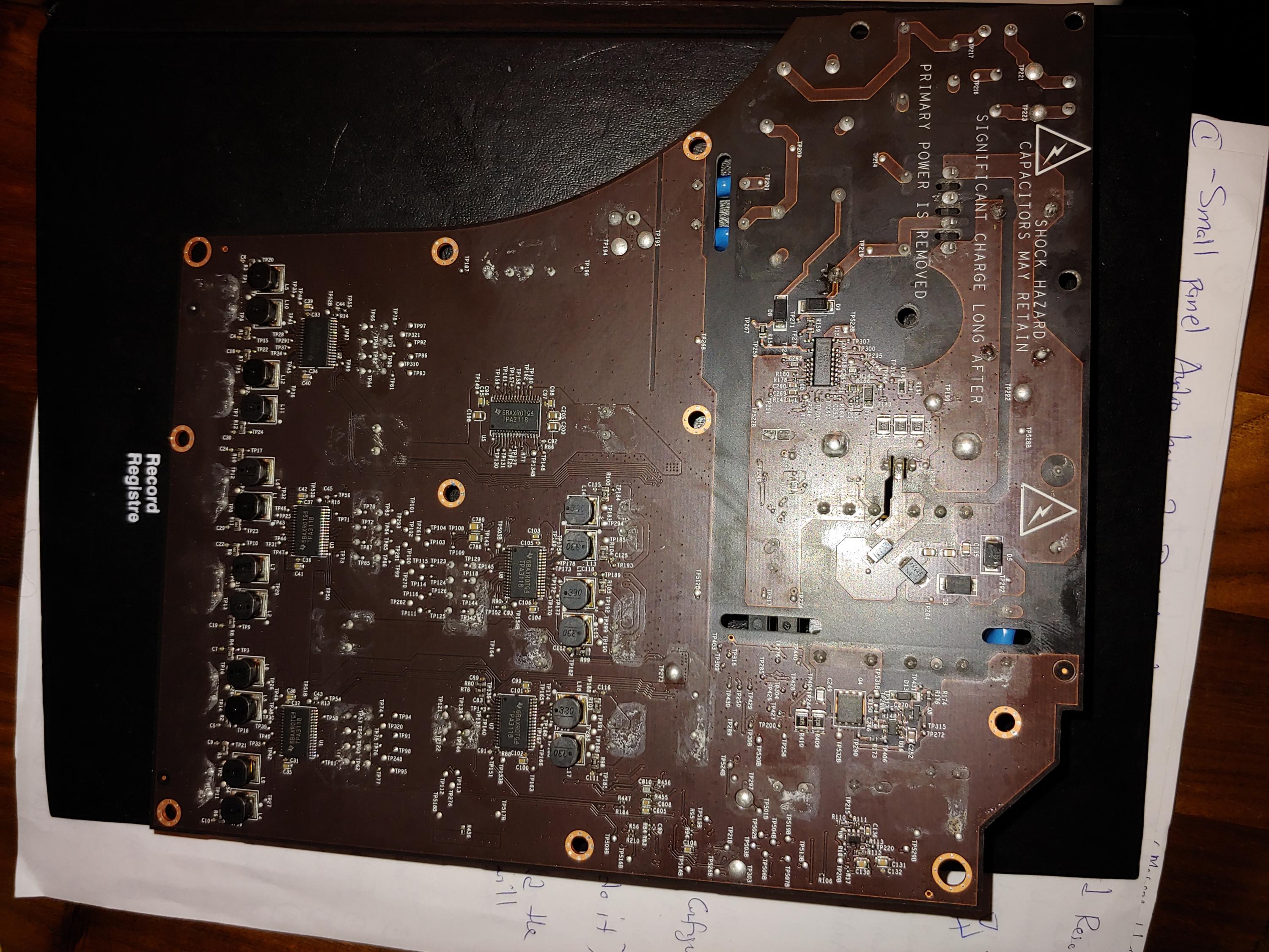

                                        I'm sorry I got into your topic. I didn't have any output voltage from the power supply
                                        There was a short circuit (0Omh) on the three Green capacitors
                                        As a diode, there is a mosfet Q4. It's been burned down.
                                        As I replace it I will say or do it
                                        PS/
                                        Author of the topic check the main voltages on the board (RAM,FLASH,CPU)
