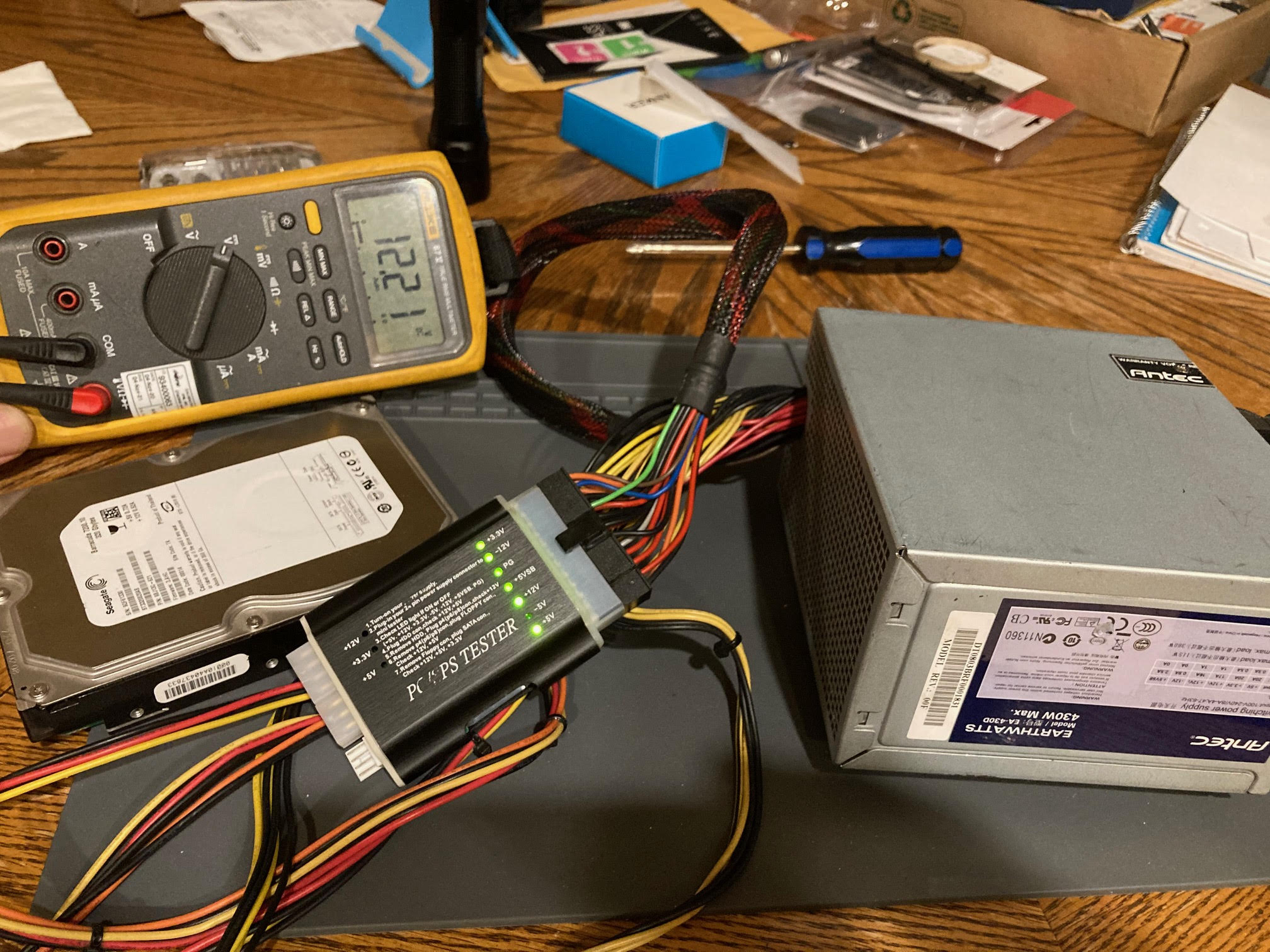

        Just wanted to give an update to let everyone know that the power supply is now fixed.
        Ultimately the main issue was the main 450V ( 270uf Aishi) cap. I replaced it with a Rubicon MXK 450V 390uf. And i replaced the TNY278 IC ( blown due to bad main cap). Now the 5VSB works and the power supply runs without issue.
        Thanks again for everyone's helpful comments and insight. I learned a lot and now have a deeper understanding of how it works. And would not got this far without the help to theorize and understand what was happening.

          Awesome! Great to hear your PSU is working again!
          And that Ruby 450V/390u should provide much better hold up time (from the larger capacity) in addition to lasting longer, as it should be capable of higher ripple current.
