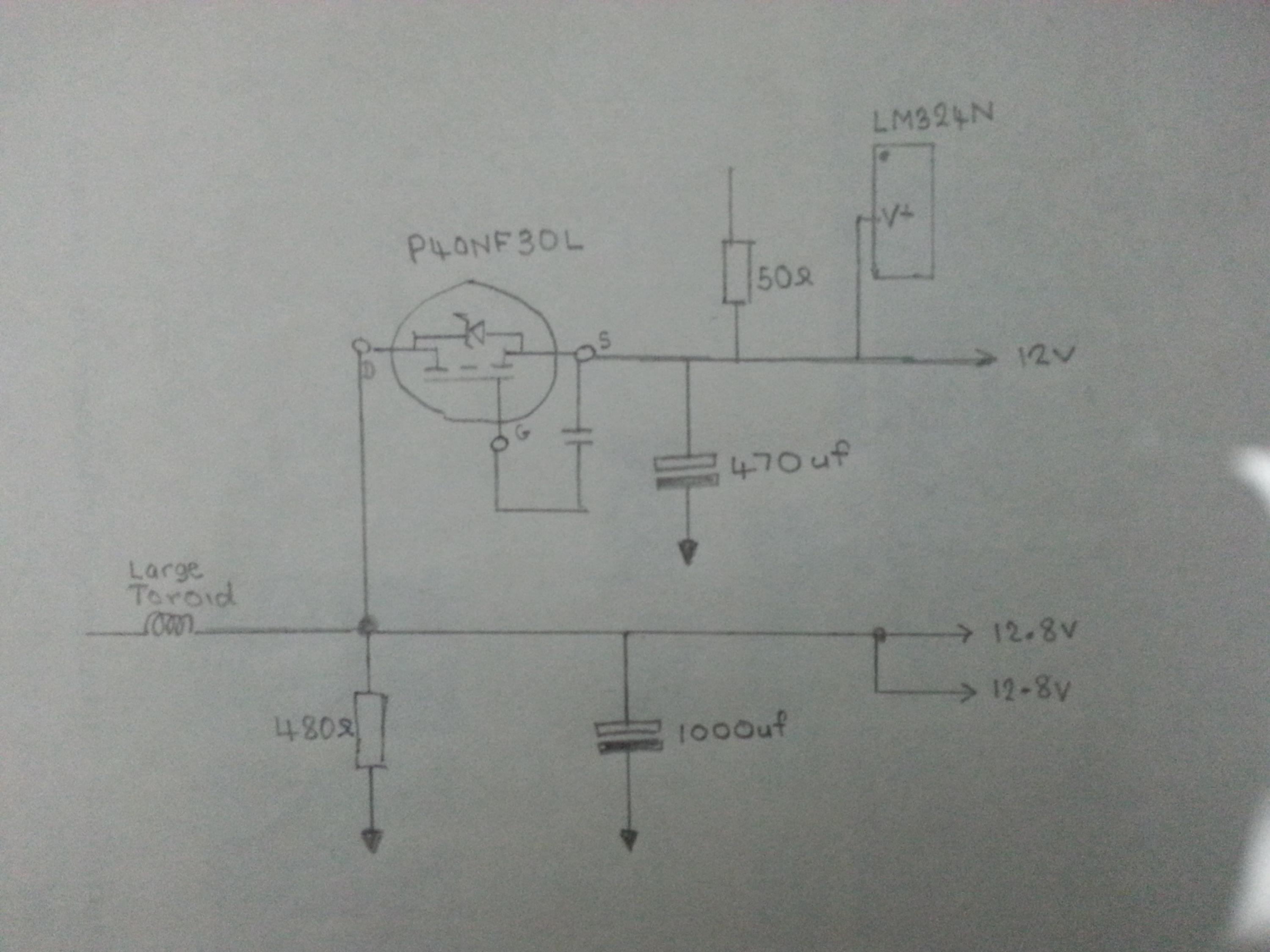

            I've traced out some of the circuitry and identified the components
            The MOSFET isn't shorted, but maybe it's still faulty?
            Could whatever it was that blew the primary side components also have damaged this secondary side MOSFET?
            Just because i could, i removed the 4 pin CPU plug from the motherboard and powered it from another PSU, but it didn't make any difference.
            So i get the impression that the problem is with the 12V rail, not the 12.8V rail

                  Originally posted by socketa
                  I tested the STP40NF03L MOSFET with the transistor tester, and it identifies it as an "N-E-MOS"
                  with addional information:
                  vt = 1.8V
                  Cg = 2.2nf
                  RDS = 0.2ohms
                  Uf = 632 mV +
                  Does that look OK?
                  Yes, looks pretty normal. If the TT tester was able to identify it, then that means the MOSFET is actually working.
                  Looks like the MOSFET between the 12.8V and 12V rail is used either as a linear regulator or just a simple pass-through device. Check your schematic, though - I don't think that circuit can work just like that, with the Gate only connected to the Source pin via a cap. There has to be something more. In fact, if that MOSFET really is to operate as a pass-through device (or a linear regulator for that matter), then the Gate must always be higher than the Source by at least as much as the Gate threshold voltage, V_th. And for that to happen, then the Gate has to be pulled up by an external voltage source that is higher than 12V.
                  with the theory that there is a problem with the 12V rail (that appears to be derived from 12.8V rail) ...
                  would it be OK (i.e. not cause any damage) to disconnect the MOSFET and then try and start it up, to see if 12.8V comes up?
                  Yes, you can try that test. The 12V rail will just not appear. That being said, I suspect the PSU will not start at all with the 12V rail missing (when you remove that MOSFET), as it probably is monitoring it, along with the 12.8V rail.
                  So when you had the PSU power up OK with the other (working) PSU feeding into it, did you have that PSU's 12V rail connected to this PSU's 12.8V rail or just the 12V rail?

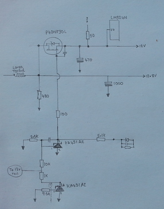

                    #69
                    Re: Compaq PDP-121P - Baked MOV
                    - yep, thanks for pointing that out (makes sense, and i should have recognized that there was nothing, on my drawing, to turn the MOSFET on).
                    i missed a thin trace that was going from the Gate, to a 100ohm resistor, and then to pin 3 (cathode) of a KA431AZ Programmable shunt regulator, that's located on the add-on board - i'll update my drawing later
                    And i'll check the voltage at the cathode of this programmable shunt regulator.
                    Just the 12V rail
                    • socketa
                      Asbelowsoabove
                      • Jun 2014
                      • 660
                      • samsara
                      #70
                      I soldered the 12V rail MOSFET back onto the PCB and connected an analogue meter to it's gate terminal.
                      Then i plugged the rail cables into the motherboard and put the power cord into the wall socket
                      (i'm pretty sure that these Compaq computers start up straight away by themselves)
                      Then the voltage quickly rises to 5.5V and quickly drops to 3.5V, and stays there until i pull the wall plug out, and it quickly drops backs to zero after about 8 seconds (probably after the primarys discharge)
                      Pretty much the same result if i connect it to the other side of the 100ohm resistor

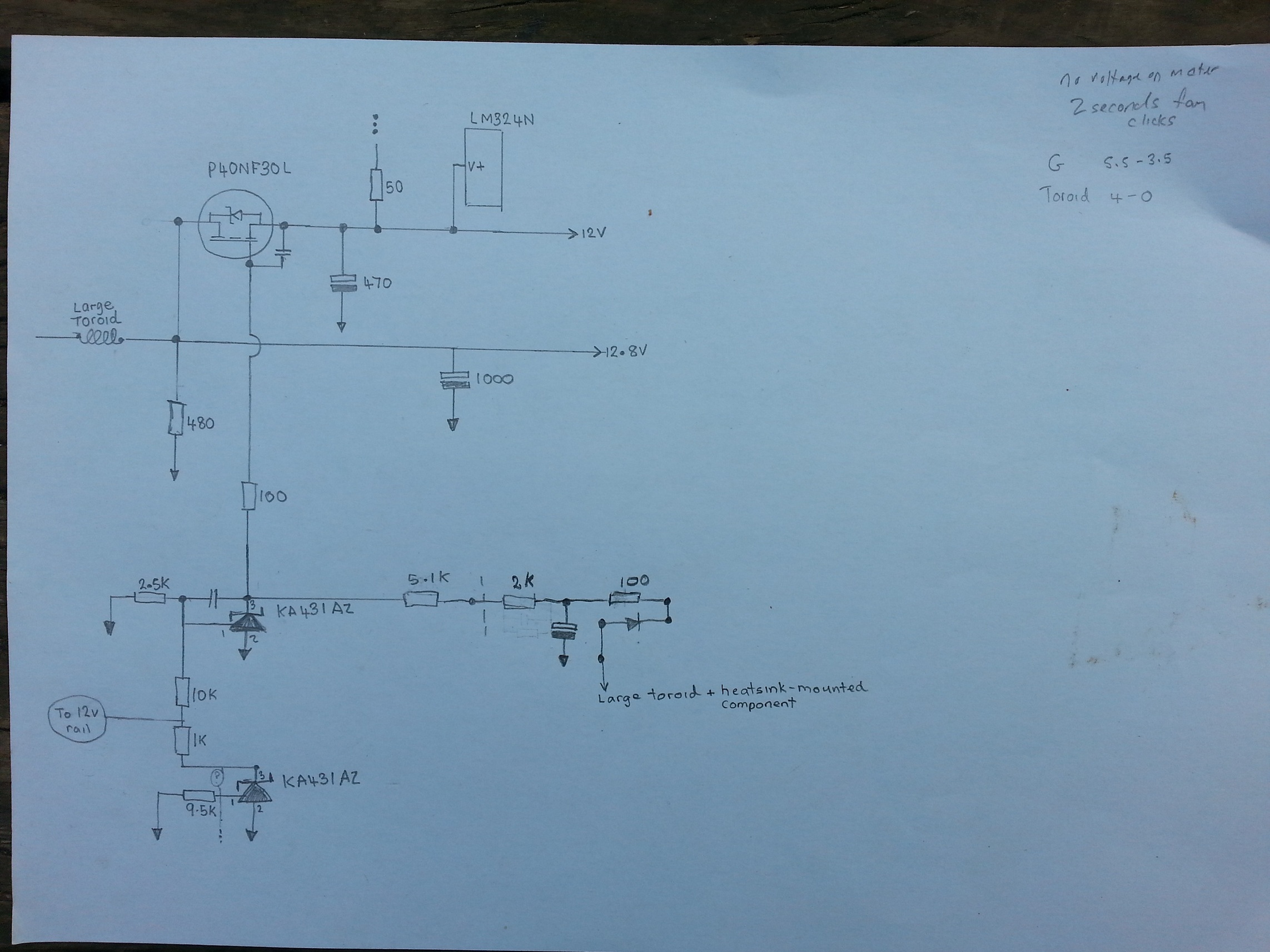

                        #71
                        Made an error on the schematic
                        Here is the correct version
                        After connecting the rail cables to ATX, CPU, and hard drive, and then plugging in at the wall:
                        Attaching a meter to the gate of the 12V MOSFET
                        There is initially no voltage
                        After a couple of seconds (i guess after the primary's charge up and the computer automatically turns on) the PSU fan clicks, and the gate voltage rises to 5.5V, and settles at 3.5V
                        If i, instead, attach a meter to where it says on my schematic "large toroid and heatsink-mounted component", the voltage rises to 4V and drops to 0V
                        So can we say for sure that there is some problem with the creation of gate voltage?
