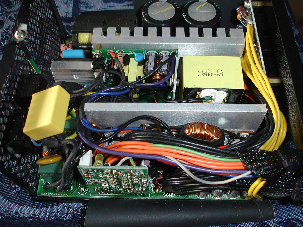

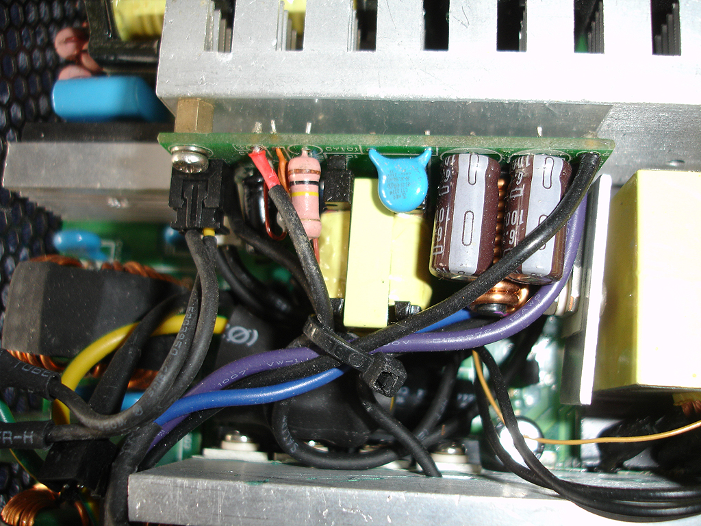

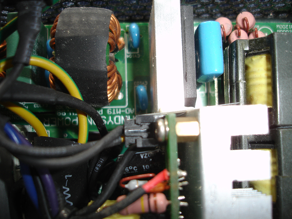

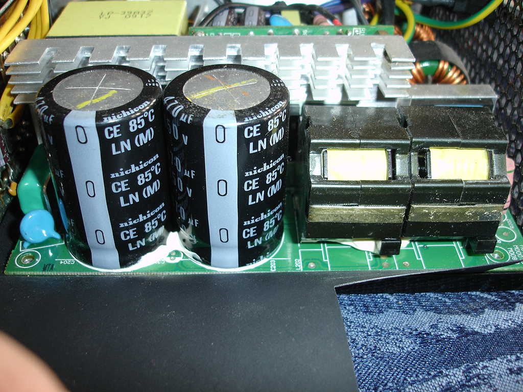

      • bigbeark
        • Jan 2010
        • 661
        Re: BFG 1000 PSU BFGR1000WEXPSU Died Suddenly
        Pictures attached. Test data to follow

                      I see this PSU appears to use all good Japanese caps, so that likely isn't the issue. The PSU also looks quite packed. So at this point, I think you will just have to get your hands dirty and dig in there - that is, remove the PSU PCB from the case and attach a temporary plug to the Live and Neutral inputs to test the PSU as we go along troubleshooting. We will need access to the bottom of the PCB to take voltage measurements, so that's why you will need the PSU exposed like that. Do note that there is danger of high voltage / shock when the PSU is open like this, so you'll have to be really careful not to touch anything on the primary side when the PSU is plugged in. If you're not comfortable with this, just say so. Otherwise, please provide pictures of the bottom (solder) side of the PSU PCB - preferably high-resolution ones, so we can see/identify parts. Also, try to note all ICs you see on the primary side of the PSU and post their part numbers here (since we may not be able to see them all from the pictures.)
                      You will also need to check the voltage across the two big 450V caps on the primary at some point (note, this is the dangerous high-voltage part.) Since you're in Canada (120V AC mains), you should be getting about 160-170V DC when the PSU is plugged into the wall but not forced to turn On. When PS-ON is connected to ground and the PSU is supposed to turn on, those caps should have about 380-390V DC across them. Since your PSU is not turning on, you need to check if the voltage on those caps actually tries to go up or not as you connect PS-ON to ground. If not, then the APFC may have a problem, or the circuit responsible for sending signal to turn on the APFC (and then primary side switching devices) may be faulty.
                      It may also be helpful to test the outputs (3.3V, 5V, and 12V rails) for short circuit - measure resistance between these to ground (with the PSU unplugged, of course) and note what resistances you get here. I doubt we will find anything wrong there, since a shorted output will typically make the PSU try to turn on (fans in the PC and PSU spin for like half a second, then stop), but then stop - i.e. a short "blip" of power.
