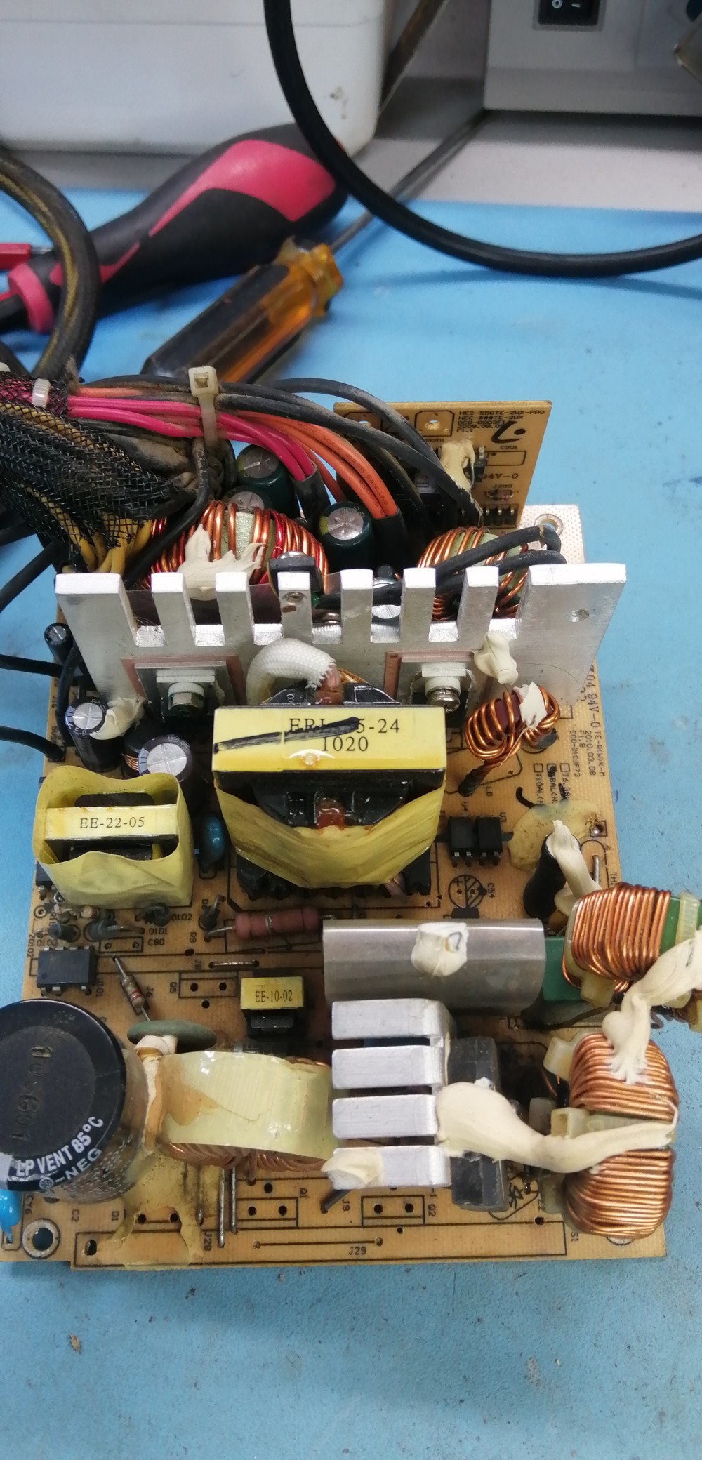

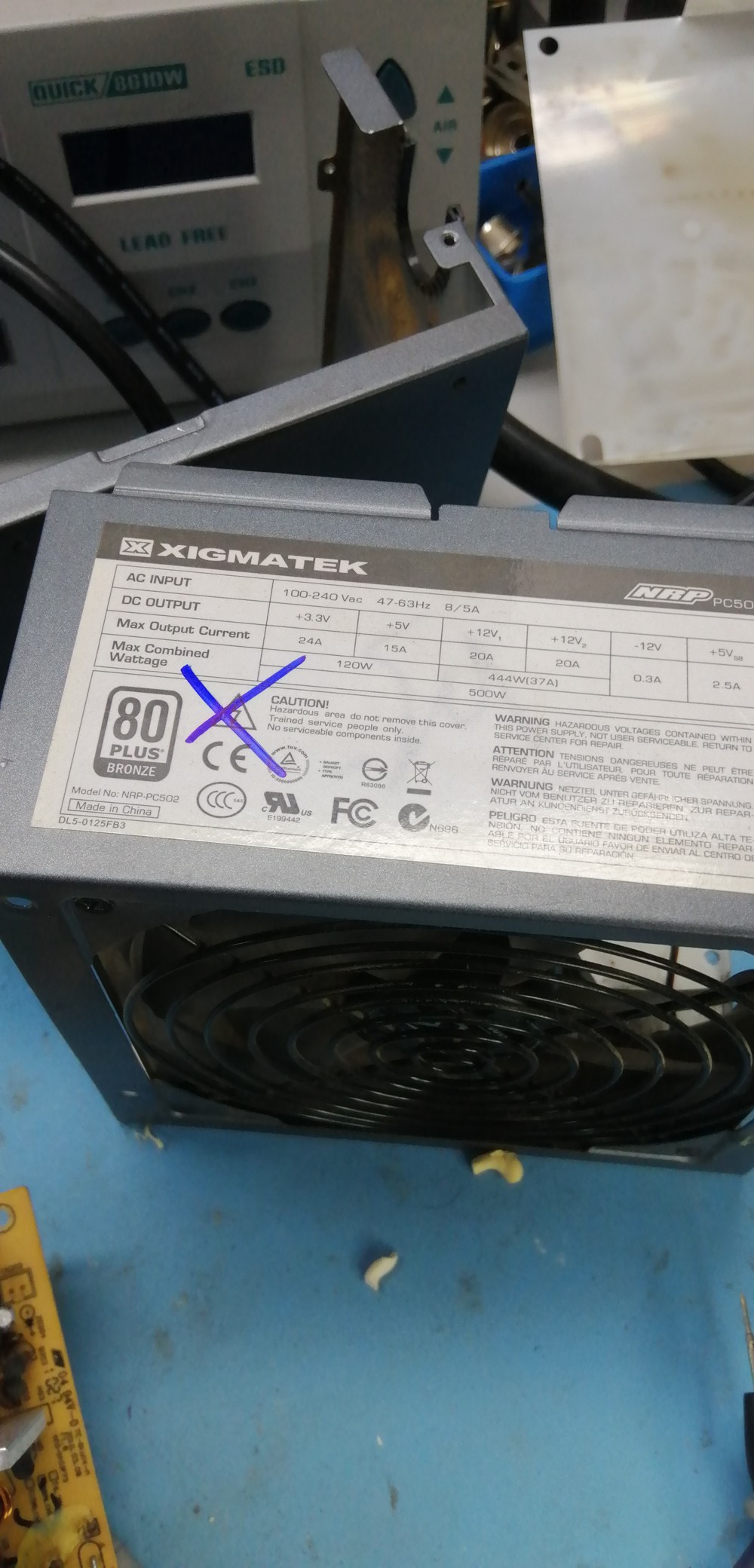

    This ATX PSU is off a customers computer. Originally it had a faulty motherboard GA-X58-USB3 that had a VRM fault. I fixed that and returned it working, but when he plugged it in something went 'pop' and it went dead.
    I have the PC working again using my test ATX PSU so I decided to look at his PSU
    Its a Xigmatek 500W ATX
    When I opened it up the whole thing was full of dust, dirt and fluff.

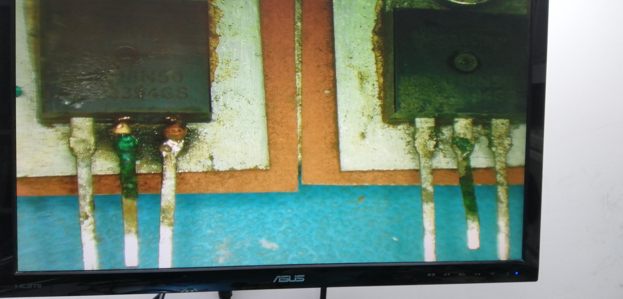

    The in-circuit fuse on the 220V input has blown
    I cleaned it all out, then removed the heatsink with the Output MOSFETS that drive the main SMPS transformer. They test OK, but I noticed a small wire (looks like a component lead) down between the heatsink and the SMPS transformer and it is just sticking up in the air and doesn't do anything (see pics) I can't figure out what this is supposed to do.
    The Output MOSFETS tested OK so I then removed the other large heatsink with the PFC MOSFET(s) and the main PFC circuit Diode - at least that is what I think it most likely is.
    Now here is the interesting thing, one of the PFC MOSFETs looks like it has blown, in so much as the Drain and Source legs look partially melted where they enter the body, and there is some evidence of blast 'deposit' on the heatsink behind it - but the odd thing is it tests OK as an N-Ch MosFET same as it's comrade in arms next it. They are both 18N50.... But it definitely looks like it's blown even though it test just fine.
    See pics.

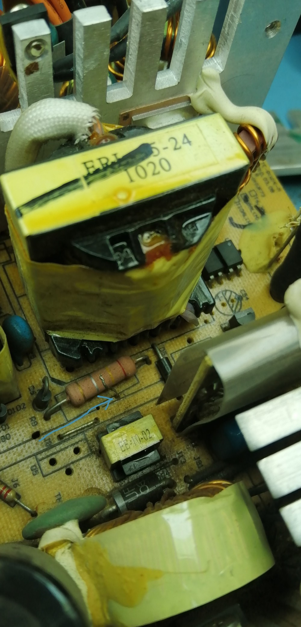

    And any suggestions? My guess is the dust/dirt/fluff went conductive around the device legs and that is what went pop, not the divice itself - and if I put it all back together it might even work - but if that is the case I have to say I've never seen that before in over 40 years messing with electronics.
    Then there is that wire sticking up doing nothing useful that I can think of
    Suggestions?

    Re: Xigmatek 500W ATX PSU went POP and stopped working
    they look like salvaged mosfets!
      That may be how it looks but I'm 100% sure they are the originals as there was no sign of any previous rework
        That short jumper wire looks like it was soldered into that hole closest to it and one end was unsoldered for some reason. Does the solder side of the hole look like it was soldered?
          No. it's just a hole, no pad. It looks like it was/is/could be used to short out a small 10R SMD resistor (R11) on the other side, because the end of the wire that is soldered actually also passes through a hole with no pad, and is then soldered to one end of the resistor. it's not 100% obvious whether the other end was ever soldered or not. It certainly hasn't broken off but it could have been deliberately unsoldered.
          I still don't see the point of it, why not just fit a 0R resistor in place of the 10R resistor if you wanted it shorted for some reason?

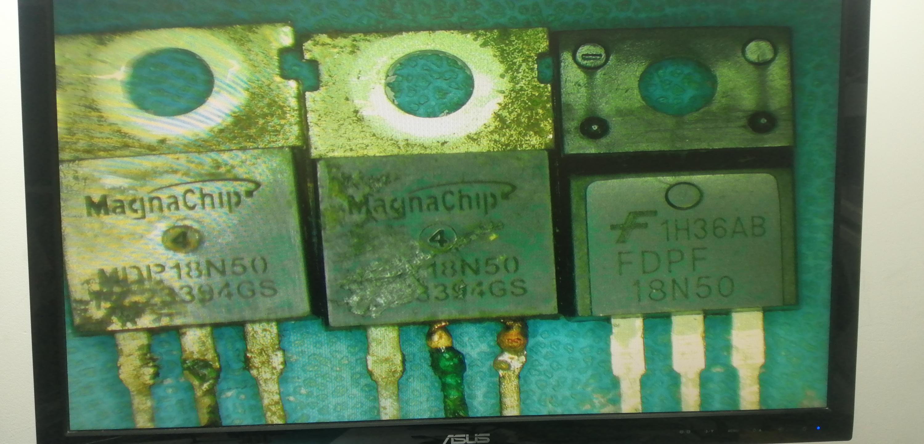

            Hmm no it doesn't 'just work' once I put it back together (minus all the dust and fluff)
            With a light 220V bulb in series, the lamp lights up quite brightly - I would expect it to light then go dim/off with the PSU in standby
            I only get around 0.3V on the SB supply and about 25V on the main electrolytic after the Bridge/PFC so I am guessing that the dodgy looking 18N50 in the PFC is breaking down under load. The two 18N50s look to be in parallel, with a 20R resistor on the gate of each, driven from the same pin on the controller
            These 18N50 are very cheap on Aliexpress so I think I will get some to try to fix it, just out of interest really.
              Those 18N50 on Aliexpress are 100% fake. If you measure their RDSon you'll see its much higher than normal. It's better to salvage the mosfets from another PSU or buy from a legit supplier

                I have seen that same green crystaline glue dawbed all over the leads of PSU fets and rectifier packs before. Usually to hold down ferrite beads. i have not as yet seen any conductivity issues with it. But you never know. BEWARE of that yellow glue that turns brown/black, that is conductive.
                  ^^ THIS ^^
                  Clean out ALL of the tan/beige glue from the primary side - especially from the APFC coil and on any traces (especially high-voltage ones.)
                  Also pull the big mains 400V CapXon cap and check its ESR and capacitance. Better yet, just change it. APFC does NOT like cheap cap brands and tends to roast them after a while. Heck, even good Japanese brands tend to get roasted in APFC circuits. A lot of that has to do with cost-cutting too. 400V caps, especially GP 85C ones really aren't adequate for APFC circuits. Use a 420 or 450V cap rated for 105C and preferably something that has a higher ripple current rating. The combination of high frequency ripple and high voltage is really what roasts most PSUs with 400V-rated caps. Adding a 630V 0.1 to 0.47 uF ceramic or 1-3 uF film cap may help ease some of the high-frequency ripple from the mains cap (and will also provide a safe place for the APFC coil to dump its load, should the primary cap fail open-circuit.)

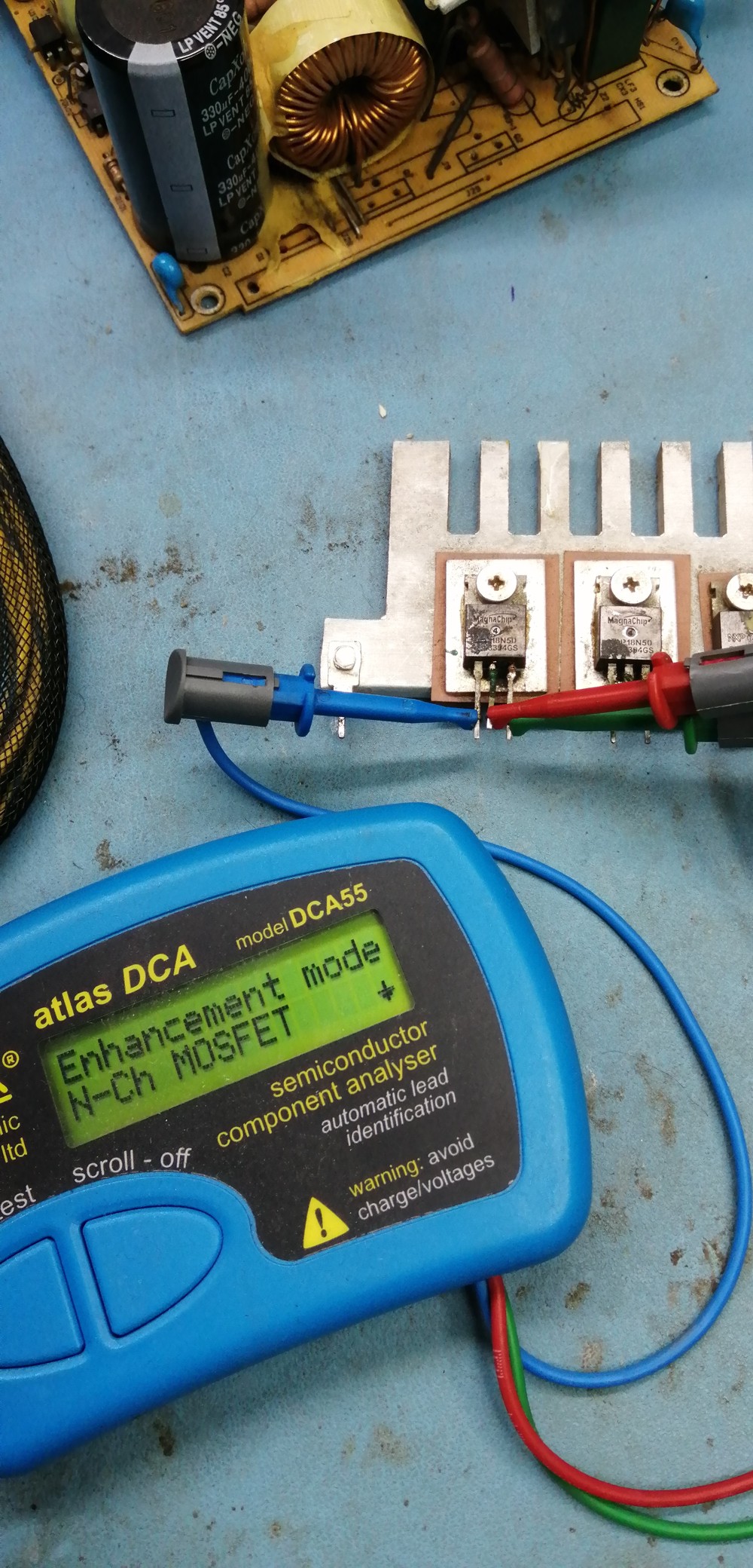

                    I like to tidy up my threads so...
                    Sorry I didn't see what MHTSOS put until after I had ordered some el cheapo 18N50s
                    Sorry I didn't see what Momaka put until after the 18N50s arrived from AliExpress
                    So anyway I fitted the new MosFETS in the PCF circuit, left my light bulb in series and the PSU powered up and I have 5V Standby with the light bulb flashing once them dimming out to nothing. So I connected a load (old faulty HDD and a 12V fan), forced the ATX PSU to 'on', bypassed the light bulb.... and it powered up and ran just fine.
                    So it seems that the doubts about cheap fake 18N50s and capacitors in this case were not applicable
                    Actually about the cheap FETs from Aliexpress - the ones in the pic on the listing look like some generic make, but the ones I received were Fairchild branded.
                    https://www.aliexpress.com/item/4000...3da24c4dku4X7Z
                    They all test OK on my DCA55 - they all have the same Gate threshold 4.39V (where as the original Magnachip read 4.42v) and they seem to be good.
                          Well, not so fast!
                          You will know if those 18N50 are up to snuff only once you give the PSU a more serious load, like a PC with a power-hungry GPU and CPU... or more ideally, a full-rated load according to the label. The problem with cheap MOSFETs is not that they don't work (they usually do), but rather that they tend to blow at a much smaller load than reputable-made ones.
                          And as for what I said about the primary Capxon cap - that still stands true. Even if it isn't bad now, it just won't last very long. I know those big caps are expensive and make the repair almost not worthwhile... but when (not *if*) that cap blows, it will take out the APFC MOSFETs, and possibly a good deal of other primary components as well (APFC controller, typically, among other things.) And that will make the PSU certainly not worth a repair again. Not to mention there is also a risk of damage to any connected PC components.
