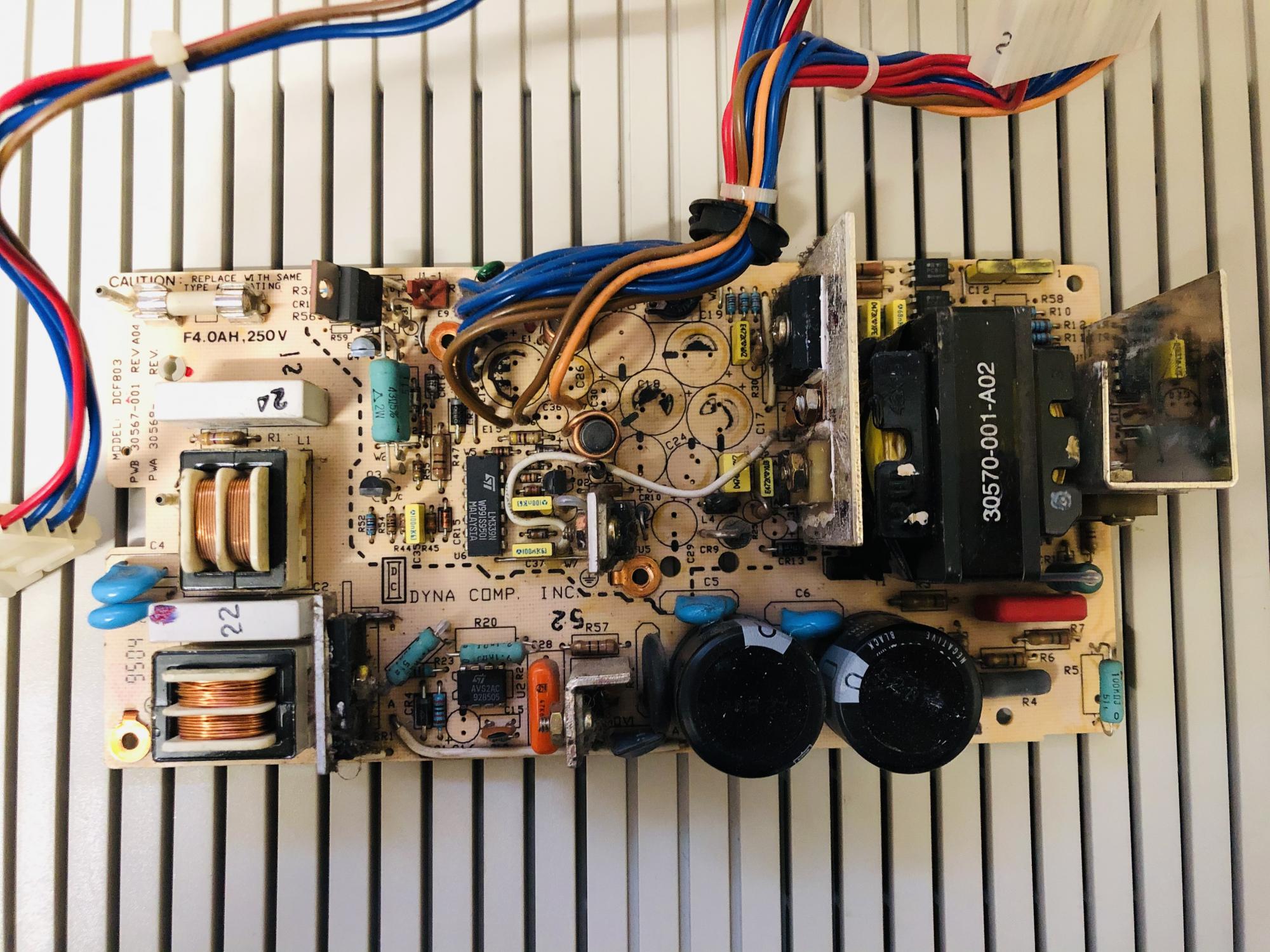

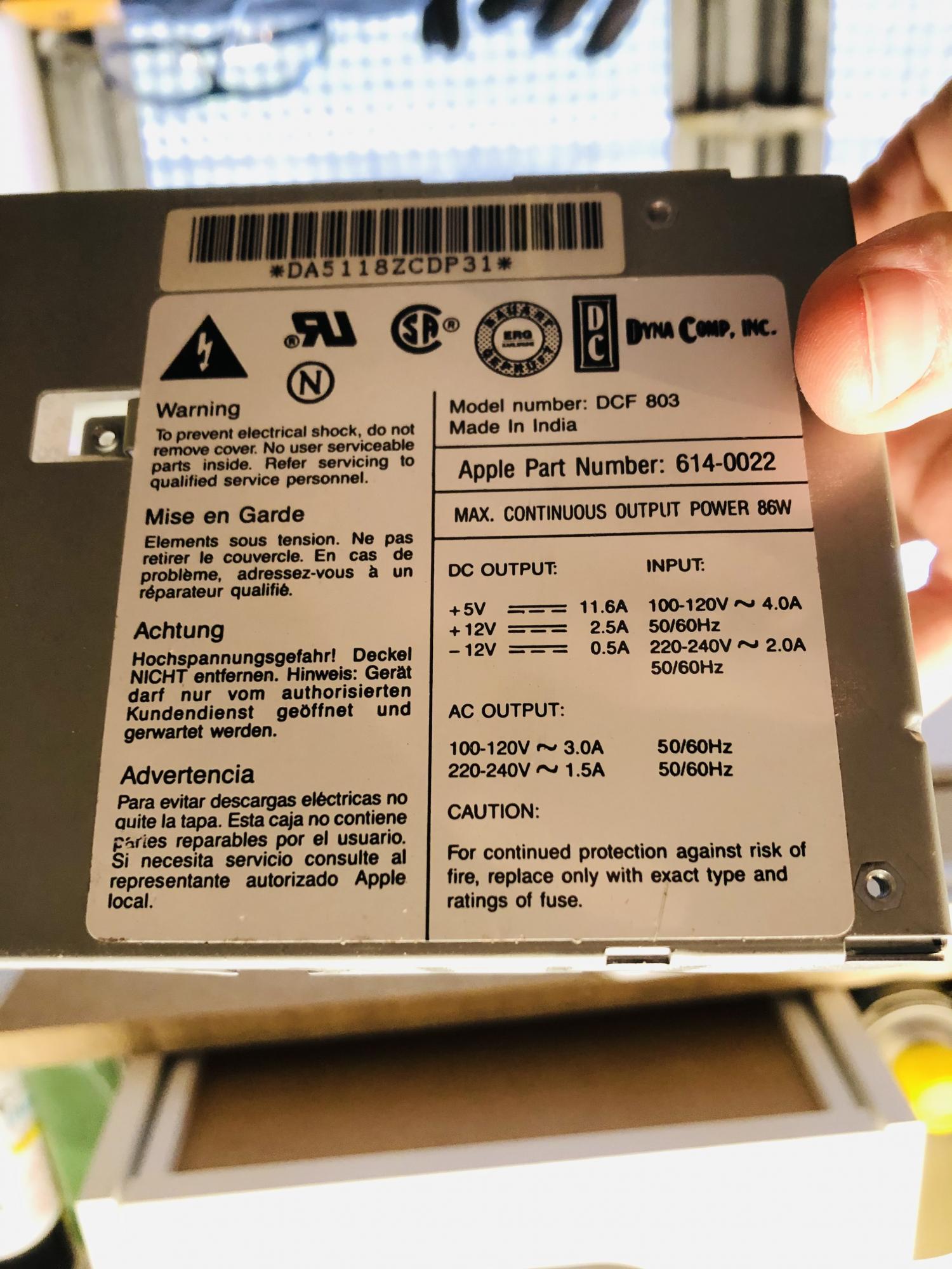

    Hello folks!
    I am currently working on a Macintosh 6100 Power Supply and I really need a capacitor list! Maybe someone has such a computer and can open it to tell me which capacitors belong where.
    Apple Part Number: 614-0022
    Thanks in advance!

    Re: Macintosh 6100 Power Supply
    Looks like that's an Astec AA16990. Is there a reason you are assuming the problem is a capacitor?
      Thanks for the reply!
      I have already seen this post and this is not the PSU I have.
      My problem is that I have a PSU without capacitors and therefore I need this list I talked about.
        Missing capacitors would definitely be a problem. I'm not even familiar with the PSU brand, but my wild guess would be that the smaller output capacitors are 1000uF and the larger 1500uF. I don't think a guess would be good enough to go with, though.
        Since that was built in 1985, most currently available low impedance capacitors are much lower impedance that what was originally installed. When you settle on values I'd suggest Nichicon PS or PM series. Or possibly PJ series.
              I'm new here but have recapped a 660AV that this power supply powers. I've also fixed a bunch of other things kicking around the house with bad caps.
              I know it's a year ago that you posted this but I have this exact power supply! The Dyna-comp DCF 803, not the ASTEC!
                    Power Macintosh 6100, it looks like, based on both the date code on that PSU's PCB and a hit on DuckDuckGo.
                    Several machines share the exact same chassis and power supply. There is more than one power supply model design that share the same Apple part number.
                    Unlike other threads on Badcaps here, where these machines contain an ASTEC power supply, mine has this Dyna Comp Inc. unit instead.
                    Instead of it being multiple boards like the ASTEC, mine looks exactly like the single PCB power supply as pictured above, except I have all the original caps on mine and it is working.
                      I pulled all the caps off the board last night. It was quite tricky, because they decided to manufacture it by bending the cap's leads quite far over and leave big tails, and solder them all down. It took a lot of heat to get a mini-screwdriver under each lead and bend it up straight, clip it off and remove the caps.
                      My board did not have any errors regarding the polarity of the Electrolytic caps. The silkscreen shows a +, and before soldering, they clearly had someone mark the (-) lead with a dashed line using a sharpie. If you use isopropyl alcohol to clean the board, you might lose these marks.
