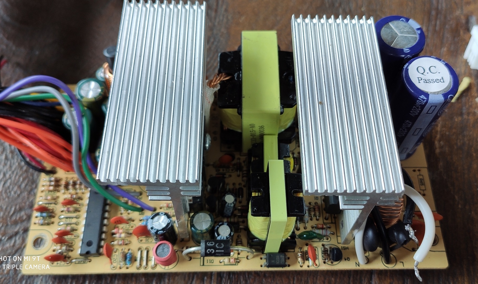

    If that thing is identical to the L-LINK you linked, it's basically a 150W power supply. I doubt the main transformer core is good for 200W, and those input electrolytics might have decent filtering and hold-up for 200W.
    It is the same PCB model, although I noticed that in the core of the transformer that carries the 3GO puts ERL35 (although I doubt it is true, it is too small to be an ERL35, I think it is rather 28 same as the L-LINK ), and has a small PFC winding and an X2 capacitor (in the area where RX1 is written in the L-LINK PSU), but the rest is the same, even the model is the same (zf-2012b) except the REV which is VER2.0 the L-LINK and the 3GO VER2.1.
    And I realized that it has tin balls stuck in some components.
    Then I will put more detailed photos inside the PSU.
    You may be able to deliver 150w, but surely take a terrible ripple on the voltage lines.

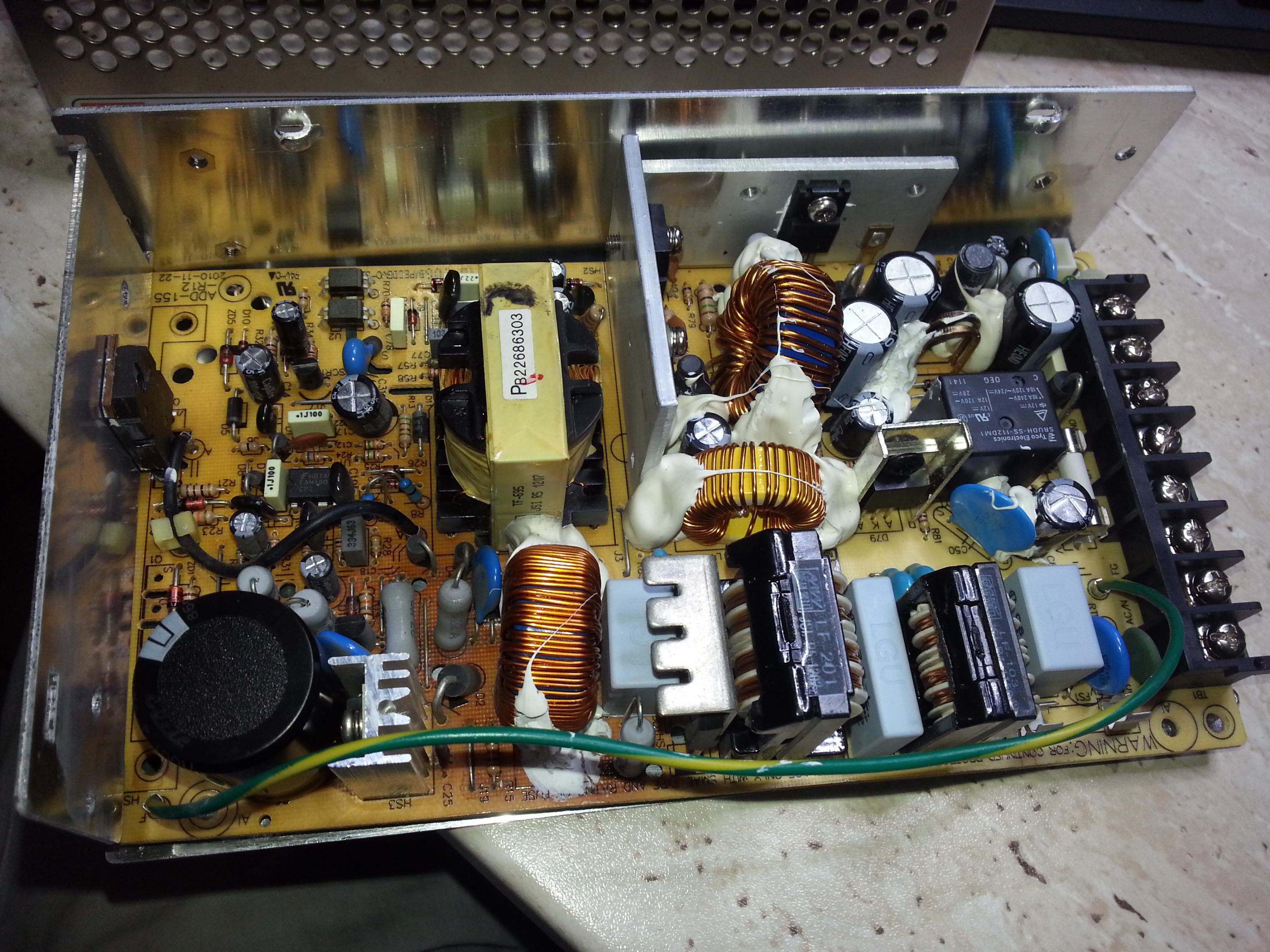

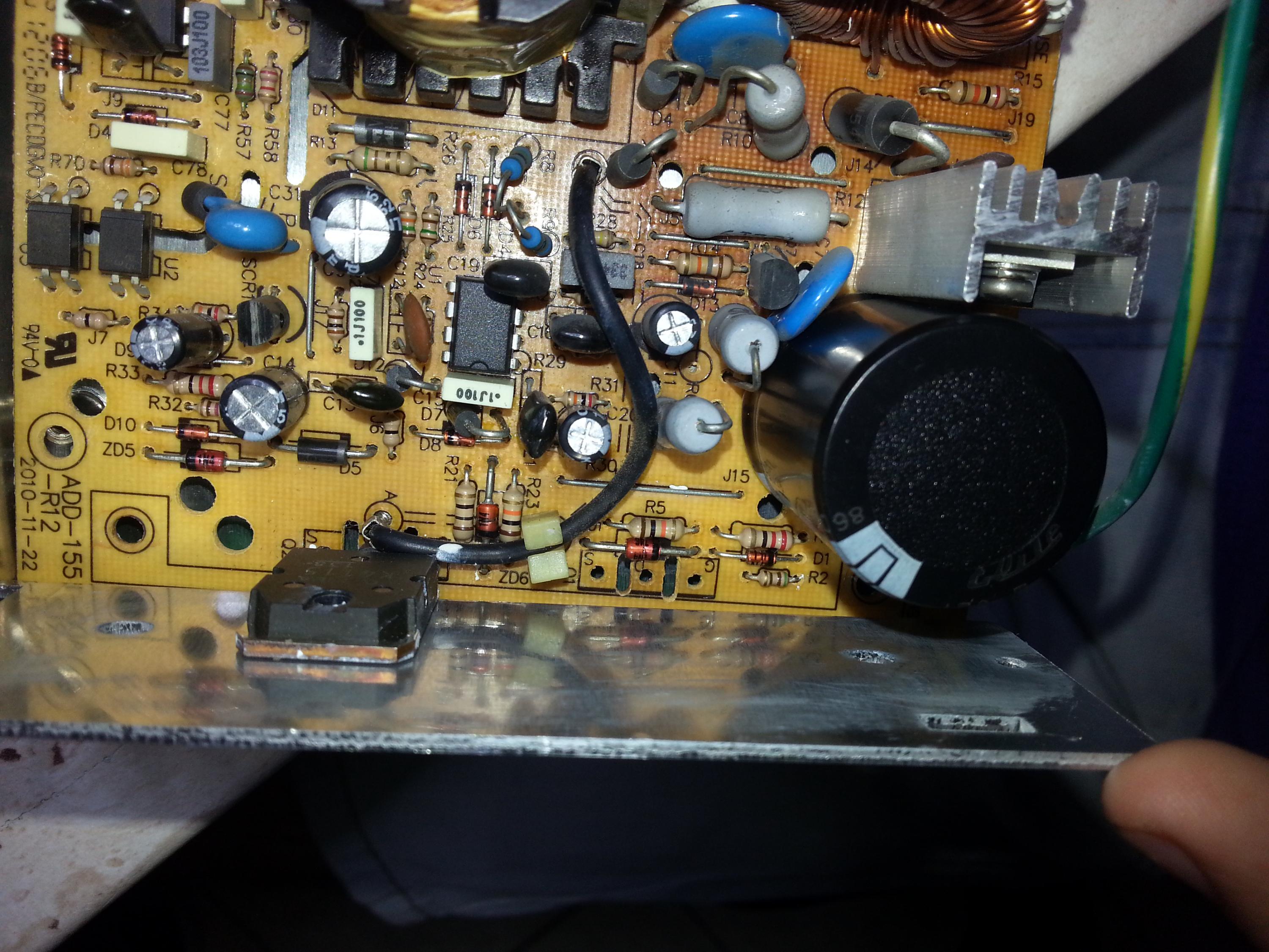

      Here's another long story of mine
      This one isn't so much about a "bad" or laughable power supply by design like others, as it is about how it actually failed, since I found it rather interesting and it might actually be a first occurrence to me: this is a "MeanWell" supply that powers several CCTV cameras and electromagnetic locks (the combination is pretty unusual) at a small shipping container somewhere in the middle of a field/nowhere which houses various equipment for gathering data about residual waters in the area, but that's beside the point.
      We were told that only a few cameras were still operational there (they're remotely accessible from a head office) and that the gate for the outer fence and also the door of the container itself wouldn't open by means of the RFID access cards these chaps use to get in/out, so we went down to investigate and got in using the regular key. There's 3 of these supplies side-by-side inside a control panel, making it a pretty hot environment in there. These things get.....hot...VERY hot - you can barely hold your hand on the metal casing, so they fail fairly often. I've fixed like 4 of them in 1 month. The most common issue is faulty caps of course, which in the case of these particular supplies most often resulted in the supply failing to turn on intermittently, accompanied by the random clicking of the output relay for the SLA backup battery, since I forgot to mention these are "backup" PSUs which have a terminal for connecting a SLA in parallel to the output which basically kicks in when the SMPS shuts off, so there's a relay inline with the battery that prevents it from being connected to the output immediately, unless the SMPS has powered on at least once to pull the contacts of the relay together. At the far side of the output screw block you can just about make out a white header: if you shunt its pins, that sends the battery's own voltage to the coil of the relay so you can turn on the output on battery even without mains present.
      The power LED was indeed off on this one, so it was totally dead. I shunted that header with a screwdriver just to ensure the devices reported as non functional still power on fine once they get their power, which they did. I took the PSU out of the panel, replaced it with an identical functional one we always carry around as a backup to keep things running nice and smoothly and brought it back to the store. Popped the cover off and immediately noticed a blown and darkened fuse, so I knew an important semiconductor must've popped: the bridge rectifier, the PFC transistor, the diode or the main transistor, there's 1 of each.
      Sure enough, the PFC transistor was shorted (2SK3903, already removed in the pics). Other components around it like diodes and resistors seem to be fine. Now that itself is not very interesting - transistors do fail out of the blue like that when their time is up, but this one had an underlying cause: I learned throughout the years from various sources that it's good practice to replace the main cap(s) whenever you've got failed transistors AND the supply tends to run hot, so without even measuring it or thinking it over too much, I replaced the main cap (150uF/400v) even though it showed no obvious signs of failure (others I did before would most often be bulged indeed). I tossed the old cap in a tray on my desk and forgot about it for a few days, since I was busy with other stuff. Today as I was sitting around doing nothing, I lay my eyes on that tray and see the cap. Pulled out my brand NEW (! ) meter and measured it mostly for fun.....nothing....no reading at all. Remember how I said the meter is new...yeah, well for a good 5 minutes I tinkered with it thinking perhaps I'm an idiot who lacks a few neurons to properly operate something as simple as a meter, until I gave up and did two things to confirm: grabbed a cap meter from a colleague and also a good known cap. Turns out I wasn't doing anything wrong: the faulty cap was indeed DEAD ! Way past dead in fact: no reading at all on either meter, not even a smidgen, so it's a good idea I replaced it. Must admit I haven't seen this happening before: a cap not giving any reading AT ALL on two different meters ? Interesting stuff...goes to show you should ALWAYS check the main caps on highly stressed supplies like these...

          We were told that only a few cameras were still operational there (they're remotely accessible from a head office) and that the gate for the outer fence and also the door of the container itself wouldn't open by means of the RFID access cards these chaps use to get in/out, so we went down to investigate and got in using the regular key. There's 3 of these supplies side-by-side inside a control panel, making it a pretty hot environment in there. These things get.....hot...VERY hot - you can barely hold your hand on the metal casing, so they fail fairly often. I've fixed like 4 of them in 1 month. The most common issue is faulty caps of course, which in the case of these particular supplies most often resulted in the supply failing to turn on intermittently, ...
          I noticed that the output caps are Nichicon HE, which is a very good series, generally. However they use a water-based electrolyte, which do less well than non-aqueous solvent-based electrolytes with heat. If the output caps are frequent-fryers I'd suggest trying Nichicon's PA series, if it's available to you. The impedance is almost identical to the HE series but it's not a water-based electrolyte.

            No, the pics were taken after I had already replaced it, so that is the new one (with the black top). The old one has a silver top, but I can't remember what the brand was and I already tossed it in the trash sadly...
              Or just add proper ventilation to that PSU.
              Anything that runs so hot to kill Japanese capacitors is just not well-designed. In this case, it's not the PSU, but the enclosure that it's in.

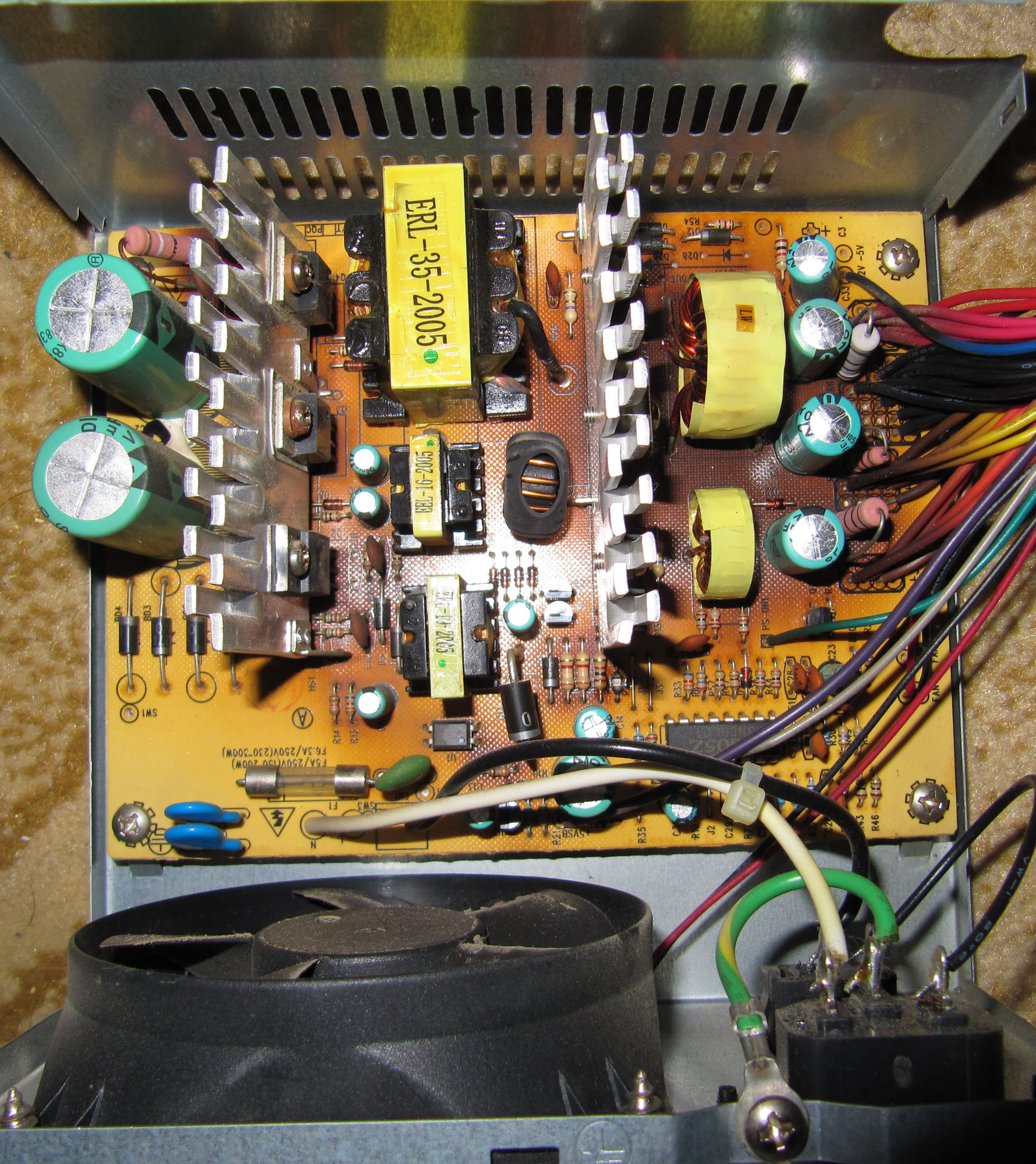

                            Deer DR-8500BTX (MAX 500W)
                            not able to output any watts in specs here

                              I mostly just lurk around on these forums, but this unit cought my attention. That must've been a very luxurious and expensive model for Deer. I mean, they really went out of their way for this one and did all kinds of extra work to still produce a shitty PSU.
                              - Added a seperate PCB for input filtering
                              - 4 "fat" diodes for input rectifier bridge
                              - real output rectifiers, no "2-diodes-on-a-plate" jobby
                              - The caps were good enough to last for a couple of years it seems
                              - A label completely dedicated to this one PSU version
                              I mean, they even painted the case and glued the fuse down. That's some serious build quality you don't expect from a Deer unit.

                                        #1599
                                        Re: the gutless, bloated, and fried power supply hall of shame
                                        I recently bought 2 shallow ATX power supplies, hoping that they were better than the YoungYear unit i'm currently using. Unfortunately that wasn't the case...
                                        The PCB layout however did have some potential for becoming a decent compact unit. After pulling some components from some other (broken) power supplies, i did the following upgrades:
                                        NO PFC -> Passive PFC
                                        2x Y capacitor -> same
                                        NO X capacitor -> added X capacitor
                                        1x common mode choke -> 1x better wound common mode choke
                                        2x 2.5A diode -> KBL406 rectifier bridge
                                        2x 4A diode -> see above
                                        2x 470uF 200V Ltec primary caps -> same
                                        2x 13007 primary transistors -> 2x D304X primary transistors (still TO220)
                                        1x SVD2N60F mosfet -> same (but primary heatsink has been swapped)
                                        ERL33 transformer -> ERL35 transformer (swapped the primary snubber circuit together with it)
                                        Small output inductor -> bigger output inductor
                                        SC6105 switching controller -> who would swap a controller? Not me
                                        NO fan control -> added fan control
                                        12V: MOSPEC F16C20C 16A TO220 Fast Recovery rectifier -> DSSK 40-008B 40A 80V TO-247 Schottky rectifier
                                        5V: MOSPEC S30D45CS 30A TO247 Schottky rectifier -> same, 5V is already beefy enough
                                        3.3V: Advanced Power AP40N03GP 40A mosfet (tapped from 5V) -> same, also beefy enough
                                        12V: 1x 1000uF 16V ChengX, PI Coil -> 1x 2200uF 16V Teapo SC, 1x 470uF 16V ChengX, PI Coil
                                        5V: 2x 1000uF 10V ChengX, PI Coil -> 2x 3300uF 6.3V Panasonic FS, PI Coil
                                        3.3V: 1x 1000uF 10V ChengX, PI Coil -> 1x 3300uF 6.3V Panasonic FS, PI Coil
                                        +5VSB: 1x 470uF 16V ChengX, not looked any further -> same
                                        -12V: 1x 470uF 16V ChengX, NO PI Coil -> 1x 2200uF 16V Teapo SC, added PI Coil
                                        -5V: 1x 470uF 16V ChengX, NO PI Coil -> still there, just not used anymore
                                        After making all these changes, it didn't start anymore. It turned out that the controller was entering a protection. The bigger output inductor did not have a winding for the -5V rail. Now, that isn't a problem since modern hardware does not use this voltage rail anymore. But the controller was entering it's UVP protection for the negative rails. Connecting the supervising pin for these negative rails directly to ground fixed it. The voltage selector switch on the rear is also removed in order to make room for the PFC coil
                                        I've done a quick 15 minute stress test run with the following hardware:
                                        - Intel Pentium D overclocked to 4GHz with 1.45Vcore (used this as the variable load)
                                        - Gigabyte X48T-DQ6
                                        - 4x2GB RAM
                                        - NVidia Geforce GT640
                                        - 2x IDE HDD
                                        Using a current clamp i got the following load numbers:
                                        12V (12.09): 18.5A / 222W
                                        5V (4.99): 5A / 25W
                                        3.3V (3.25): 8A / 26.5W
                                        Total power: 273.5W (~275W)
                                        Using my PR10 power meter, i got the following numbers from the socket:
                                        Power: 340W
                                        Voltage: 221V
                                        Current: 2.0A
                                        Power Factor: 0.76
                                        Efficiency: 275/340 = 0.81 = 81% (pretty decent, that's probably 220VAC doing it's magic)
                                        Temperature wise, the power supply could probably use a bigger secondary heatsink, the fan ramps up nicely:
                                        60c Primary heatsink
                                        60c Transformer
                                        75c Secondary heatsink
                                        80c Output inductor
                                        PFC coil: Toasty
                                        I can call it a win this time.

                                          #1600
                                          With one output cap per rail and that small output inductor, it's not surprising. Junk!
                                          And it's a shame, because the primary side probably could do 200-250 Watts. With good parts on the secondary and proper filtering, even a 200-250 Watt PSU can be plenty for many office systems and entry-level gaming PCs.
                                          That's the sad part. It's like they tried and *almost* could make a decent usable unit, but then stopped short of that and ended up with the current POS instead. It makes ZERO sense.
                                          Originally posted by Hemingray
                                          These crapbox PSUs still exist in 2020?
                                          They always will.
                                          As long as there are suckers to buy them (and believe me, there are - especially in this day and age where buying questionable cheap Chinese products from eBay and Amazon is considered a norm), we will keep seeing them.
                                          but if those "Y caps" are generic 1KV or 2KV DC parts instead of agency-approved safety caps, .
                                          Don't think it's a question of "if". Pretty sure they are ceramic caps, looking at how skinny they look. Proper Y2-class caps are usually quite a bit "fatter".
                                          Force DR-8460BTX (MAX 450W) v2.2
                                          The fan stopped but the psu continued working till it almost burnt itself to death.
                                          WOW!
                                          I wonder what this PSU was powering for so long, though. You'd think with that crappy filtering and bad caps, the constant PC crashes/instability would have made the owner realize something is wrong with the PSU and replaced it.
                                          Instead, it was ran until it turned into Deer kebab.
                                          Hmmm.
                                          If it was my unit, I would have put that 2200 uF cap on the 5VSB rail. 5VSB caps see far more stress than any other rail, since it is always On and filters a flyback design (higher ripple current output.)
                                          The -12V rail no one cares about. Just has to be there and not too out of spec to trip UV/OV protections. Same goes for the -5V rail.
                                          Another option you can do if you want to keep the -5V rail (for legacy purposes) is to install a 7905 voltage regulator and use the -12V rail to generate -5V with the 7905 regulator. Plus, it's easy - just mount the 7905 on the secondary heatsink and run wires from -12V, -5V, and GRND to the appropriate pins.
                                          - Gigabyte X48T-DQ6
                                          - 4x2GB RAM
                                          - 2x IDE HDD
                                          5V (4.99): 5A / 25W
                                          60c Transformer
                                          80c Output inductor
                                          PFC coil: Toasty
                                          Those are not bad results at all. Pulling 220 Watts from the 12V rail is actually impressive given how compact this unit is. Not surprised at all with the temperatures. Now put it in a Core 2 Duo box that uses no more than 100 Watts, and this PSU will probably have a very long life and run much cooler.
