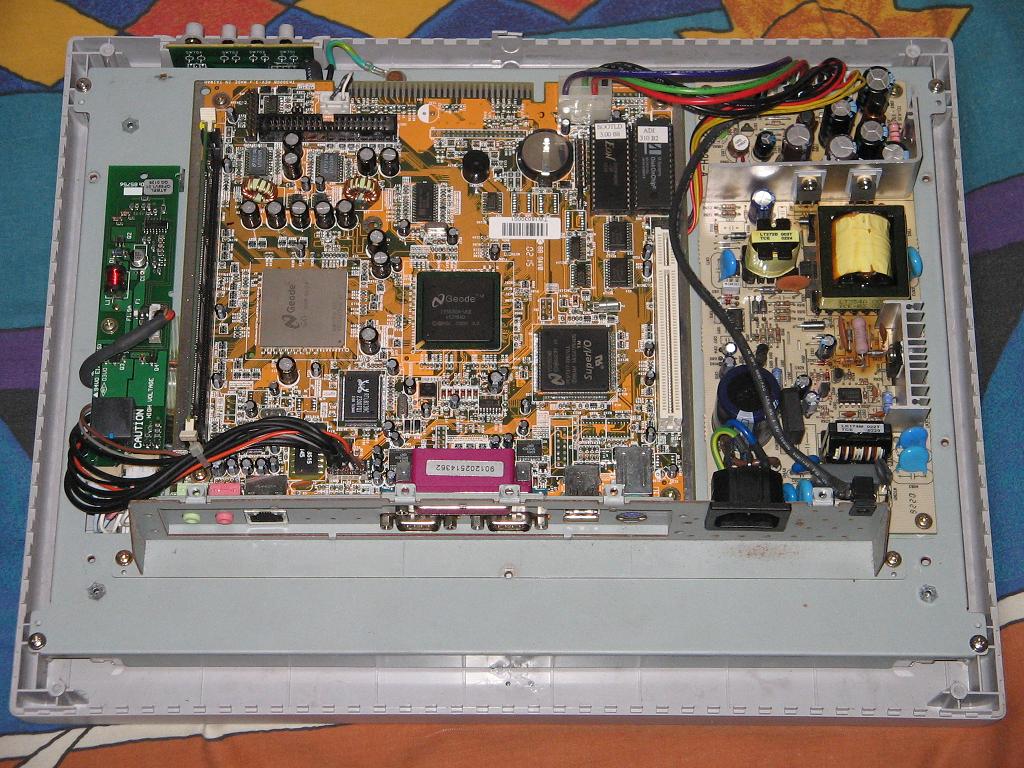

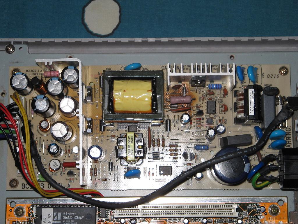

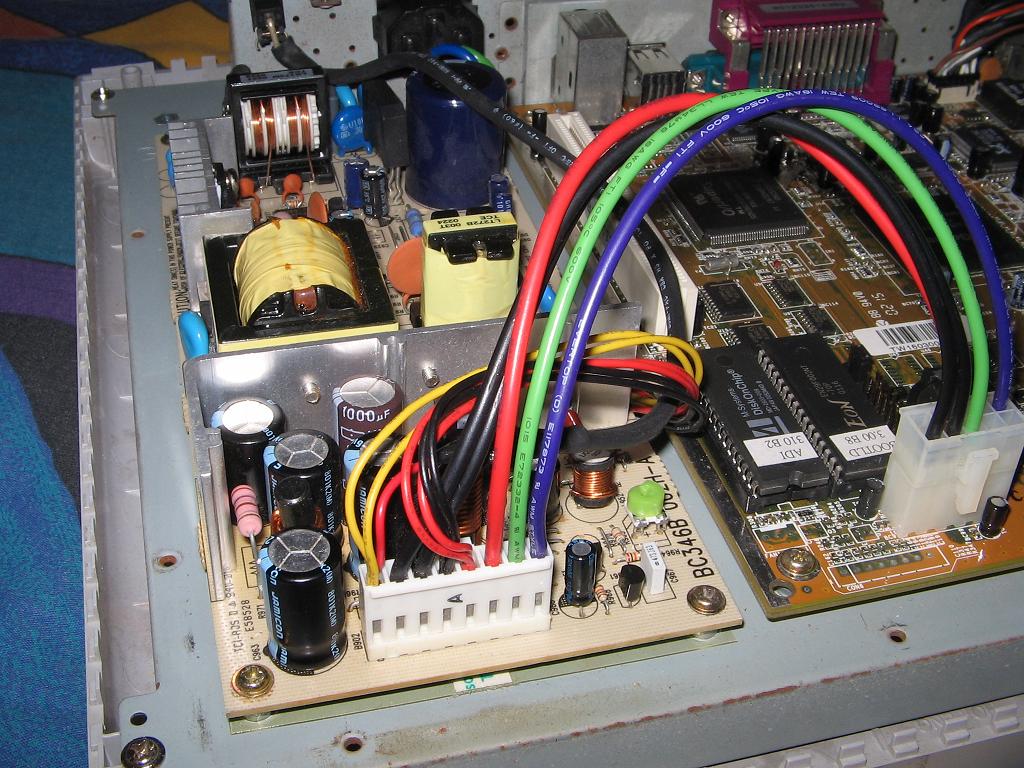

    I have here a thin terminal PC, seems to run Windows CE or some variation...
    It's basically a small Geode based PC built into the back of an LCD monitor.
    The front displays the logo "ADi"
    On the back, the sticker says
    Product Name: T8053 LCD Color Terminal
    Model Number: WT-500H
    Description: TD-551W
    When I first got it, I couldn't get it to startup (seemed totally dead, press power button, nothing happens, not even an LED)

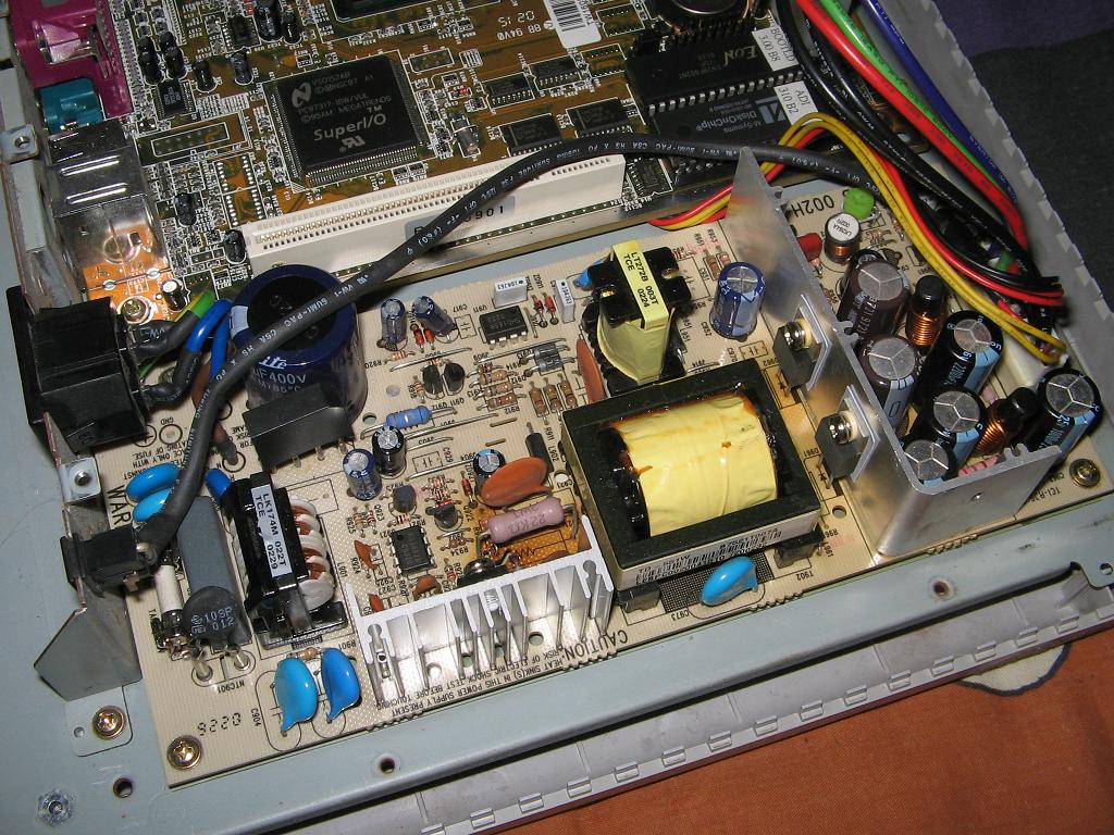

    After pulling it apart I notice there has been work done on the PSU, some components have fresh solder (though I can't tell if components are new)
    After putting it back together it seems to work, but I am worried about the 12v line.
    This PSU seems to be similar to ATX (wiring colours and voltages are the same, green wire for PS_ON but no PWR_GOOD and it lacks 3.3v rail)
    At power-on, the 12v rail jumps up to 22v and then falls back to 12v faster and stays there (I measured with DMM so it may go higher than this) 5volt rail seems fine. 5v standby also seems fine (though maybe a little low, 4.78v)
    I suspect the PSU to be faulty in some way, especially as it did not even power up the first time I tried it
    However since no actual damage seems to be done to the components, I considered the possibility that they are just using a really badly designed PSU and have also included protection circuitry to limit the initial overvoltage condition (I know that is stupid but I'm sure someone's seen stupider designs than that)
    If anyone has experience with this model, would be great to hear, or any other thoughts on the matter. If it is a fault, what would I be looking for?

      try getting rid of the crapcaps (jamicon in PSU and the garbage around the cpu) ?
      the NCCs near the secondary side heatsink of the psu may be cooked aswell.
      who knows how long this thing has been running.. look at the discoloration..

        Re: ADi T8053 LCD Color Terminal - PSU output high at startup
        One of those Jamicons looks 'wrong'. The sleeving is too thick at the top.

          Once the thing has started it does run, so the motherboard caps are probably OK (or at least not causing the PSU issue)
          Powering up the PSU without being connected to the motherboard results in the high voltage problem as well as when it is connected, so I think the PSU is solely responsible for that issue
          I agree that Jamicon looks odd but I doubt a slightly longer sleeve would be an issue.
          However I agree with Scenic. Those NCC are actually of a series (KME) which aren't made anymore, so they're definitely old!
          Will pull them and test ESR, but actually both the Jamicons and NCCs are general purpose series and the datasheets of course show no indication of what ESR should be, though. What do you think ESR should be in this case?
          Can bad capacitors on the outputs actually cause such a huge voltage swing like this though?

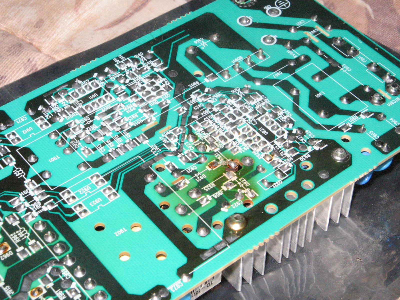

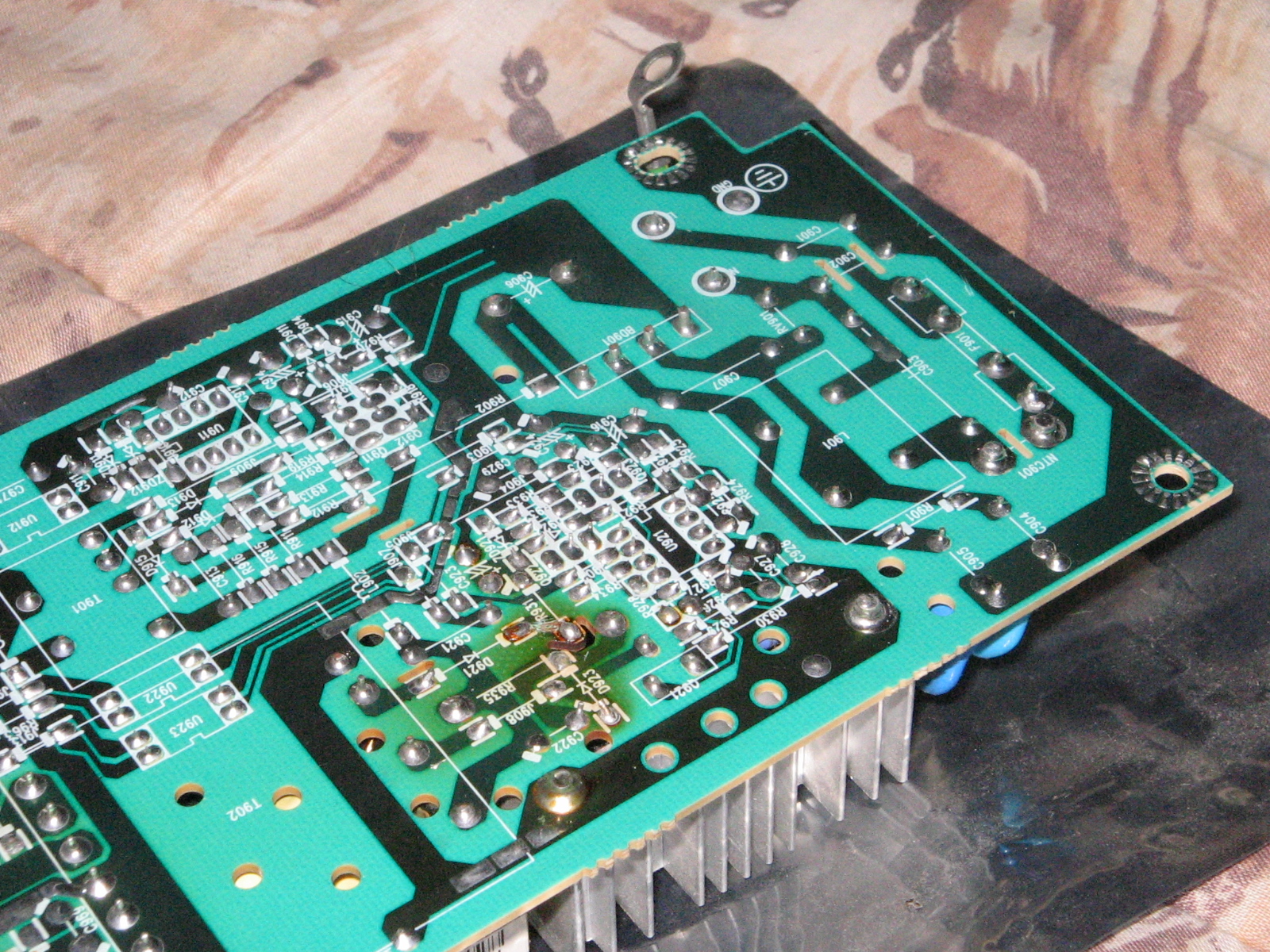

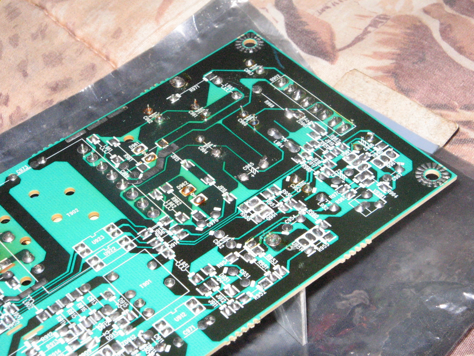

                          Kind of hard to say without a shot of the under side of the PSU board.
                          It could be that the PSU was not designed to get feedback from the 12v rail and that's why you might be seeing it go high voltage without shutting off the PSU. I just fixed a monitor with a PSU board that was designed like this where only the 5v rail was used for feedback. Turned out that the cap on the 5v rail was bad which caused the regulation of the whole PSU to go amok (12v rail was at 24v!). Original cap on the 5v rail was general purpose 85C. I used a low ESR one and lo-and-behold the 12v rail came down to 16v (see this thread for more details). It really shouldn't be a problem to use low ESR caps, as long as you don't go overboard. Something like Panasonic FC, Chemicon KY, and Nichicon PW should be perfect for this application.

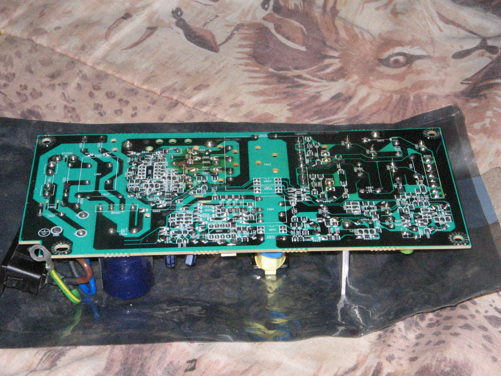

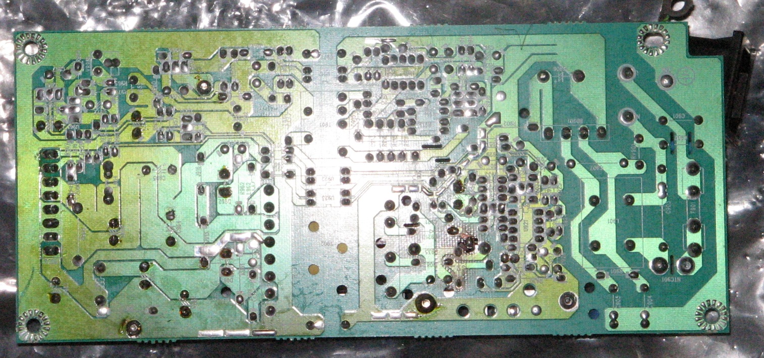

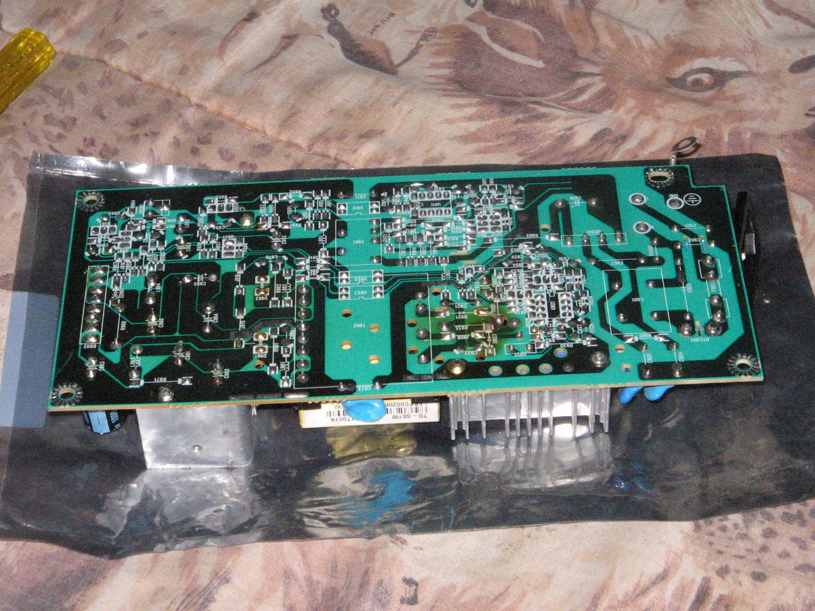

                            • Agent24
                              I see dead caps
                              • Oct 2007
                              • 4961
                              • New Zealand
                              Here are the photos of the underside... hopefully they are of some use to you.
                              -David VanHorn
                                master hoarder
                                • May 2008
                                • 12175
                                • Bulgaria
                                Thanks.
                                From the pictures, it looks like both the 5v and 12v rail are designed to give feedback to the PSU, which is good. The fact that the 12v rail spikes so high still concerns me, though. How long does is stay high? Just a second? 5 seconds? more/less?
