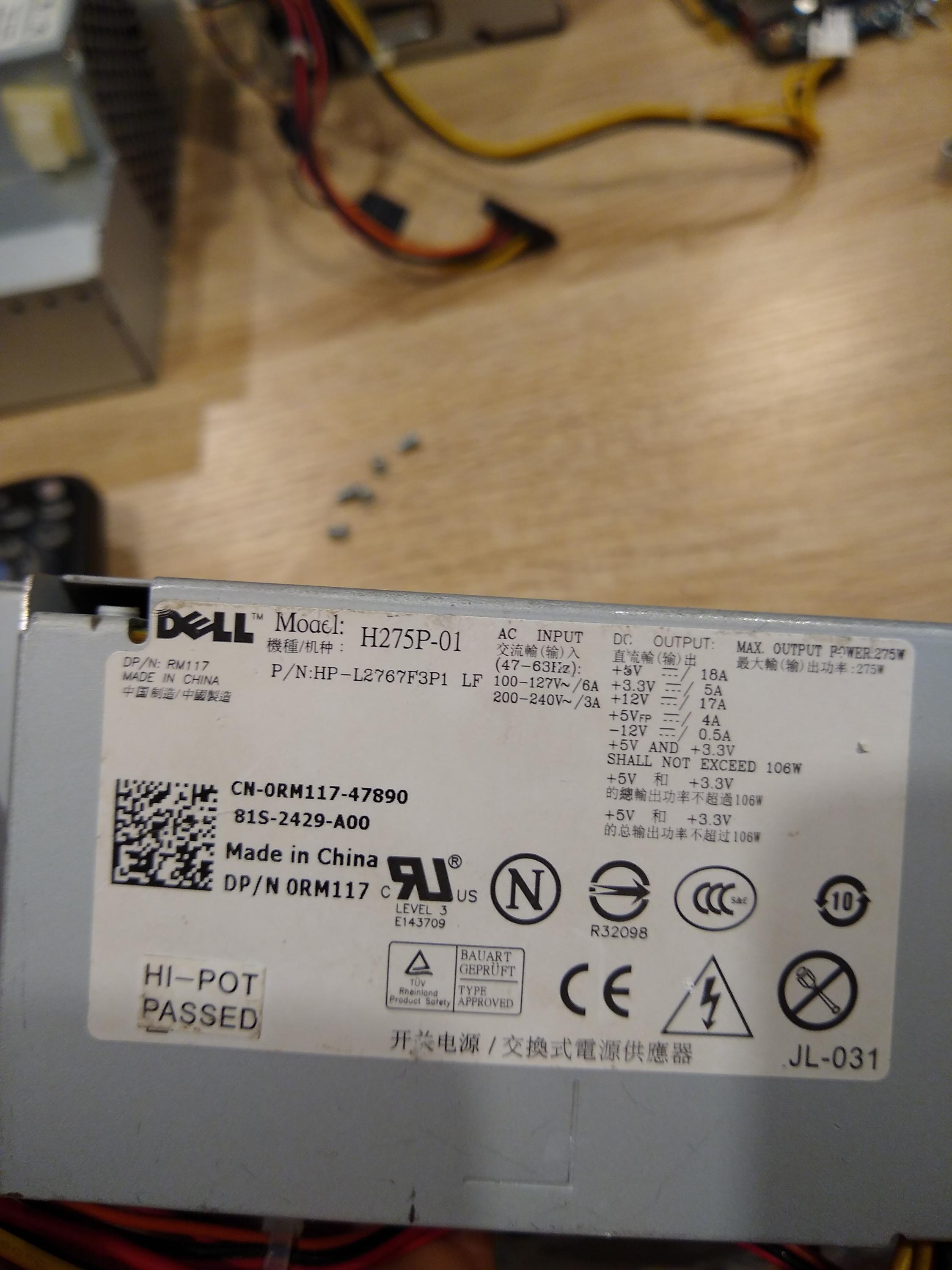

Dell model: H275P-01 P/N: HP-L2767F3P1 LF
  • Jackching
    • May 2017
    • 127

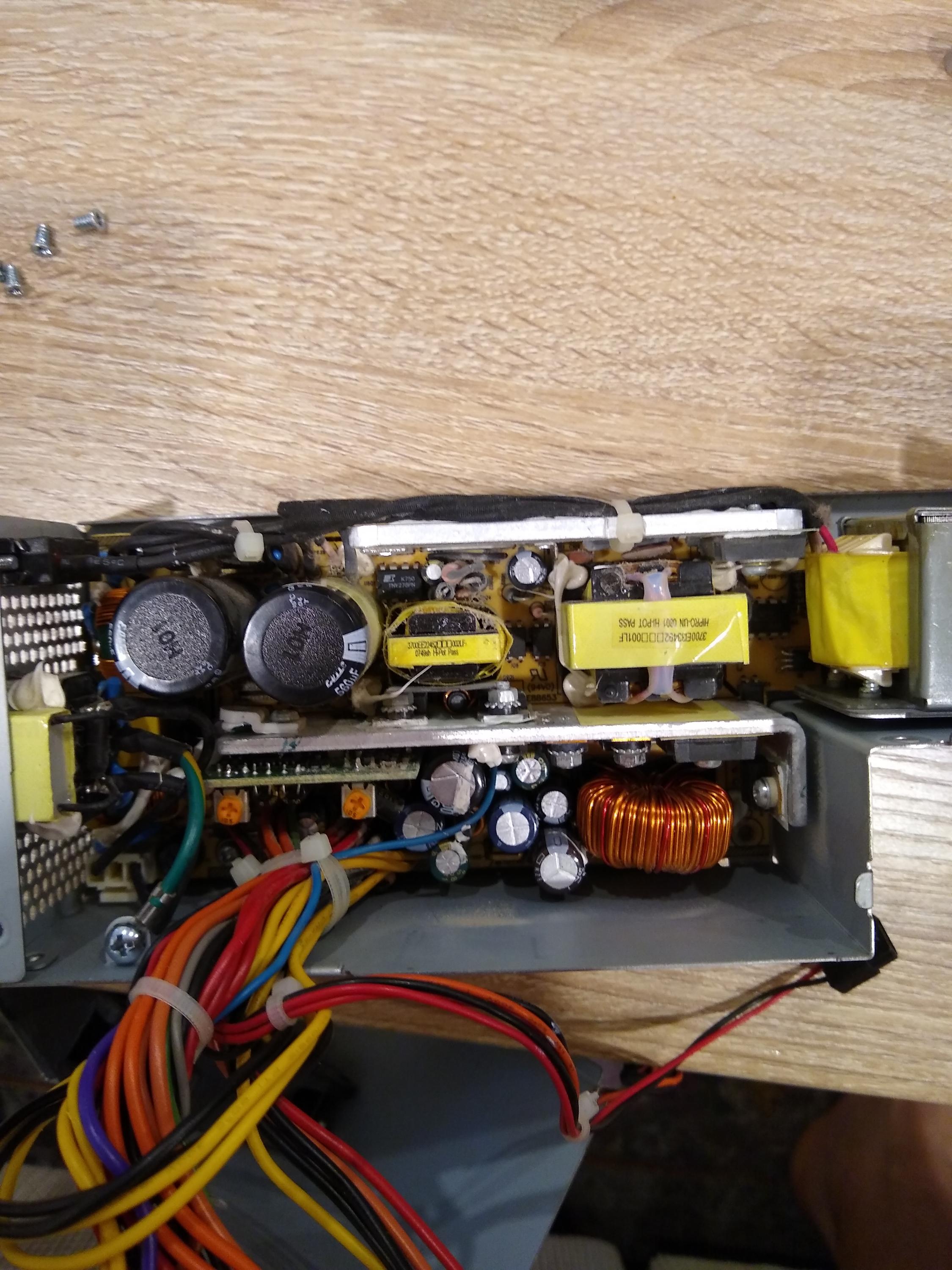

    Has anyone fixed one of these PSU? The computer is not powering up. Should it all be recapped?

    In any case, before even attempting a recap, first you should try to identify what is the problem with the PSU.
    Start by plugging in the PSU and measuring the 5VSB voltage - i.e. check DC voltage between purple wire and a black wire. Should be 5V. Now connect the PSU to a motherboard and try measuring the 5VSB again. It should still be 5V. If it's not, then the PSU might be having an issue regulating that rail.
    If 5VSB is OK, what happens when you press the power button on the motherboard? Do the system and PSU fans twitch a little or nothing at all? I do see a number of good and bad cap brands in the PSU, so of course it is possible that the main PS has bad caps on it. But it could be something else too.
    In any case, first verify if the 5VSB is there and steady at 5V. Then we can go from there.
