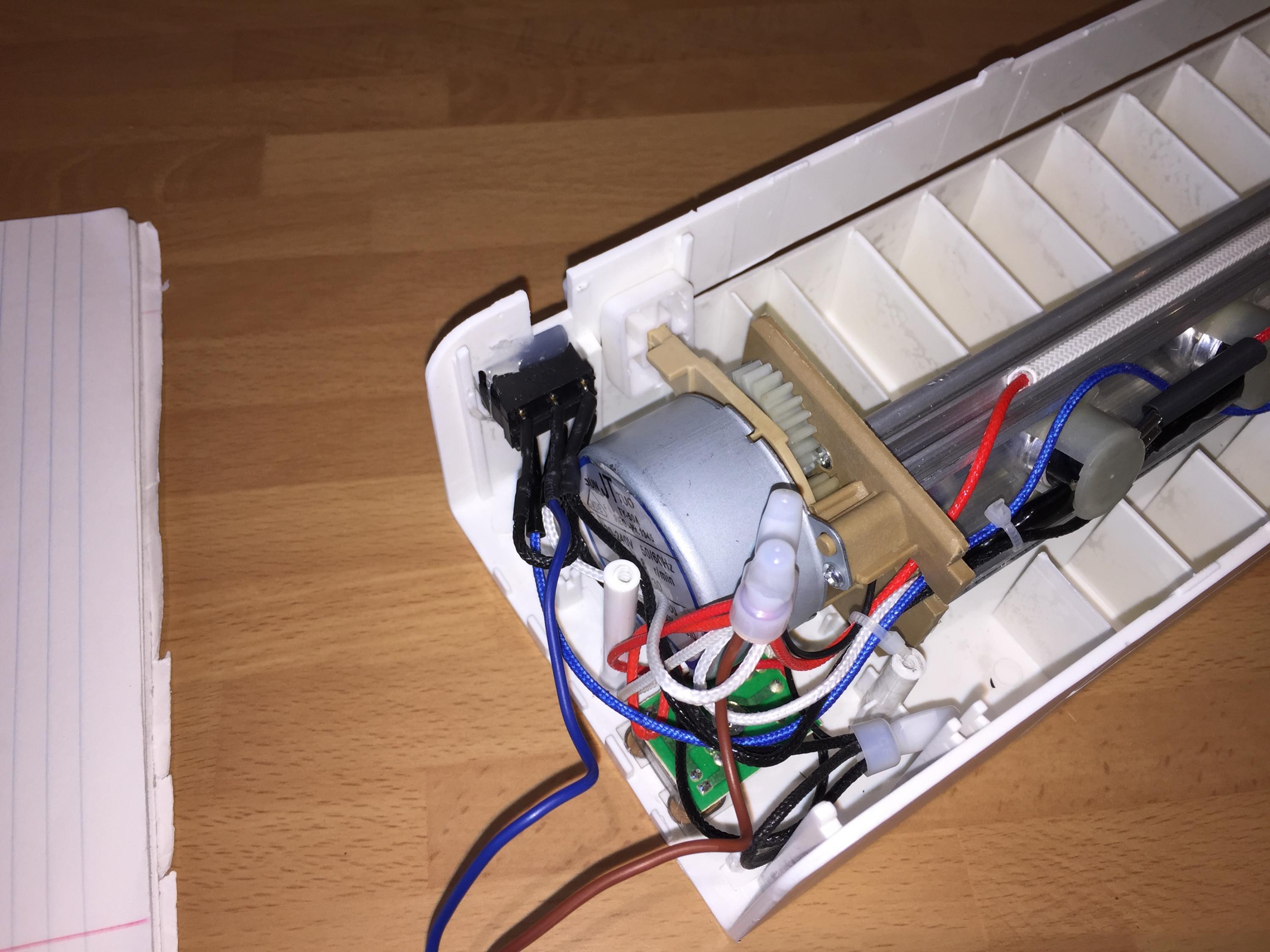

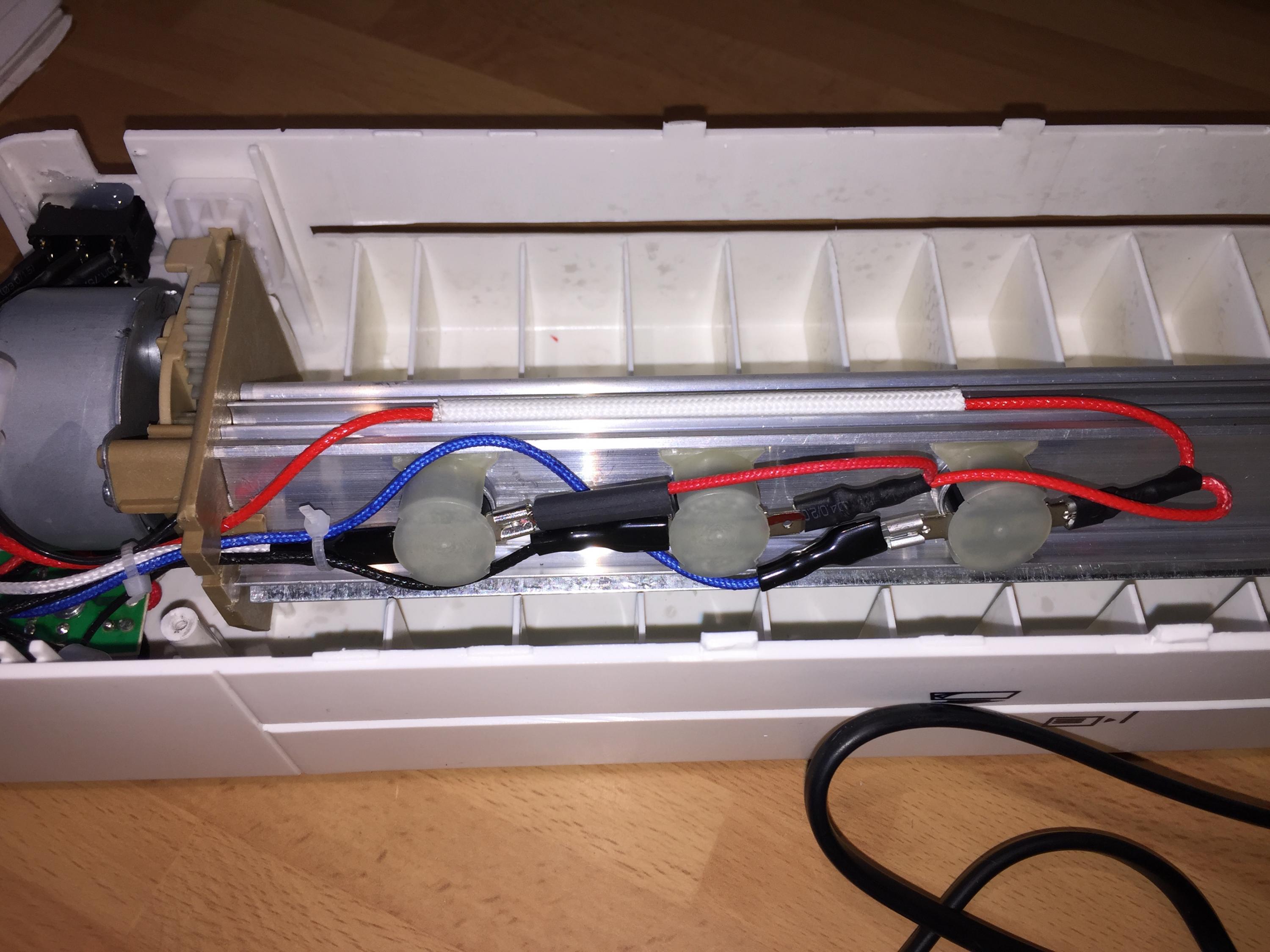

    Hi
    I've just purchased an Amazon Basics laminator, to use for PCB toner transfers but thats not the reason for my post.
    I opened up the unit to see what was going on inside to find that it contains 3 normally closed temperature sensors.
    I have draw a schematic of what i believe to be how its wired up, but if I've draw it correctly I don't understand the purpose of the third 130 degree temp switch, as regardless of whether the other 2 temp switch's had switched off the third would remain on therefore defeating the object of the other 2 switch's.
    I have attached the schematic that i have draw and some images of the device so if you could take a look to see if I'm mistaken i would be grateful.

    Is the DPDT switch "center off", by chance?
    If that's the case, then the two "other" positions represent operation at 115C and 125C ("operation" implying the motor is running to pull the material through the laminator). The 130C cutout then acts as a standby/preheat setting -- with the motor off (as soon as anything passes through the laminator, the temperature will drop to a point where the appropriate 115/125 cutout acts to control the temperature).
    Note that most laminators are designed to laminate bits of paper in plastic encapsulants. So, you may find the heating element underperforming for your needs.
    [I have to give the heating element in my laminator time to "catch up" if I have been laminating large (e.g., 8x14") items -- or, set it to run hotter than desired (I have a variable temperature control)]

        Yes the DPDT switch is centre off.
        I still don't get how the heater could be preheating until I've switched to either side as the heater is switched on the neutral side. Sorry I may be just being thick.

          It does'nt make sense. Does the unit start to heat up when first pluged in and the switch in the OFF position?
          It could be that one thermal cutout is just to control the "ready" led

            The unit doesn't heat in the off position it only starts heating when the rocker switch is placed in the low temp or high temp position as the heater is switched on the neutral side at the same time as either thermal cutout's are switched in.
            The unit has got a ready led which I think is switched on from the 130 degree temp switch. I didn't draw that in as i haven't taken the small PCB out to look at how its wired up.
            The 125 degree and 130 degree seem to switch off and on at around the same time.
            To me the lower temp setting seems pointless as when this position is selected with the rocker switch it wouldn't turn the heater off until all 3 thermal cutouts are off no matter what.
