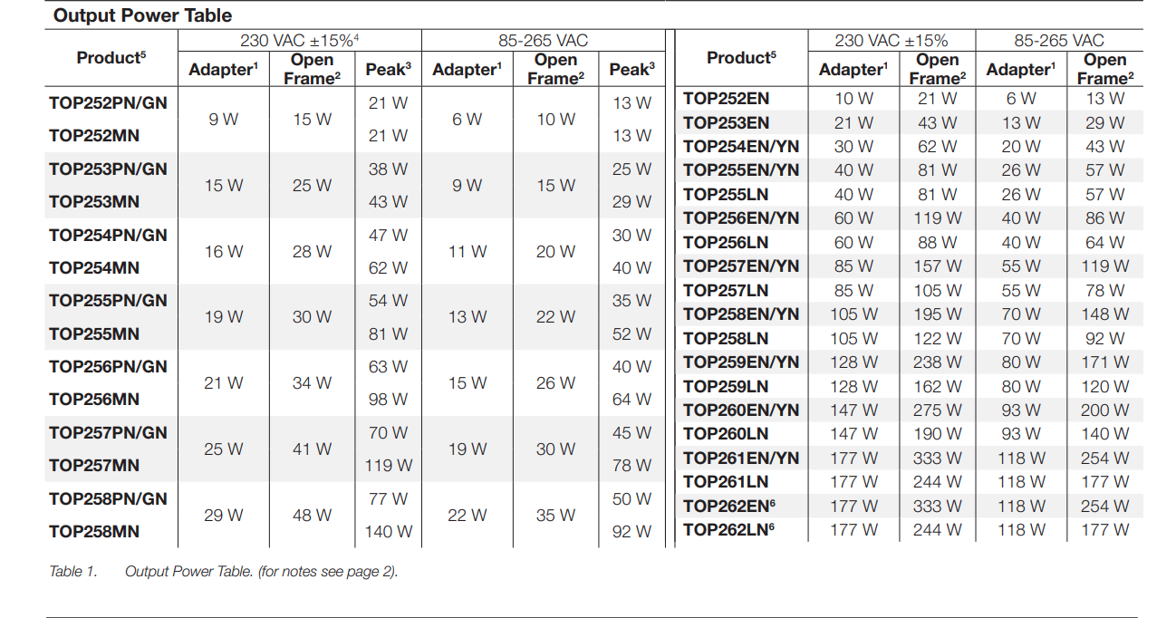

                            Re: List of pin compatible pwm/supervisor PSU ICs
                            Please help Can you replace top256pn by top258gn
                            • lotas
                              • Jan 2016
                              • 4809
                              • Russia
                              Yes, you can, the difference in power.
