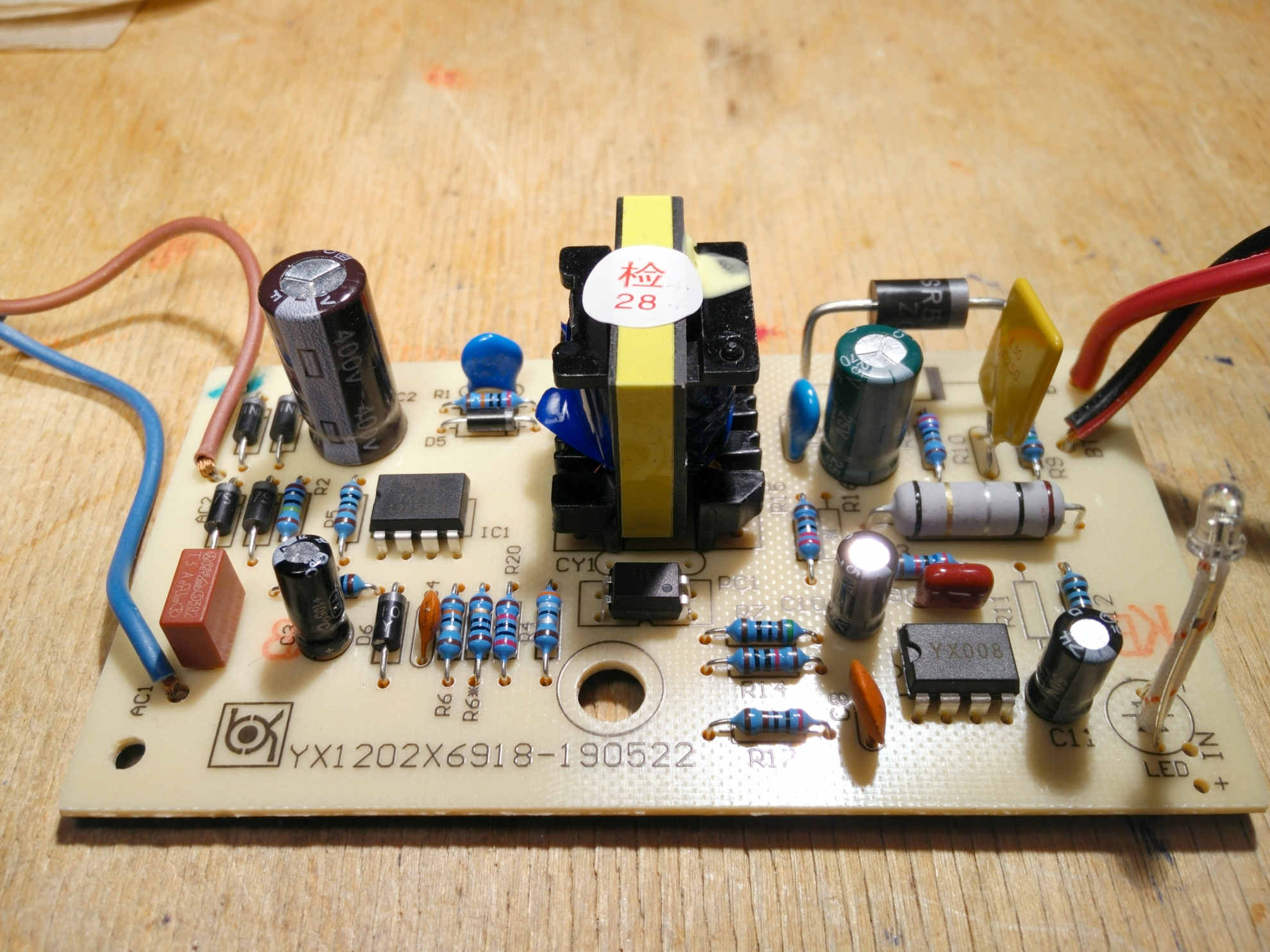

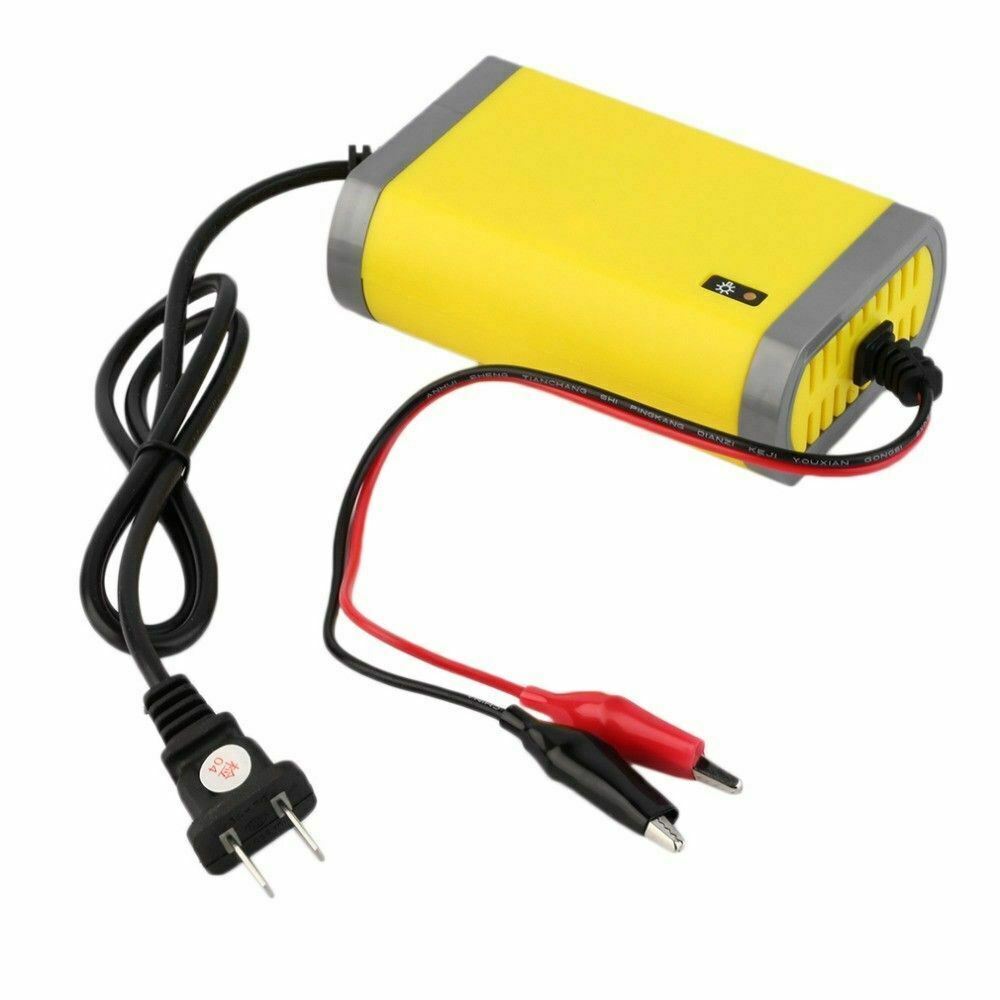

    12V 2A battery charger/maintainer

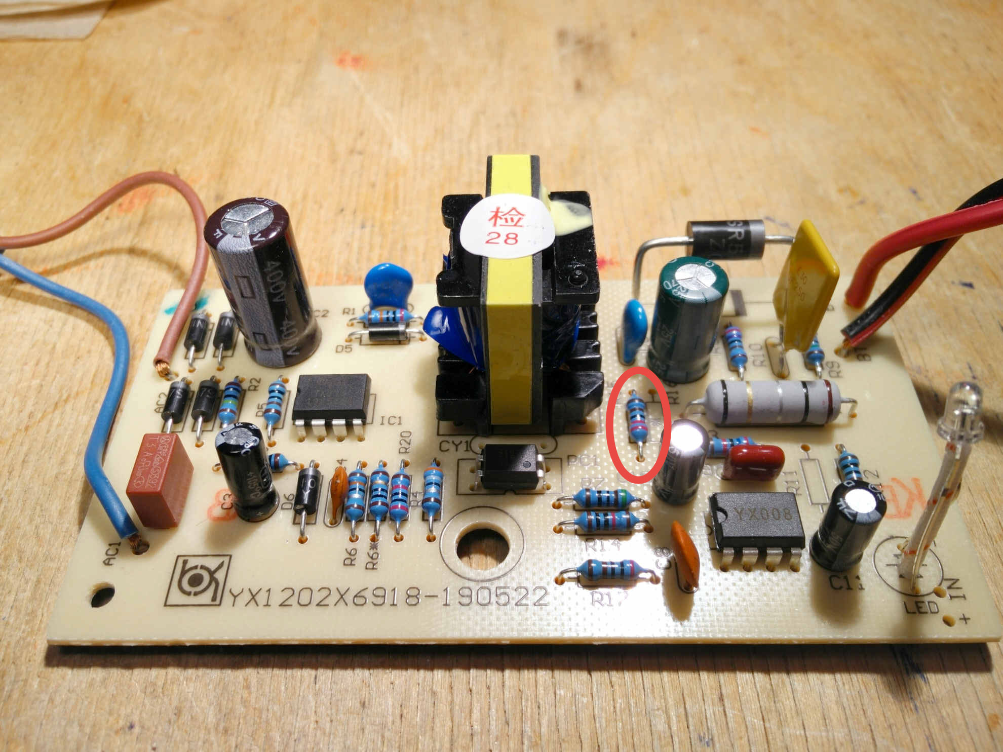

    Bought this chinese 12V 2A car/motorcycle battery charger/maintainer $7. It looked OK hardware wise in pics.
    But... everything runs quite hot at 2A - IC, transformer, capacitors, output rectifier. Estimate over 85°C.
    The primary cap is tiny 15uF 400V, output 470uF 25V. I would say the ripple currents are too high. So I'm not sure if I will use this charger, it's not going to last.
    What do you guys think?
    The way it works: if load is over 600mA (bulk charge) it's 14.4V setpoint and 13.8V if less (float charge). The YX008 IC hard to understand, it's a "coin timer" IC but I did not see any timing action.
    "Note: Charging motorcycle under 20A, after 3 hours must cut off." I have no idea what that means.
    There is no inrush NTC. Other versions of it add a charge bar graph or voltmeter or have 10uF primary cap or use a TO-220 IC on heatsink instead of CR8642S. It seems to be made by the same company that makes the IC's Guangzhou Yuexin Electronic Technology Co. Ltd. YX1202X6918

    Two things about this board
    The first one is there are no heat sinks on this board really
    They used house part numbers really
    The only two thing I see going for it is that it has a resettable fuse that is a nice feature
    The other thing that it has going for it that it has an optic sensor on it is for feedback to the switching regulator or dose it have one
    One other thing I do not see how this charging board could do 2 amps maybe 750 milliamperes maybe with out over heating

      not house numbers,
      YX prefix is used by "YX Shining ic" a company that makes a lot of dedicated parts for thinks like solar chargers / lights.

        Re: 12V 2A battery charger/maintainer
        There is a resistor R15 = 2k2, located next to the transformer. If you increase the resistance value a bit, then you will lower down the output voltage. Try to replace this resistor to 2k7, and measure the output voltage, it will be drop to about 12V.
        Or you can replace it with a potentiometer, ranging around 2-3 kilo Ohms, then you can tune the output voltage...
            The output voltage is two step. It has high (bulk charge 14.4V) and low (13.8V float) output voltages. I had no problems with them, the voltages work fine for a car battery. Increasing R15 would lower both charging voltages.
            There is no usual TL431 and I did not finish drawing a schematic because the IC "YX008A Pulse Controlled Coin Timing Charge Control IC" datasheet is terrible. Somehow it's getting 5V power, and toggling based on current (sense), and doesn't seem to have a coin timer lol.
            My problem is the charger runs hot and a loud spark when you plug it in.

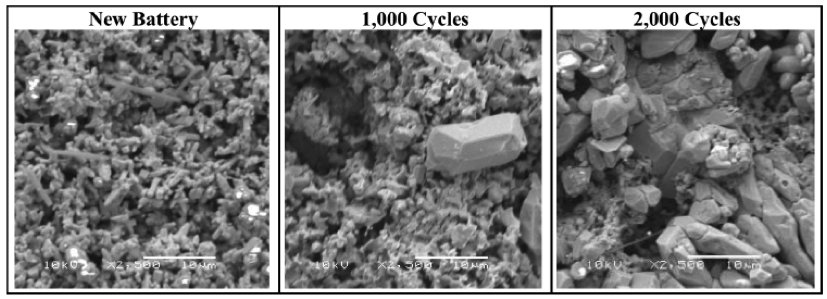

                Modern cars with ECU-controlled alternators undercharge the battery. They keep them around 80% charge and AGM do not seem to matter, it's all to get more MPG. When you are decelerating, down a hill the ECU ups the alternator's voltage and dumps energy into the battery. It's like a regen. Cars also have more parasite drain with TPMS, keyfob remote RX always on, fuel pump anti-percolation, canister purge etc. functions happening with the key off while you are sleeping lol.
                This all falls apart when the battery gets older, you need to charge them more, or in winter. Toyota firmware certainly isn't doing much at 13.4V in -20C weather for a flooded-type and AGM needs even higher voltage.
                So I'm finding I have to do an equalization charge once a year and decent float charge every month or two. That's up to 14.4V then float at 13.8V, and the car stays around 13.4V but it goes to 14V for a short time after starting.

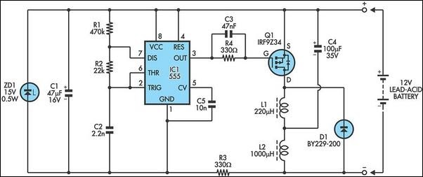

                I built a desulfator (555/IRF9Z34 1mH, 220uH in pic ) and found it did not help. Hard sulphation is really stubborn, so I suspect you need huge current pulses to really knock the crystals off, and even then it apparently works to a limited extent. Right now I'm not a believer in desulfators because the scanning electron microsope pics of sulphate crystals shows they don't come off much.
                Recovery of discarded sulfated lead-acid batteries by inverse charge they connected them backwards(!) new acid, to get 80% recovery.
                edit: that desulfator circuit is stupid, the 15V zener is in the way lol.
                  Looks ok, R3 makes it "work" however much these things "work". Would agree it would be completely useless if R3=0Ω ...

                      I can get rid of hard Sulfate on with my CIP. Takes about a week. That CIP plugs into the wall, so yes… it has power all right. Those little desulfators in that circuit you shown are not good for anything much more than keeping a good from sulfating. Got one of the little guys sitting on my generator and I get twice the battery life out of it than another generator I maintain that only has a battery charger on it.
                      However there is another Voltage Doubler design of this. I built a couple of them and I gave mine the nickname “sparky”. The battery posts will start singing pretty good on this thing. So yes it does work, but it needs real power behind it. The voltage doubler circuit you need good diodes and large caps in series. Mine has 4 64000uF caps and it needs a power supply, other than that the battery is flat in a few hours. The charged inductive pulse (CIP) has a built in PSU. The battery posts will really sing on that one too.

                            Everything has been tried, chemical additives, pulse charging etc. Either the battery dies from sulfation or it's corrosion causing mechanical failure of the interconnects or plates. Ultrasonic I think would just dissolve the plate material.
                            Desulfators I would not run with the battery in a car, decent amplitude voltage spikes would be good for battery but not the car's electronics.

                                I am not Big Clive, but I did try to reverse engineer a similar power supply. It is labeled on the circuit board as YX1202-4-2003. (It appears to be 12V, 2A.) See attached PDF of hand drawn schematic. /Paul Robinson
                                • redwire
                                  • Dec 2010
                                  • 3912
                                  Thanks for the schematic, I forgot to finish mine. It looks almost identical to the one I have. This charger is really good for the car, I don't like the brittle cables when it's cold out or the hot running caps... but it's still working fine.
                                  The main SMPS IC appears to be a Chip Rail part CR6229 and other models use a mosfet+heatsink instead. At best it's 25W or so output.
                                  The IC's are house labelled to hide the advanced technology and prevent copying
                                  YX008 seems to have a voltage reference, comparator and current-sense op-amp.
                                  What it does is really simple but works good. At high current loads >600mA it charges to 14.4V and when the current drops below that it switches over to 13.8V float charge output and stays there.

                                      A lead acid battery must always be kept fully charged. Permanent sulfation damage can occur in a week in a discharged battery. In the pandemic with less driving many folks are finding dead batteries.
