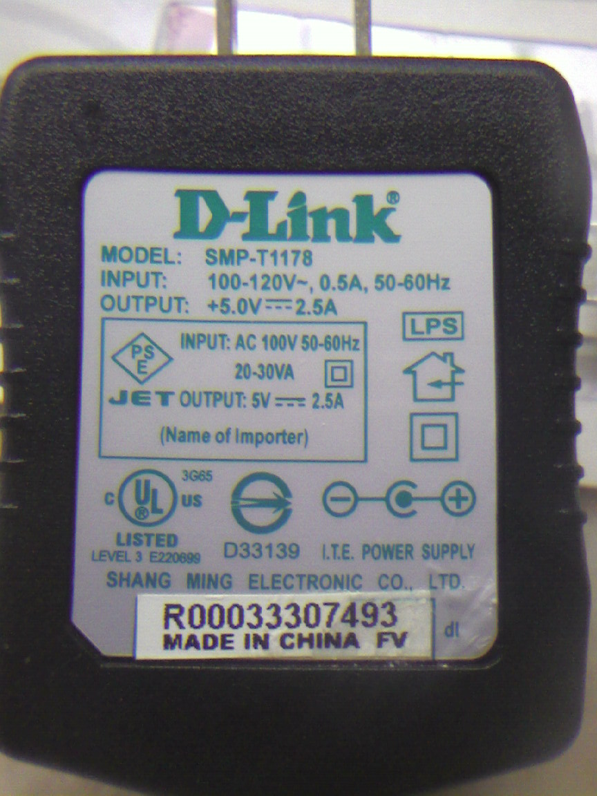

    Judging by the size, this is a switch-mode power brick. Here's the info that's on it:
    Shang Ming Electronic Co., LTD.
    Model: SMP-T1178
    Input: 100-120v, 0.5A, 50-60Hz
    Output: 5.0v, 2.5A, 20-30VA
    UL E220699 <--- it doesn't lead to anywhere when I Googled it.

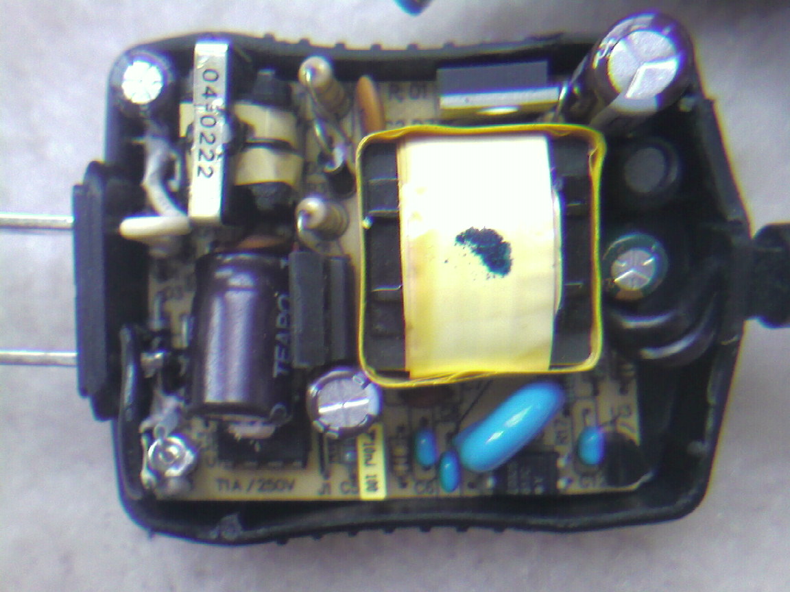

              Well thanks to KC's method, I just opened the power brick today. Here's what I have for the output caps:
              1x Teapo SC, 25v, 330uF, 8x14 (mm, dia x lenght) <--- before PI filter
              1x Teapo SC, 10v, 220uF, 6x11 (mm, dia x lenght) <--- after PI filter
              Like Krankshaft's power brick, mine has all Teapo caps. The date codes show they were made in 2003 (I had this router in service since 2004). None of the caps are visually bulging or leaking. And unfortunately I don't have an ESR meter so I can't test them either.
              That 25v 330uF cap doesn't look right in there, though - why would they use a 25v cap on a 5v rail anyways? Lower ESR from the bigger can size?

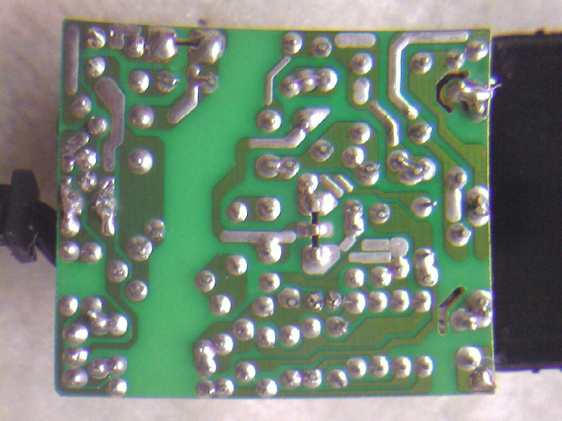

              I did test the fuse, secondary rectifier, bridge diode, and the feedback resistors with my DMM and they all seem to show proper values.
              The PWM IC does not look like a UC3846, but I can't tell for sure since there's some white glue on it that won't come off easily. There's also a lone Teapo SEK, 25v, 47uF next to it. (Maybe this cap is causing a problem that's similar to the Bestec 12E with bad 5vsb design?)
              Since I repeated the same test yesterday (where I left the brick to get warm under the sun after which it powered up fine again) I do think there's a bad cap somewhere that's causing this problem.
              I guess I'll just get new caps for the output (with a proper rating of 10v) and pray that it works (unless someone has any other ideas or thoughts). Might even get some replacements for those Stone caps in the router. I also have two older (but nice) ATX PSUs that need new caps too, so why not buy everything at once .

                Well, it's been almost a year later, but I've got some results finally.
                Turns out the 25v, 47uF Teapo SEK next to the PWM controller was the culprit. At first I replaced the 25v, 330uF Teapo SC on the output with a 10v, 1000uF United Chemicon KZE (8mm dia.), but that just made the output voltage awfully screwy (I would get ~1v with the router as a load and something like 6v when there wasn't a load, and the voltage would continually go up - I didn't want to blow the adapter so I didn't keep it plugged for too long to see how far it would go). Then I replaced the 25v, 47uF Teapo with a 50v, 47uF Nichicon PM and the output voltage came back to normal: 5.12v with the router as a load and 5.20v with no load.
                Now I just have to get this thing shut. The KZE cap is just 2mm too tall. Might just drill a hole for it . I also attached some pics. Sorry if they are a bit distorted - they were taken with my cell phone with a magnifying glass in front of it to get a better macro shot.

                  Re: D-Link router - faulty power brick?
                  i just noticed this thread,
                  i could have told you it was that cap,
                  it's the startup cap that provides the pulse to kick the oscillator into action.
                  very common fault in set-top boxes & dvd players etc.
                  you dont need the cap for the psu to run, but you do need it to start.
                  so you buy some gear, plug it in, it runs fine.
                  the cap dry's out - but isnt being used.
                  soon as you unplug it that's it - it wont re-start.

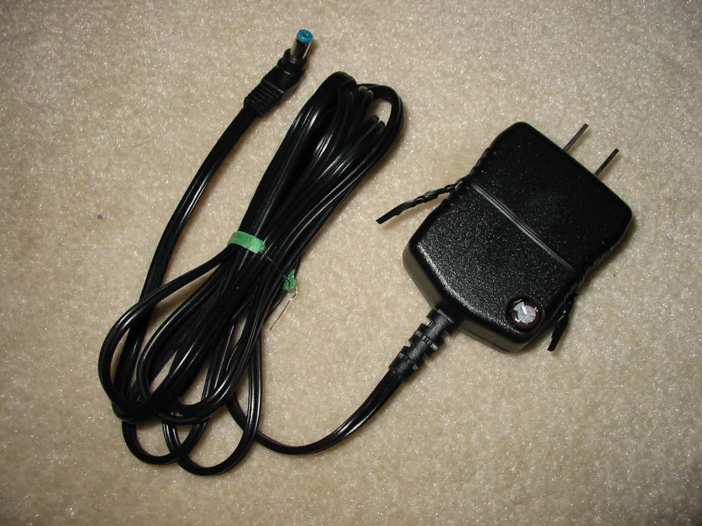

                        Also, here is what my power adapter looks like now after I finished it:
                        https://www.badcaps.net/forum/attach...1&d=1327456835
                        Basically, the 10v, 1000uF Chemicon KZE cap was a bit too tall, so I drilled a hole in the case to accommodate for that. I did have some 6.3V, 1000uF Chemicon KY caps that would have fit, but I thought that this would be cooler (pun intended).
                        Held together with wire ties (because I don't like gluing things).
