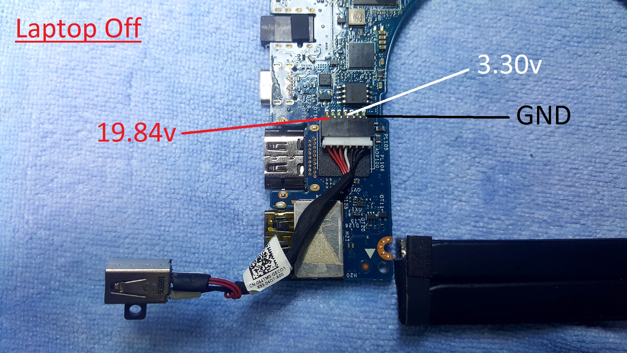

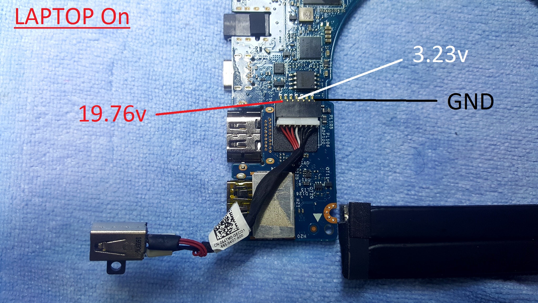

    Dell XPS 15 9560
    Power Adapter and Power Jack are ok
    Laptop = 19.5v --- 6.67A --- 130w
    Power Adapter = 19.5v --- 6.67A --- 130w
    error :
    Alert! The AC power adapter wattage and type cannot be determined. the battery may not charge. the system wil adjust the performance to match the power available

    Re: Dell XPS AC Adapter Unknown
    sounds like the old 1wire problem.
    a memory device in the charger that the laptop reads data from.
    NOT faulty usually, but caused by a bad connection in the cable.

          the white wire is a data wire to a memory chip in the charger.

                  I've seen this A LOT on returned laptops. I think what happens is those newer adapters simply have a very crappy cable that looses/breaks the middle (ID/identification) pin. So despite the power adapter outputting the proper voltage, the laptop cannot properly ID the adapter and thinks it's a generic/no name and/or low-power adapter.

                    sometimes cables break, sometimes static kills the chip - it has no zener diode or similar to protect it.
                    there is pic chip code floating around to simulate them.

                                  Dell 5470 unknown ac adapter I replace charger an motherboard caple and I face the same proplem what can I do ??
                                    • 31214
                                    get a schematic and check the 1wire bus circuit.
