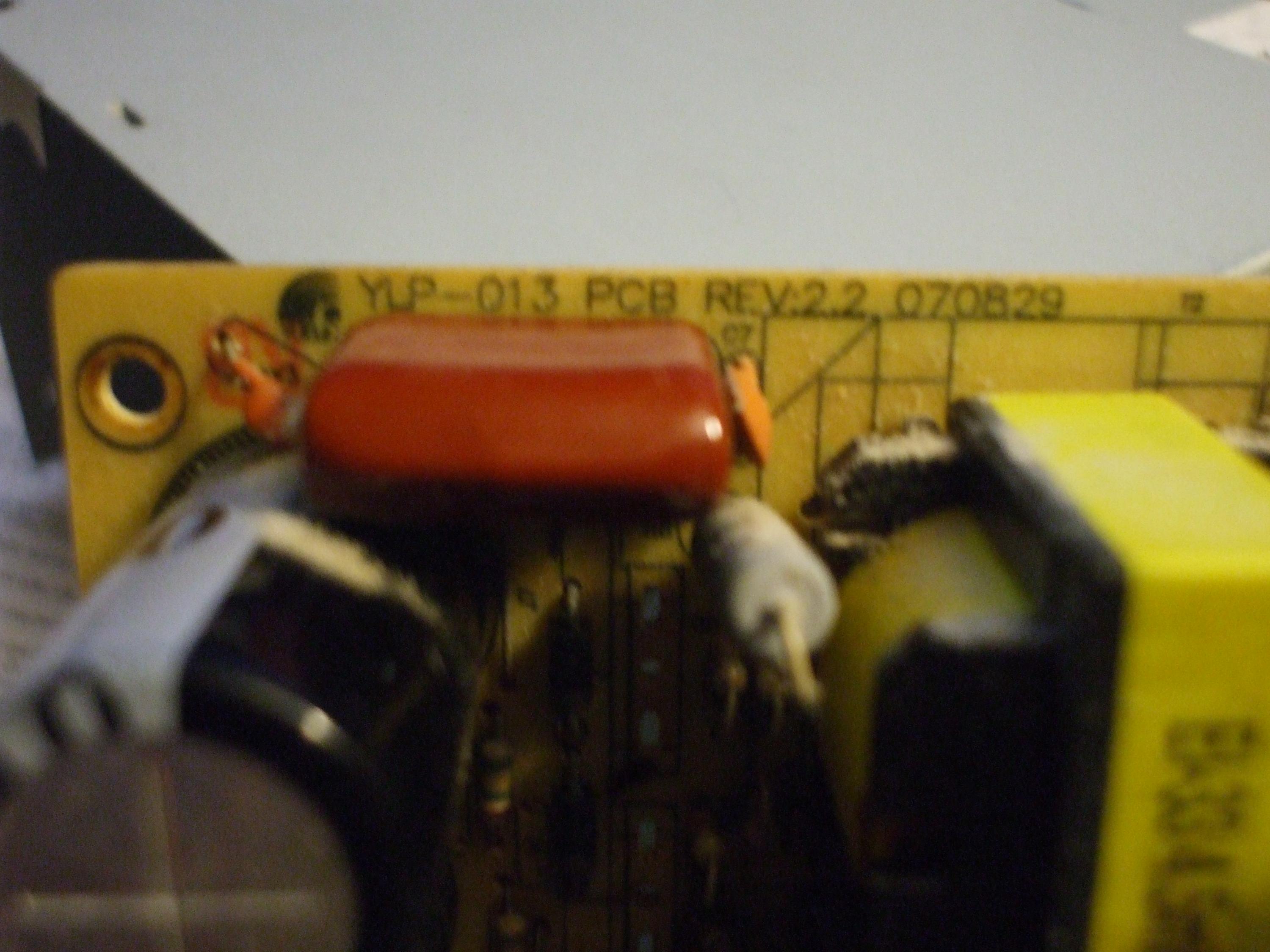

      Re: YLP-013 450W capacitor value.

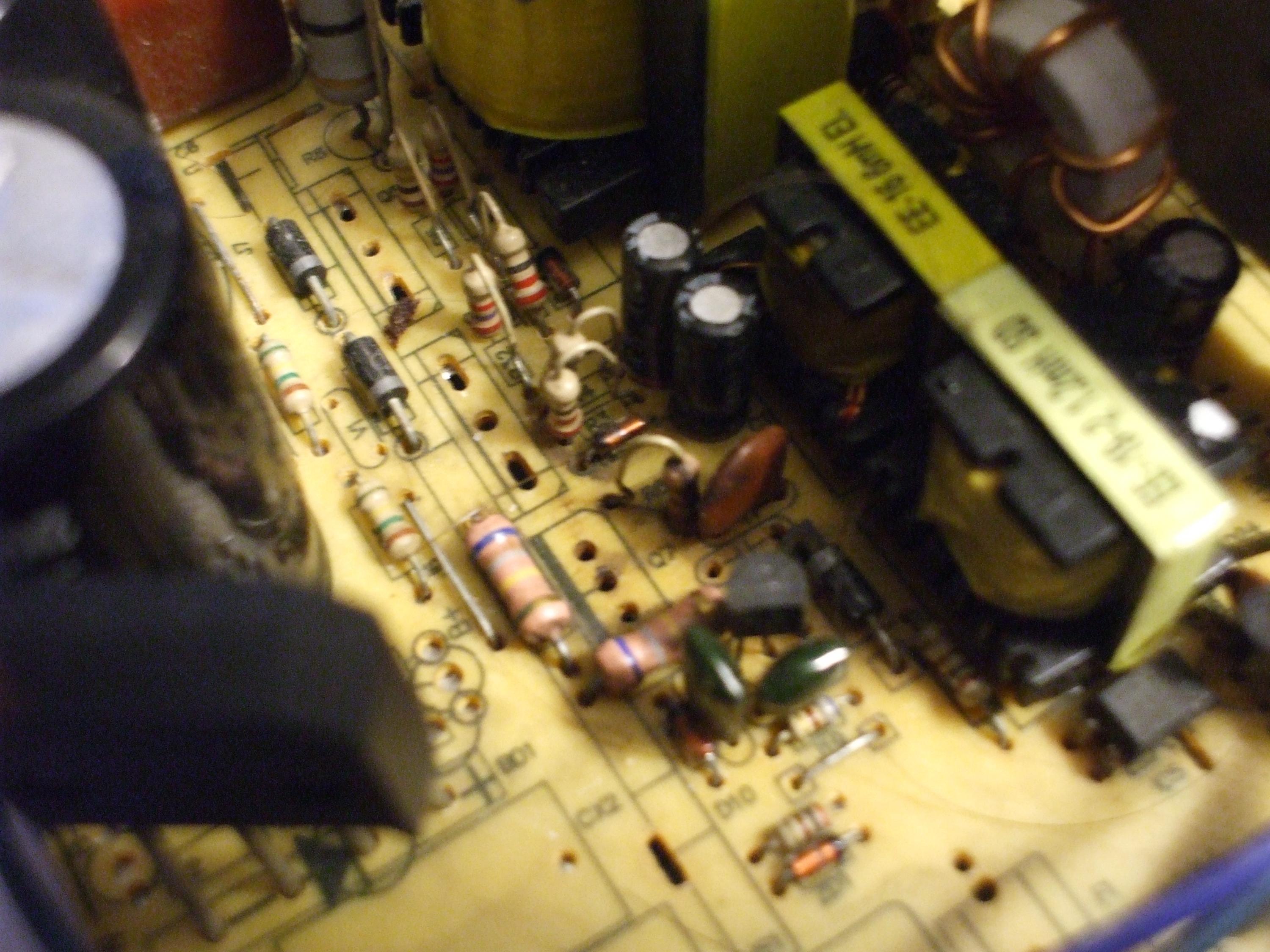

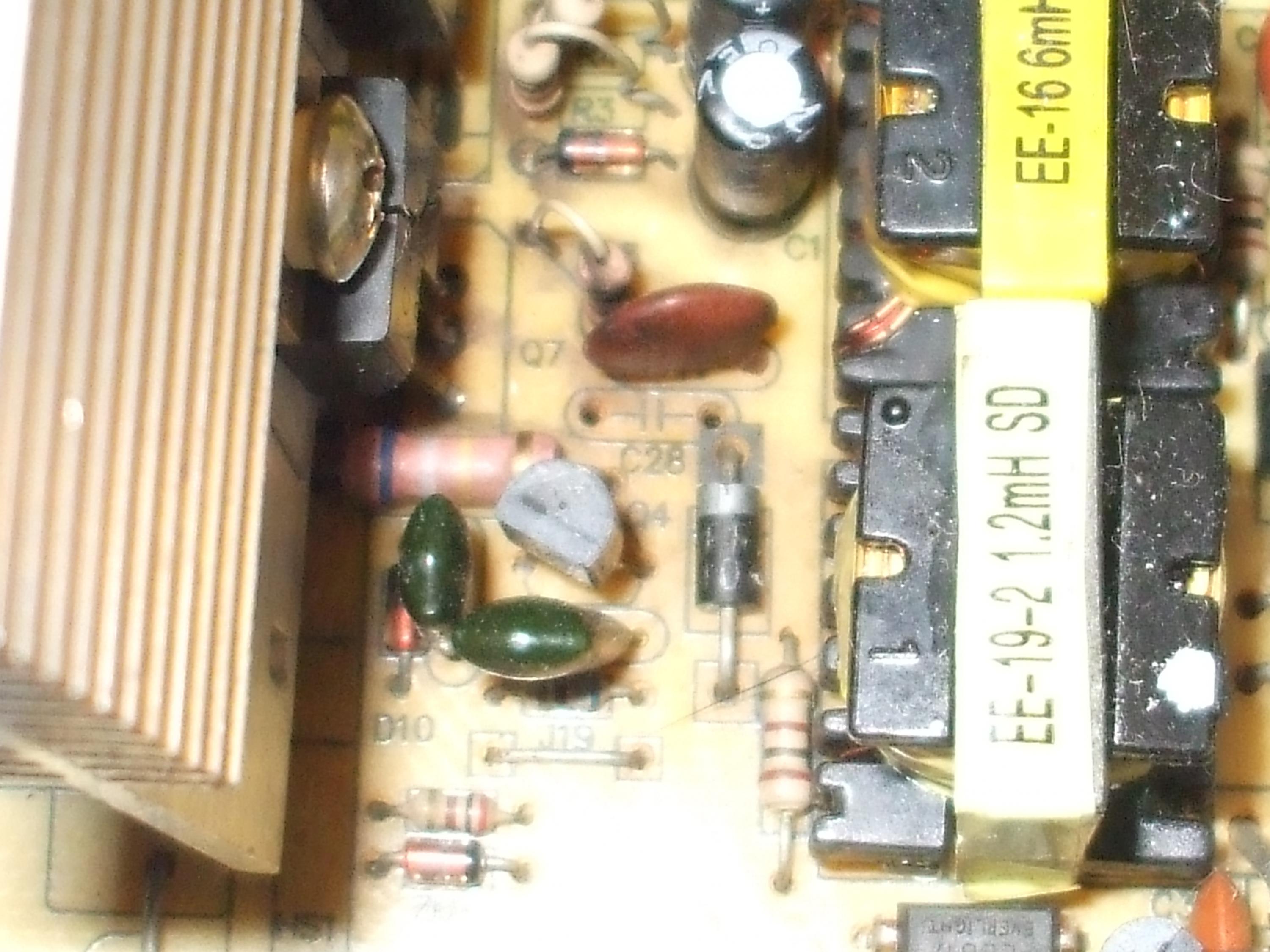

      I apologize, it is a power supply out of a desktop computer.
      Here are a few pics of the power supply with heat sink in
      and out of the supply board. Pic #3 shows the damage of
      Q7, and the location of C28 that was removed. I cleaned
      the board up a little to see the locations of the damaged
      components. Any help would be appreciated.
        Rattman, are you repairing this power supply for fun / as a learning experience, or actually doing the repair for a customer (or yourself)? Reason I ask is because that power supply appears to be a cheapo unit that isn't really worth investing time into, unless you're doing it to learn / for fun.
        In any case, that cap (C28) and transistor Q7 are part of the 5VSB circuit on the power supply. Being a cheap PSU, this is a 2-transistor self-oscillating flyback circuit. Q7 is the main switching component and transistor Q4 is its driver. Chances are, Q4 is probably blown too (either short-circuit or open-circuit is possible, since it's a small transistor.) Also worth checking are all the diodes in that circuit. And if you have an ESR + capacitance meter, check the output capacitors of the 5VSB circuit. If not, replace them. There's a good chance those are bad and caused the circuit to go bad.

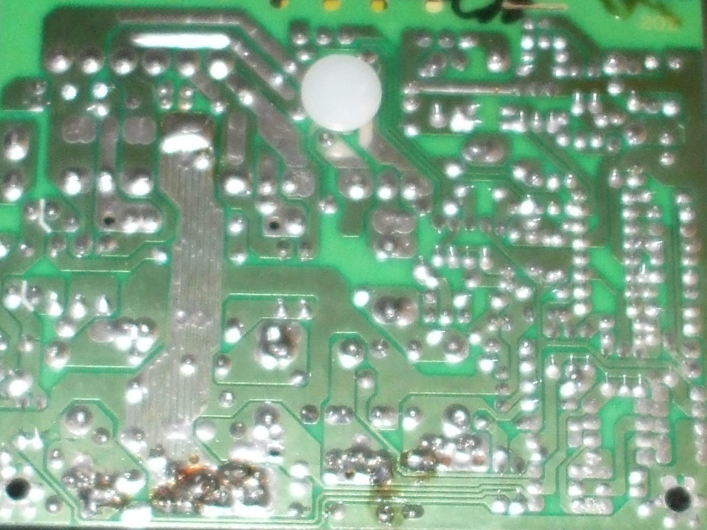

        As for C28, I can't tell you exactly what it is without some pictures of the other side of the PCB. It may be just a small value cap across Q7 Collector-Emitter terminals, or it may be for something else. As for the ceramic disc cap above that - it appears fairly large and is likely part of the RCD snubber network, so I don't think C28 is a snubber cap.
        But again, will need pictures of the traces to determine that.
        The 5VSB on this PSU being a 2-transistor circuit means it's going to be a fairly simple circuit. However, those 2-transistor circuits are very "particular" about having all parts working. If one part is bad, they tend to blow themselves up again. With that said, when you do any further experiments (after attempting a repair, that is), make sure to use an incandescent light bulb (about 60-100W) in series with the PSU's live input (or just remove the fuse and connect the bulb across that). This will limit the current and save your PSU from blowing more parts, should the 5VSB try to do anything "ballistic" again.

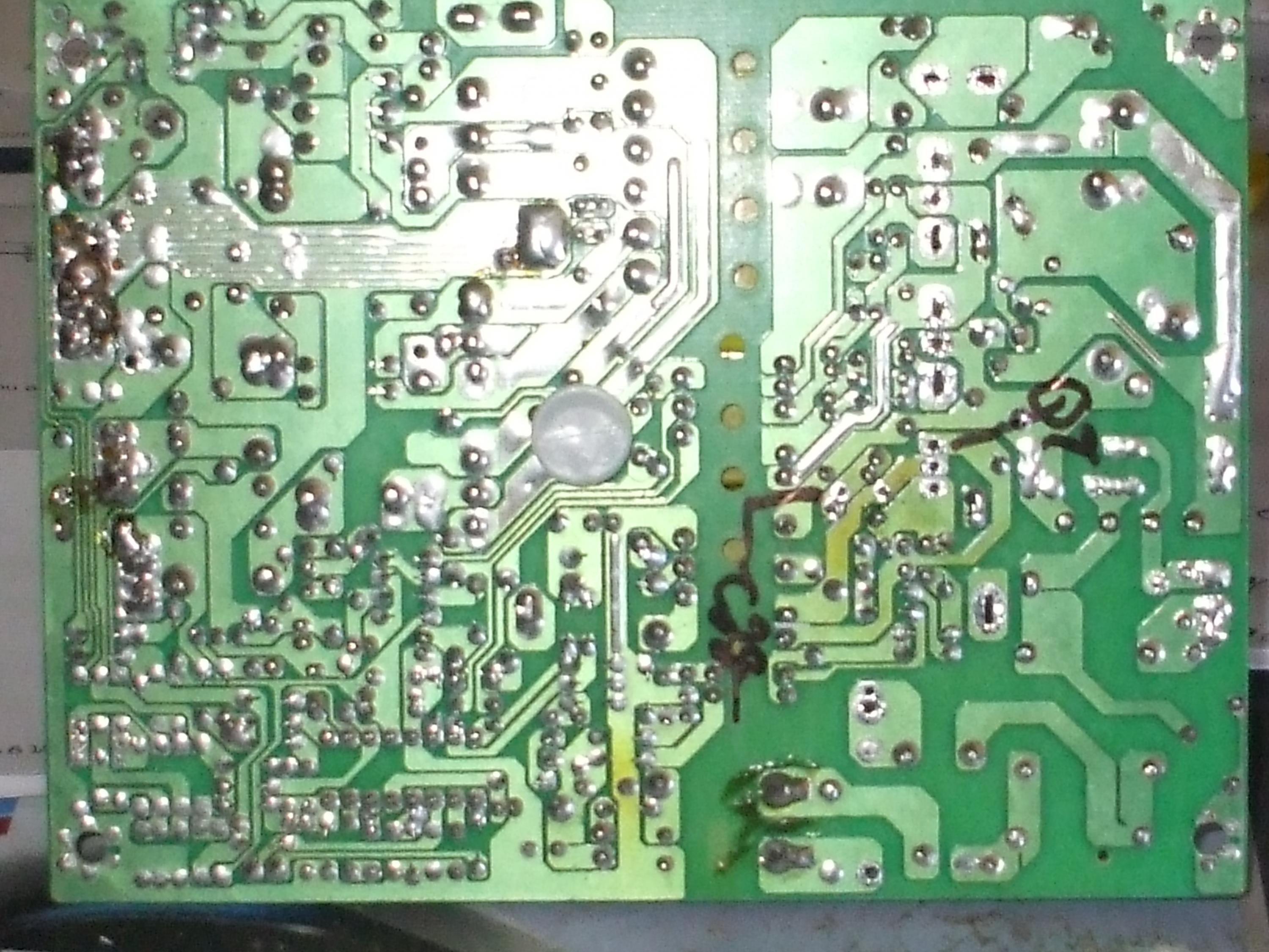

          Thank you for the reply momaka.
          Trying to save a few bucks by repairing it, but it appears that YUELIN does not want you to repair it as there are no schematics to be found anywhere.
          I have an EDS in circuit cap checker that I checked the caps with, they appear to be okay.
          I do use the light bulb trick when repairing TV's, but did not think to use it on power supplies which is a good idea, thanks for the heads-up.
          When the power supply shorted out the computer was off. It came with a mid tower Power-up computer case I bought online a while back.
          I added a few pics showing the bottom of the power board.
            Judging from the second picture in post #3 of this thread, it looks like the PSU has generic 1KV (DC) caps where safety agency rated Y caps (250VAC or higher, with special construction) should be used. If so, that is a safety issue.
              Here are a few more pictures of the power supply with a couple numbers on the top in Pic #8 that might help. If someone has this power supply I would appreciate it if you could look at the C28 disc capacitor and see what the value is on that capacitor. Thank you in advance.
                    The diagram that RJ posted looks pretty similar to your PSU. Check the value of the orange ceramic capacitor above C28. If it's 10 nF like on RJ's diagram, then C28 should probably be around 470 pF. Since it blew up on your PSU, check the resistor next to that orange ceramic capacitor for being open-circuit. Basically, C28 is part of the snubber network, so everything must work properly there. Otherwise, those parts and the switching BJT could blow again.
                    While at it, also check the small TO-92 transistor Q4 for short and open-circuit (will need to remove it from the board to check it properly.)
                        I checked the resistor, (R65=100K Ohms) next to/behind capacitor (C27=10 nF), it measures 99.1K ohms.
                        Since C27 is 10 nF I agree that C28 should be about 0.47 nF 1KV. Checked Q4 for an open/short, measured
                        okay but has a crack across it so I'm gonna replace it. Ordered the replacement parts and will let you
                        know how it goes.

                                      • Bill Sullivan
                                        • Feb 2022
                                        • 2

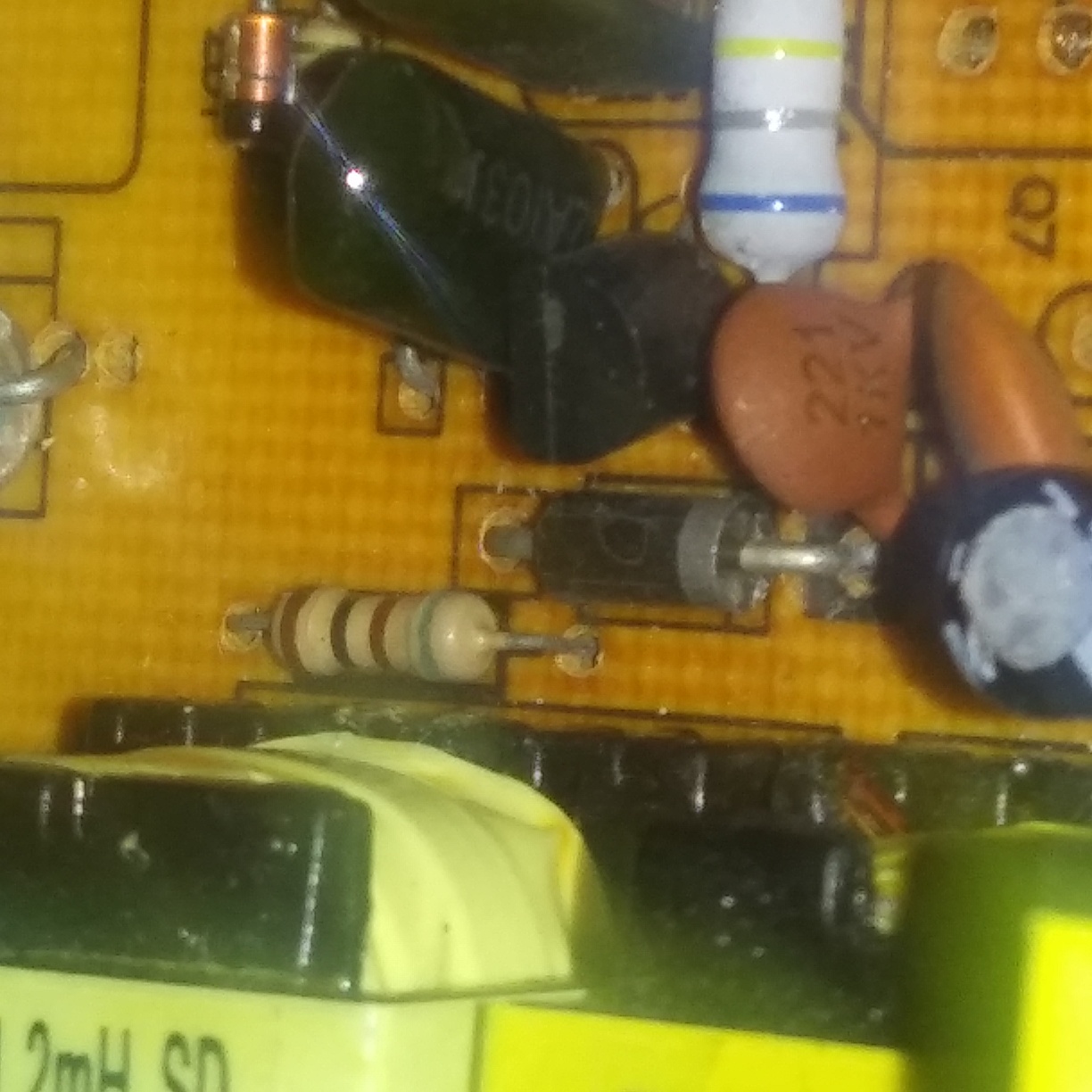

                                        I know this is an old post but thought I would answer since I have this board and Rev 2.1 board.
                                        YLP-013 Rev 2.2 c-28 is 221 1kv, c-24 is 103 1 kv
